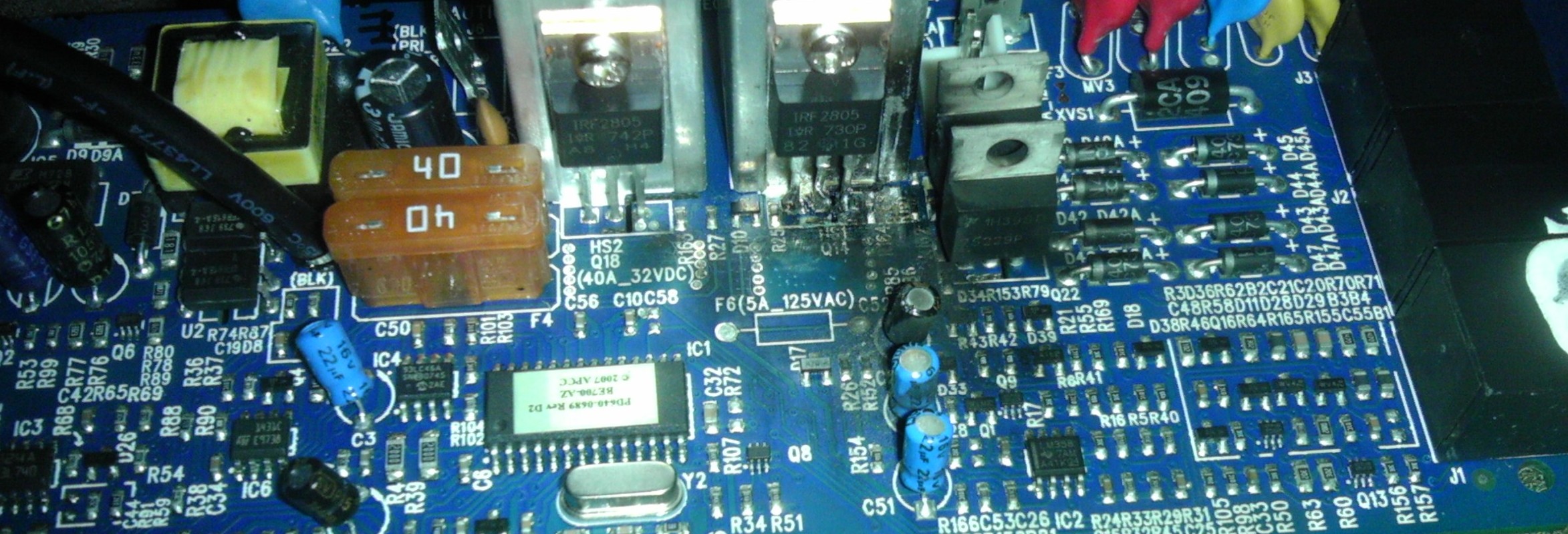

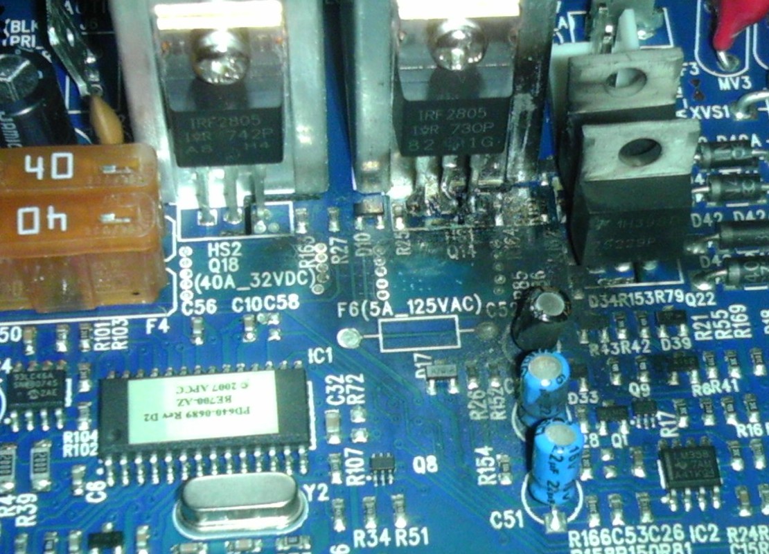

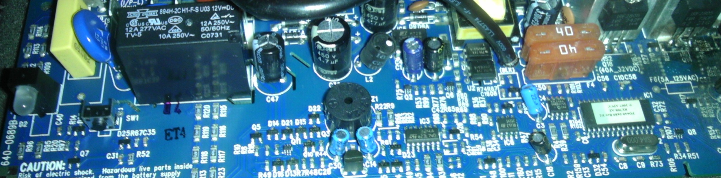

    UPS APC (640-0689b)
    this UPS is giving no power, just beeping.
    I look inside and see one transistor IRF2805 is blown up.
    I change transistor, but when i test the UPS transistor blows UP again.
    And second transistor is burning hot, but not shorted.
    Thanks.
    • 31304
    Re: UPS APC (640-0689b)
    because something is shorted and drawing too much current.
    you need to check all diodes & stuff for shorts.
    also, check the battery(s) with the power off to see if they all have voltage.
    if one has no voltage it may be shorted out.
