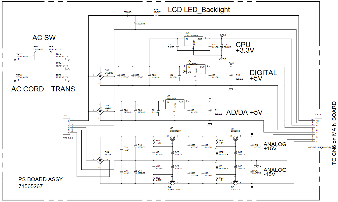

    Anyone got any idea what voltages these transformers run this was 117v transformer plugged into Australian mains power.
    2 red wires are center tapped.
    I'm just trying to get a understanding of the specs I should go before getting a custom r-core built via China.
    I don't really trust what is written on the transformer to what I see in the vg-88 schematic which uses the same part number.
    The voltages here seem a bit low in comparison to what people have measured else where.
    Filter caps are 16v
    And 2 other filter caps are 25v
    What amperage should each leg have on the transformer.

        I am really surprised there is no fuse board. Inside the transformer the thermal fuse better be there, although the transformer has no safety cert on it which is scary.
        Can you give the part numbers on the three guys on heatsinks and on the DIP-8. It looks quite different than the VG88 board (sch attached).
        My math,
        19.2VCT gives +/15.1VDC raw at no load, +/12.4VDC raw at full load, which is a bit weird as feed to the linear regulators. It's too low for even +/-12V regulators (rails).
        8.9VCT gives +/12.1VDC raw at no load, +/10.2VDC raw at full load.
        So I also think the transformer label is suspect.
        For +/-15V regulators I've used 25VCT and it would drop out and give hum if the mains voltage sagged at some venues, so I use 28VCT with no problems which gives +/-18.6-21.6V into the voltage regulators and there is headroom for low line.

                            I checked and the other model VG-88 uses some LDO's.
                            5V 2A digital reg PQ05RF21 (4-pin) LDO and 5.5V in minimum.
                            Second 5V 1.2A reg is an LDO AN7705F and 6V in minimum.
                            The +/-15V rail is a capacitance multiplier and transistor/zener reg.

                                What are you going to do with 27VDC, it's not good for anything in the guitar synth. The filter capacitors are only rated 25V and 16V, and 27V would make so much heat for 15V regulators.
                                So am saying it can't be 19.2-0-19.2VAC it would be too much for anything, which makes me think the label is bogus. If it was 19.2VDC - then that is a good value for feeding the 15V regulators, and their filter caps. Only way I can make sense of it.
                                Looking more at the PC board, I see the other low voltage winding has no center tap and is isolated from the other center tapped winding. I think it makes 8.9VDC to feed a 5V and maybe 3.3V regulator.

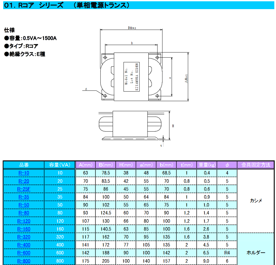

                                      OP can measure the old R-core size and use this table for a ballpark VA rating. From Kitamura Kiden Co. catalog. Maybe even hit up the company for more information on the original transformer?
                                      Kitamura KRT-18D-A-002S2, K5F1KO, 22453552C0, Label Pri: 120V, Sec: 19.2V and 8.9V for the search engines.
                                      One trap is using an oversized transformer VA. If you run them under their rated load, surprise! they have higher output voltage so vregs end up running too hot.
                                      I think SMPS modules are too noisy, Roland stayed using linear regs to keep the synth quiet, good noise floor, lots of ferrite beads as well. The toroid inductor and big diode on the power board sorta look like a buck-converter? but I can't see it being used due to the EMI. It might already have a TO-220 converter for the 5V rail there?
                                      We don't know the IC numbers but I would be fine with using a 14 or 15VACx2 1A transformer (for around 600mA DC) plus another transformer 8-8.5VAC 2A.
                                      I noticed the other model synth VG-88 has 35V filter caps (not 25V) and a capacitance multiplier/ripple filter for the 15V rails - so it needs a bit more extra headroom for the voltage losses there- but OP said it's the same transformer used in both models?
