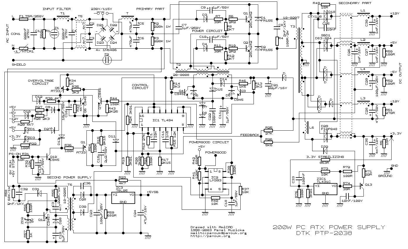

          Also, while the 5VSB may be stable, is the auxiliary supply (the one that actually provides power to the controller) also stable?

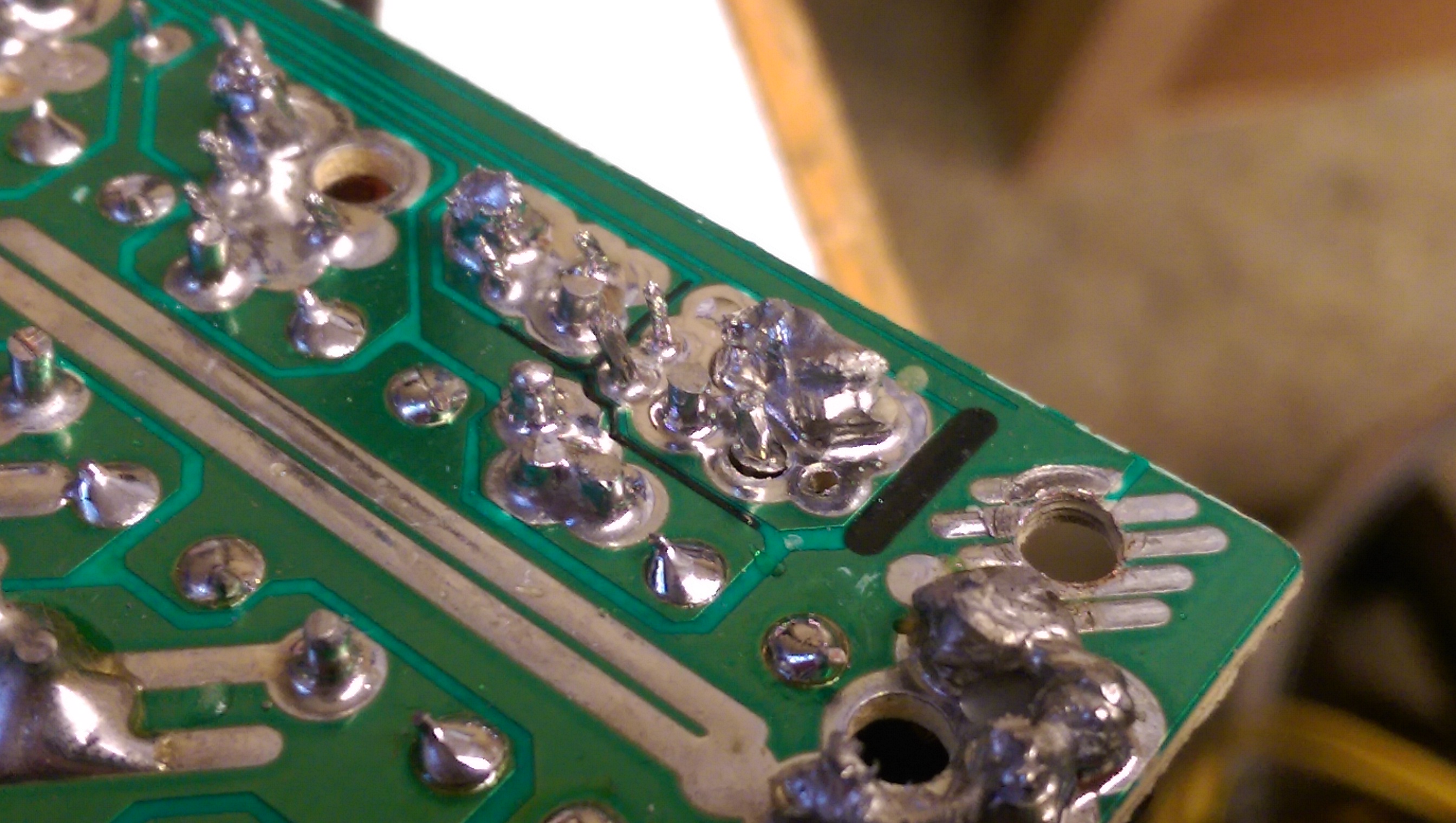

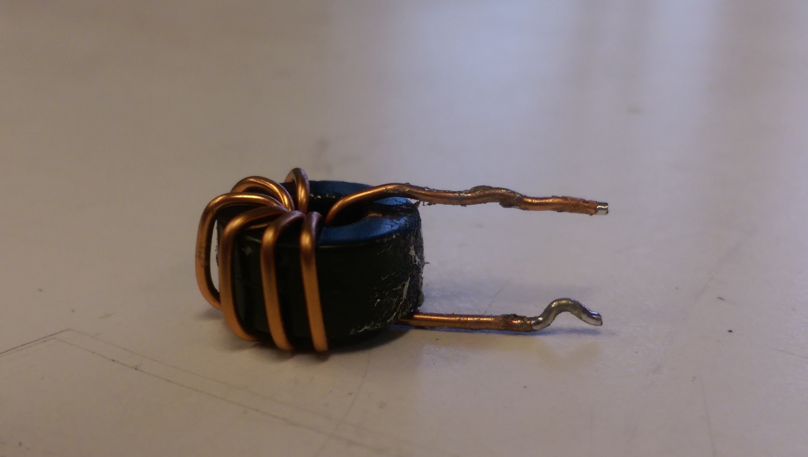

            So, I looked at this thing again, and at first I thought that fixing this was going to solve the issue:
            That must have happened after moving the wires around. I also found other inadequate joints and fixed them as well, but when trying to power on a system, the motherboard CPU fan would just tick (Not the PSU fan)

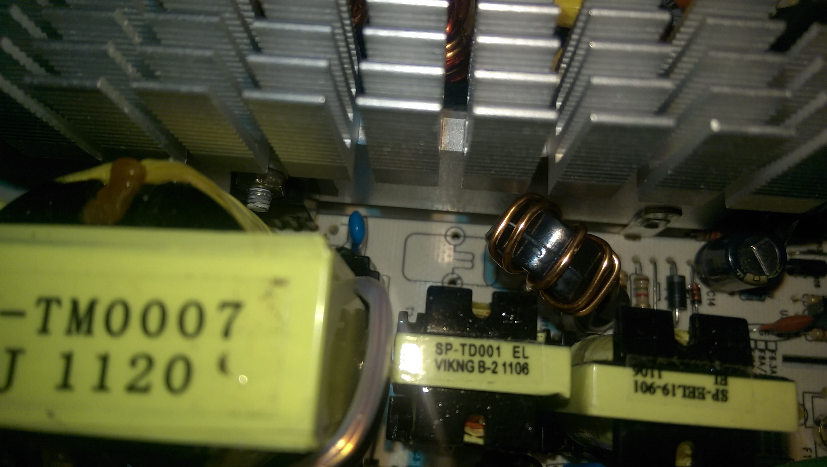

            So I found another potential issue, the 5VSB output inductor was physically touching the 3.3V toroid. After separating them by wedging a piece of plastic between them, the issue remains, however now instead of a tick on the CPU fan, it makes a few revolutions instead AND now the PSU fan will tick as if it's attempting to start. Doesn't this seem odd? When attempting to power on, you hear a quiet click inside the PSU. No whining or other noise noticeable. When first plugging in, PS_ON gets 5.13V, and goes down to 0V immediately after hitting the power button. PG gets 0.016V, 0.028V briefly when the power button is hit, then goes back down to 0.016V.

              Maybe check for short circuit between rails? - i.e. between 3.3V rail and 5V, rail, 12V rail and 5V rail, and etc. Perhaps something could be shorted on the large toroid.
              The controller appears to be an "updated" 494 variant, like the AT2005b and ATX2005 with direct sensing for 3.3V, 5V, and 12V.
              According to the datasheet Functional Block Diagram, "REM" (your PS-ON signal) only appears to be an input. So I'm not sure if it is supposed to latch down to low (0V) like that. Check the VCC voltage on the chip and see if it's still there after this happens.
              Other possibilities are some random small resistor to have gone open-circuit - but that is extremely extremely rare. More likely a bad solder joint.
              Also check that one (or both?) of the BJTs on the primary side is not open-circuited. May have to disconnect some resistors on the Base pin for that, though - if you want to spare yourself from removing the BJTs (I would). Make sure both BJTs have a "healthy" B-C and B-E diode readings. And while in that section, check the Base drive circuit. That would be resistors R5 (which appears to be 1 Ohm?) and the second resistor next to D4 (same color code as R5). Check D4 and the other diode that's kind of hidden under the main transformer. Oh, and make sure the small electrolytic caps (C5 and C?) are not open or shorted.

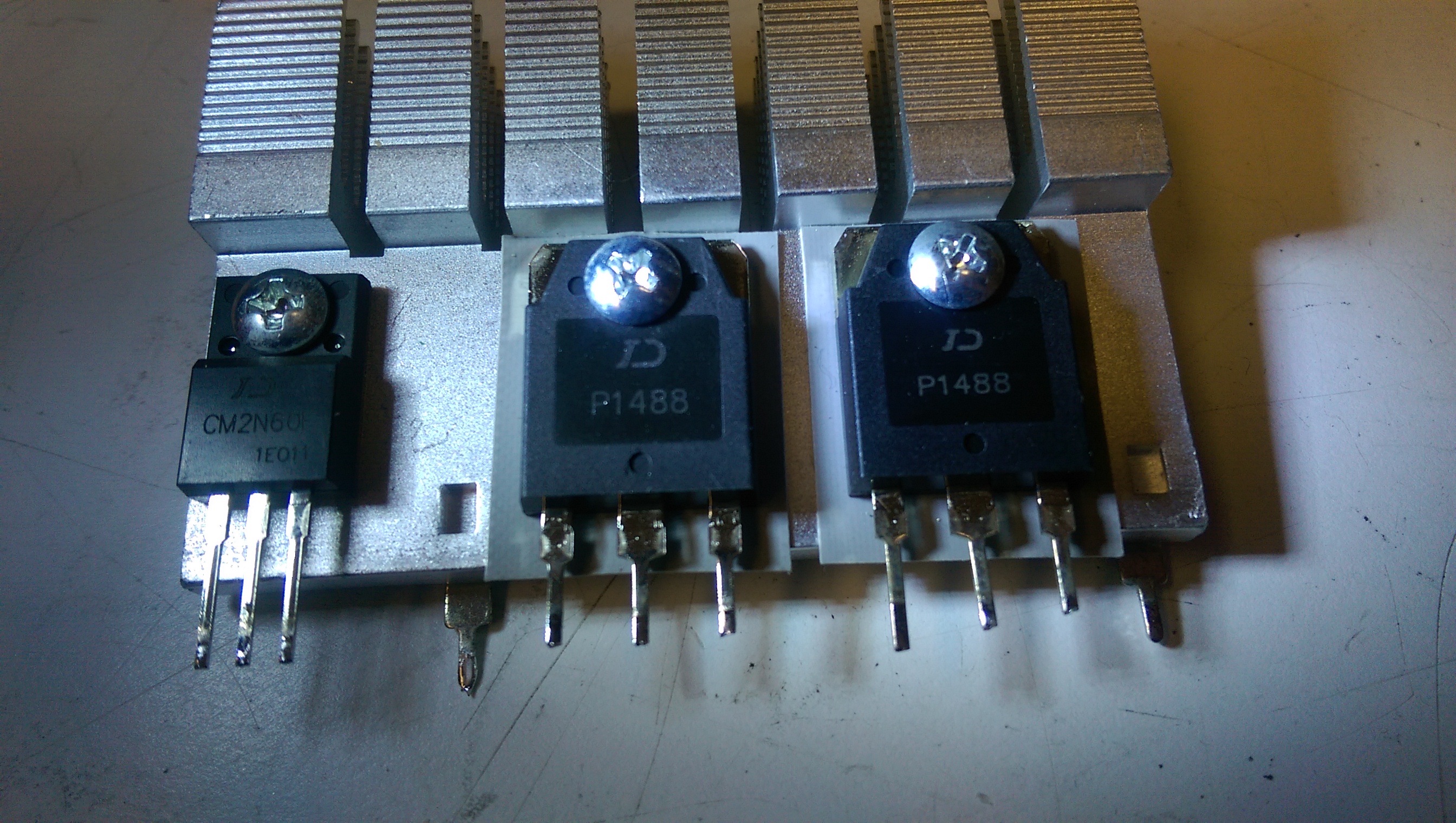

                This is likely, since the more I look at this thing, the more terrible the soldering seems.
                I have a strong iron, so removing the primary heatsink is no trouble I will do that tomorrow, will check those resistors too. I've recapped every cap with japanese parts, should I still check those caps?
                I don't know if this could be a clue or not, but many reviews on newegg state the same issue, indicating that this thing could have a specific design flaw? Within reason I'd like to fix this thing, minor build quality issues aside, it's very solid looking

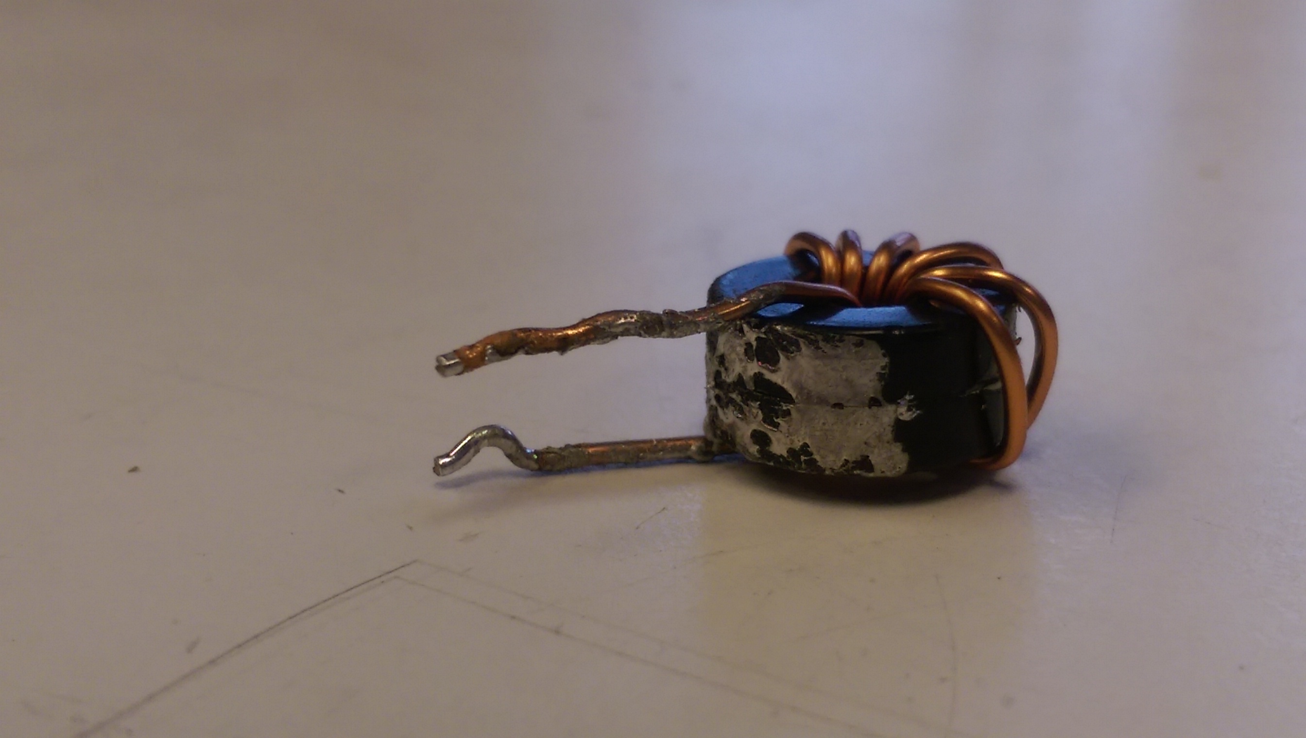

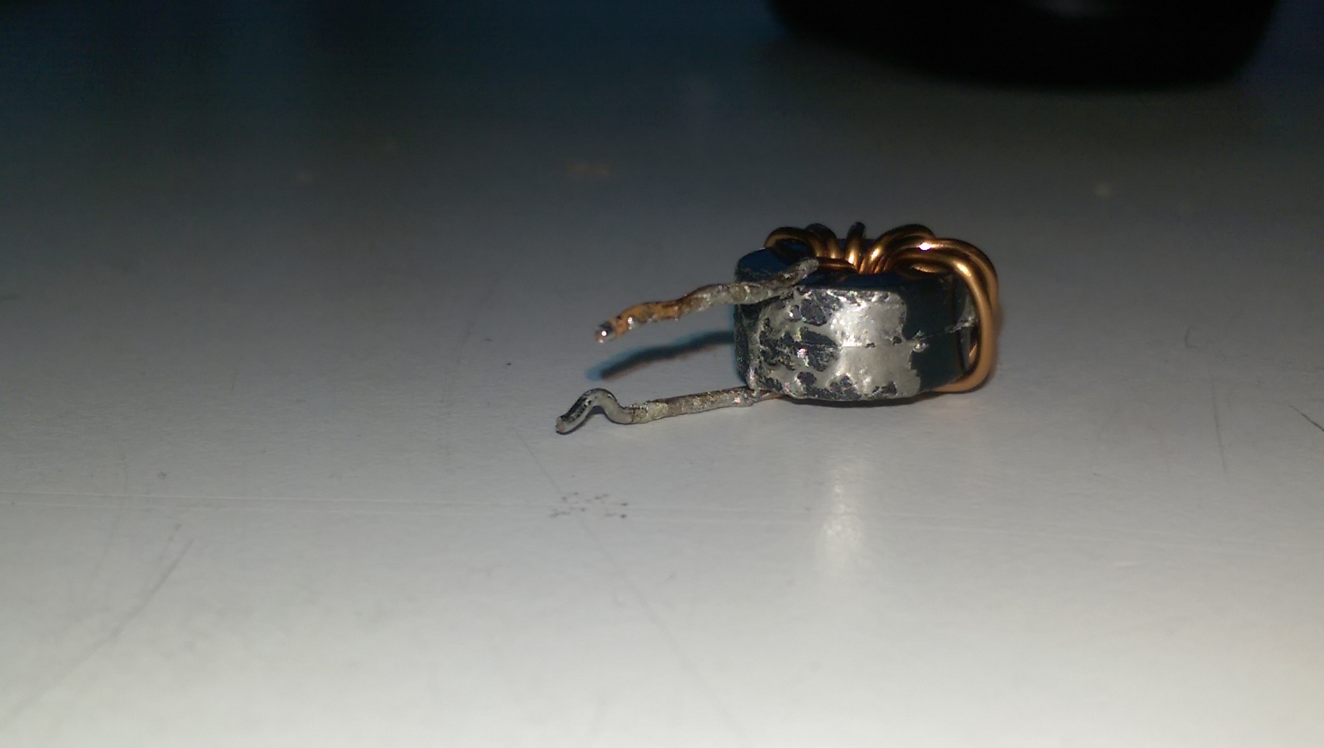

                    Guys, momaka is a genius! Anything look funny with this mag amp coil?
                      I can't imagine...
                      Re-tin/resolder that lead, and maybe replace those secondary rectifiers.
                      Since it's a half-bridge, I'd also check the base drive circuits for the power transistors. Specifically, two signal diodes, and six resistors as detailed below. Use the attached diagram for reference, your supply will share the same circuitry, but probably not the same values or ref-deg's.
                      2- 1N4148s (D3, D4)
                      2- 1.8-4.7ohm, 2.2 being common (R6, R10)
                      2- 22- 47ohm, 39 being common (R7, R11)
                      2- 1.8k-4.7k, 2.7k, 3.3k, and 3.9k being common (R8, R12)
                      If you've replaced the two small electros (C9, C10), don't worry about them. Otherwise, replace 'em- they bias the switch transistors. They're usually 1-4.7u, depending on the unit.
                      Now, if you also suspect the two freewheel diodes (D1, D2), just replace them- as you've seen with diodes, they can "appear" ok, but are still bad. They commutate the current resulting from the leakage reactance of the power transformer- no transformer is perfect and not all energy applied to the primary gets to the secondary. Those diodes and the snubber network (hopefully) take care of that.
                        Ha! QC PASSED!!!
                        Funny you have nearly the same problem in your PSU, even though it is from a completely different manufacturer. The 3.3v rail output toroid in my LinkWorld PSU didn't have ugly solder splat like that, though. Makes you wonder if the employees in that factory had a hot solder mini-wars just for fun .
                        However, I see another potential (lol them puns) problem with your PSU - those 3.3v toroids for the mag amp look like they are touching the secondary heatsink. Perhaps the coil you removed (or the one that is still there) are shorting to the secondary heatsink? I suggest putting a plastic insulation sheet or something.
                          If that edge is poking through the varnish, then maybe so. With heat and movement, it could (partially?) explain the "randomness" of its problems.

                            Oh my WTF with that toroid

                              In the mean time, I also have an SDC2921 coming in the mail, in case the one I have is bad.
                              They were retinned, no luck still I know it looks that way, I think it's the angle of the picture. They're both ~8mm away from the heatsink in both directions. If that's still too close I can move them, but that seems like a safe distance.

                                  Wow those transistors look kinda screwy (AKA cheap). Interesting that they aren't the all too common MJE13009.
                                  Wow I never would have thought to check the insulation on that mag-amp coil. Haha reading this thread made my day!
                                    Haven't found anything bad so far. However, notice the BJT's. They're the same, but notice how the printing was done in different sizes, and the way they cut the leads on the right one
                                    https://www.badcaps.net/forum/attach...1&d=1424224095
                                    Wow, they do look quite goofy. I wonder if one of them went open-circuited. It's a rare failure mode for BJTs, but it does happen. That could also explain the fan "blip" you see on the output.
                                    If you still have them out of circuit, check their B-E and B-C PN junctions... i.e. set multimeter on diode test mode, put red (+) probe on the base (B), and black (-) probe on emitter (E), and then collector (C). You should get a healthy diode voltage drop on both - probably around 500-700 mV (usually around 600 mV).
                                    - OR -
                                    If you have a crappy PSU with 13007 BJTs (or something equivalent), try swapping those into this PSU.
                                    Another thing I would suggest you check - the 3.3V rail mag amp circuit. In the schematic diagram that Kaboom uploaded (200W PSU, "DTK PTP-2038"), that would be on the lower right of the picture - you should have a circuit similar to that in your PSU. Should be a small transistor (Q13 in the PTP-2038 schematic), a diode (D32), and a 431 shunt IC.
                                    Finally, check that none of the silicone parts - both on primary and secondary - don't have their tabs shorting to the heatsink.
                                    Yes, that distance is more than enough. If your voltages on the secondary side are jumping 8mm air gaps, you'll probably have bigger problems
                                    • Behemot
                                      • 4845
                                      • CZ
                                      Re: Epower EP-600NE-XV Shuts down intermittently
                                      I think that EU norm is at least 3 mm of air insulation so 8 mm is just OK.
                                      • kc8adu
                                        • Nov 2003
                                        • 8832
                                        • U.S.A!
                                        different counterfeit parts with different markings.
                                        but why?
                                        bjt's are too cheap to be worth all that.
