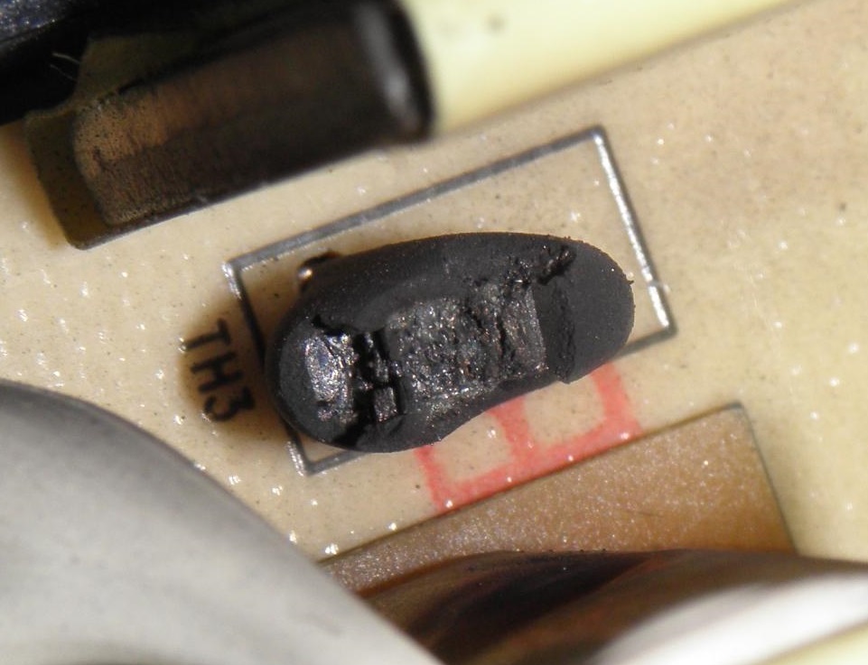

    Hi Guys,

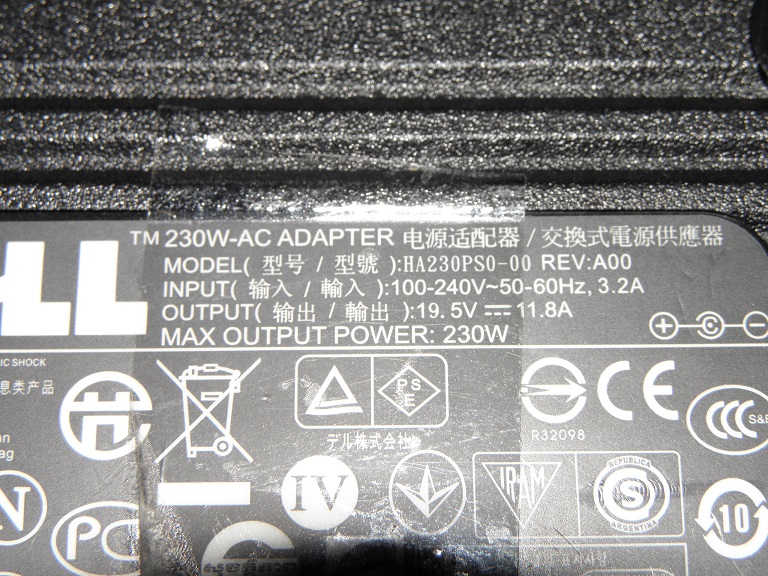

    I have a Dell M1730 which is in restricted performance mode and in the BIOS the PSU is showing as unknown.
    The PSU model is HA230PS0-00 REV:A00 and the blue LED comes on and the output is over 19.5v and the laptop powers up - but battery isn't charging (that may due to separate batt issue) and the laptop is in reduced performance mode.

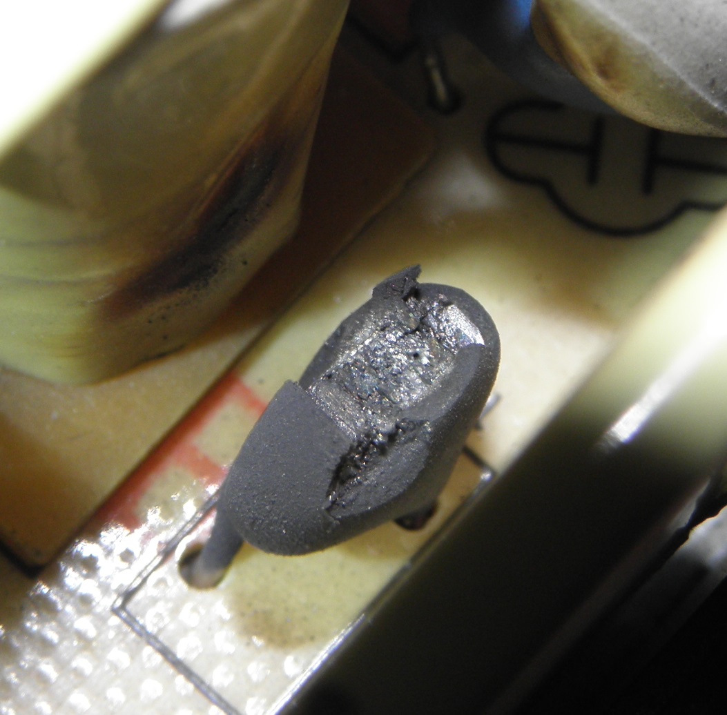

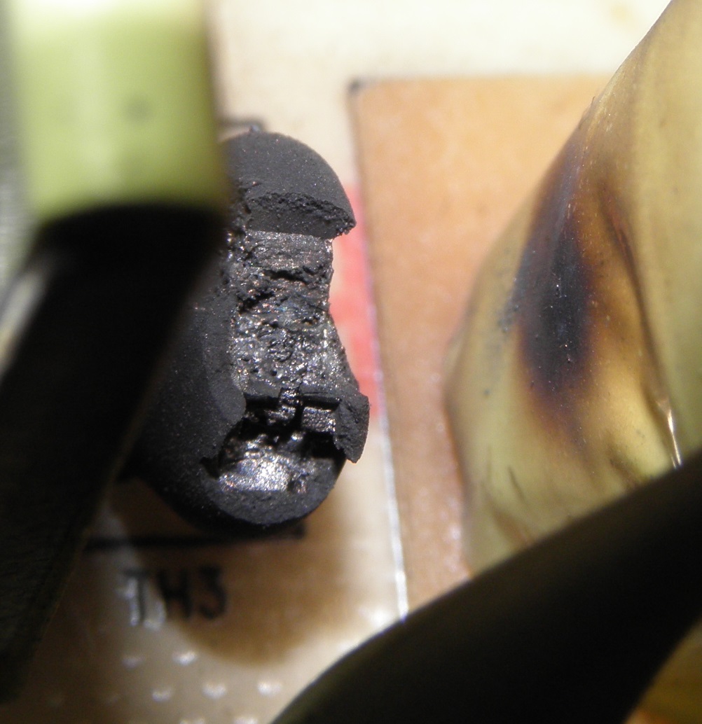

    I opened up the PSU unit to check the continuity of the Dell genuine 'signal' wire and the first thing I noticed was a component which looks like it is self destructing and there are brown marks on the component next to it.
    On the PCB it is marked as 'TH3' and the first time I powered up the PSU open & plugged in to laptop - some sparks came out the top for about half a second.
    Please see pics attached for PSU P/N/specs, TH3 & it self-destructing.
    Before I do anything else I wanted to ask for your help;
    1. Would anyone know/can suggest the part number for TH3?
    2. Does this need to be replaced straight away or it doesn't impact on the overall performance of the psu?
    3. Is failure of TH3 isolated or the result of something else also failing?
    Thx.

    That is thermistor which is for the in-rush current limiter used in the primary side, it is connected after the Main AC fuse. What resistance does it show right now? You usually do not see this kind of damage, unless there is problem in the circuit which is drawing too much current exceeding the current limit of this device.

        Re: DELL M1730 LAPTOP PSU HA230PS0 - Sparking component - help please
        That is way too high, at 28 Ohms, with 120V circuit, for 230W power supply, I expect it to around 2~5 Ohms or so when cold, this inrush limiter is the NTC type, as it is heated up the resistance will go down.

            Vpeak = line voltage x 1.414, so 240 x 1.414 = 339V, then look at the capacitance value of the main filter cap (there should be big electrolytic cap laying on its side) and put in those numbers in the calculator to find the J rating then look at the that can handle the Joules rating.
            • Markie76
              • 81
              • United Kingdom - the land of 240v!
              ok, I've delved further into the psu - the capacitor is marked 450v 220uf;
              Vpeak: 339v
              Capacitance: 220 uf
              Total energy = 12.6 joules
              So I need a thermistor rated above 12.6j so something like 15 or 20?
                      This one should be OK: http://www.ametherm.com/datasheets/sl1025002.html
                      25 Ohms (that will limit the Pk current @ 230V (325Vp) to about 13A which the bridge rectifier should be able to handle), 20j, Max 2A steady state (your power supply is rated at 230W, so the steady state with 90% effi will be about 1.1A). This is the closest one I come up with, it will dissipate about 1W of power with 1A.
                      Please note that I do not know what the peak inrush current of this power supply is designed for.
