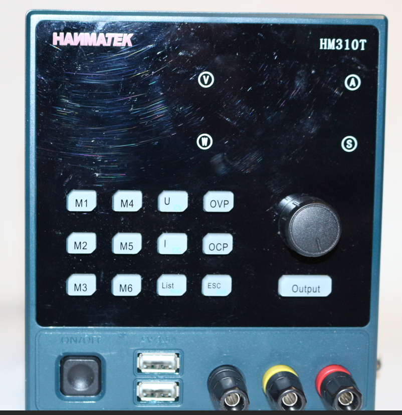

    hey there
    I picked up a faulty bench PSU that was being discarded as was faulty. So the internal SMPS has some faults, bad thermistor, Schottky rectifier and Mosfets all blown and I have replacement parts on way. fingers crossed 😀
    I am looking for a set of diagrams for the power supply. has EST v1.15 along with 2022 date. Not sure if the EST refers to Edwards or some other manufacturer.

        Hi
        Photos as requested:
        Front panel

        the main SMPS board is loose as the heatsink is removed with 3 faulty components...i removed to test a 470uf 50v cap but has tested OK.its removed from near top left of the board on the DC side.
        all the issues appear to be on the hot side.
        from the rear of the bench supply - 5A slo blo fuse also blown. The USB port is for programming the supply

        the faulty parts on the heat sink are
        Q9 & Q10 = cs20200CT MOSFETS
        Q8 = 13N50A Schottky Rectifier
        NTC1 = NTC20D11 Thermistor

          all working great after replacing the blown items listed.
