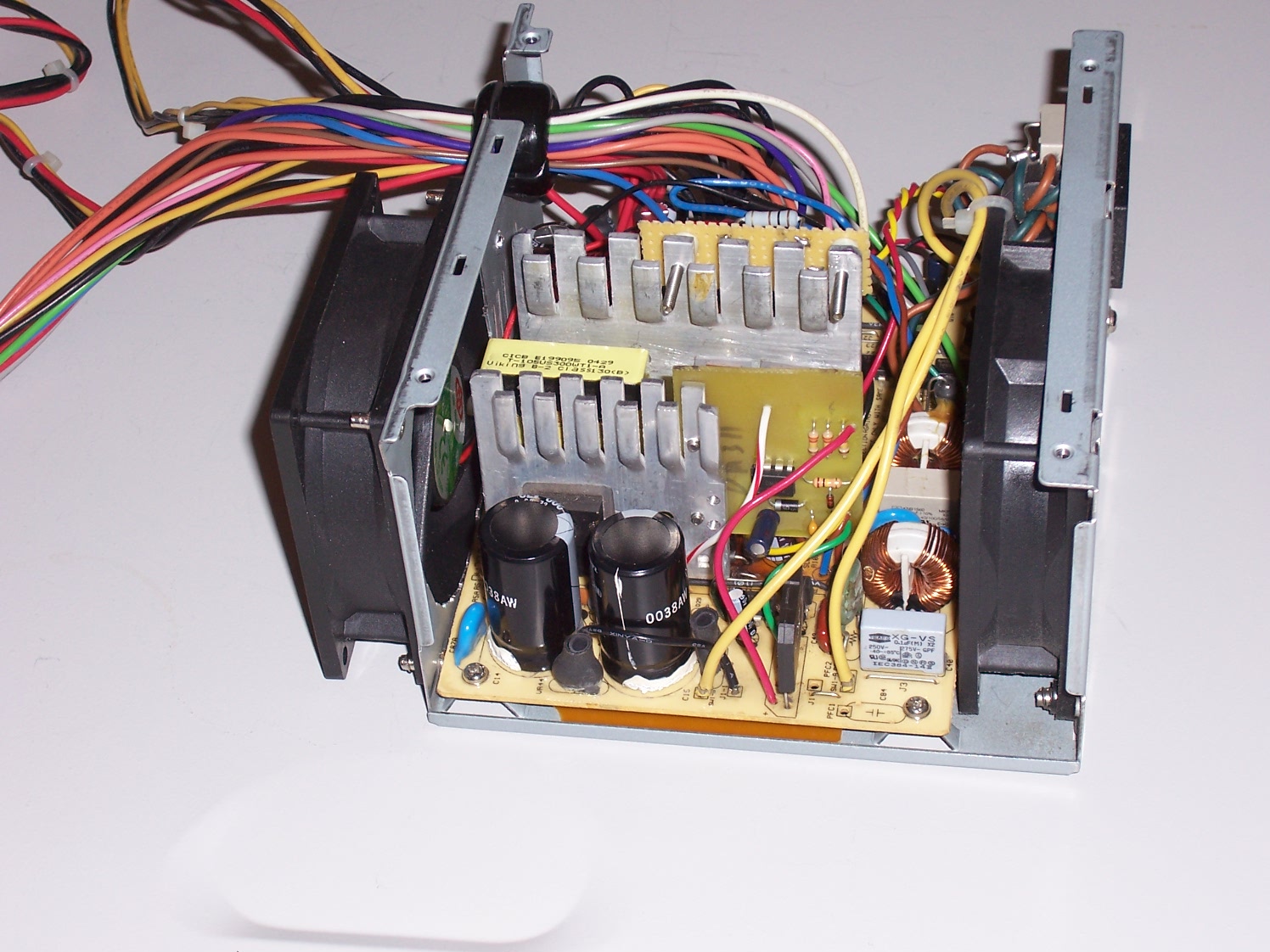

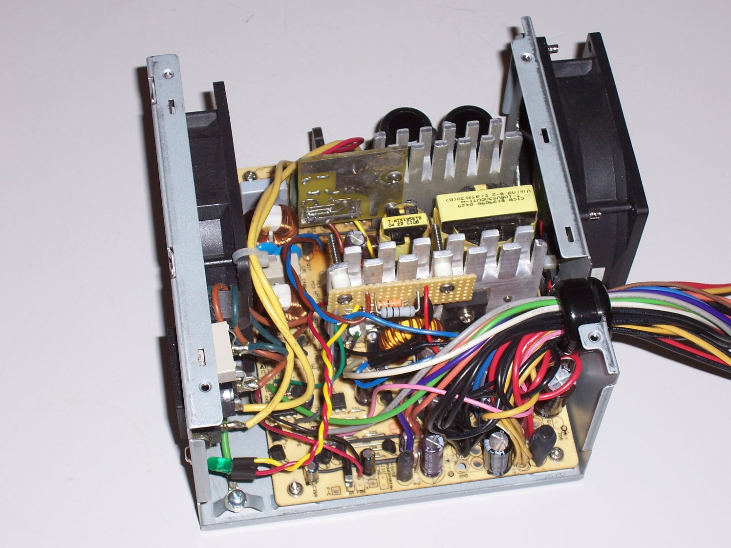

    My good friend LDSishere made a DM311 5vsb mod circuit board for me. I installed parts and installed the new board on a recently acquired Bestec ATX-250 12E. This is the mother board killer power supply until retrofitted with a 5vsb modification such as this. I began by removing capacitors and removing glue, some of which had turned black and was obviously causing leakage problems. After replacing the old Jamicon capacitors with mostly Nichicon PW series, I applied power. Nothing. Very frustrating after all that work. Troubleshooting, I determined that the 5vsb transformer feedback winding was not delivering any voltage to the pwm chip. Bestec "12E" transformers are scarce and hard to find. So................
    Pictures show the new pc board DM311 5vsb mod.

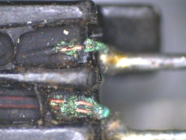

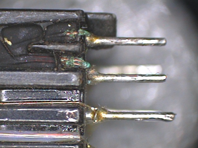

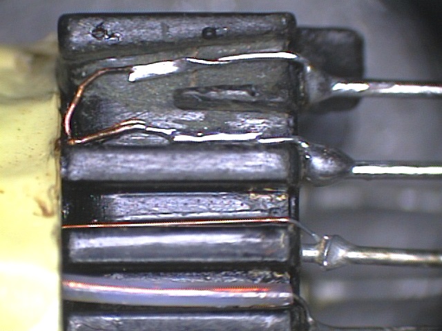

    I removed the 5vsb transformer and noticed that some of that black glue was coating the feedback windings. I carefully scraped the black glue away.......finding two of the wires were corroded under the black glue, and had corroded apart leaving open windings. Once the black glue was gone, I soldered tiny thin wires to the windings and reconnected them to the transformer pins. Installed the repaired transformer, and everything now works OK.
    I wanted to start this thread to show the effects of corrosion under the black glue on this power supply. I am sure other people will see some of the same type of problem on other power supplies. This demonstrates that a repair can be done! See pictures of the repair viewed under a microscope.

          I am glad to see the board worked, did you have to mod it any? Is the modded board on the other heat sink for the added fan?

            I did not have to make any changes or mods to your board. Once the transformer was repaired, the 5vsb came right up.
            The other board is for two functions. The resistor on top is 100 ohms in series with the fan to serve as a load when the 5vsb is on and working, but the computer is off. Keeps the 5vsb circuitry cool when the computer is off. The other components are an indicator circuit, tied to the ps-on and pg-out lines. It has a LED which comes on when 5vsb is on but computer is off. When you turn the computer on, the power good output keeps the LED on.

              Yeah, that tan glue really is corrosive. I've seen it corrode terminals on resistors quite badly. It's even more frustrating when they goop-up the whole PSU in that stuff. One of the Bestec PSUs I fixed for a friend (ATX-250 12Z) was a really bad case. Almost made me want to give up.

                  Just found this article in another forum. Looks just like the glue I have been finding in older Bestec power supplies.

                    just cleaned a bunch of that shit out of the vco units on a kenwood ts-440 hf radio.
                    the stuff is an intentional built in failure.i tossed several bestecs that had so much glue in there it wasnt worth my time.a cap change is just barely worth it.looked like they dumped a gallon in each.thats an exaggeration of course.

                            Don't toss any more of those bestecs with lots of glue. They are now "vintage" antique hard to find classics. No kidding! I was looking on ebay to see what kind of cheap replacement I could find for an old western digital 6 gig hard drive for an old pentium 2 computer. Hard drives with under 19 gig capacity are listed as "vintage" and priced $30 to $100 (and higher). Even pieces of the hard drive were being sold for ridiculous prices.
                            Besides, I can clean the glue off an old bestec, recap it, and it will outperform those old Leadman and PowMax pos. I still have a CompUSA made by Leadman which I have not been able to fix. Uses UC3843 pwm chip in current forward design. The switching transformer has a strange primary windings design.
