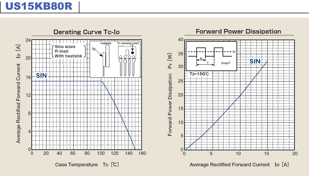

Vf times the current through the rectifier gives you the heat which the rectifier has to loose. So for example, if you have a rectifier with Vf = 1.3V and the current going through it is 10A... then it has to dissipate 1.3 x 10 = 13 Watts. That's quite a bit. Compare that with a 0.5V schottky passing the same current: 5 W - almost 1/3 the heat output just from that rectifier.

But I don't think it matters here this much anyways because even one of those bridge rectifiers will be sufficient to handle the full load from the PSU. I've seen microwave ovens rated for over 1 kW with just one of these bridge rectifiers. I think it's more of a gimmic/hype that they have bridge rectifier heat sinks in those PSUs.
. Wouldn't the external one get much hotter?
