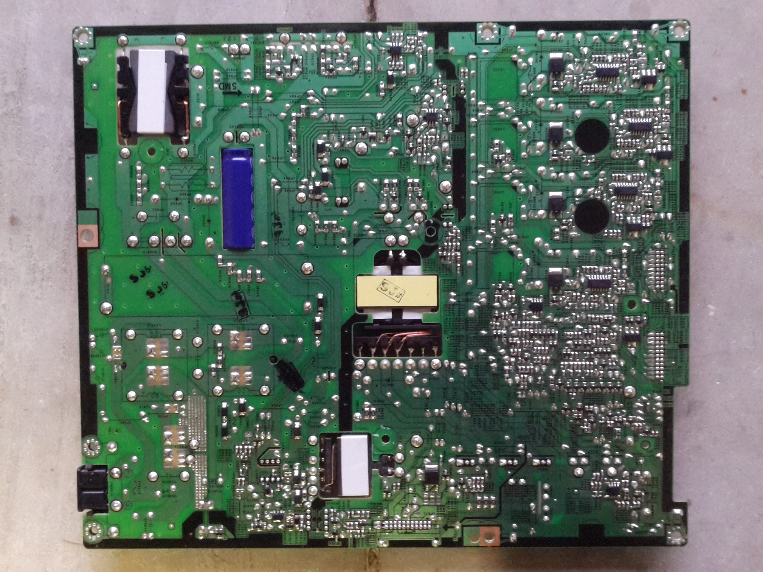

Having a power supply problem on a Samsung UN55D6400UF.
This is one of those LED smart TV's (2011), with the led driver is built into the PSU.
Here's the problem:
- locked in Stand-by mode (blinking 2 red)
- Relay cycles on/off (about 5 secs.)
- No Backlight
(with CNM803 disconnected from the Main board - Forced Backlight does not turn on any of the Leds.)
I'm assuming that the Led driver (circuit) is what's causing the protection mode, and shutting down the power supply ?
All readings are at the PSU with CNM803 disconnected from Main board (forced backlight mode)
CNM803
1) 5.30
2) 0
3) 5.09
4) 0
5) 0
6) 0
7) 12.80
8) 0
9) 12.80
10) 12.80
11) 17.09
12) 4.74 *
13) 17.09
14) 0
15) 0
16) 0
17) 5.40
18) 5.40
19) 5.40
20) 3.20
21) blank
22) blank
* BL_On only generates 0.24 vdc when main board (CNM803) is connected to P/S

With all that being said (whew)
I'm drawn to the discrepencies in:
CNL802a 11/12 and 17/18
CNL802b 7/8
Are the Led outputs all suppose to be in tandem ?
