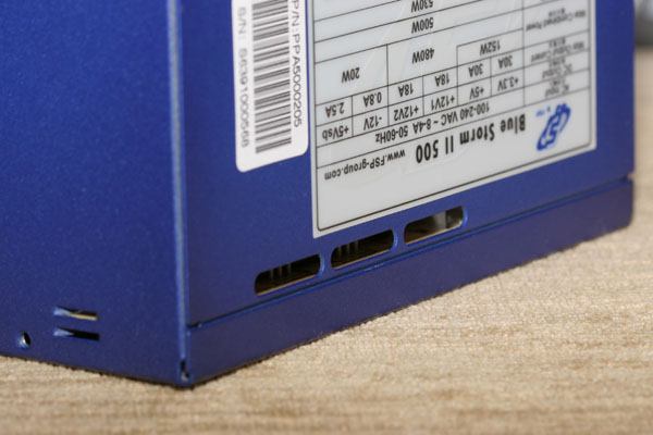

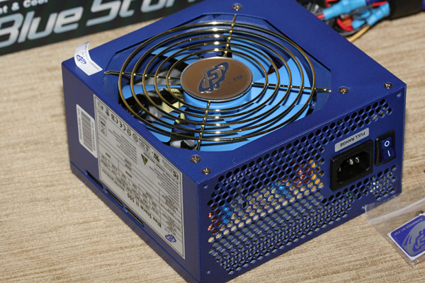

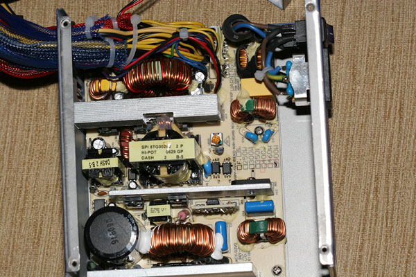

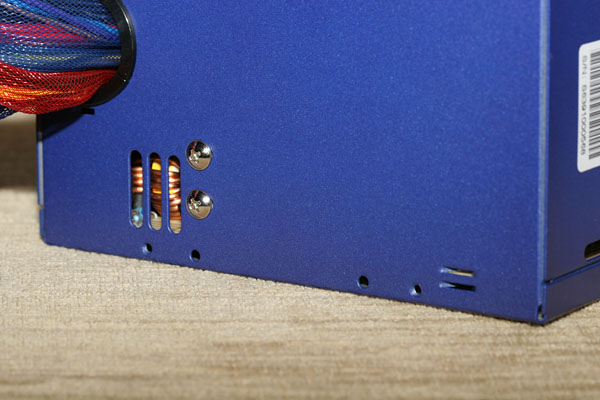

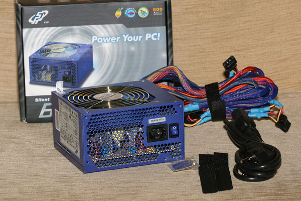

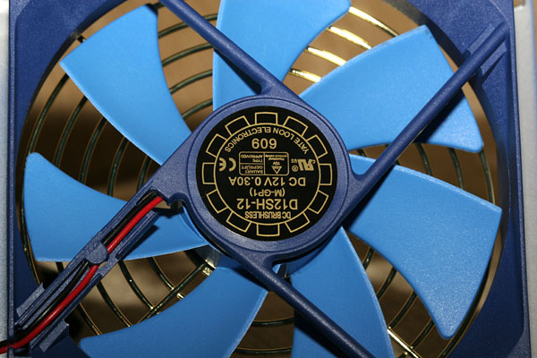

    Fortron Blue Storm II FSP500-60GLN
    notice untamperproof warranty sticker
    the side exhausts are very effective
    yate loon instead of protechnic. cooling is as expected quiet and good

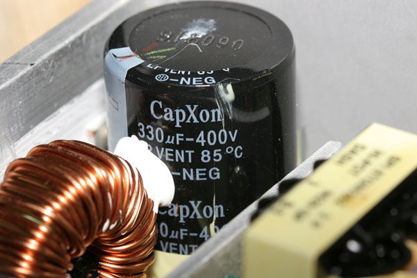

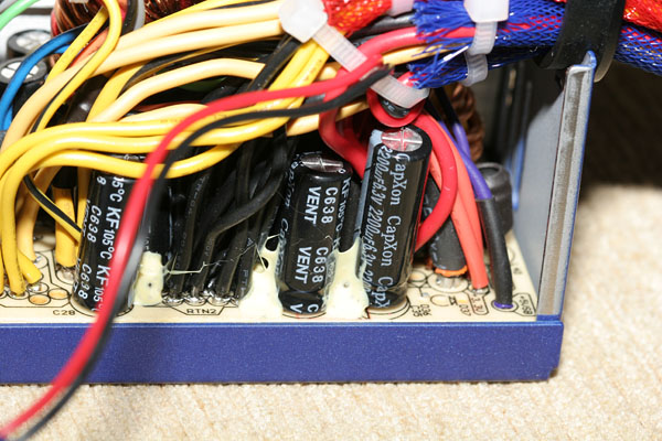

    Re: Fortron Blue Storm II FSP500-60GLN
    single capxon primary cos its active psu for the blue storm ii. actually i did a double take while looking at the box....
    all the secondary caps are capxon also. its an interesting change for fortron..

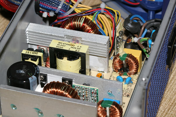

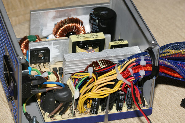

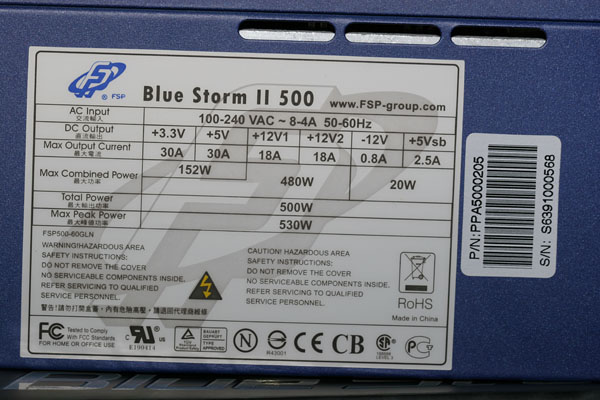

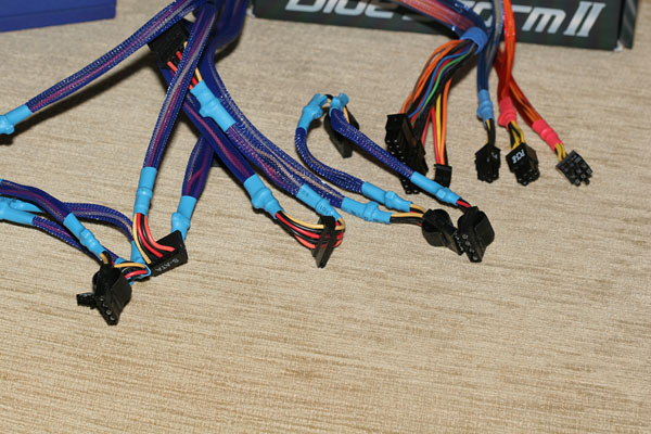

      pcb notes FSP500-60GLY not GLN like on the specs sticker. Anyway they call it "Fortron Green" and it is what the Zalman ZM-460APS is based on.
      i dont think you would need more connectors. it has 2 pci-e also
      last one - specs
        Not trying to be off topic.
        Here's jonny's review of the new Fortron provided Zalman 600W heat piped unit.
        http://www.jonnyguru.com/review_details.php?id=46
        He feels they changed the platform a bit because the Epsilon based units (OCZ) went out of ATX ripple spec near full load. The Zalman unit load tested very well indeed.
        So maybe this Blue Storm II is built on the same platform.
        EDIT: CapXon are used in this Zalman unit and all the smaller caps in the Zippy's I've opened up are CapXon also.
          I'm just glad to see a recent FSP that doesn't have OST caps on the 12v output
            dunno but this pcb only goes to 500w.
            here is the 400w Green
            http://www.silentpcreview.com/article280-page1.html
              It is the same GLY PCB like in my Amacrox Free Earth 500GLN. I wish i would have ordered the 550w version, as the higher wattage models are probably based on the Epsilon series PCB wich should be ready for up to 650w.
              All caps are Capxon too, but i have replaced some of them with Panasonic FM 1200uF.
              The only difference i see, the Amacrox does not have 2200uF caps on the 5 or 3.3v rail. IMHO there where only 1000uF 16v KF on all rails. IF i order new caps, i will loock for that, if there are no 2200uF i will change them to that value, as your units seems to proof, that a little more capcitance would not harm. But thois desing is not absolut silent, as airflow is the key to keep this unit cool. Any way, i have replaced the Protechinc Fan with an AC120mm fan, but iam not shure if this is enough airflow, but up to now it seems to be ok.
                Those are rather small heatsinks on the FET's and regulators for a 500 watter.... Compared to the Antec HE550's, which are 550 watts, and have enormous heatsinks... I just thought that's a little odd that the sinks are so small.
                  Oh, OMG.
                  Is it that 2200uF 6.3v in diameter 8mm?
                    yes but old epsilon pcb is not good design apparently. this one gets good reviews as far as i see but of course it hasnt been johnnyGURUed yet
                    same surprise with epsilon design. apparently fortron have designed for less heat, i will see how it goes. i think airflow is good though
                    i will check, i think so. There is some space for recap as they designed for 10mm in those positions.
                      Nice to hear that.
                      Fortron is SPI OEM factory, SPI is very famous in the past(P3 age) at our side, but now have many brand of nice power supply for selection here, lol.
                        The PCB is not the problem here for recaping, the cables are.
                        Those small heatsinks are ok, as the whole PSU is desingt to have an unrestrikted, high airflow. The culprit of this desing is, that you can`t get those PSU`s to absolut silent, but on the other hand the noise is lower than most other units. It is mostly the air exhaust itself wich generates the noise. Seasonic and Antec have choosen the other way, wich means large heatsinks and medium airflow. So they can reduce the airflow significantly at lower loads but at higher loads they have the same problems as the large heasinks cause audible disturbances.
                          In all this, CapXCon caps seemed to have acquitted themselves rather nicely. I have not heard till date of any mishaps related to blown caps on the Bluestorm series. It has been what two years since the Bluestorm was released?
                            Well, i would not expect an early failure from the Capxon. I would assume, that they will fulfill their spec.
                            I personaly have not had any trouble with them. Shure, they are not a superspeced ultral low esr cap, but they work. IMHo there is no need for those LOW esr values a Panasonic FM would provides in a PSU. But that dosen`t held me off in replacing them all with FM`s with a little higher capacitance (1000uF >> 1200uF) in my Amacrox.
                            Only the 12v caps where not easy to replace with 10mm caps. therefore only two of four are replaced with 1500uF FM`s.
