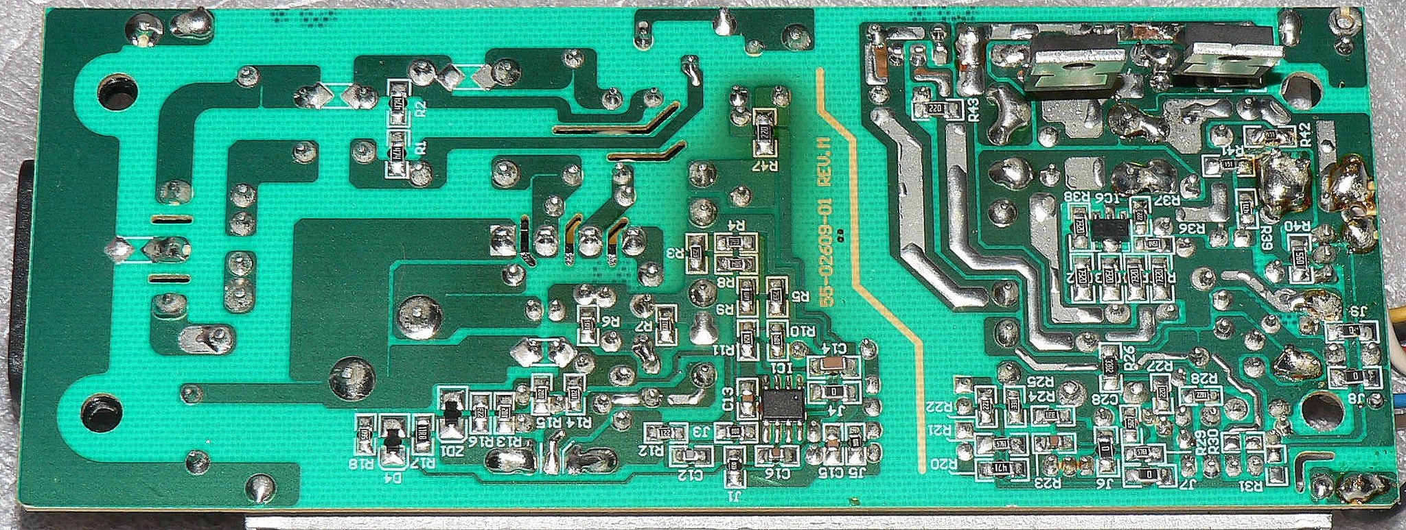

    I got this Dedicated Micros VS-PSU65W-EXT power brick. it is supposed to have three output voltages (+5, +12 and -12 V). When I got it, it squeezed and had almost no outputs (maybe some tenth of volt).
    It seems there is no real ground rather than it has flying ground, that possible? The +5 V output rectifiers (FMB24L) showed aprox. 40 on diode tester. I took them out, it still shows 40. But I think they were partially opened anyway, showed 96-99 on the internal diodes, good shottkies show around 140.
    I have swapped them with MBR20100CT, now it still squeezes but I got something, aprox. +1,8 V, +4,4 V and -4,4 V. All other semiconductors (diodes, rectifiers, one zener) measure fine.
    I took out one ceramic cap, thought it may be open, it checks fine, however, now the +5V measures 43 or so against common. There is one other cap, small blue, it may be open maybe? Other than that, I do not know what is wrong. Caps are good, Chemi-Con, all measured good (in circuit). Is it possible the secondary transformer winding is shorted? Or may optocouplers be bad?

      The resistors and those diodes near D2 ? Also, which is the controller ?Could it be the startup cap is failing ?

        rogfanther: what about them? Not sure if it even has a startup cap, it uses Fairchild KA3882 PWM controller. There is only small cap to filter it's input and that is most likely NCC KMG.

          Since all the output voltages are only 36% of what they should be, I also then suspect start up cap, something like TL431 ref diode, opto in the feedback.
            Re: Power brick squeezes, low output voltages
            Seems that you can't even believe te Chemi-Con these days. KME 47 uF/25 V, measured 0,1 uF/25 ohm in circuit, out of circuit the ESR mciro does no even read *anything*.
            Works liek charm, thanks guys, I would not even think about Chemi-Con getting bad…

              I probably would not suspect Chemi-Con either, but in similar psus from D-Link network switches, its almost always that small cap that fails.
