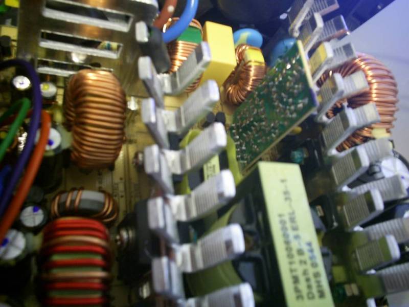

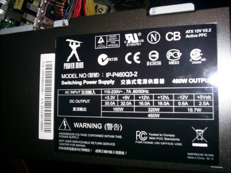

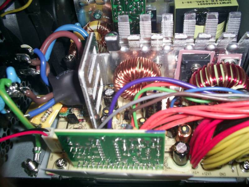

    IN WIN(PowerMan) 460W
    Model: IP-P460Q3-2
    OST galore! Not a good thing, but are they better or worse than the Fuhjyyu in my dead Antec?
    This PSU is supposed to have an efficiency of 75% and features Active PFC. For cooling it uses a single 120mm intake fan but no exaust fan, which I will be adding before I fire it up.

    Re: IN WIN(PowerMan) 460W
    OST is better than Fuhjyyu
    • Galvanized
      • Mar 2006
      • 468
      The most difficult area to get cooling air to is next to the solid front panel of the PSU. That is one of the reasons Seasonic has installed an aux 60mm cooling fan, as an intake, in this area on thier new M12 series of PSUs.
      If an 80mm fan is attached to the exhaust grill it will divert air from the front of the PSU...I think so anyhoo.
      I would just make sure the stock 120 cooling fan is ball bearing and puts out atleast 75cfm @ 12V. The amperage spec on the fan should be .34~.38A.
      Make sure the wiring harness does not shield the caps under too much from cooling air.
      On PSUs that use an 80mm exhaust fan I will install an 80mm @ 30cfm to the intake grill, right next to where the harness exits. No cutting involved.
        Ost are ok, but they shure won`t last forever. IF keept cool, they should be fine, other wise not. I personally replace Ost caps too, in my PSU`s. From some topic`s hear, i have learned, that some of the lower wattage S12 Series PSU`s from Seasonic have problems with Ost`s .
          i have some fortron with same. still ok though
            Well, my Fortrons are all ok, no problems there. But they usually have some Teapos, Jamicon and Ost. The Teapos are failing, if not enough airflow, the others have no visible sign of failure. Any way, my FSP350THN-P is now equiped with Pnansonic FM for the most parts.
