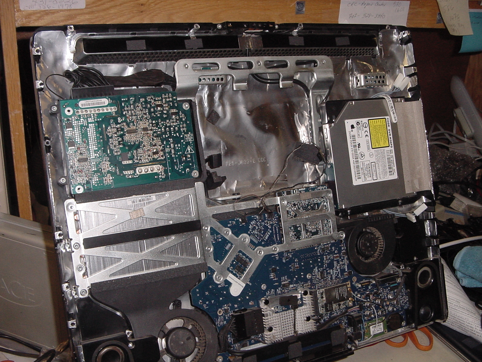

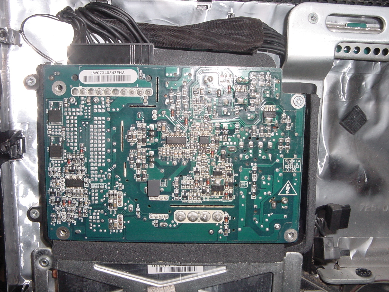

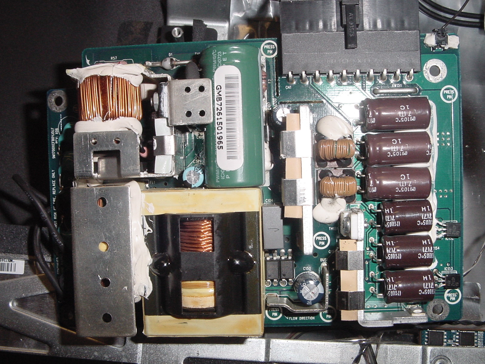

IMAC 12V Power supply

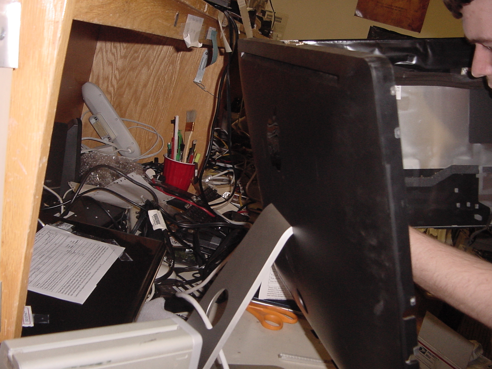

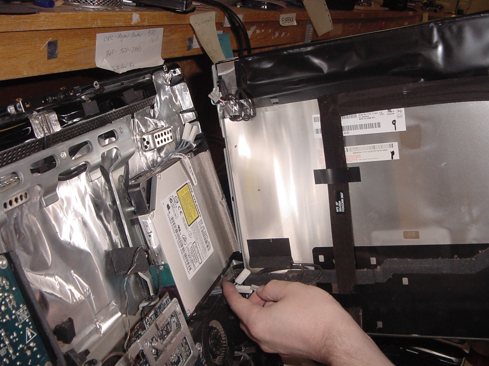

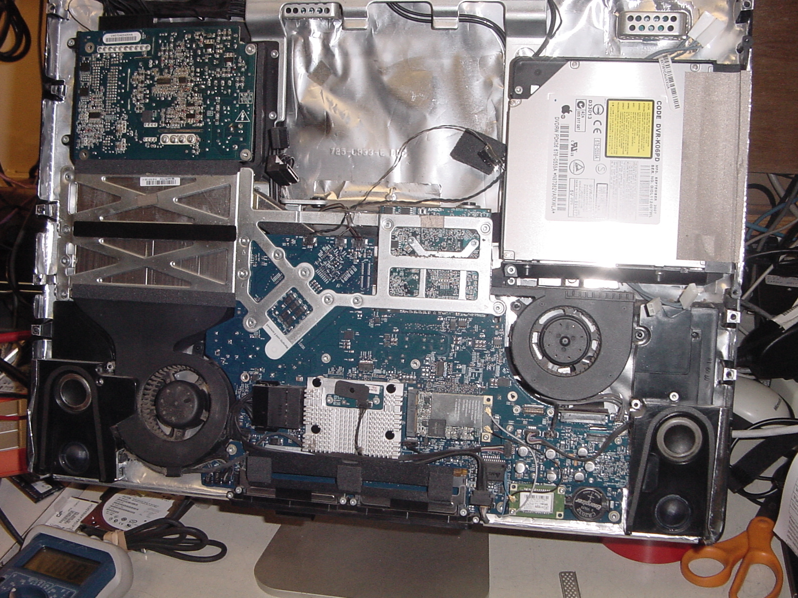

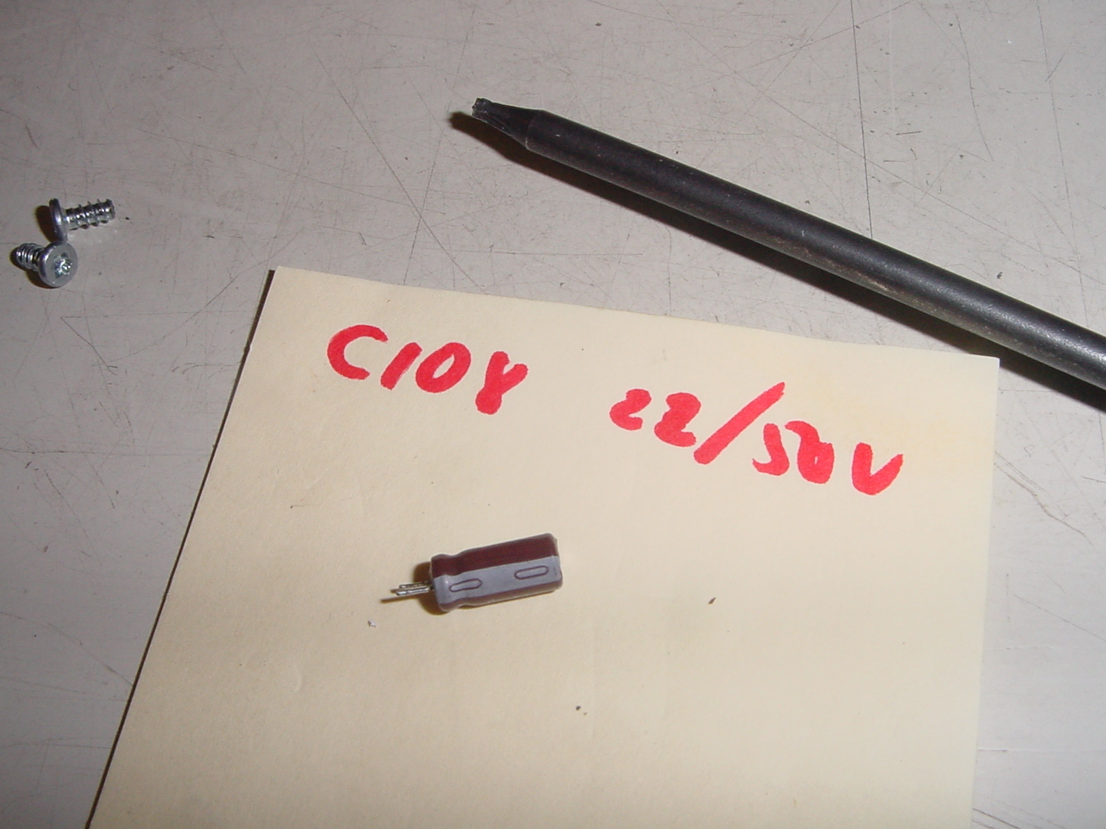

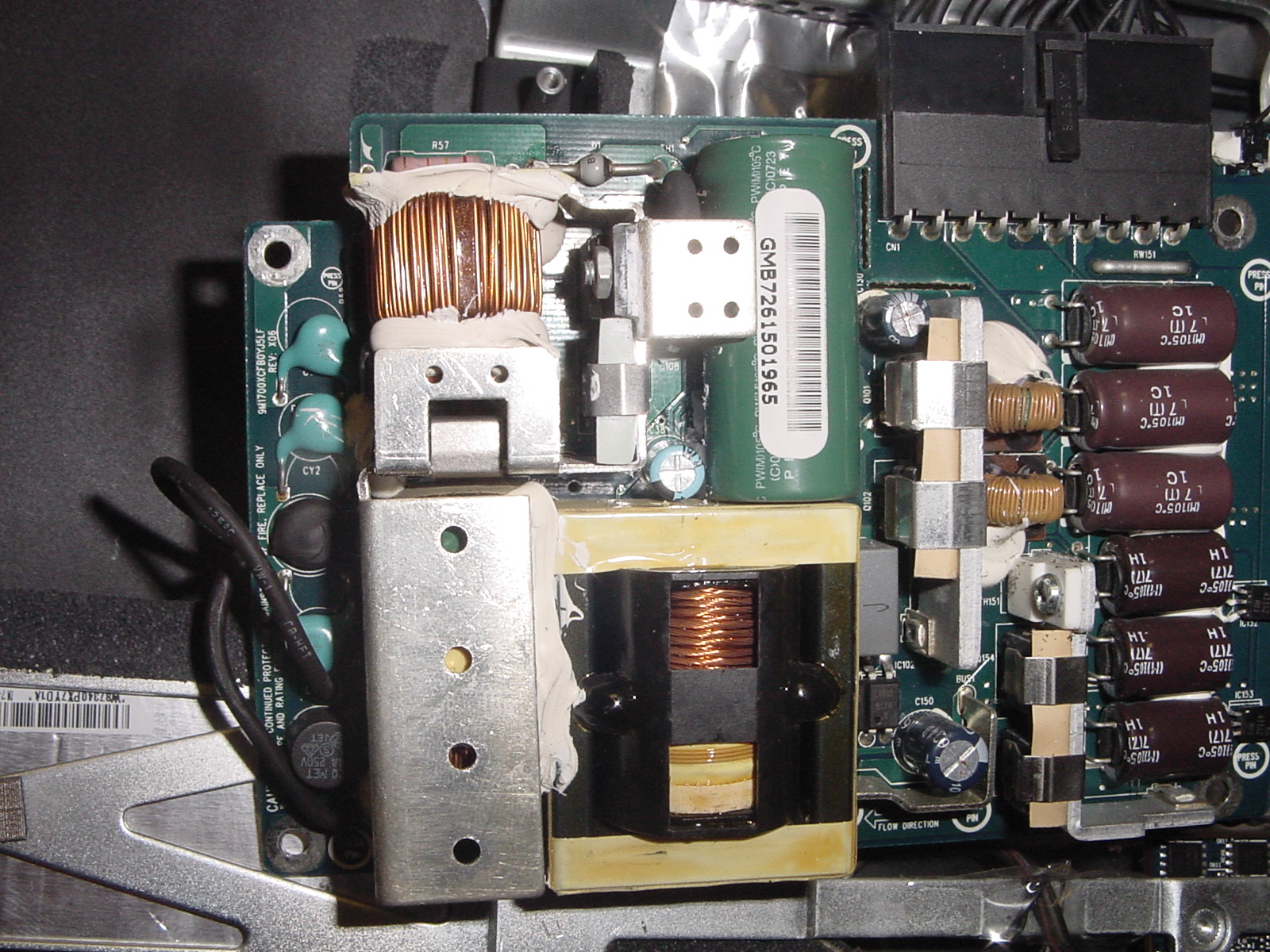

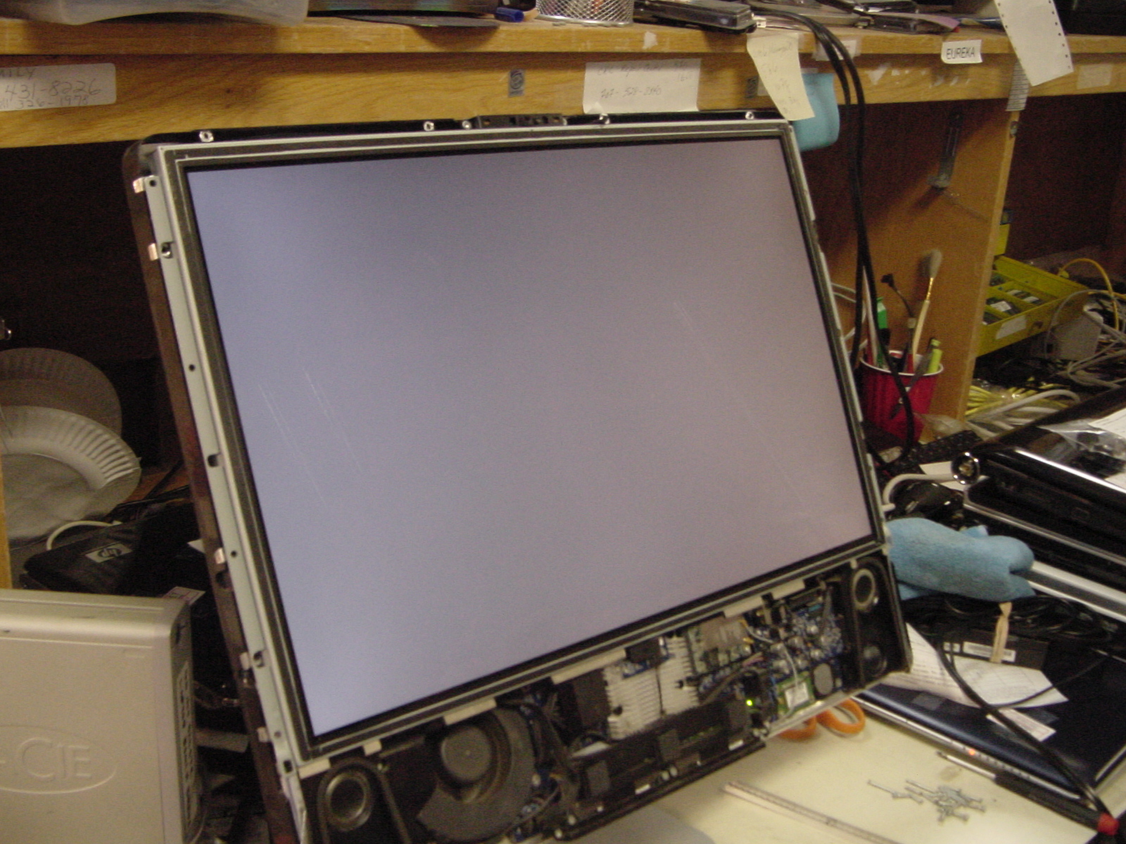

The 12v power supply out put was not steady, going between 9~12v, LED on the main board was blinking, this is due to bad start up cap c108 (22uf 50v).Never stop learning
