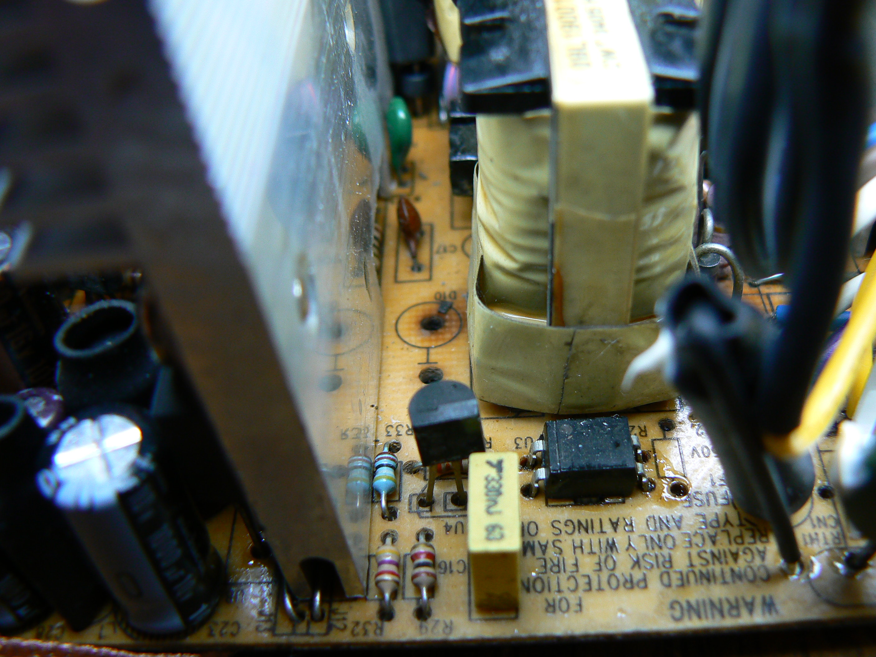

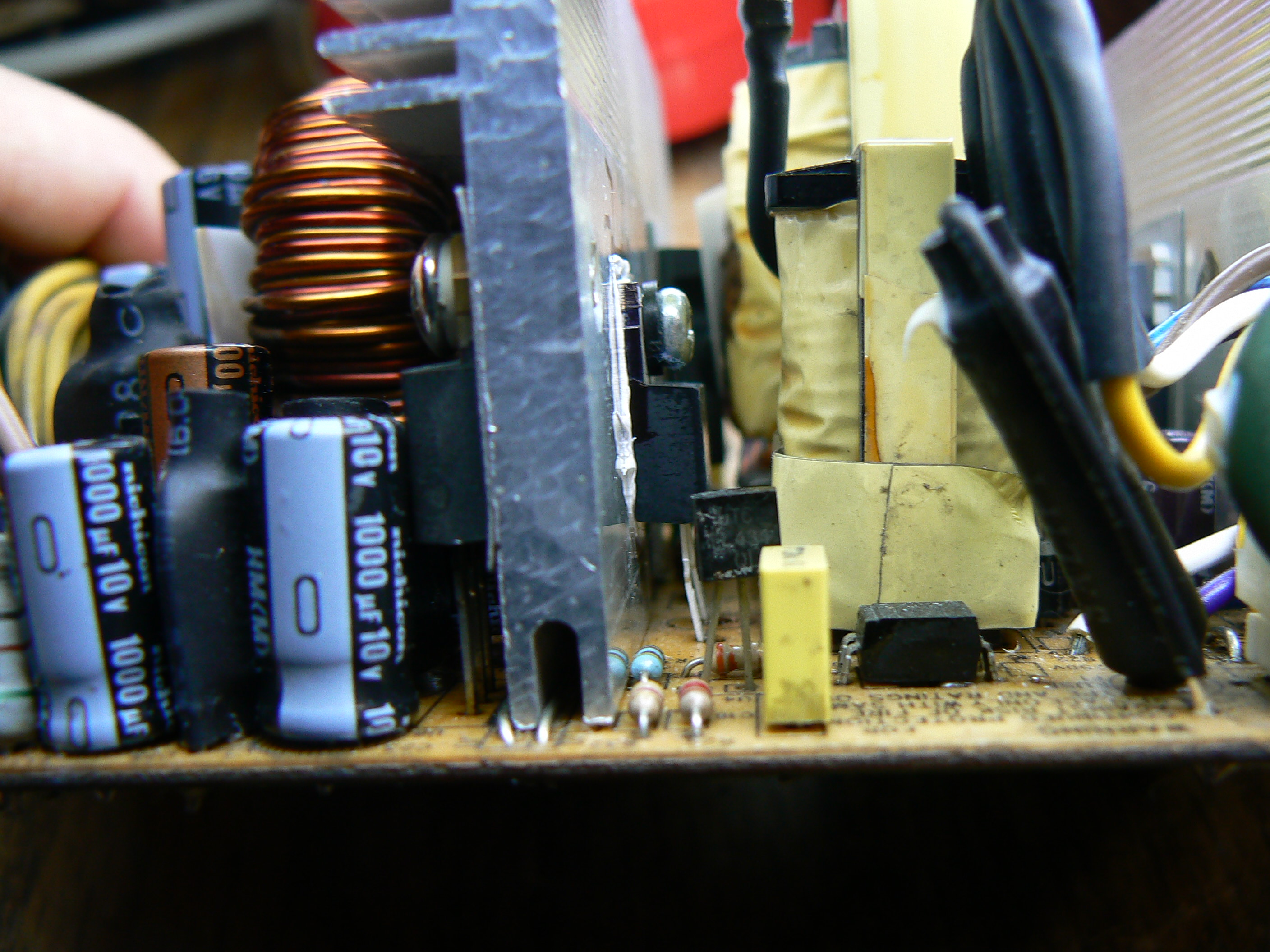

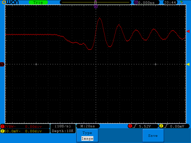

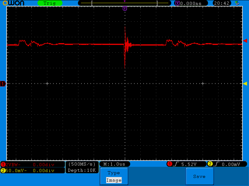

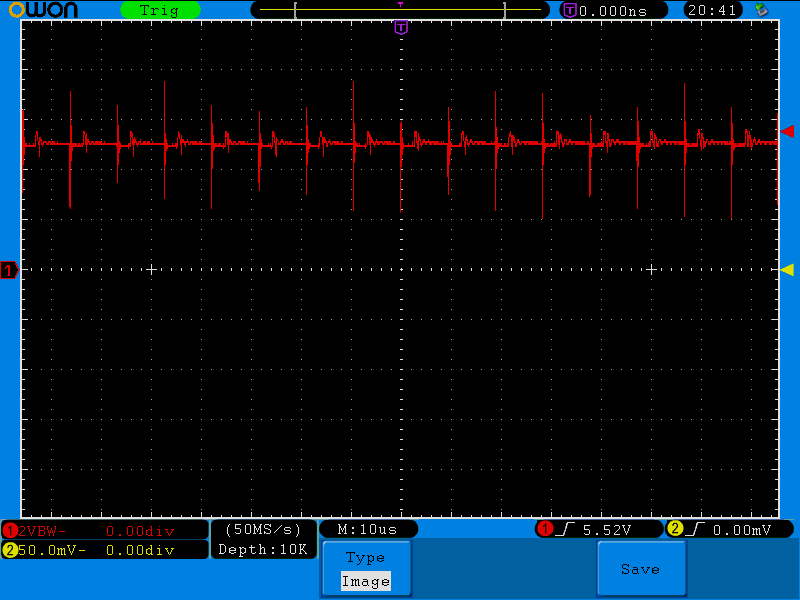

I got around to changing out the 5vsb current sense resistor last night. It turns out the original one was marked as 1 ohms and actually measured 1.3 ohms on my DMM so it really was 1.1-1.2 ohms. The largest value resistor less than 1 ohm that I could find measured 0.24 ohms on my Blue ESR tester. Using a DMM on a resistor value this low is pointless which is why I turned to the ESR meter.
I did not know what if anything would happen using a value this low as a replacement but since I could not find anything else I decided to go for it. I also went from a FQPF4N60C to a FQPF5N60C for the FET. I wanted to go bigger but I needed a FET with full length leads to reach through the holes and this was the biggest I had on hand that did not have the leads trimmed.
I mentioned in post 2 that I could hear a slight whine from the 5vsb circuit before when it did not have a load. Well, when I turned it on this time there was nothing slight about it. At this point I did not have much time to mess with it or write down numbers but the 5vsb voltage was slightly lower than what I had been seeing previously. I started adding load 10 ohms at at time in parallel all the way down to 2.1 ohms. Each load resistor changed the sound as it was added, but never eliminated it.
I guess the big question is if it will hurt anything to run it like this for testing (if I can stand it) or will it damage something?

I had ordered some 7N65C to use for the 5vsb but I had forgotten that I decided against using it when I swapped out the resistor a few weeks ago. (It was a while before I got around to doing these tests.)
It is also a good learning exercise. I was able to trace out and modify the two transistor 5vsb and then discover where the other weak spots in the circuit are located. So after I get a better diode I will then see what pops next. If I melt down the transformer, I may try my hand at winding a replacement or just move on to another supply which I will torture back to the death from which I previously revived it like I have done with this one. Also one thing this experiment does prove is that you can get more from a 5vsb circuit using an IC to drive a FET than you can using a one chip PWM like the DM311 or Viper22A, etc. and the heat is better dissipated because the 5vsb FET is already attached to a very large heat sink.
