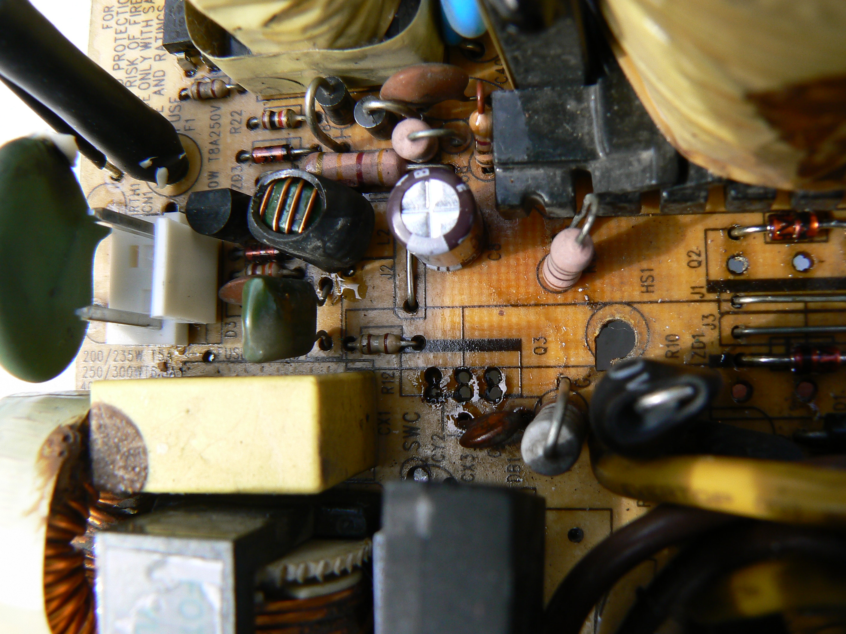

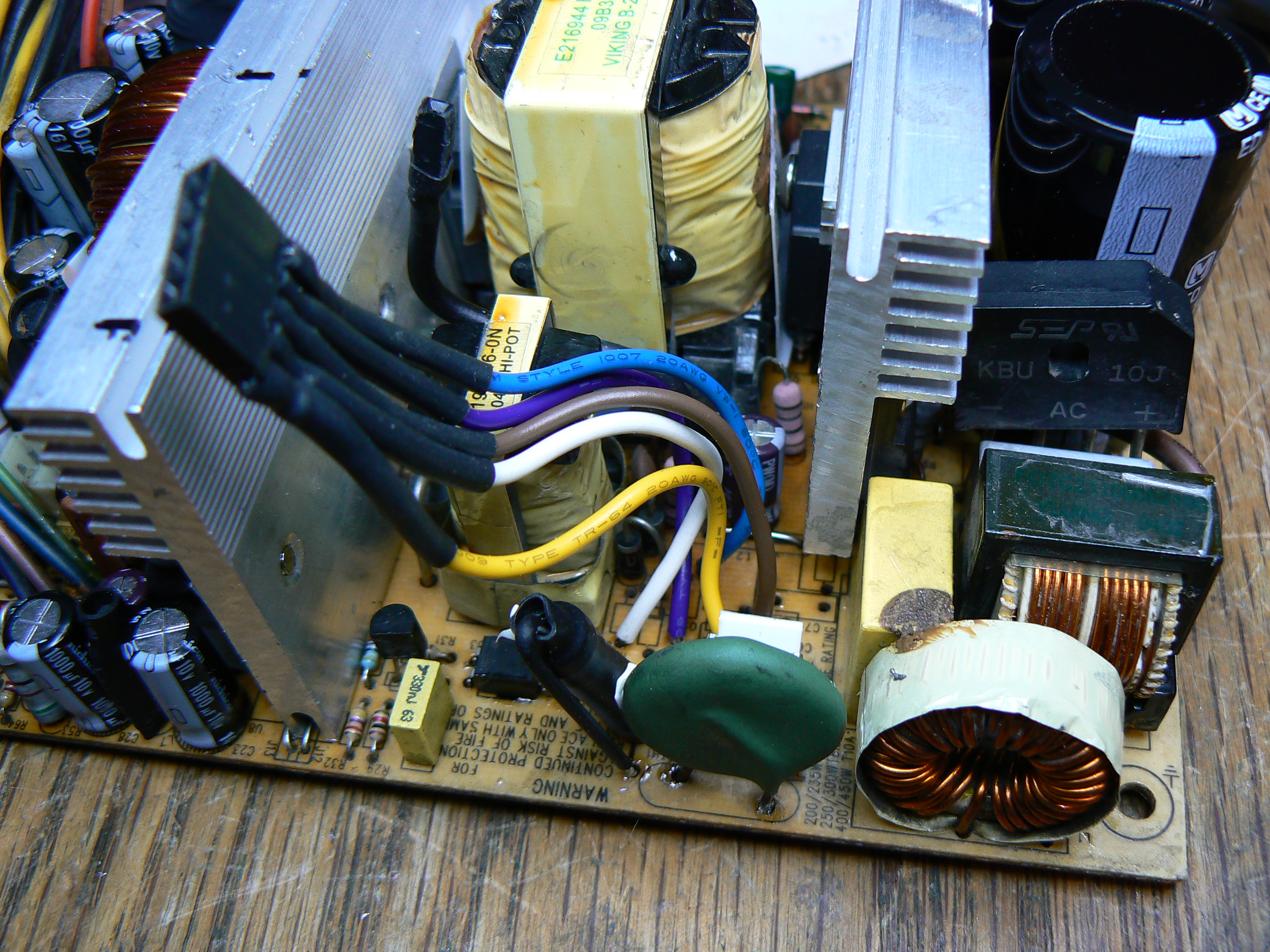

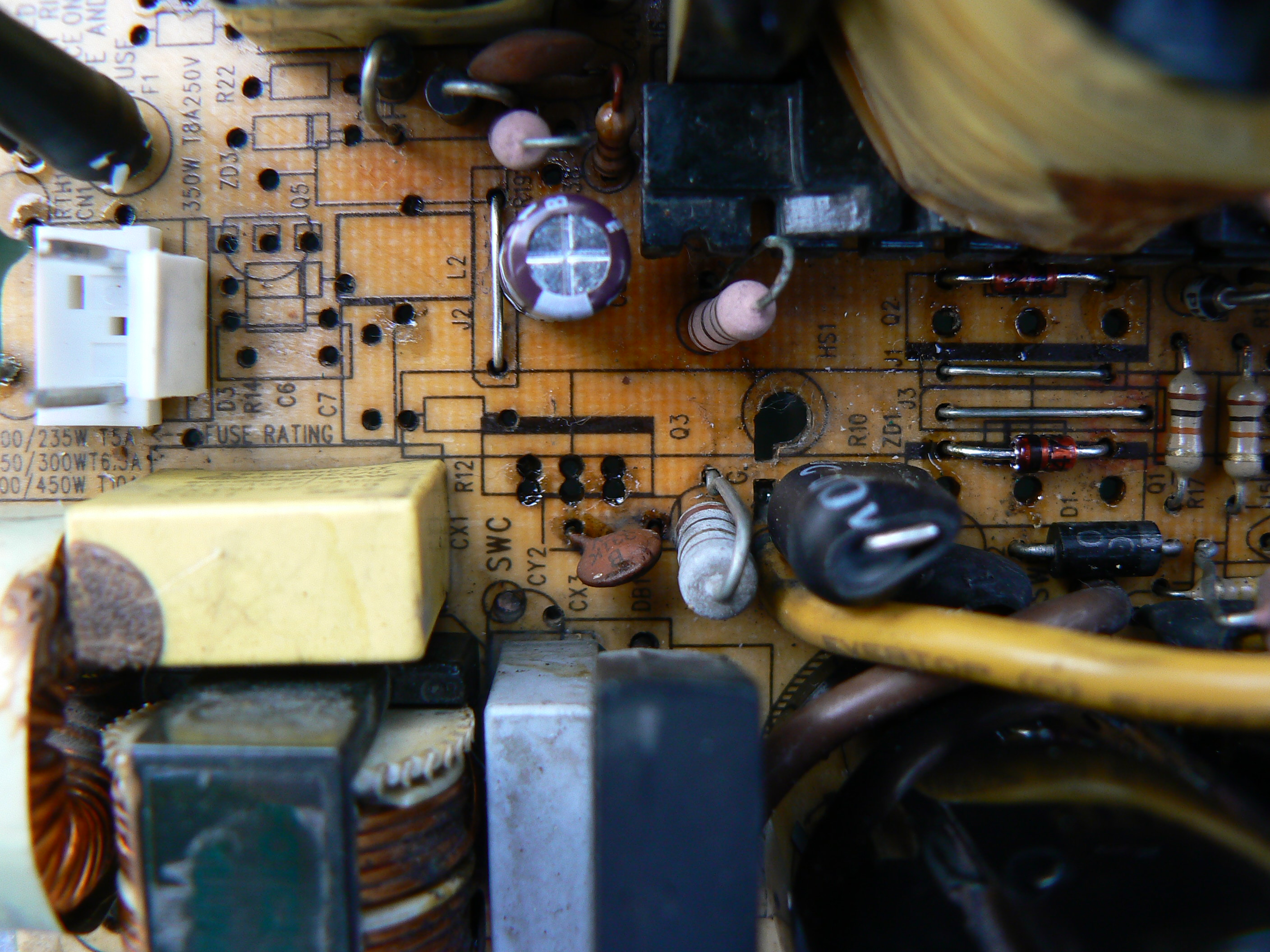

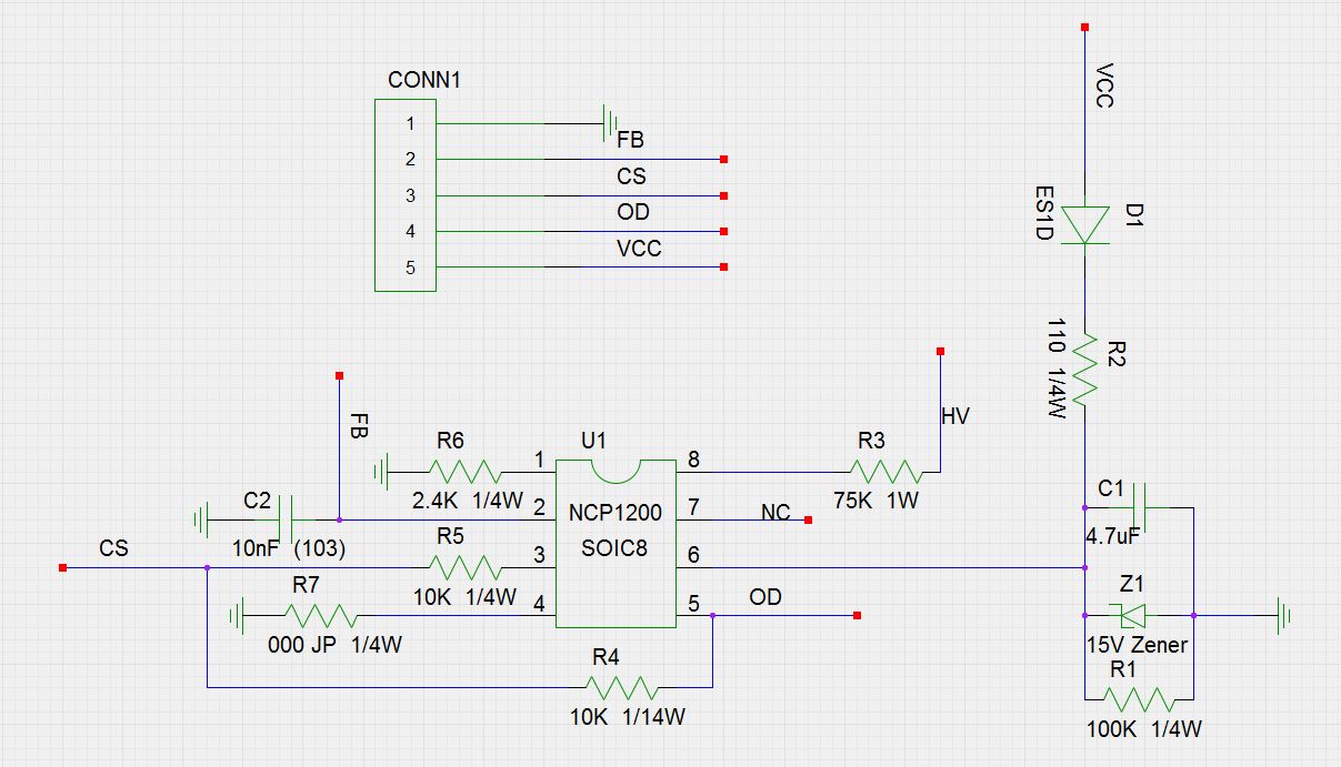

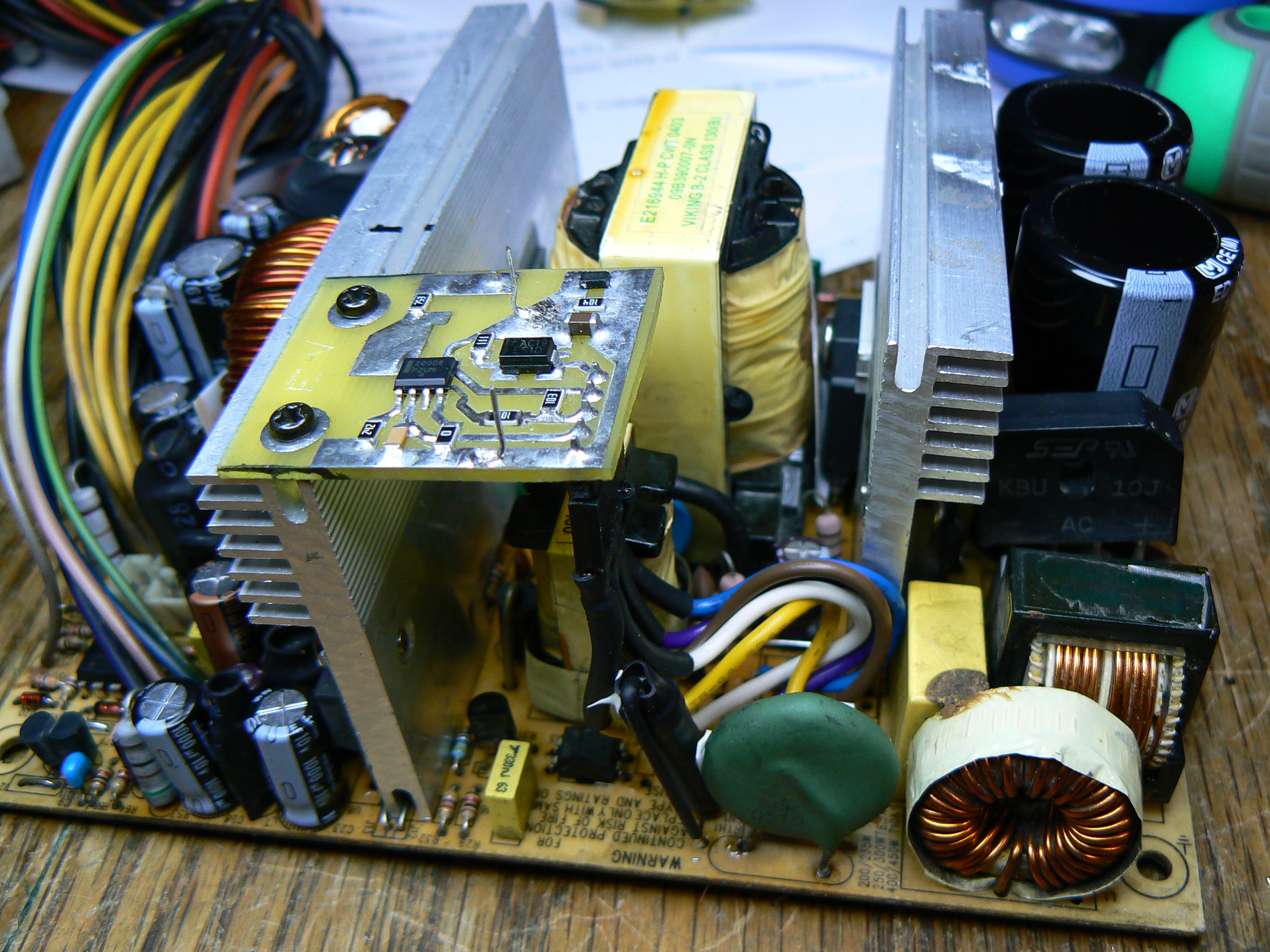

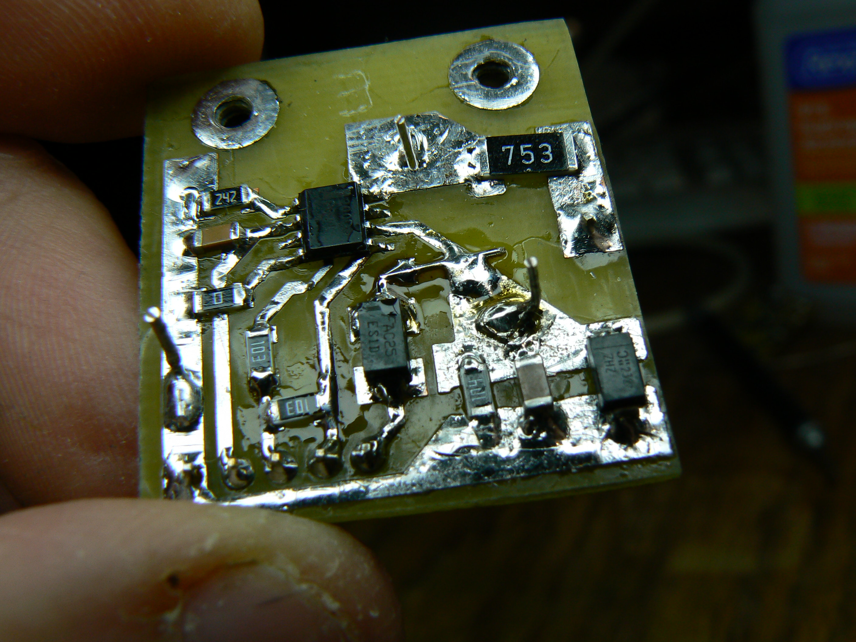

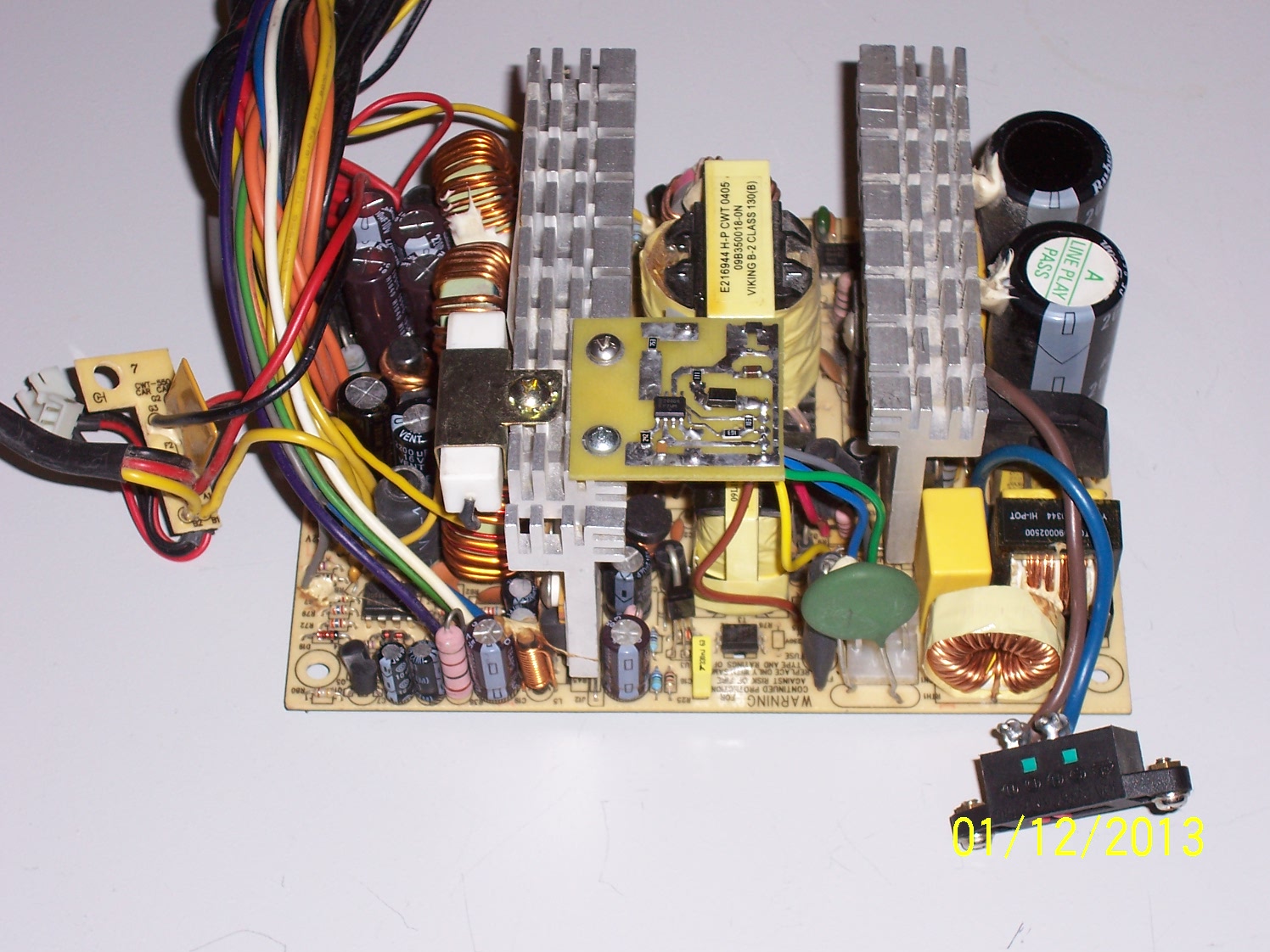

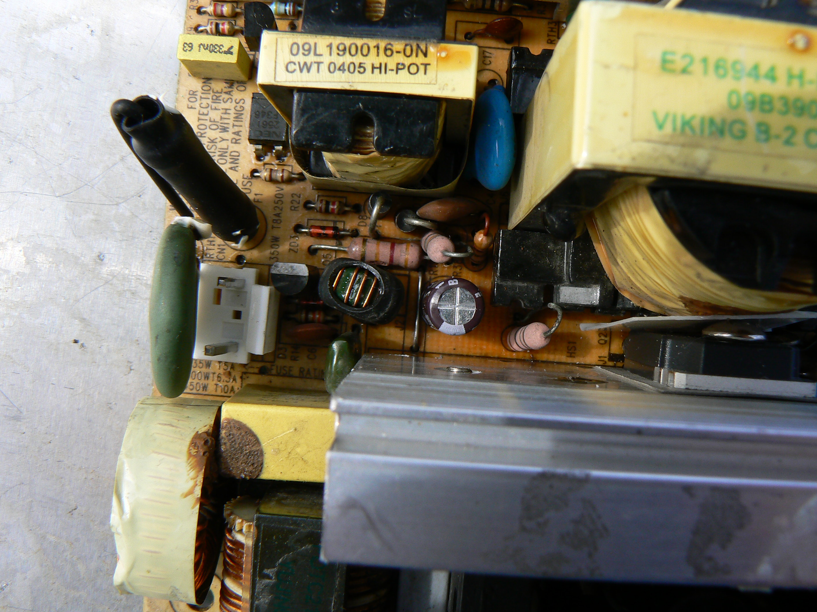

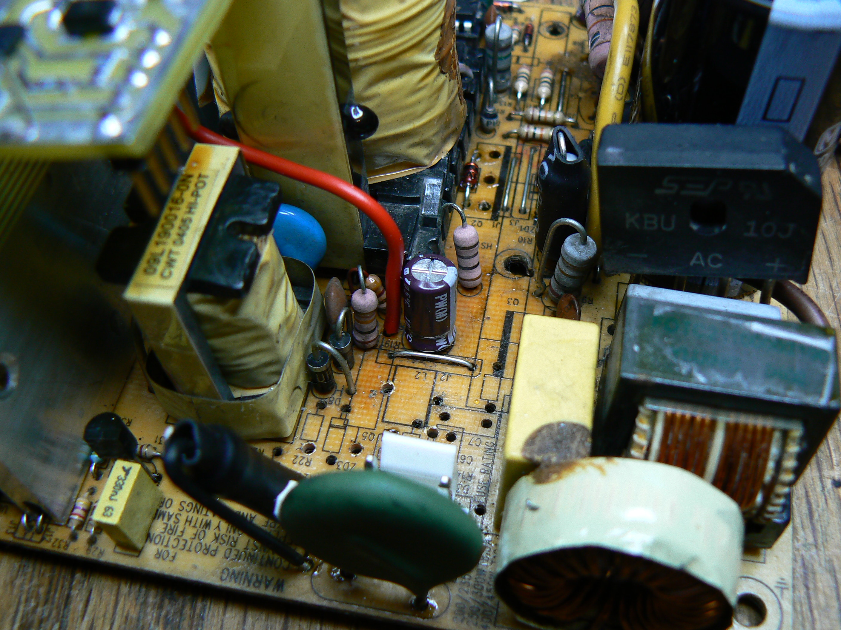

    This SL-400 is one that I recently resurrected in another thread. The entire reason I rebuilt it was to experiment with it in various ways. One of the things I wanted to do was to get rid of the two transistor 5vsb and replace it with something better. Although the Viper22A is an option it has several drawbacks especially in a surface mount package which I wanted to use for this project. Everell had found the NCP1200 driving the 5vsb FET on a power supply that had a 5A 5vsb circuit. If this chip would work it seemed like an ideal solution.
    I removed all the components that would not be used with the NCP1200 circuit. The big difference in this modification and the Viper22A mod is that the 5vsb FET attached to the heat sink will be used. I am attaching pictures of the power supply before, during, and after modification. I will make another post with the load test results.

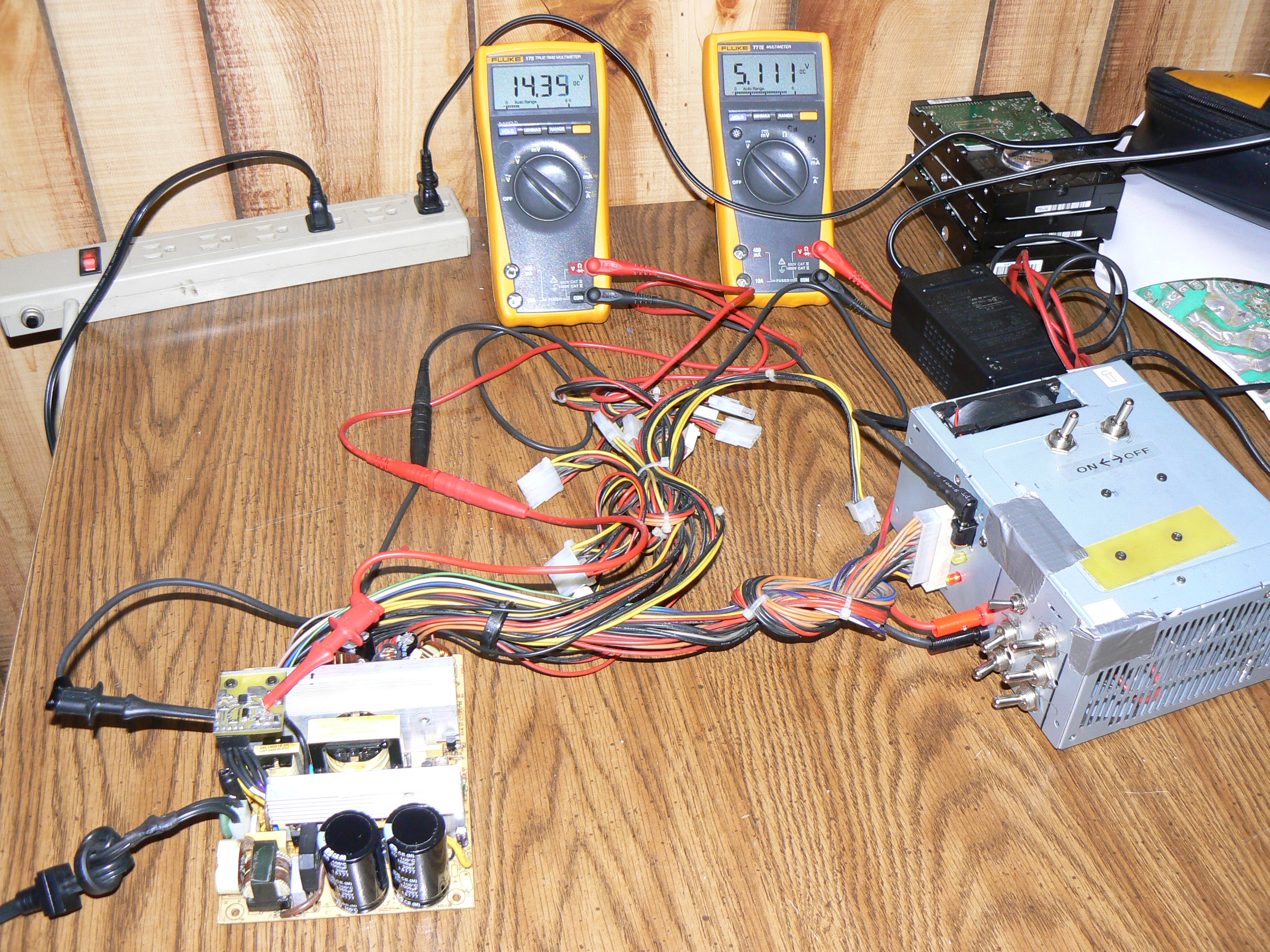

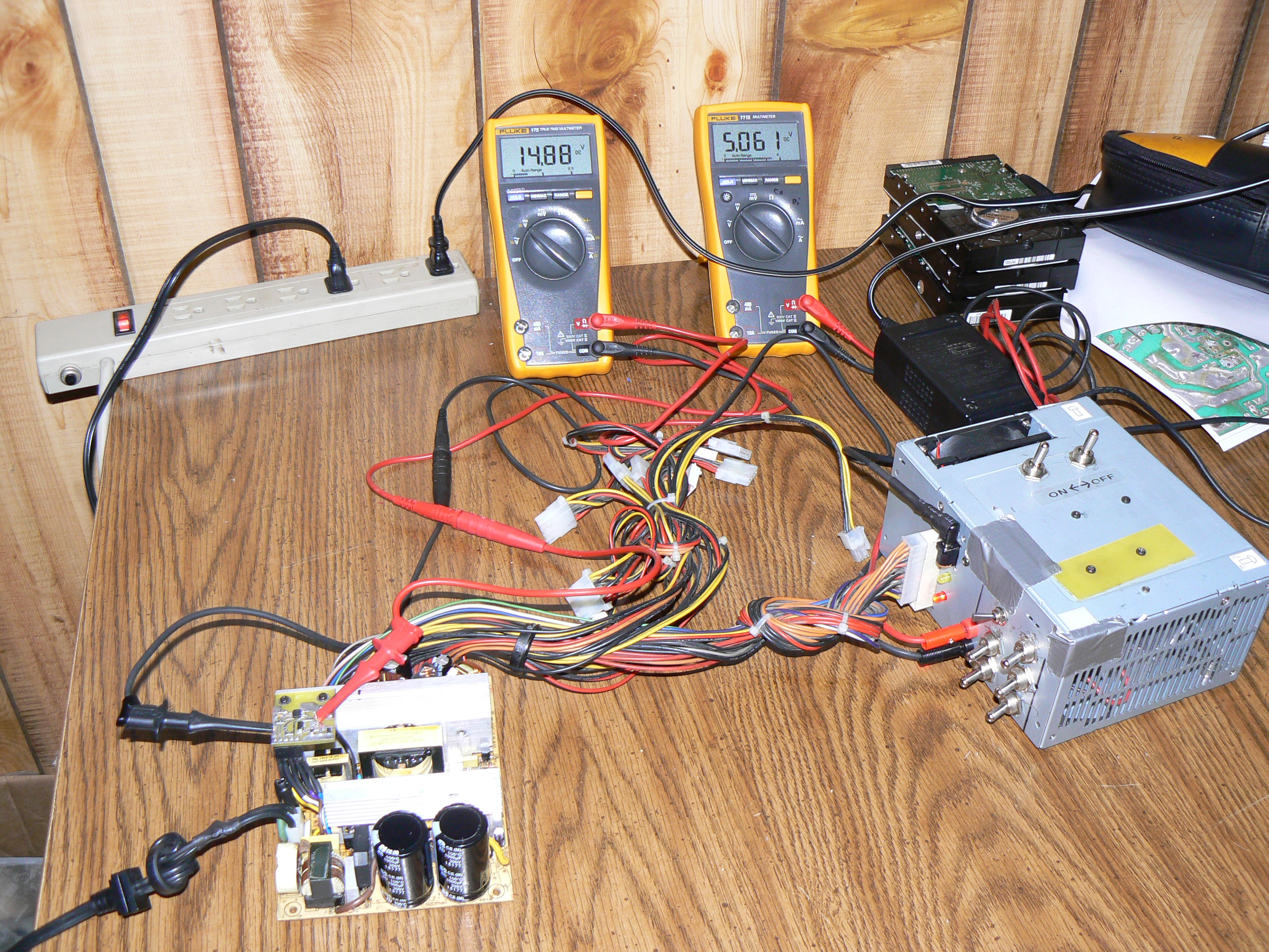

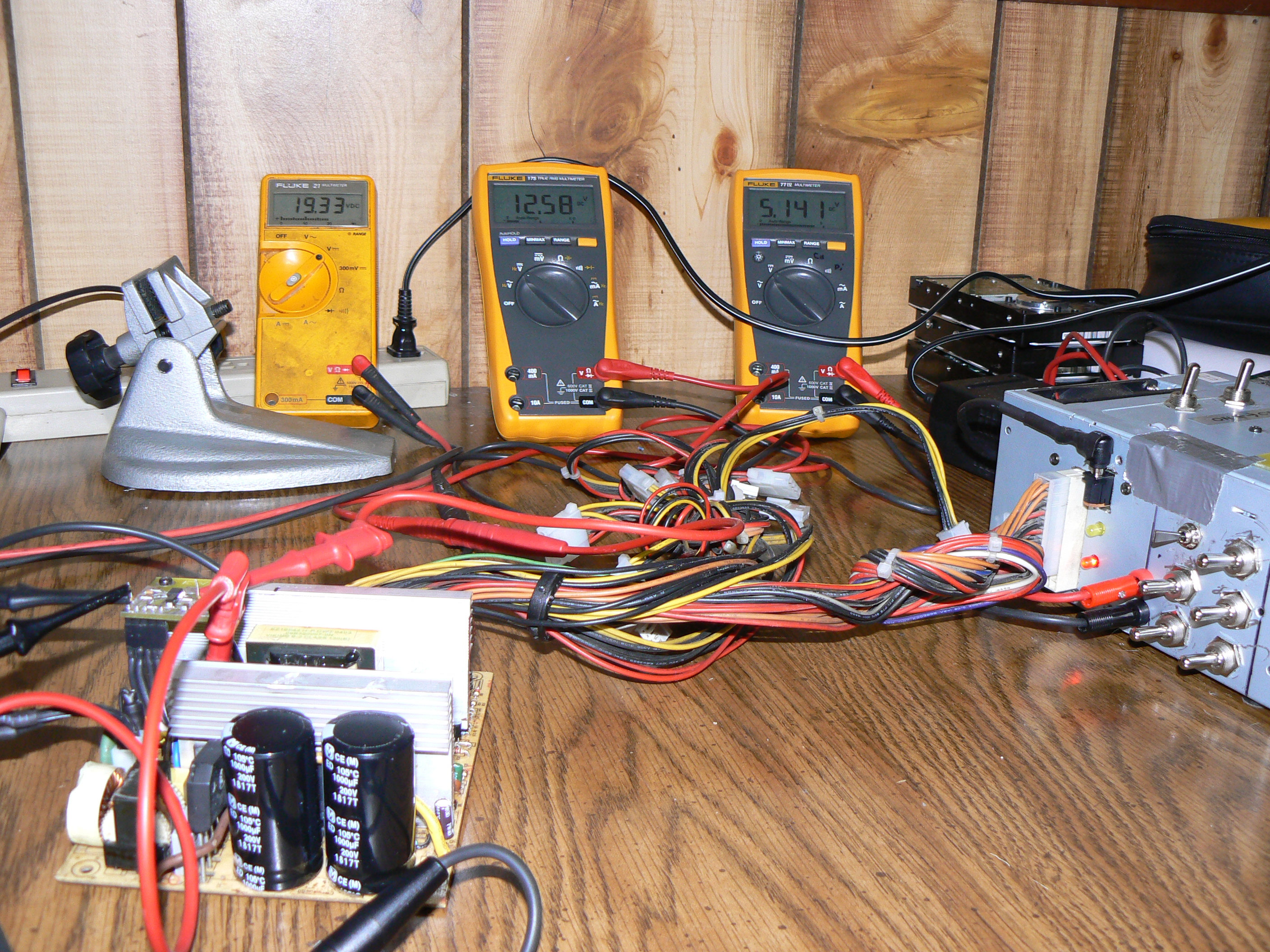

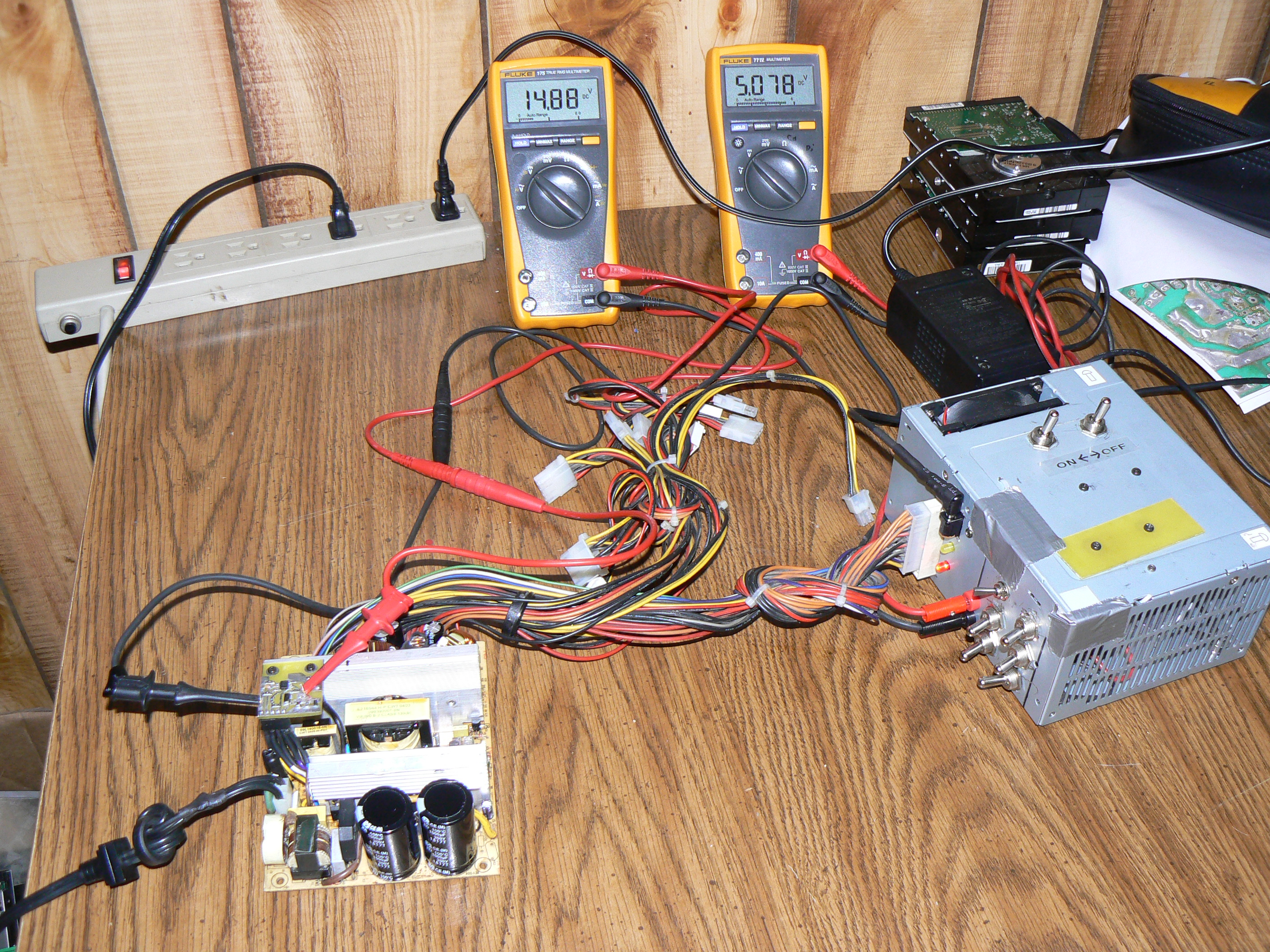

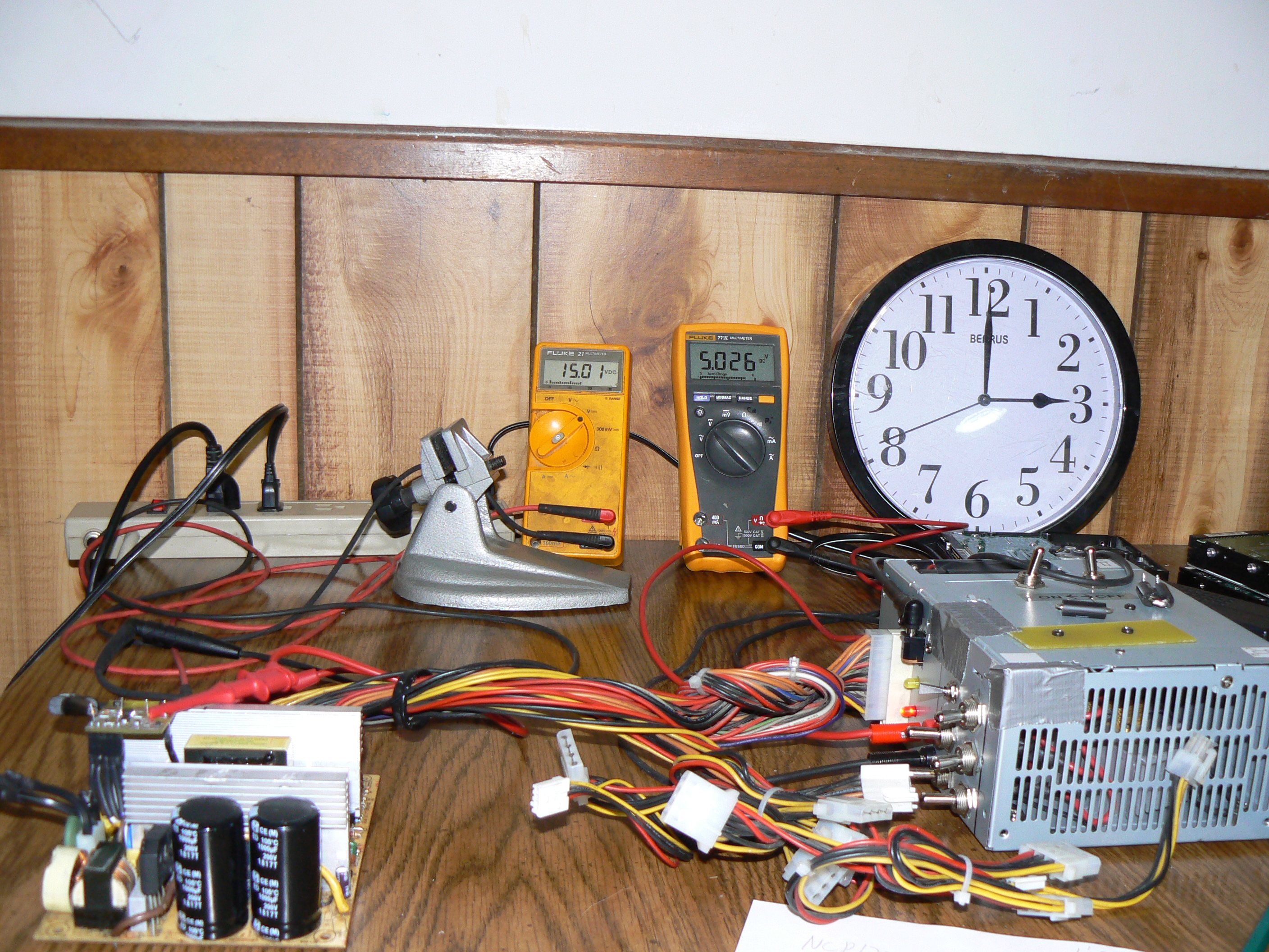

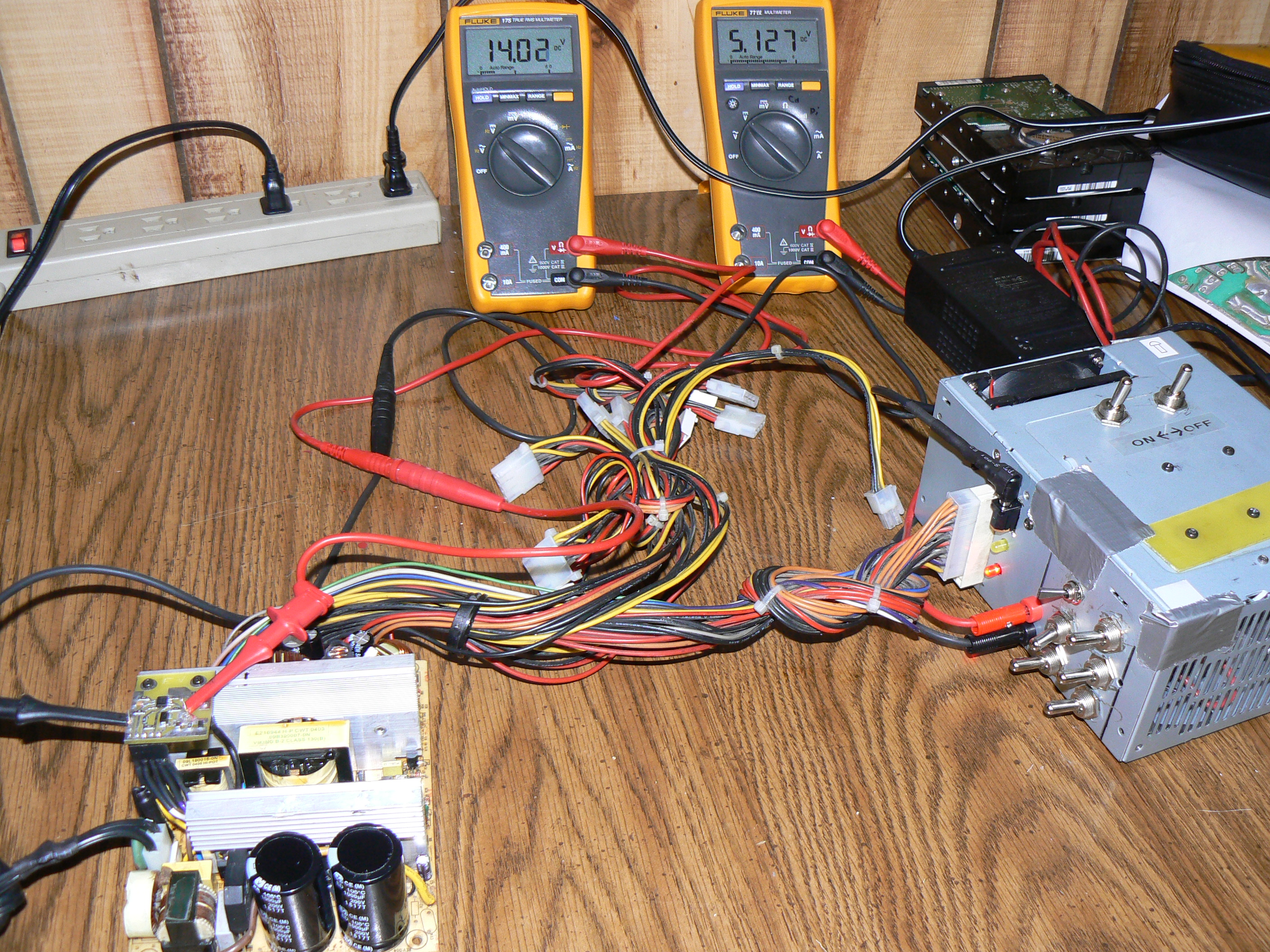

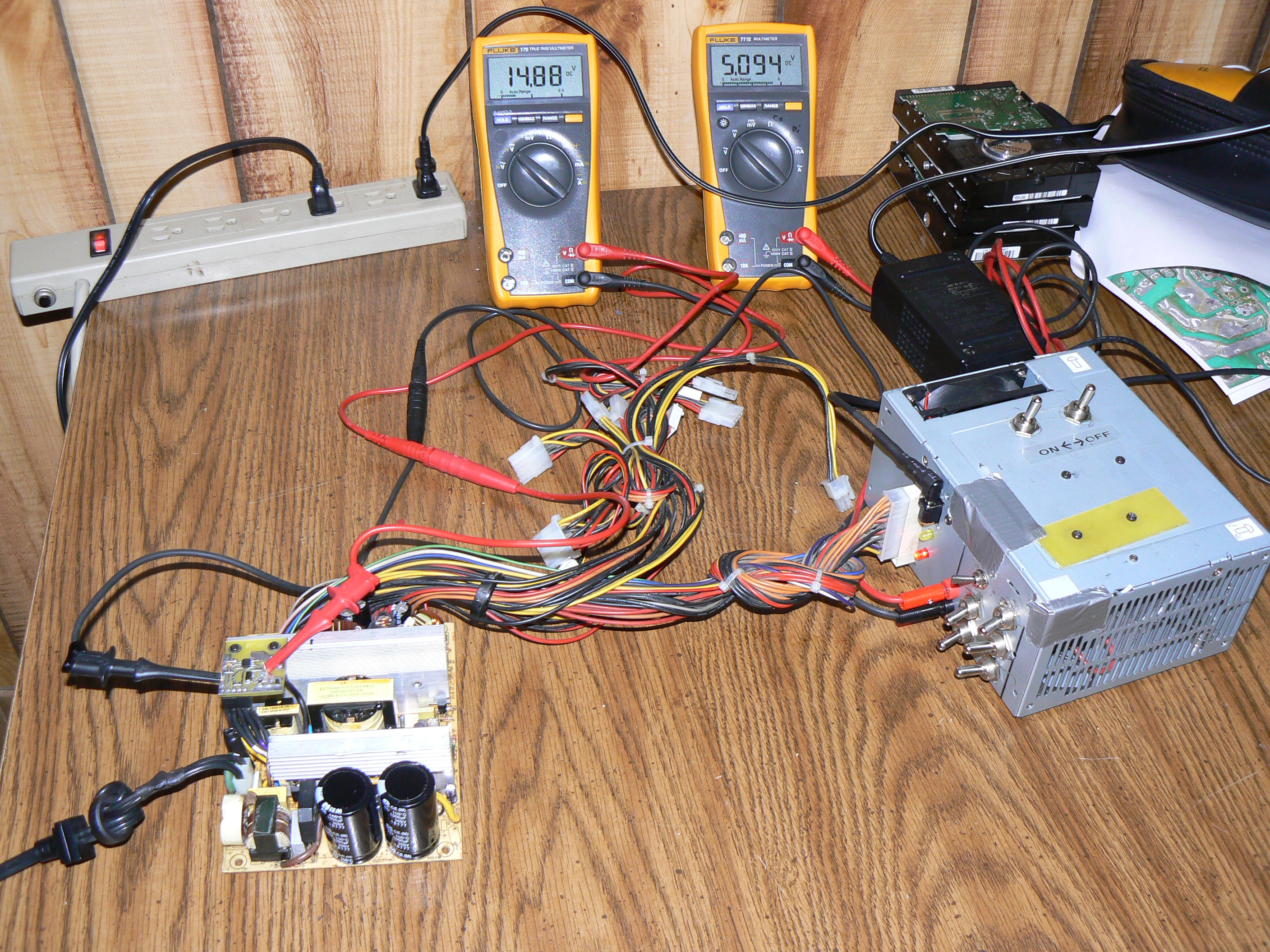

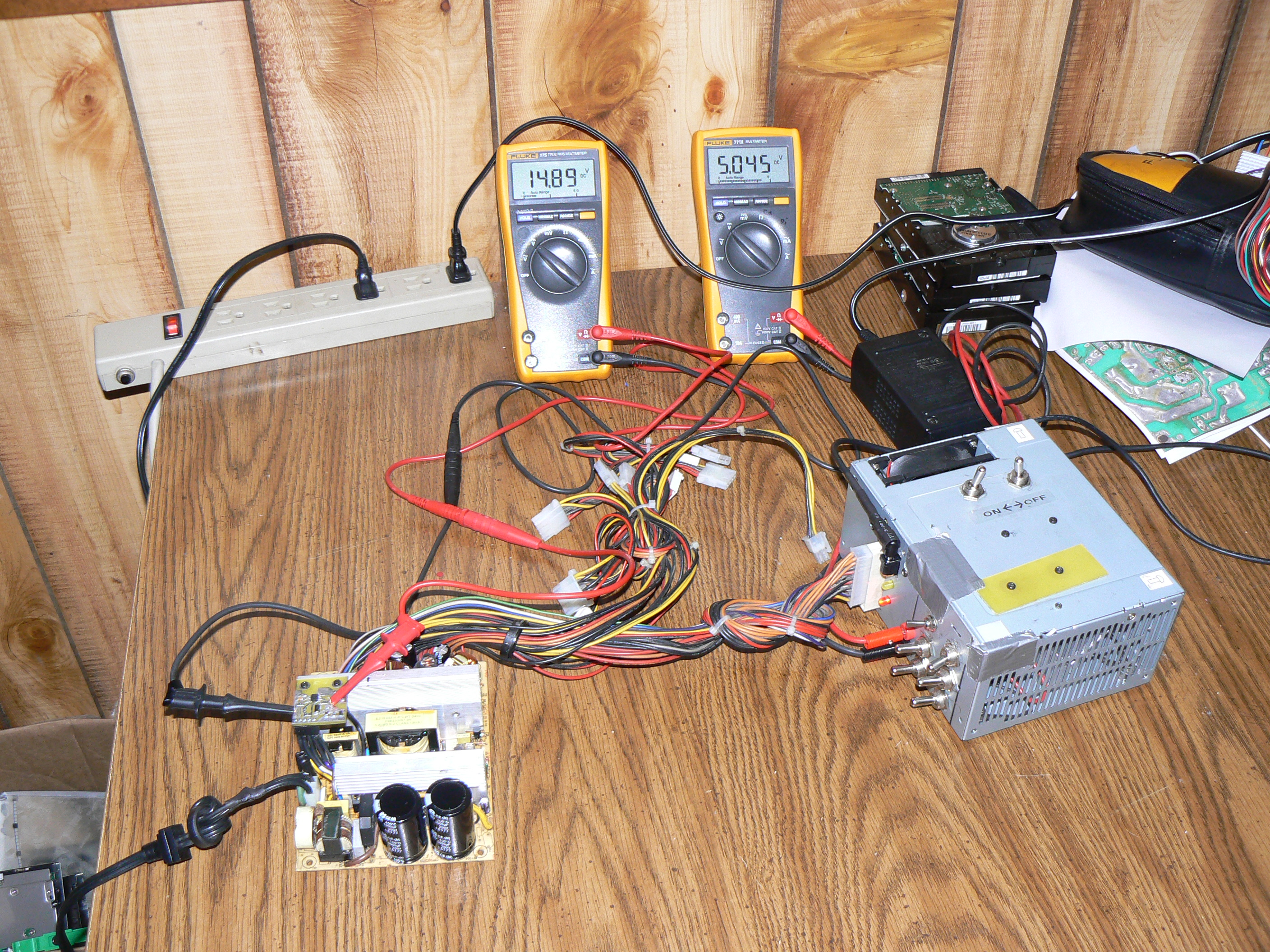

    I just got this working tonight so I only had time to do some quick initial testing. So far the results look favorable in my opinion. I want to run it under a heavy load for period time when I get an opportunity but for now this is what I got out of it:
    No load -> Vdd = 12.55 <-> 5vsb = 5.143
    10.0 ohm -> Vdd = 14.02 <-> 5vsb = 5.127
    5.1 ohm -> Vdd = 14.39 <-> 5vsb = 5.111
    3.4 ohm -> Vdd = 14.88 <-> 5vsb = 5.094
    2.6 ohm -> Vdd = 14.88 <-> 5vsb = 5.078
    2.1 ohm -> Vdd = 14.88 <-> 5vsb = 5.061
    1.7 ohm -> Vdd = 14.89 <-> 5vsb = 5.045
    The Vdd is capped with at 15V Zener diode, as the max Vdd for the NCP1200 is 16V. One odd thing was that under no load I could hear a slight high pitched ringing coming from the supply. The ringing disappeared as soon as the first load resistor (10 ohms) was added to the supply. My load tester is capable of adding even more load but I did not want to blow anything up, at least not yet, I will save that until after I do more testing at reasonable loads.

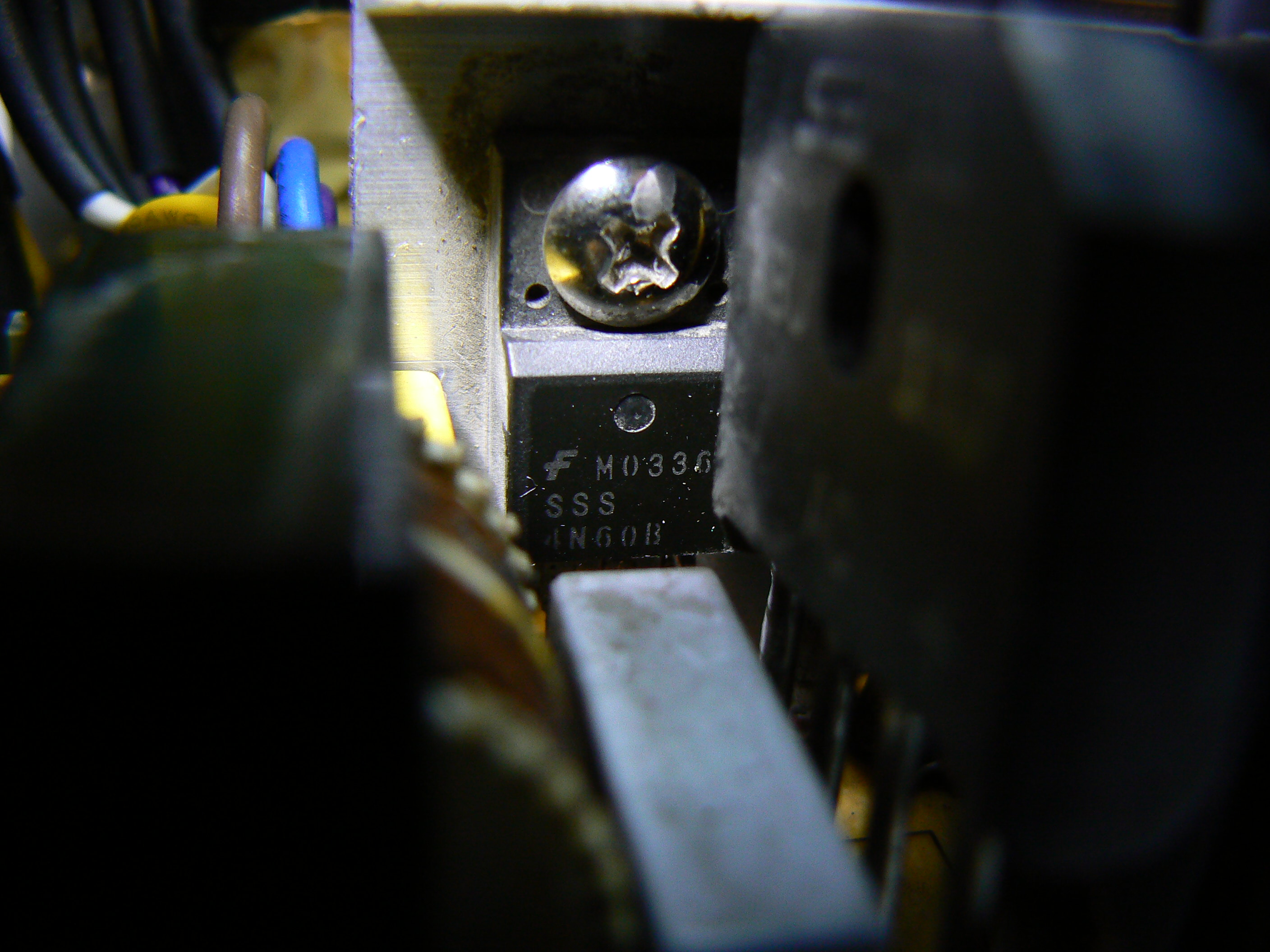

      What kind of transistor is the NCP1200 driving? Bipolar transistor or FET?

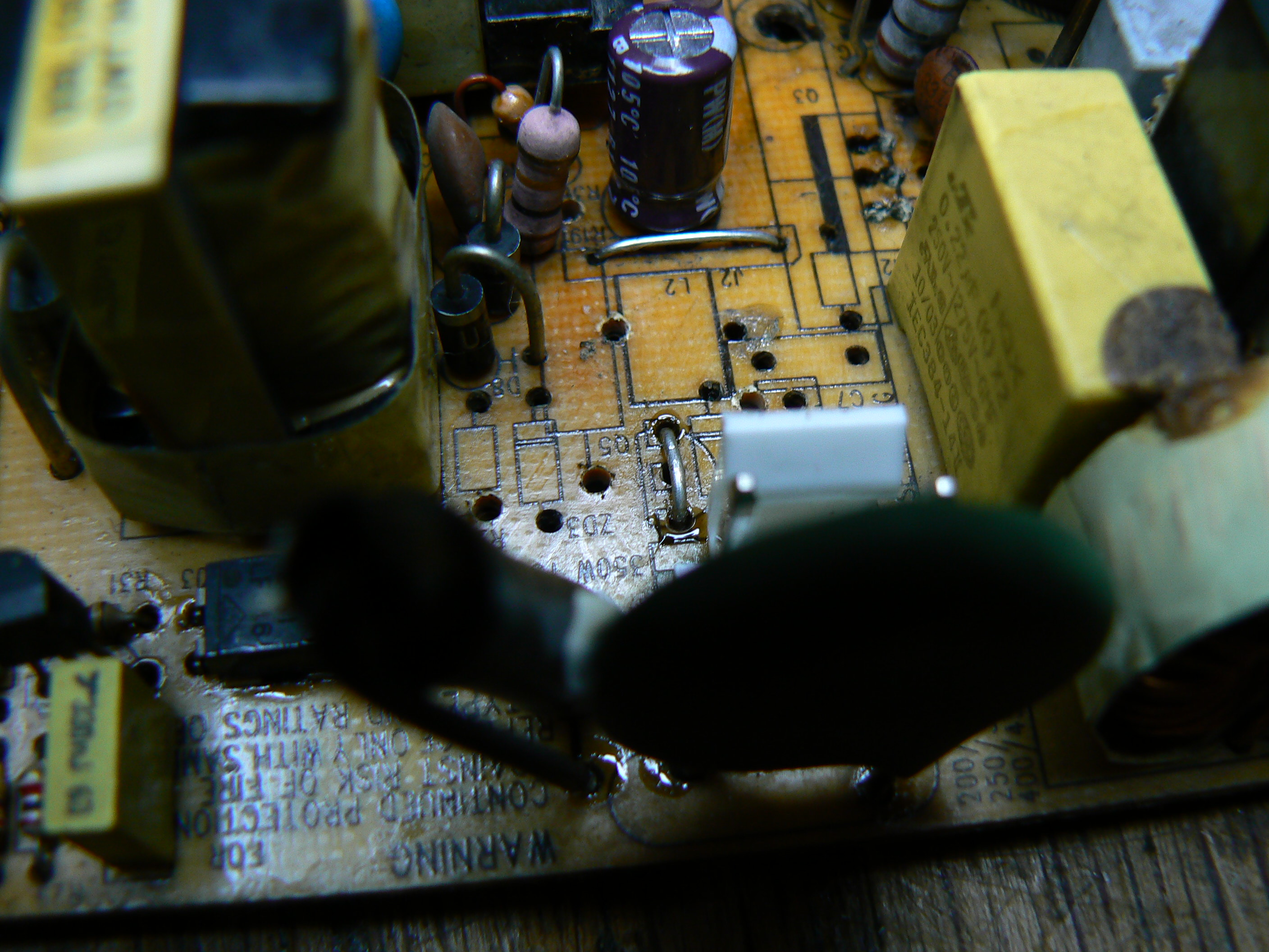

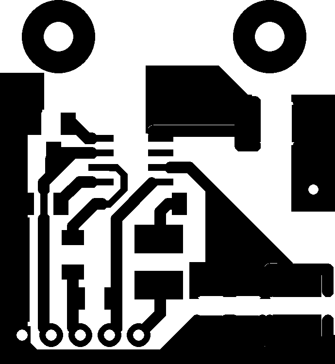

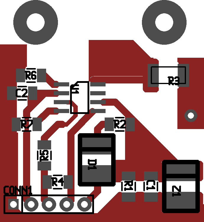

        Uh, wait... is it me or are R2 and D1 not hooked up properly on the PCB layout?

          The transistor is a FET it is a Fairchild SSS4N60B. I am attaching a picture and datasheet for it.

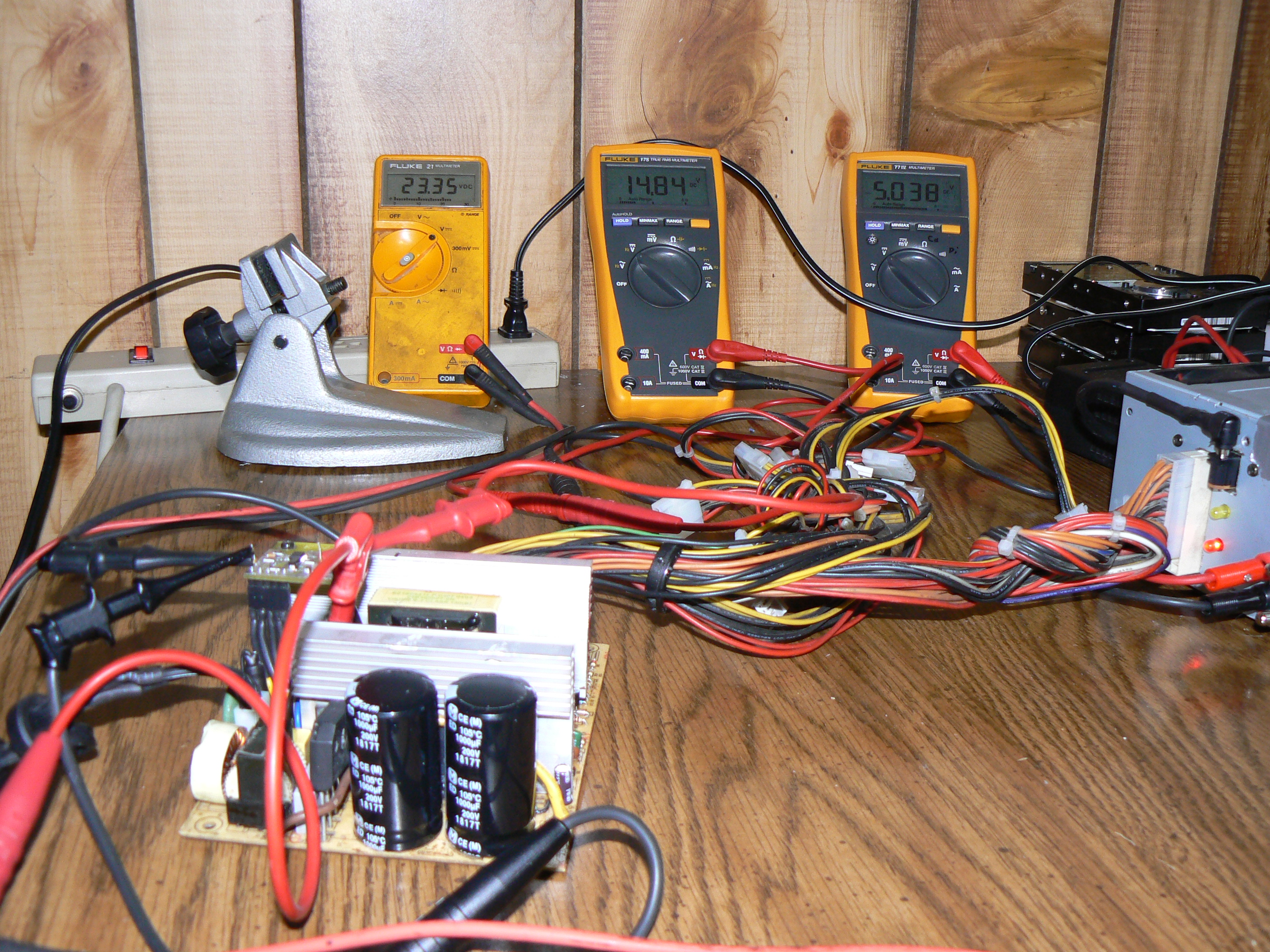

          I did some quick testing when I got home tonight. I tested it with no load and a 1.7 ohm load to compare the differences in the winding output. In the attached pictures the meter on the left is attached to D8 which is supplying the power to UC3844. The NCP1200 is getting its' voltage off of the side of the coil winding that used to go to L2.
          With no load the D8 voltage is 19.33V but the NCP1200 is only seeing 12.58V for its' Vdd. When the load goes to 1.7 ohms, D8's voltage jumps to 23.35V while the NCP1200's Vdd is limited to 14.84V by the Zener diode.
          Since the UC3844 can take up to 30V input that is not a problem, the only concern is how much power the Zener is having to burn off as it would be bad for the NCP1200 if it fried.
          I will do some more testing when I get time.
            I think the "silkscreen" is skewing your perspective, the copper is not connected. I am attaching a picture of a populated board that I was experimenting with on a different supply so the 110 ohm resistor is replaced with a wire. (Best picture I have on hand of an etched board.)

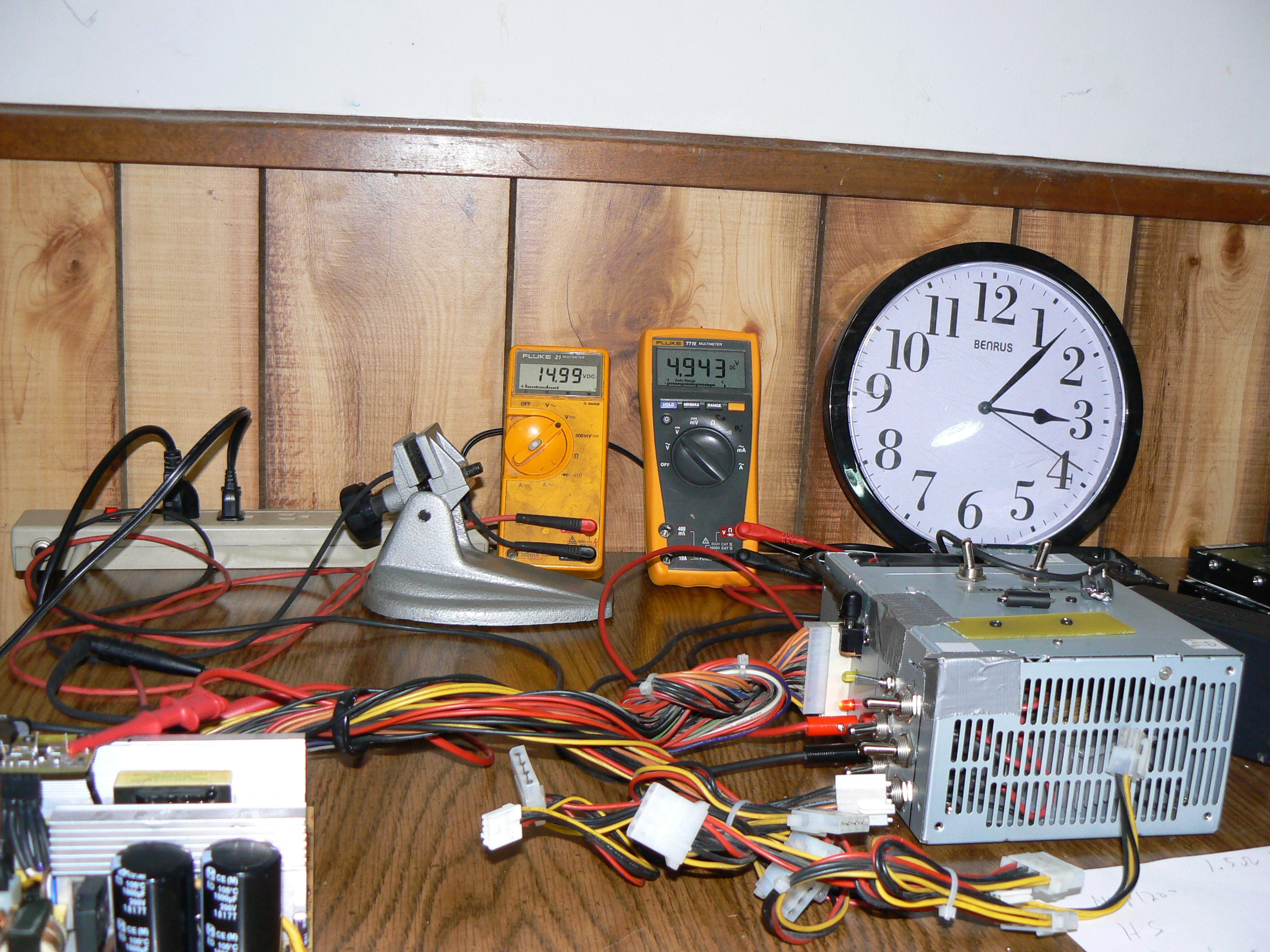

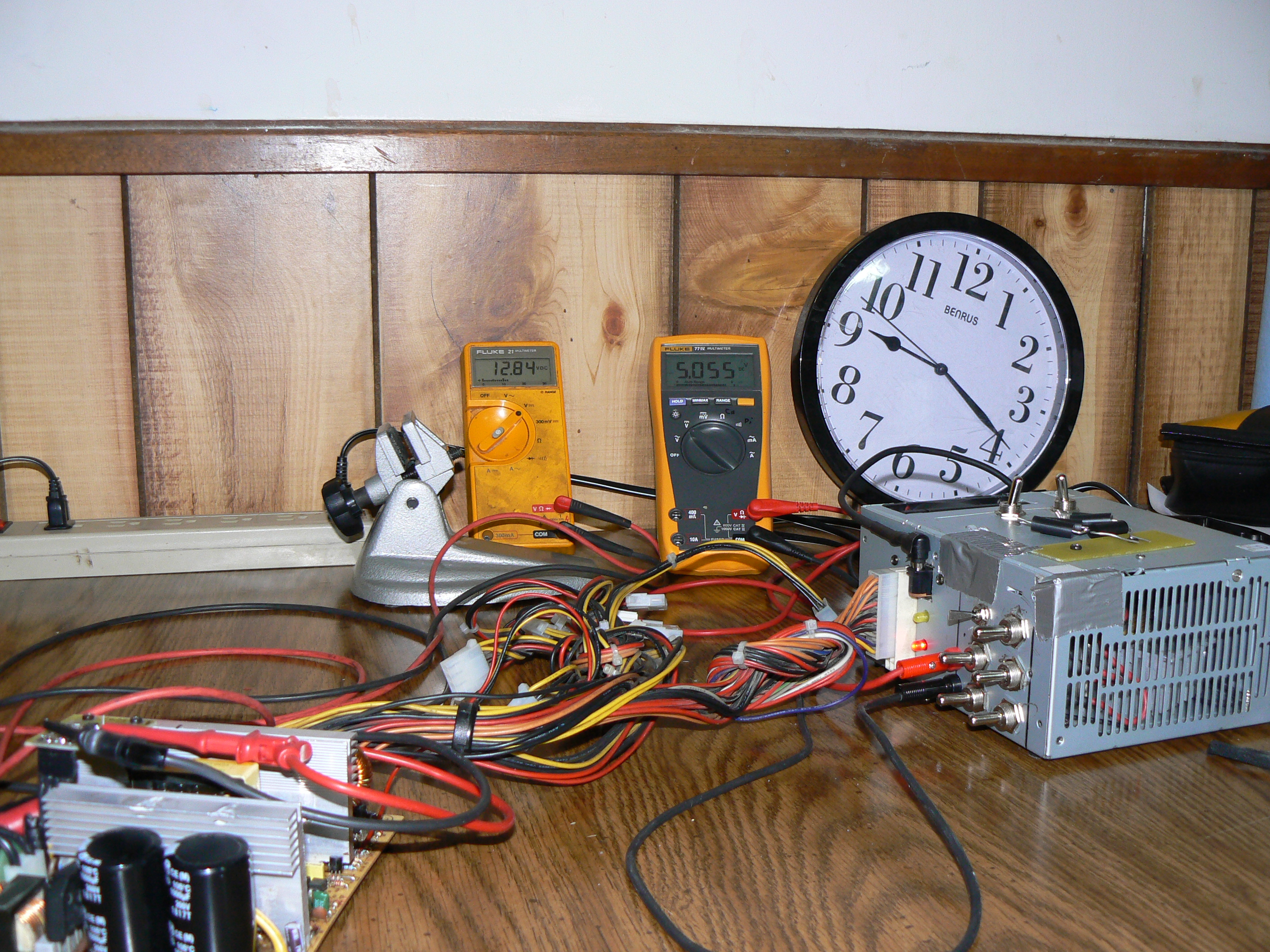

              I was able to do some 5vsb testing on this supply today and so far the results look good.
              I ran it with a 2.1 ohm load for one hour taking temperatures with my IR temp gun so the true values my vary but at least it is an idea of what it is doing under load.
              NCP1200 chip - Initial Temp 68F -> one hour later 78F
              Heat Sink (top center)- Initial Temp 68F -> one hour later 80F
              Transformer - Initial Temp 66F -> one hour later 119F
              I then went directly from this test to a 1.7 ohm load for an hour so there was no cool down.
              NCP1200 chip - one hour later 80F
              Heat Sink (top center)- one hour later 83F
              Transformer - one hour later 128F
              This supply is only rated for 2A on the 5vsb so I am leery of pressing it farther. The FET on it is rated for 4A and I really do not care if I blow it or the NCP1200 but I would really be unhappy if I burned up the transformer so I am not sure how much more load I can safely push without risking damage to the transformer. However, the temptation to keep pushing the limits is very great.

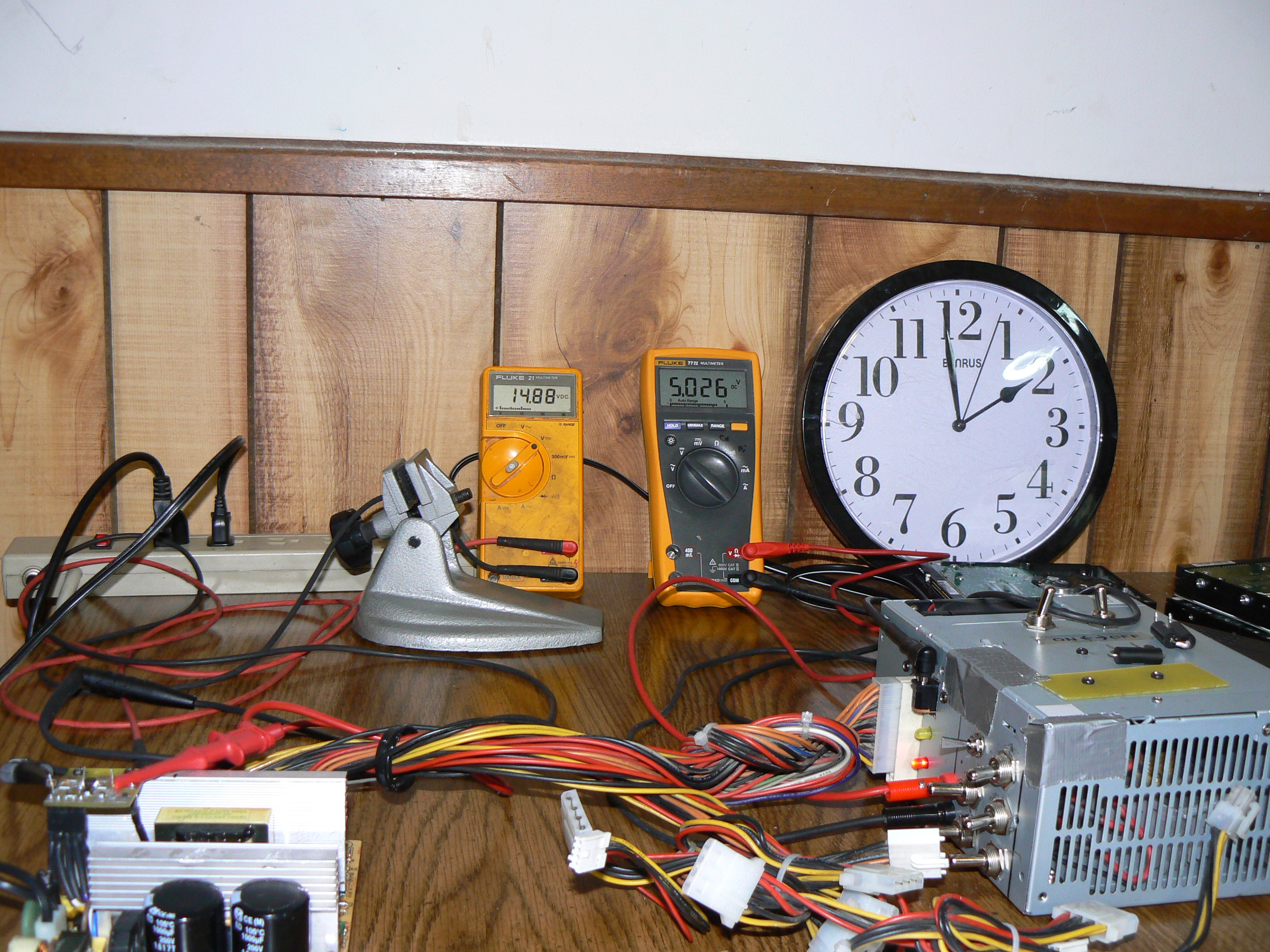

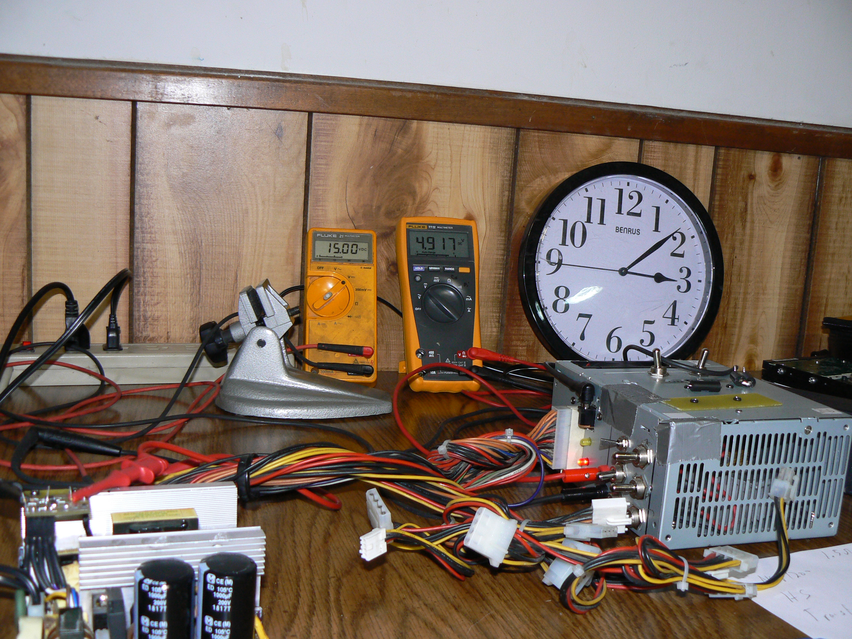

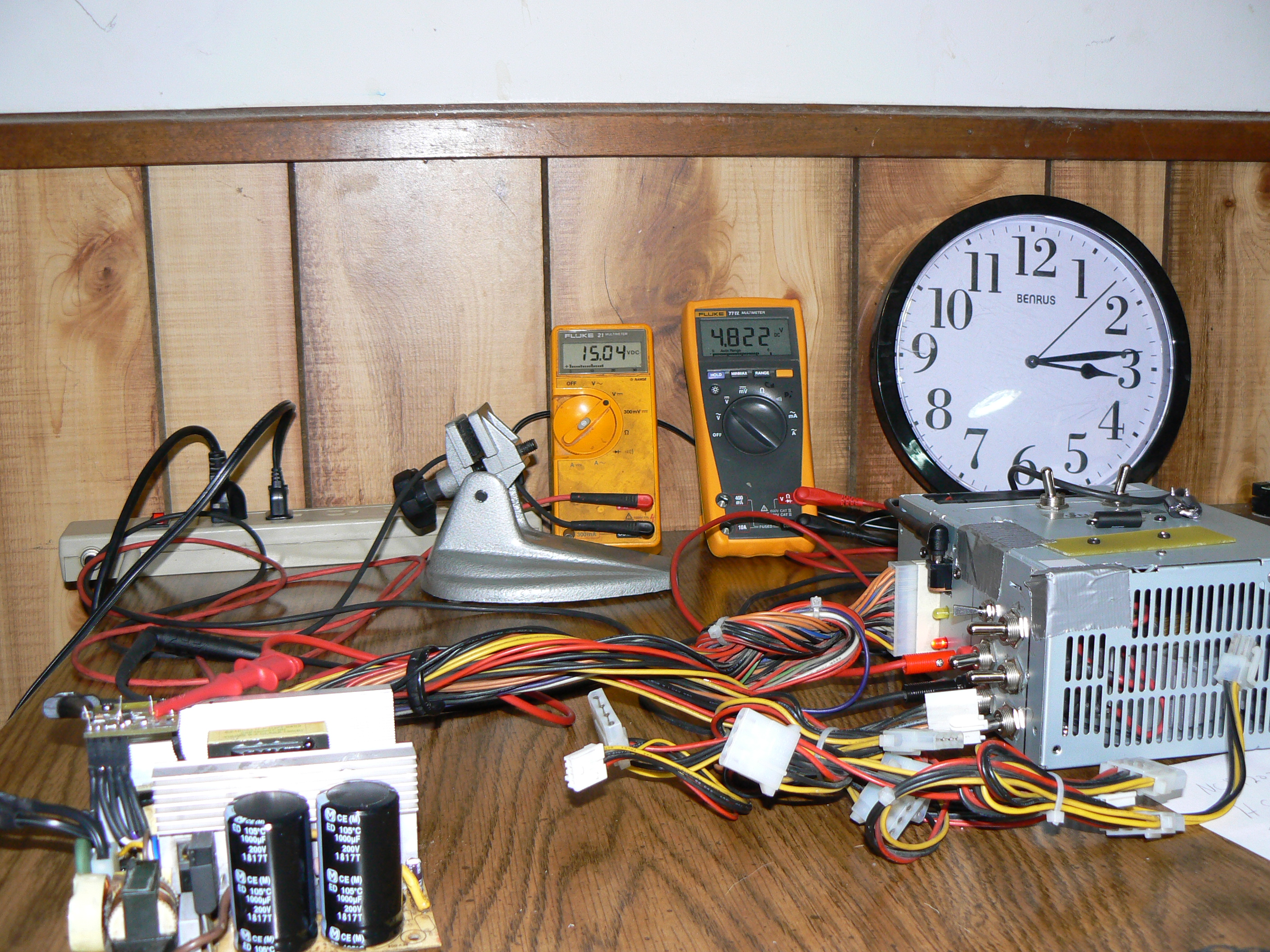

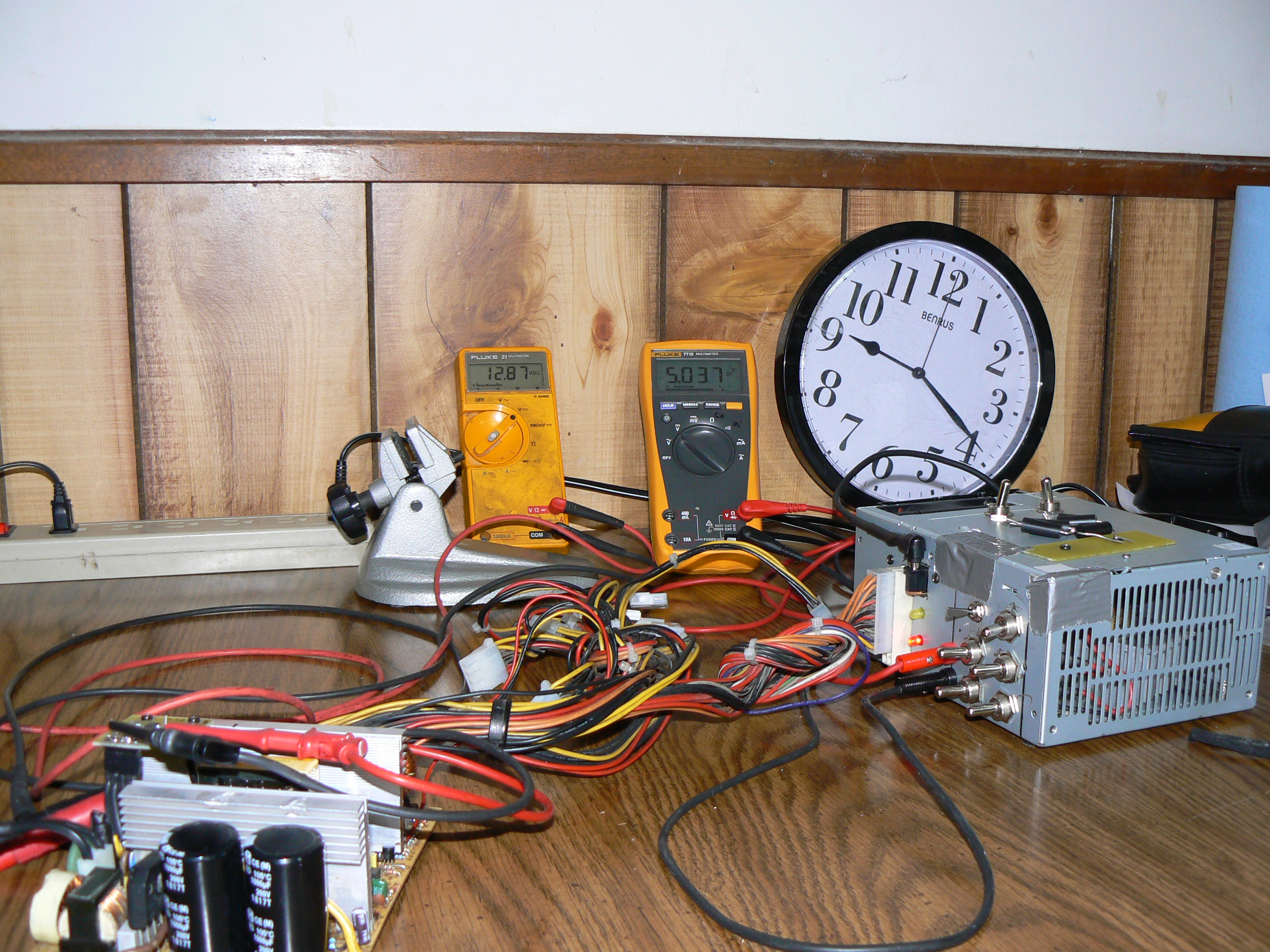

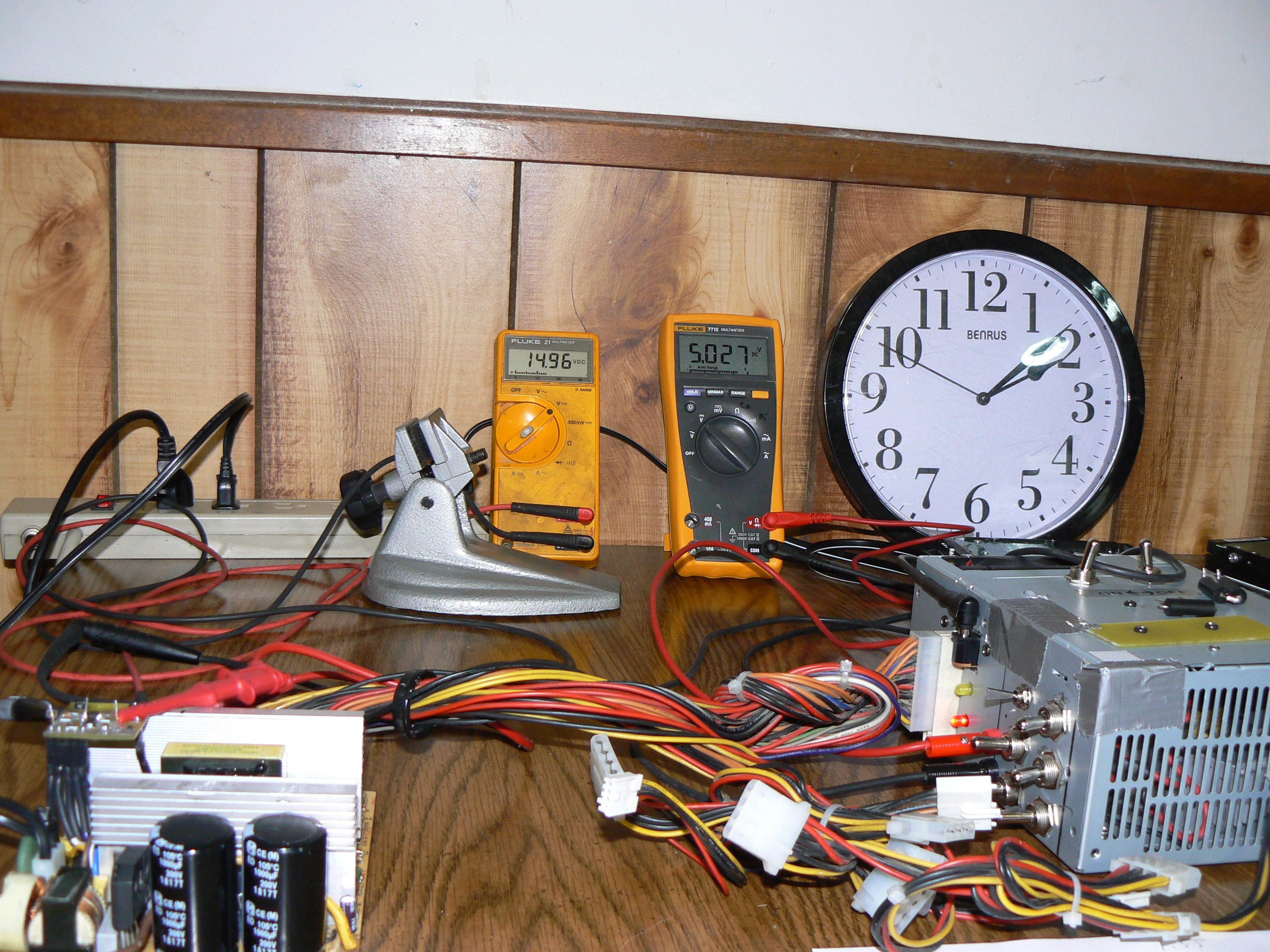

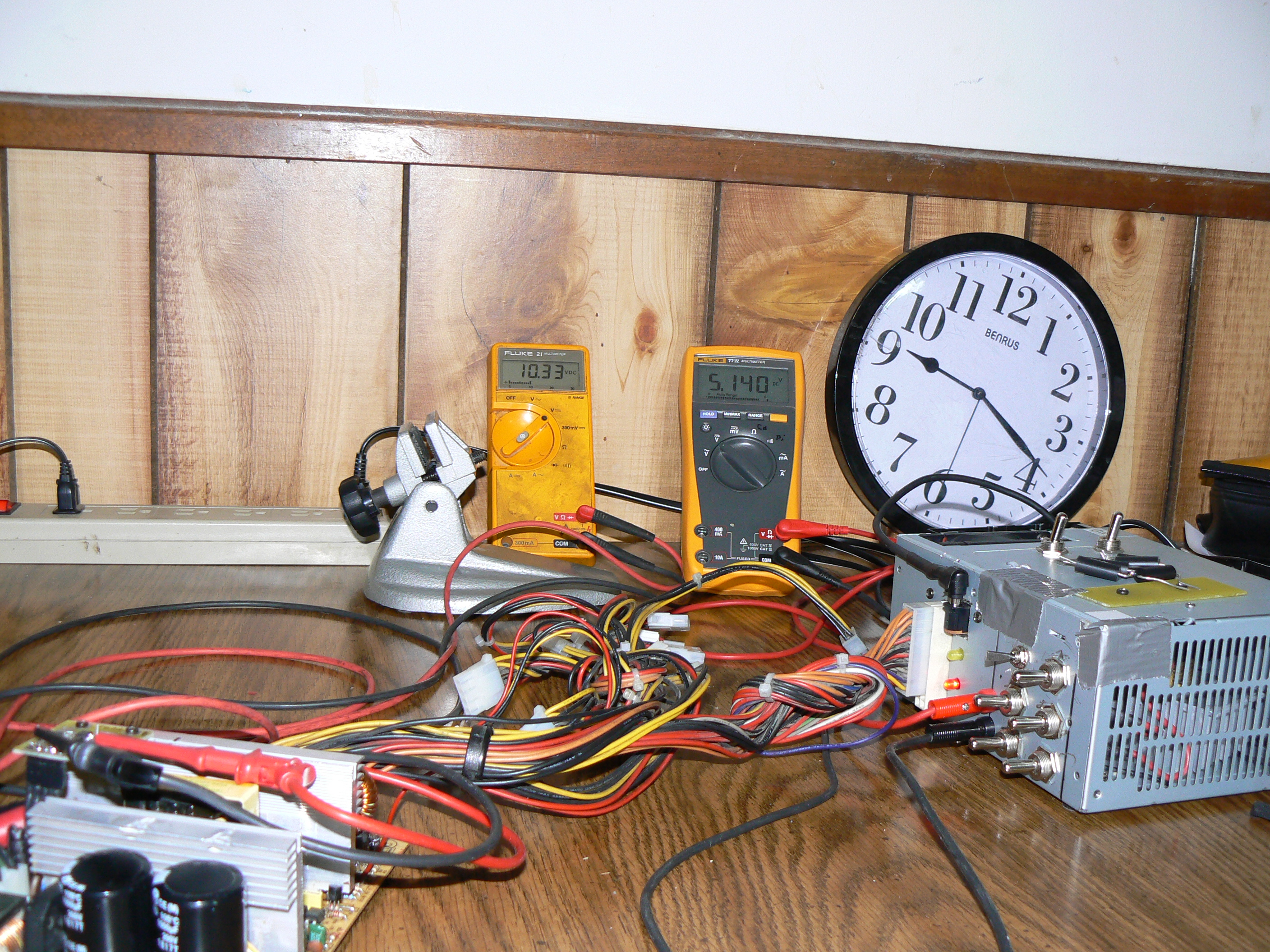

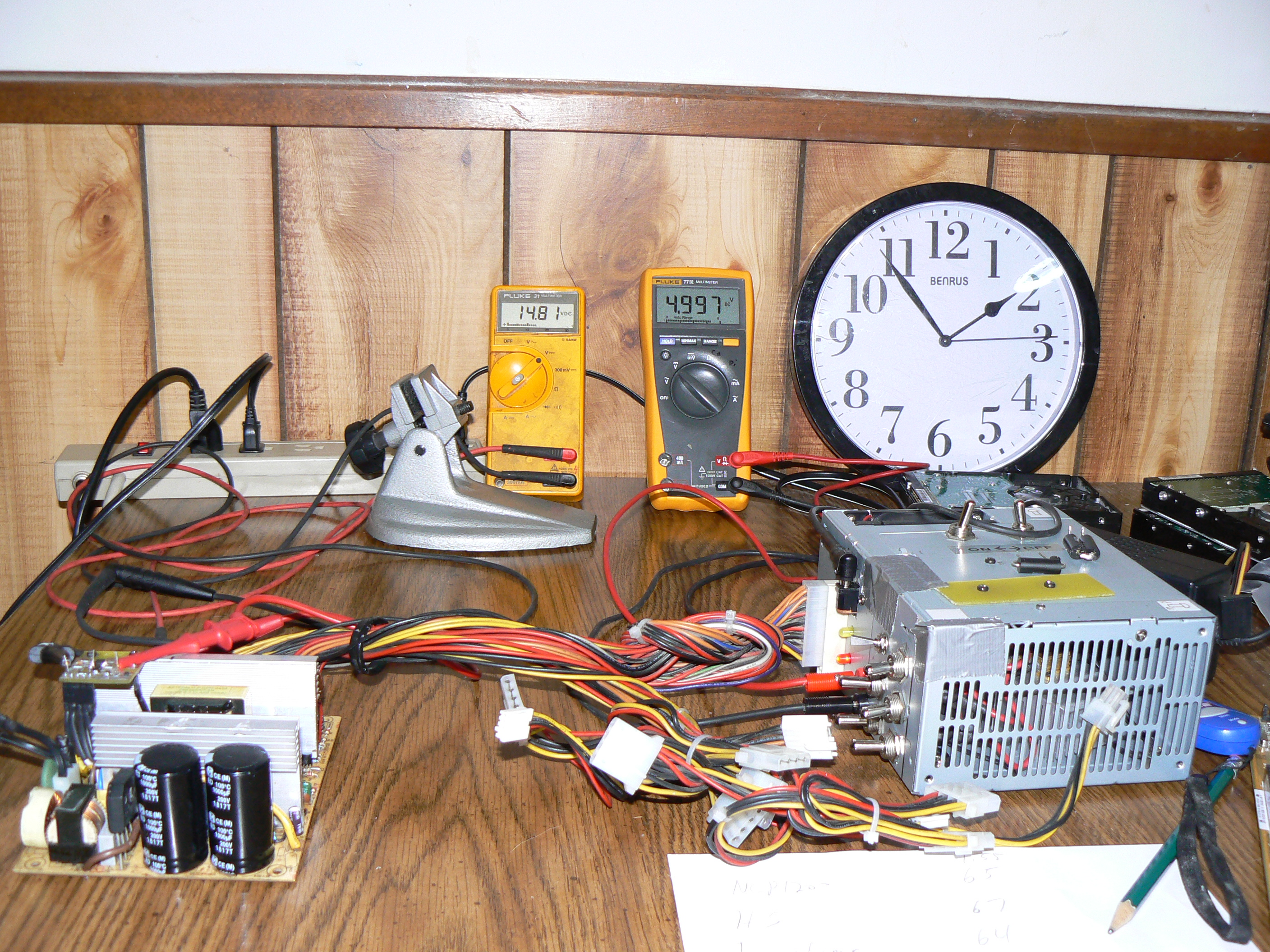

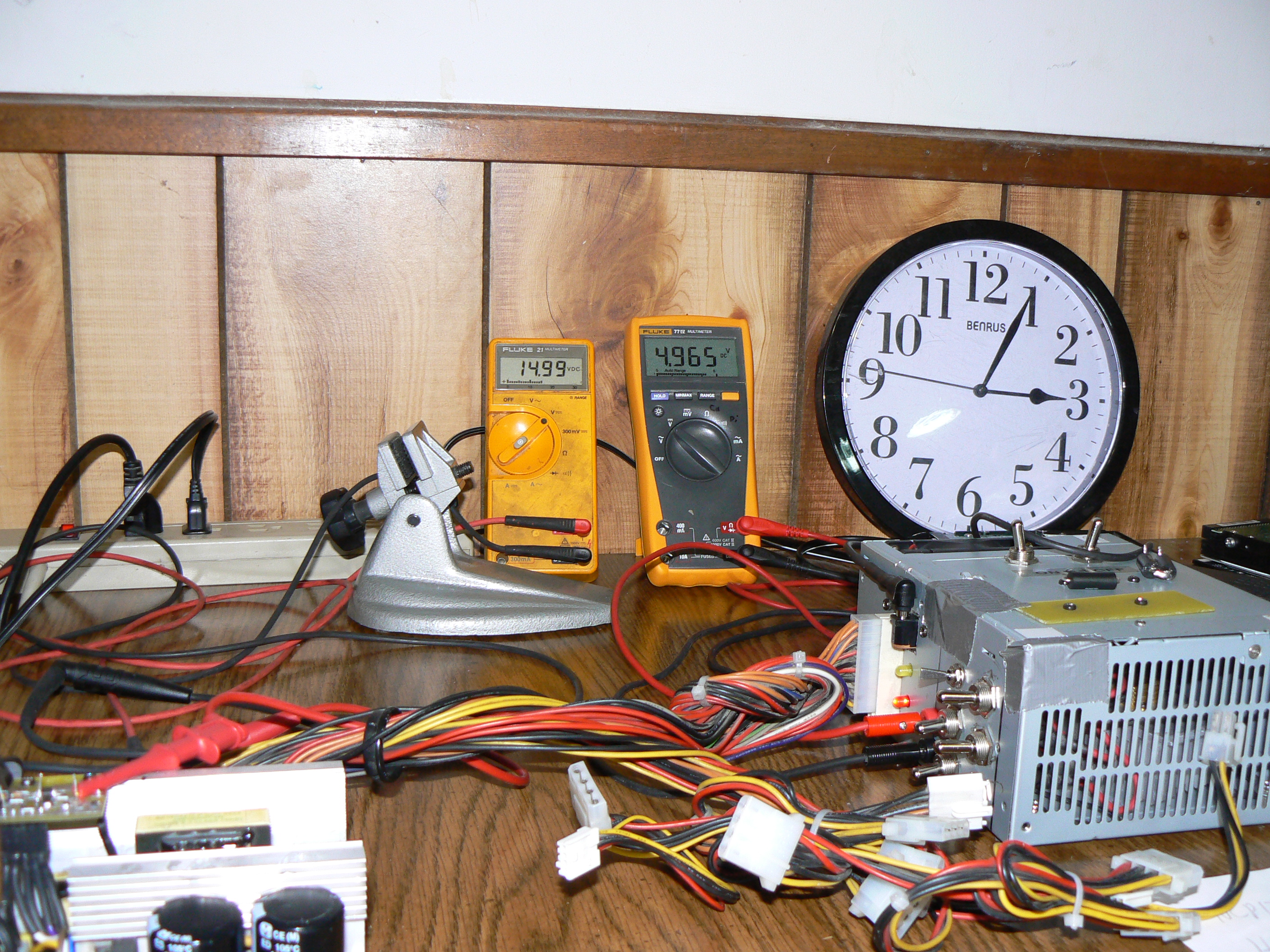

                      OK I was did some more testing and I was surprised by the results. This supplies 5vsb is rated for 2A and I ran it for an hour today pulling 3.33A. 5V on a 1.5 ohm load.
                      NCP1200 chip - Initial Temp 65F -> one hour later 83F
                      Heat Sink (top center)- Initial Temp 67F -> one hour later 87F
                      Transformer - Initial Temp 64F -> one hour later 143F

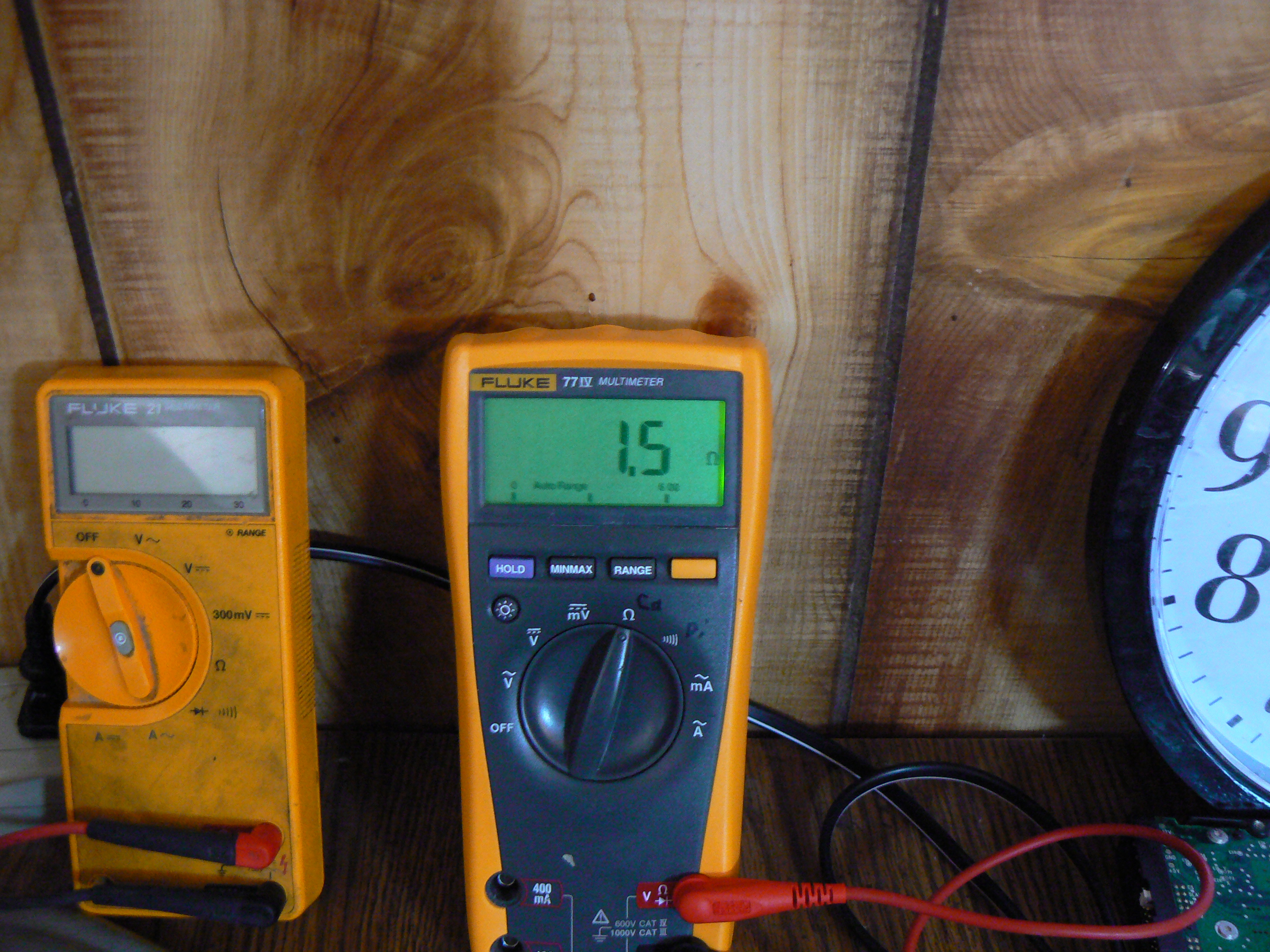

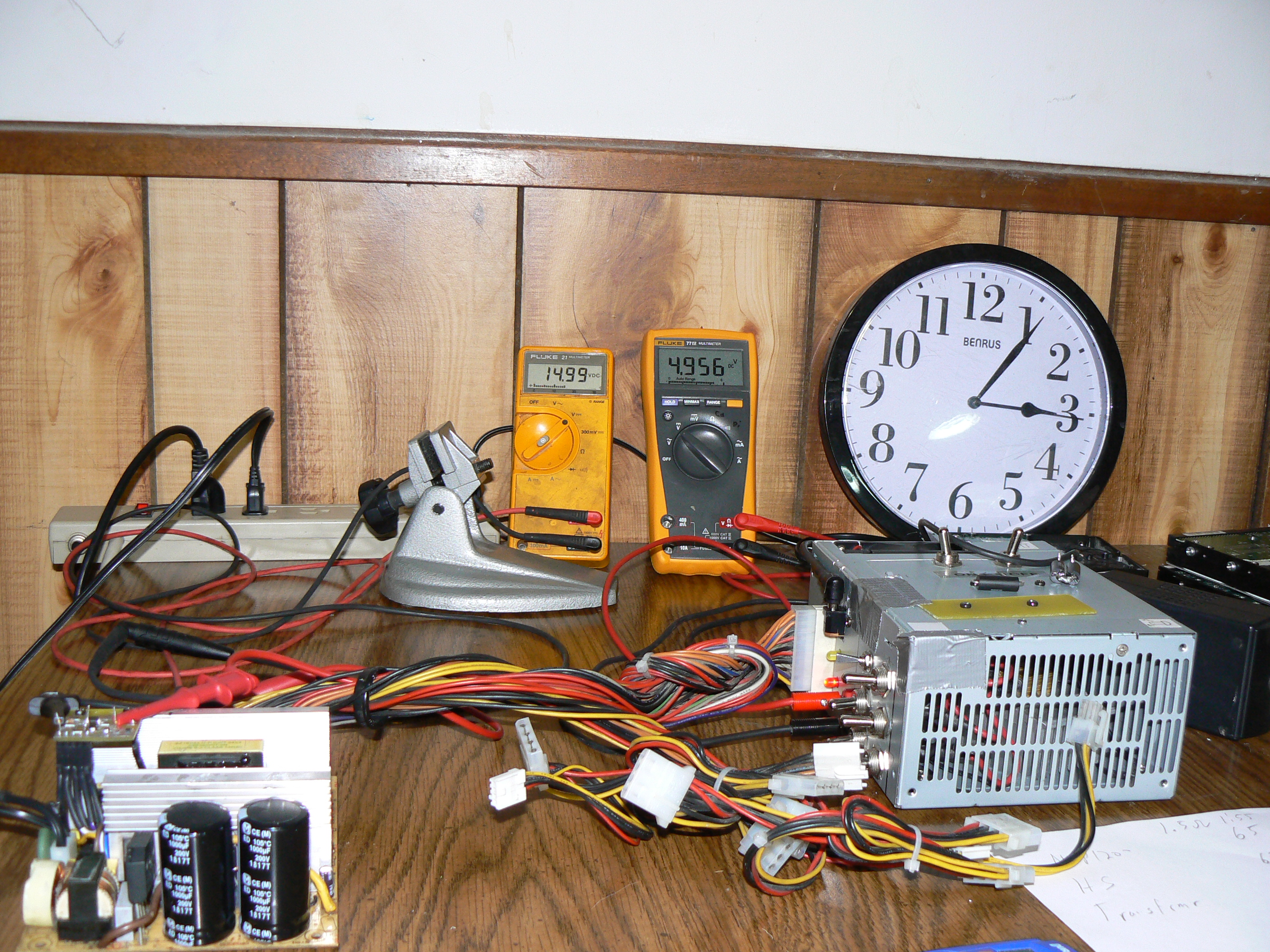

                      I took some pictures this time, so pay attention to the time on the clock. The 5vsb voltage actually rose some shortly after I turned it on which I attribute to the parts warming up but that is just conjecture based on the fact that it stabilized after a few minutes. I think I reached its' limit with my next test however, but I will put that in another post to keep the pictures separate.
                      • LDSisHere
                        • May 2012
                        • 727
                        • U.S.A.
                        Re: Antec SL-400 5vsb Mod with NCP1200

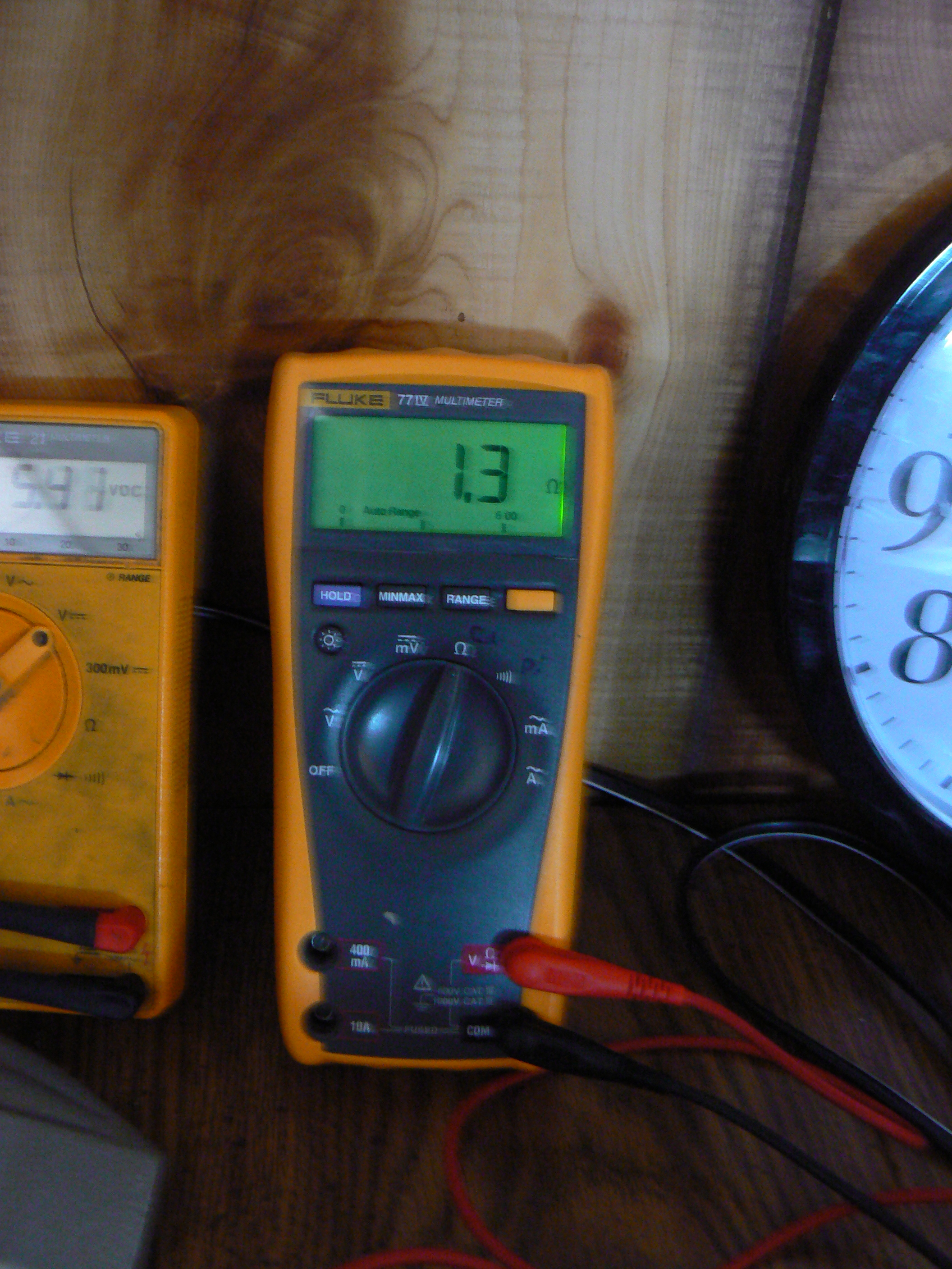

                        After the 1.5 ohm test, I paused long enough to take a picture of the next resistance reading which was 1.3 ohms. I then turned back on to see what would happen. The 5vsb voltage started dropping almost immediately. I only ran it for ten minutes before stopping the experiment since no good could come from continuing. Check out the pictures to see how the voltage dropped in the short amount of time also look at how much the temperatures jumped.
                        NCP1200 chip - ten minutes later 85F
                        Heat Sink (top center)- ten minutes later 93F
                        Transformer - ten minutes later 160F

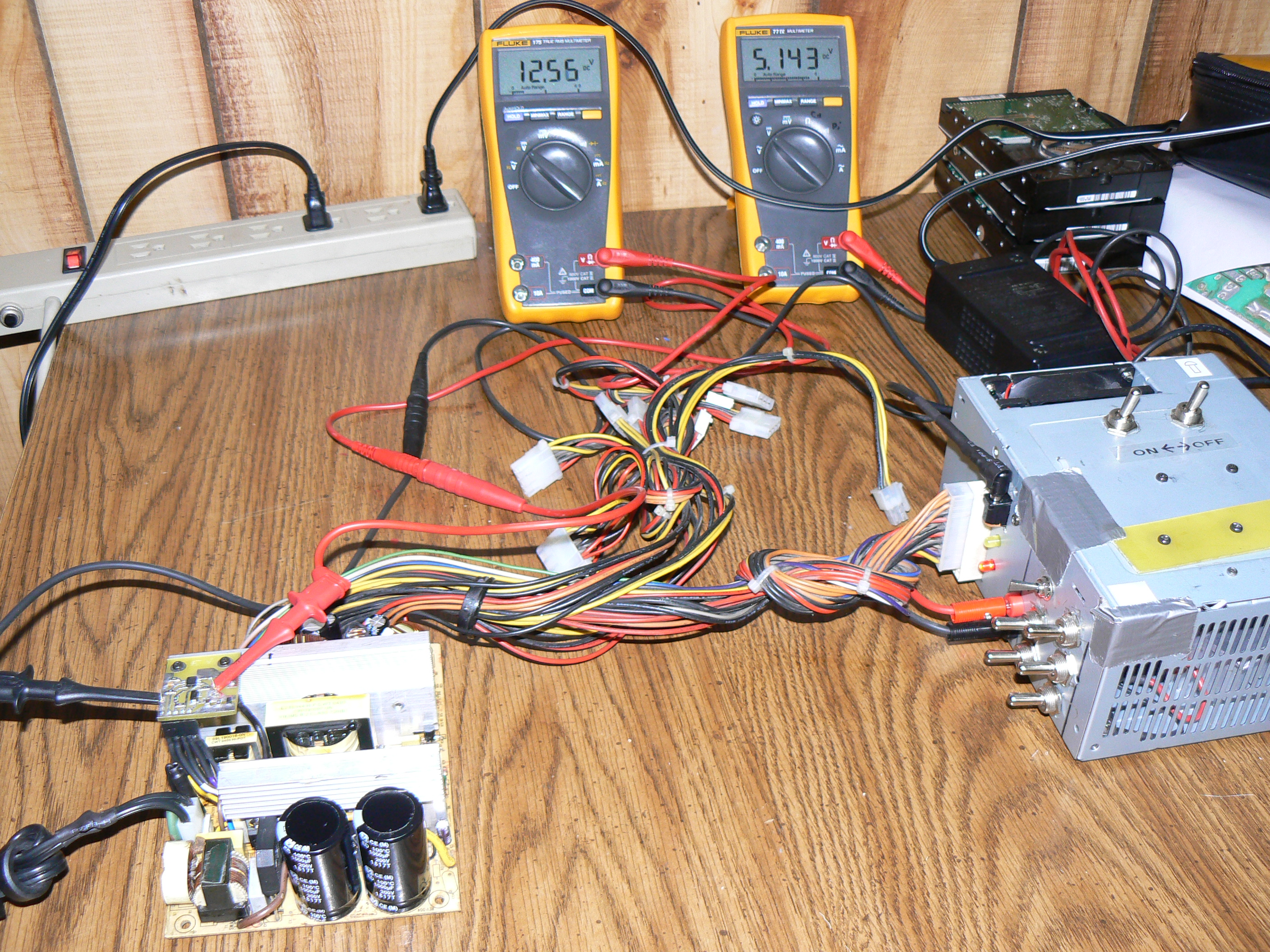

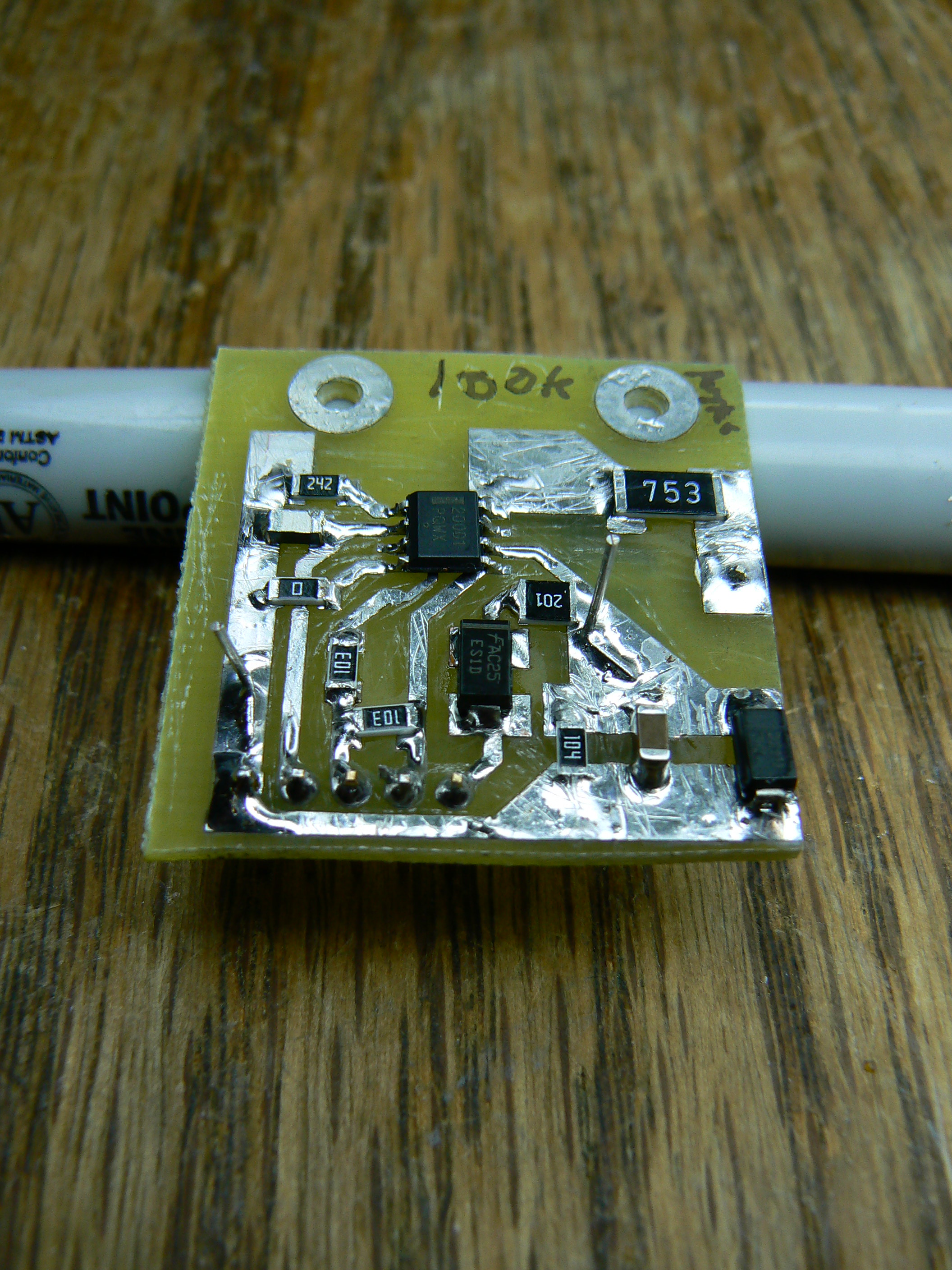

                            Tonight, I finished populating a board with the 100K version of the NCP1200, but I only had time to do a quick check of the voltages. I also changed resistor R2 (Vdd) from 110 ohms to 200 ohms to reduce the load the zener has to burn off. This may have not been the best idea for comparison purposes so I will have to make a 60K board with a 200 ohm resistor for a more direct comparison. On my Ultra the 100K chip worked better but for this Antec that may not be the case. I just ran the supply for a few seconds at each setting, I will have to wait until I have more time to do longer tests.
                            No load -> Vdd = 10.33 <-> 5vsb = 5.140
                            2.1 ohm -> Vdd = 12.84 <-> 5vsb = 5.055
                            1.7 ohm -> Vdd = 12.87 <-> 5vsb = 5.037

                              I setup a 60k NCP1200 with a 200 ohm Vdd resistor to match the 100k NCP1200 I had setup previously so that the test results would have less variables involved.
                              100k chip - NCP1200 - 200 ohm vdd resistor (R2 on my schematics)
                              1.7 ohm -> Vdd = 12.99 <-> 5vsb = 5.037
                              After 1 hour
                              1.7 ohm -> Vdd = 13.04 <-> 5vsb = 5.038
                              60k NCP1200 - 200 ohm vdd resistor (R2 on my schematics)
                              No load -> Vdd = 10.27 <-> 5vsb = 5.141
                              2.1 ohm -> Vdd = 14.07 <-> 5vsb = 5.056
                              1.7 ohm -> Vdd = 14.07 <-> 5vsb = 5.038
                              After 1 hour
                              1.7 ohm -> Vdd = 14.07 <-> 5vsb = 5.039
                              The 5vsb output difference between the two is trivial but there is quite a difference on the Vdd. In either case the increased resistor value prevents the Vdd zener's 15V threshold from being reached which I would think is a good for a longer service life of the zener itself.
                              Below are the results I got with the original 110 ohm Vdd resistor to make it easier to compare the difference between them.
                              60k NCP1200 - 110 ohm vdd resistor (R2 on my schematics)
