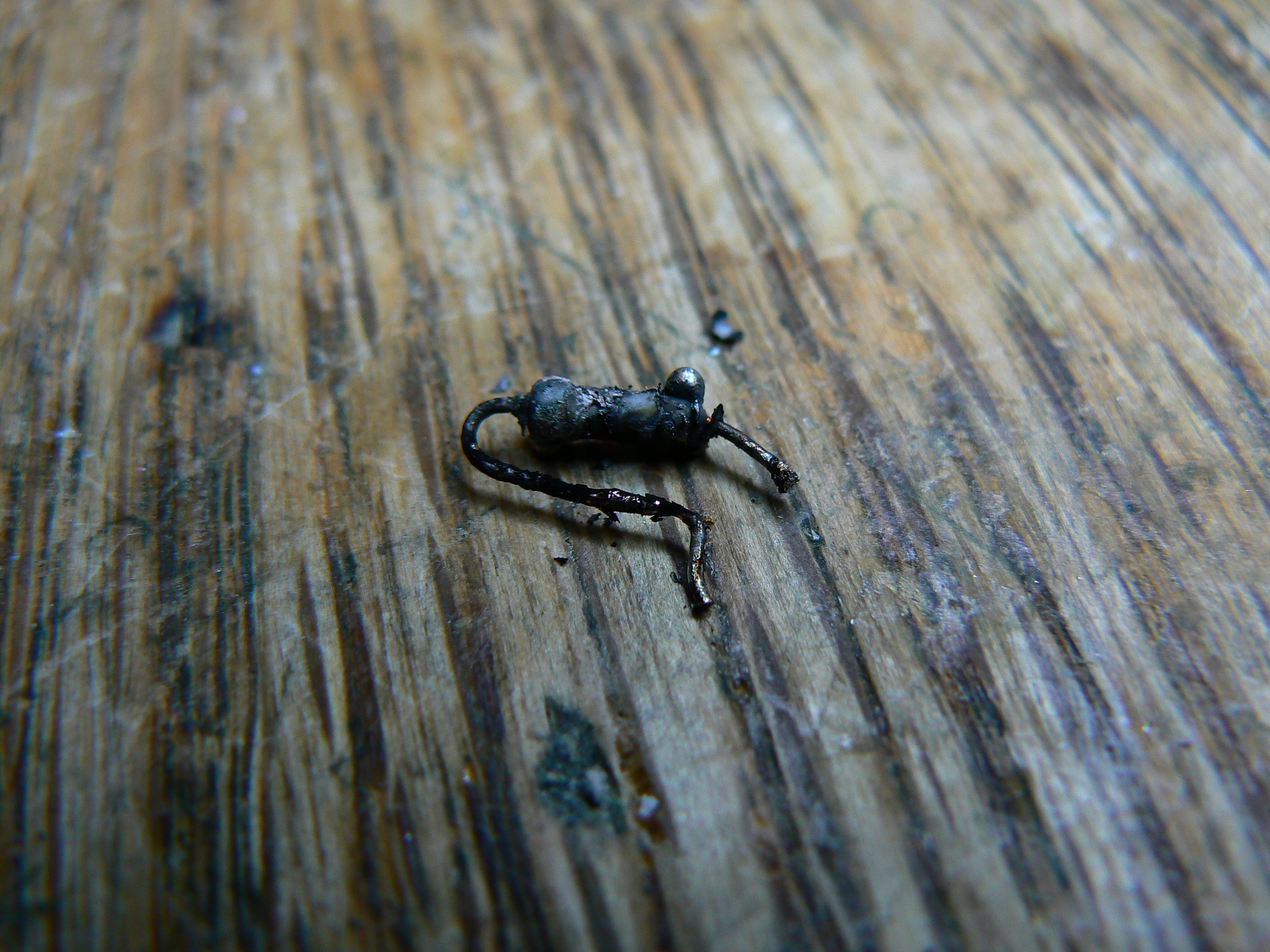

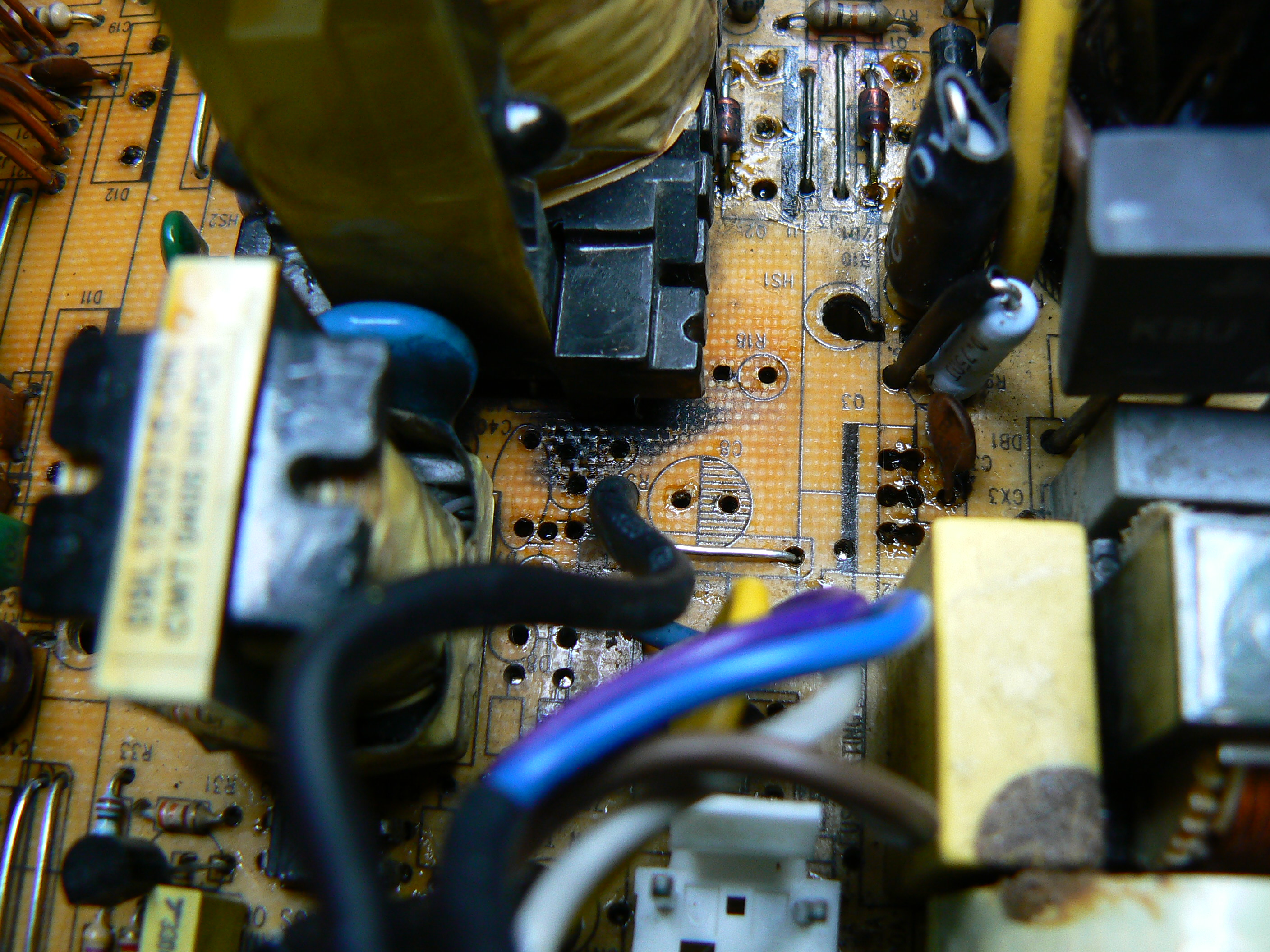

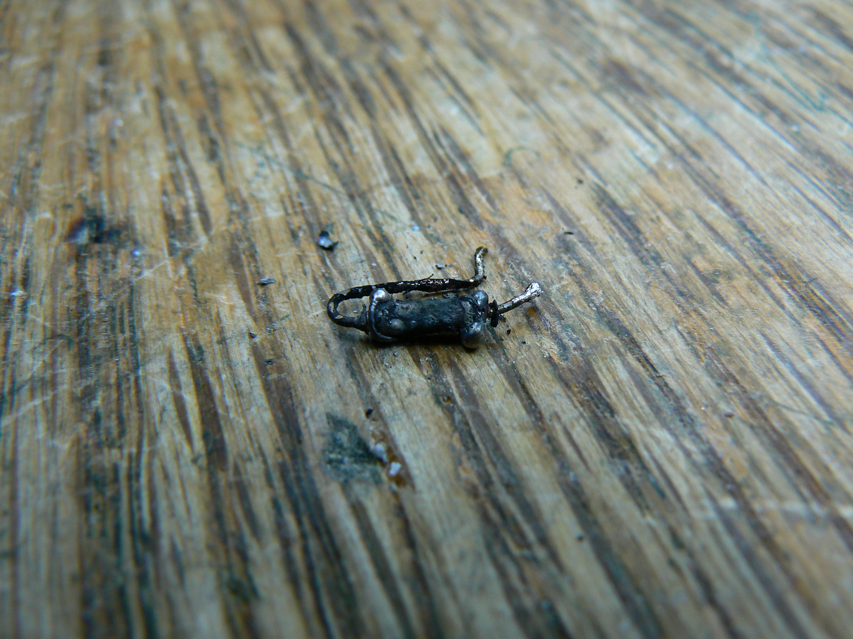

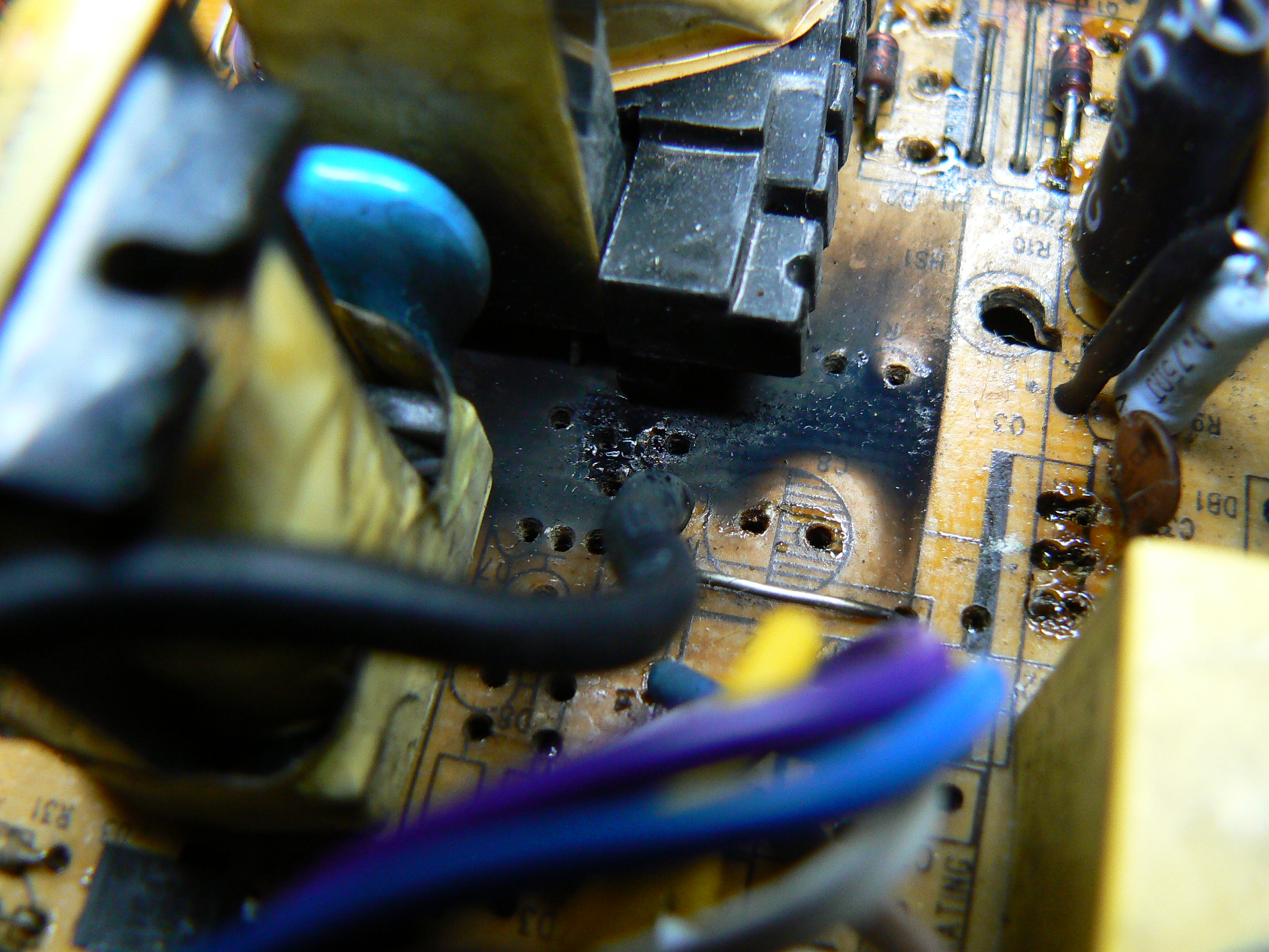

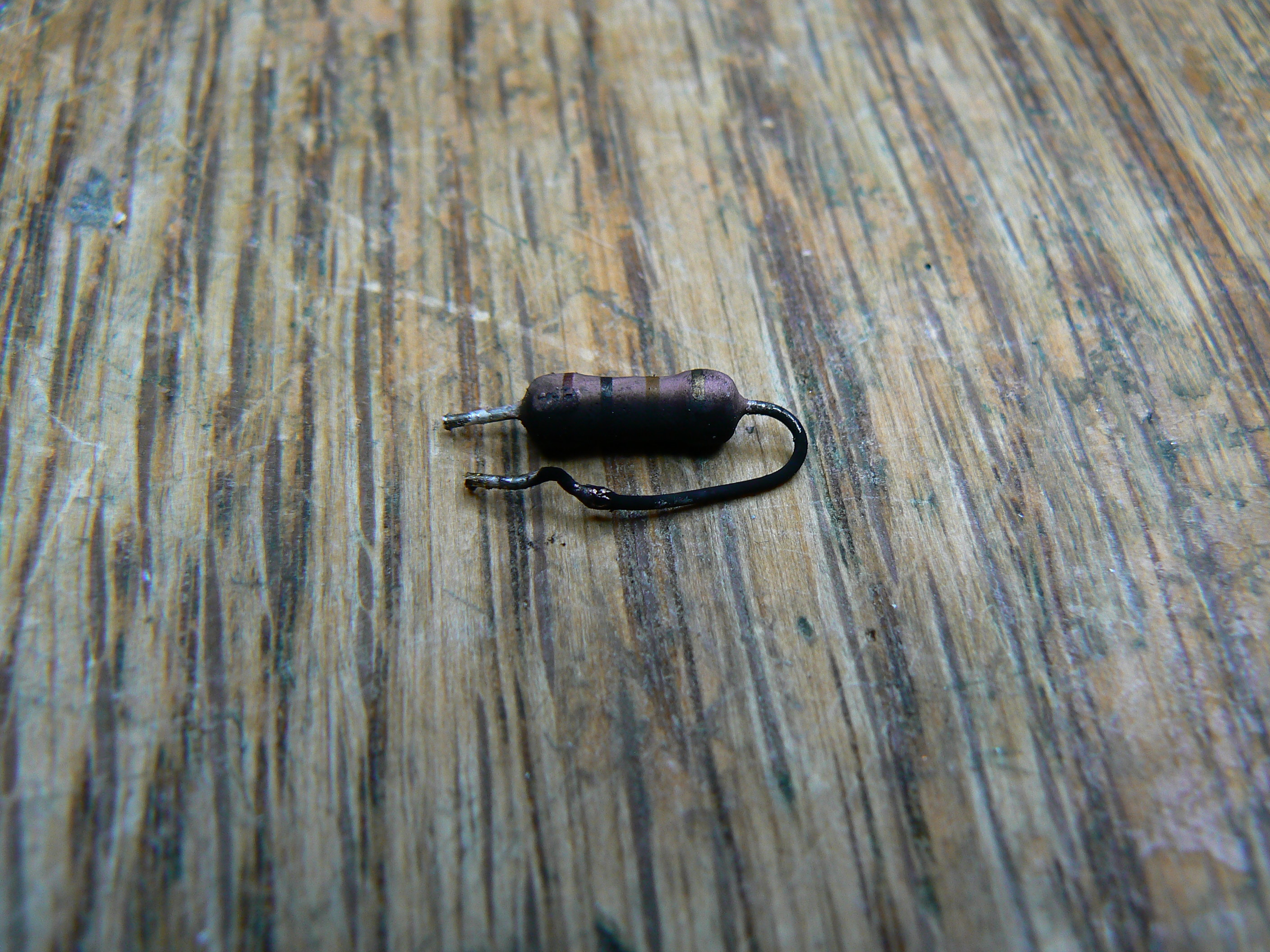

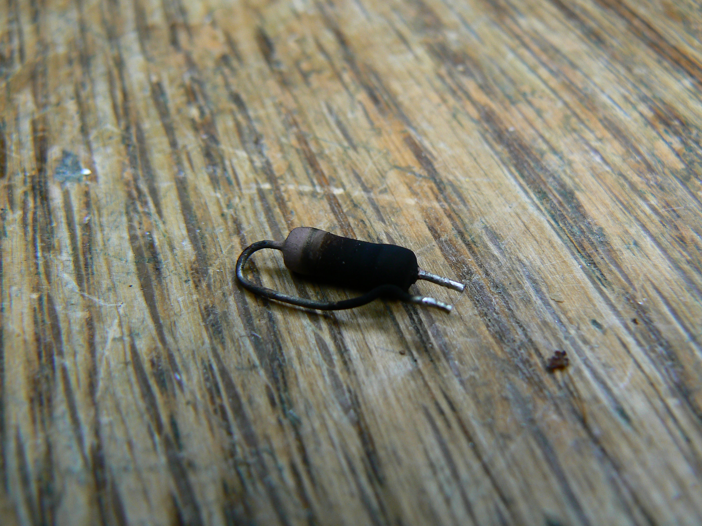

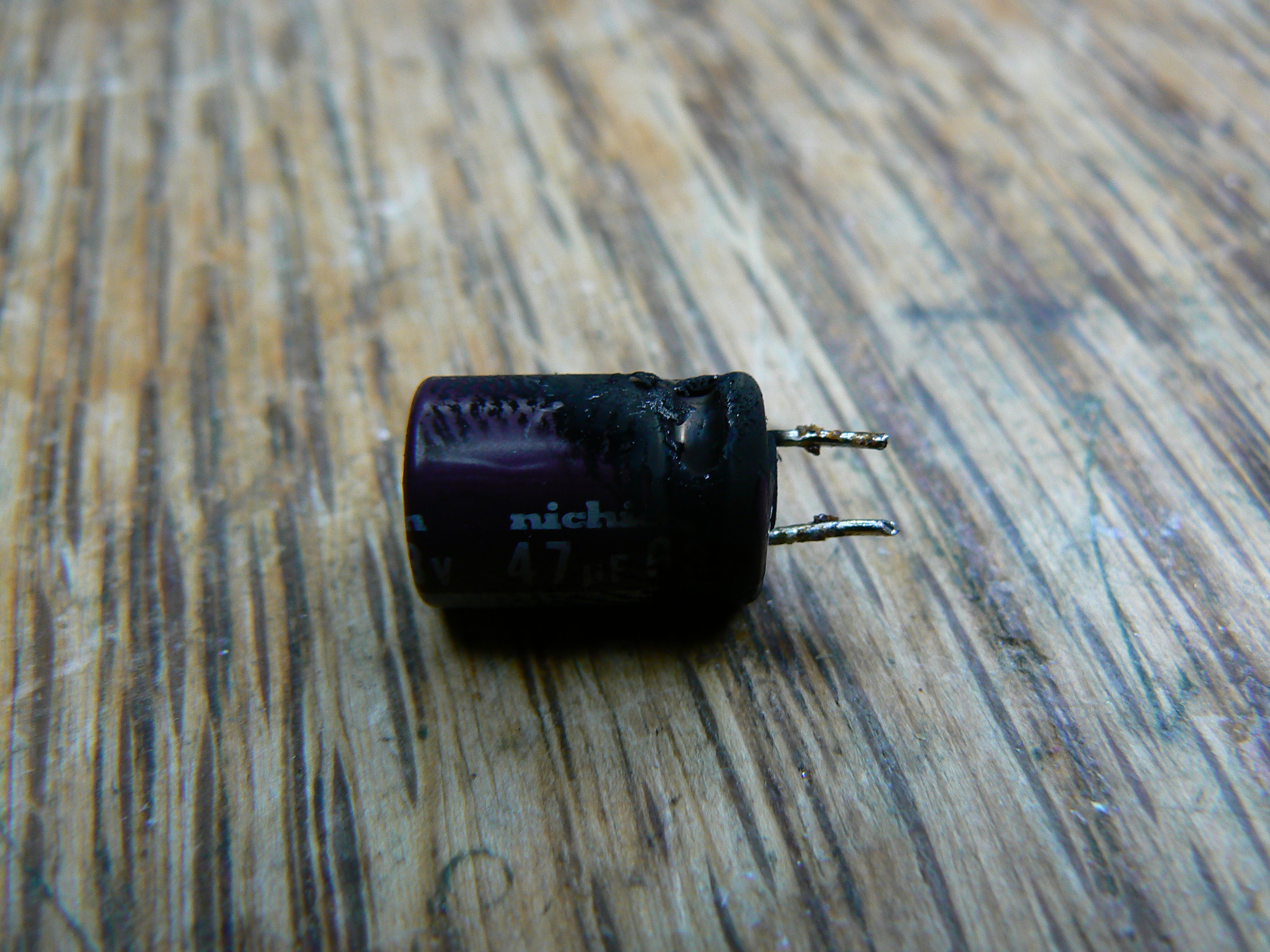

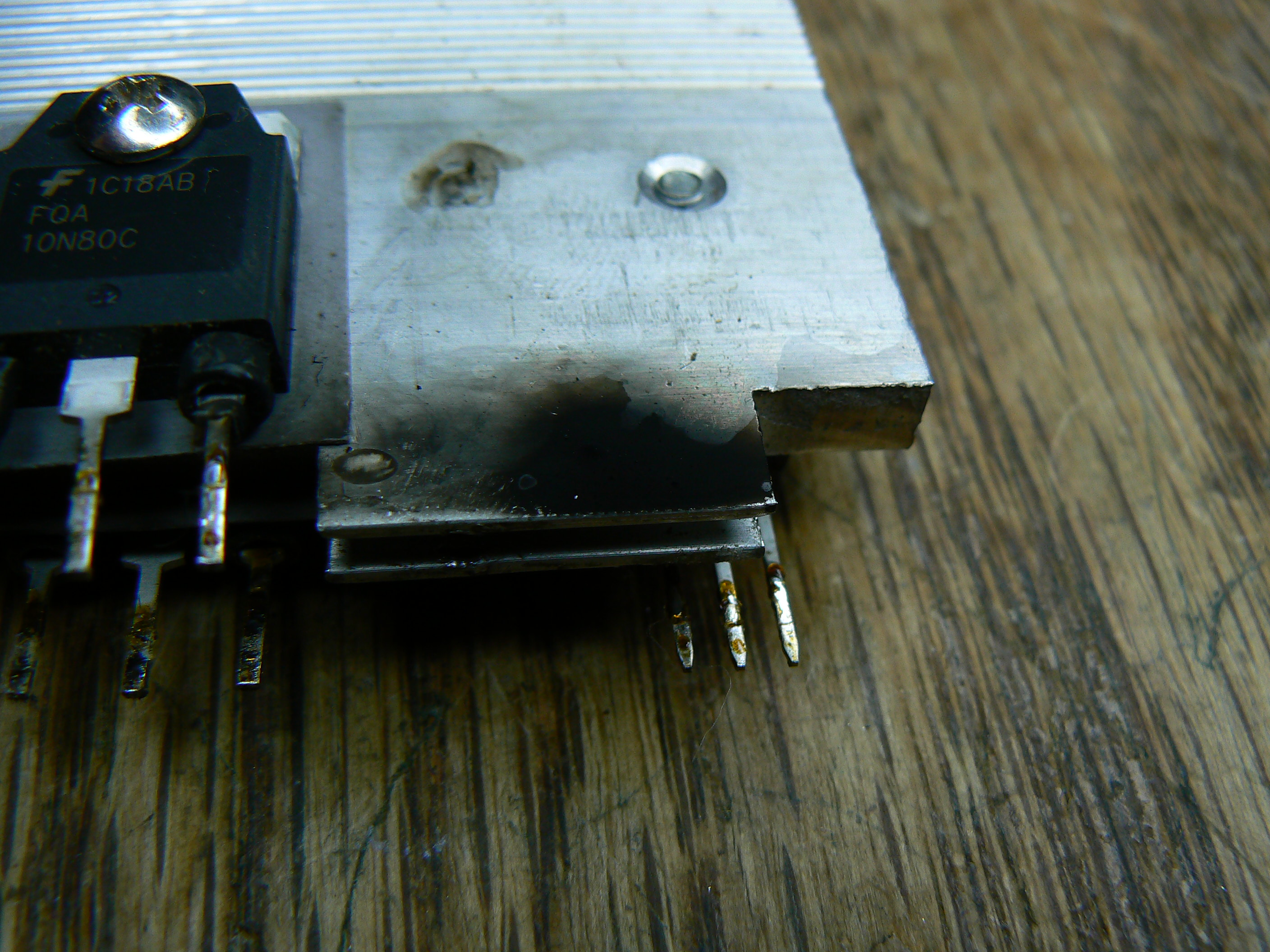

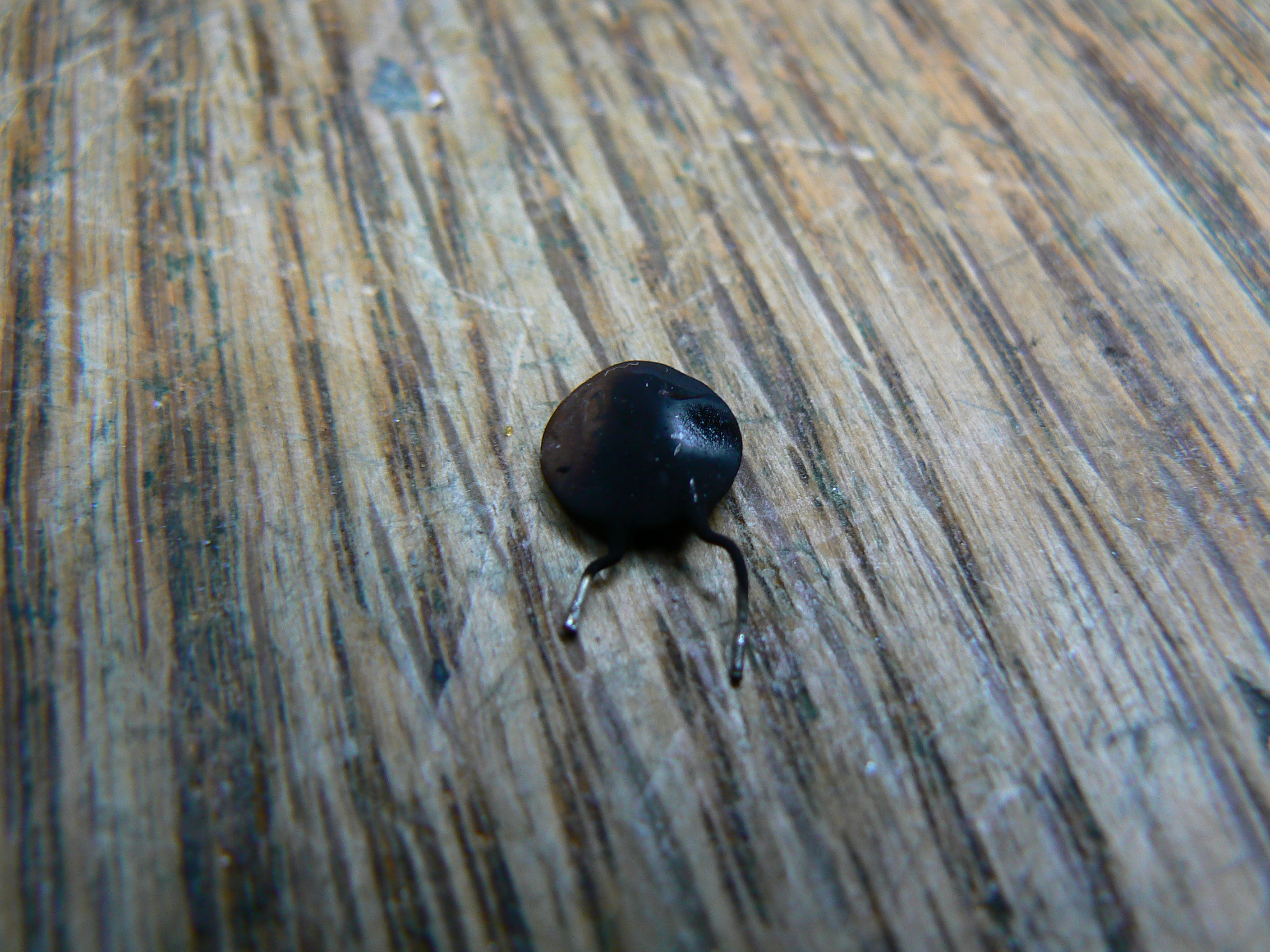

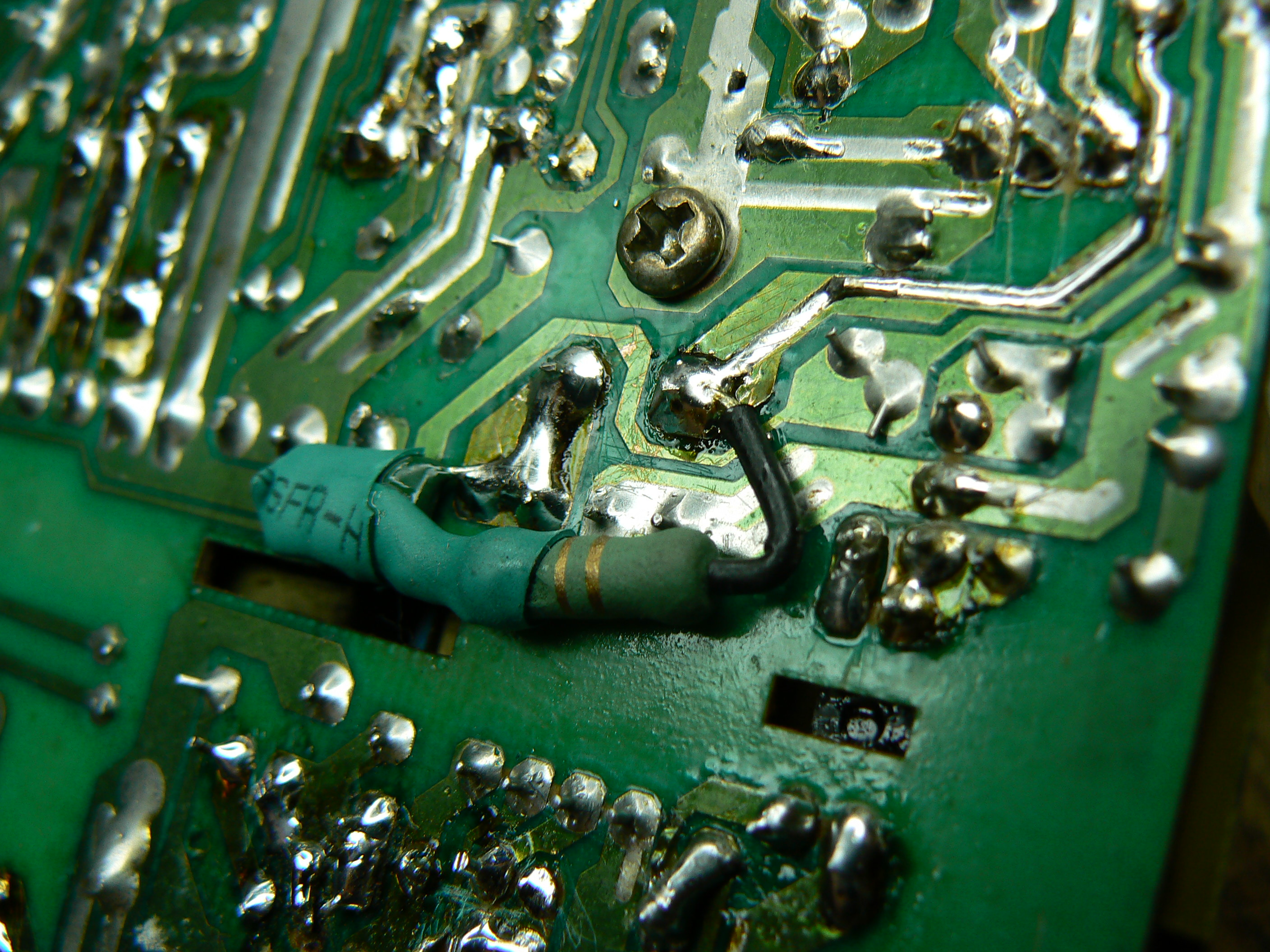

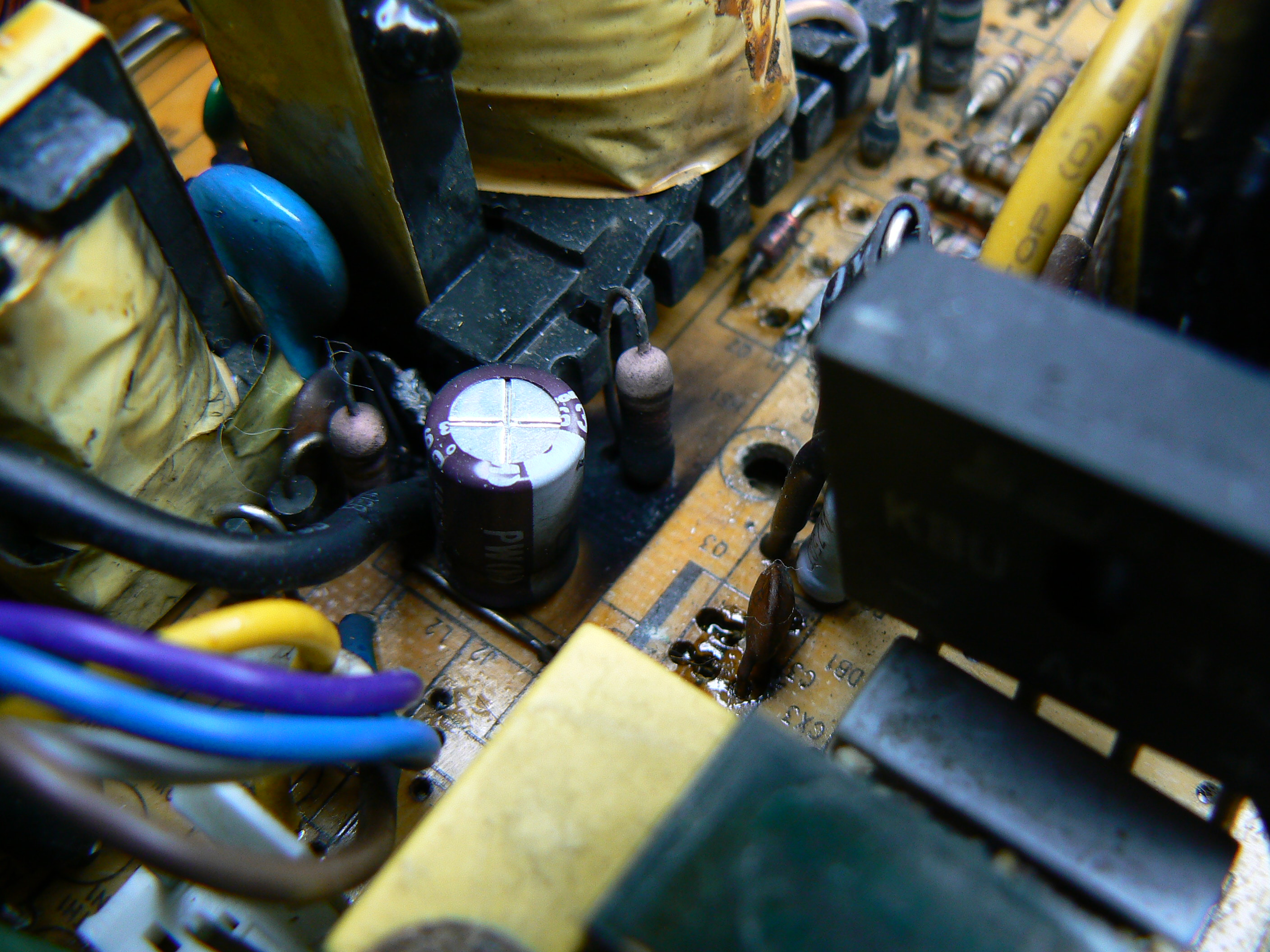

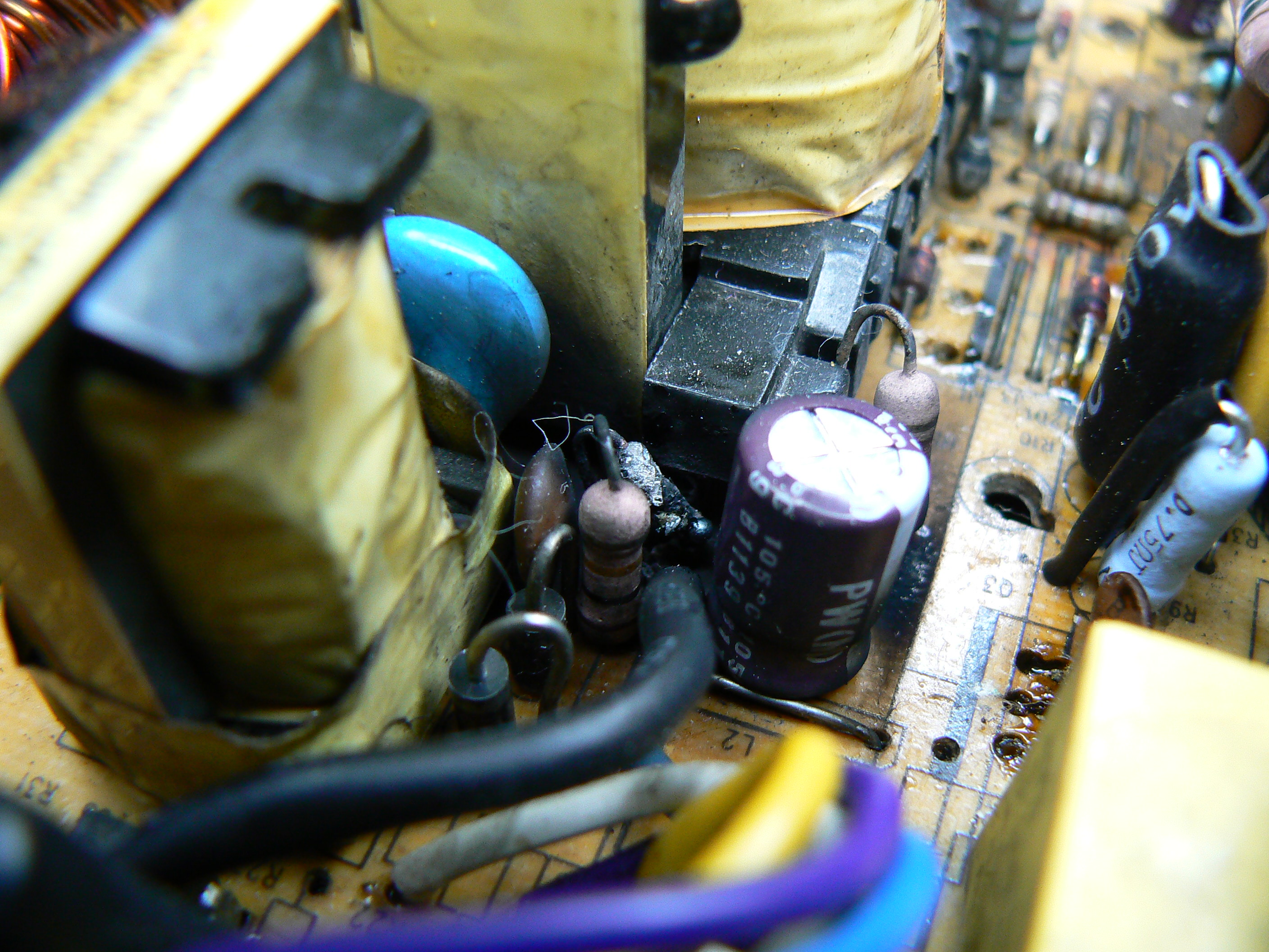

    I was finally able to take this supply apart to see what had been damaged. There were more components damaged than what I have posted pictures of but the rest did not have any visible damage so I am not bothering to post them. I am now in the process of scrounging up replacement parts, so I am not sure how long it is going to take for me to get this supply back together so I can continue testing.

      Re: Antec SL-400 5vsb Mod with NCP1200
      ^Oooo ahhh!
      Did you have the whole control board removed, or did you forget to attach the feedback to the opto-isolator? Or, did you make a silly boo-boo, er, shorted pcb trace?
        The control board was laying off to the side on the table when I applied power. Hopefully I will not make that mistake again.
          I don't know how else it could have exploded besides bad soldering, bottom of the board touching the psu case, or, you had floating wires inside the thing since you removed the control board.
            I do not think the soldering was the problem but at this point who knows. That supply has not been in a case since I got it working many months ago and it was upside down when I powered it on so that I could probe around to see if I could find any problem areas. I think the FET may have been damaged and I did not catch it or the gate was "floating" on, but I have no evidence one way or the other at this point. All I can do now, is put Humpty back together and try not to push him back off the wall again as I did in this situation. I want to save that for the load tests.
              If there is not pull down resistor for the mosfet, then yes, it most likely charged up by itself and turned ON.
              Next time, use a lightbulb (~60 watts should be good) in series with the power supply, so a short circuit won't make things explode as badly!
                Without the board I do not think there is a pull down resistor, which is something I will probably change.

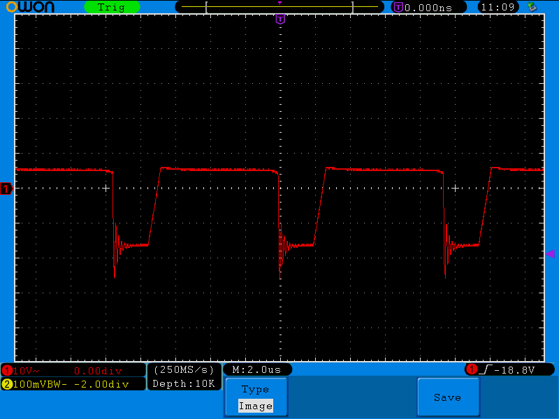

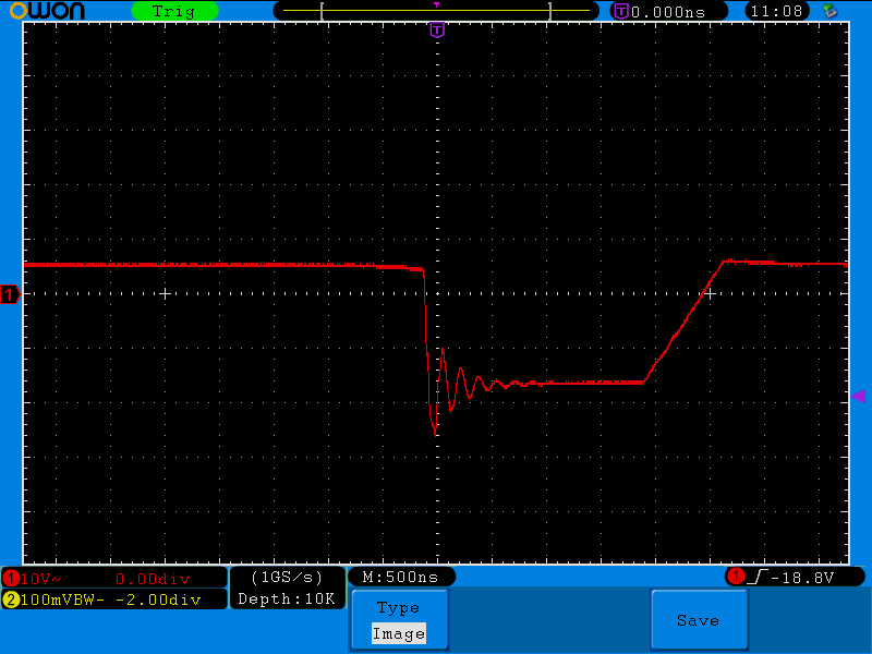

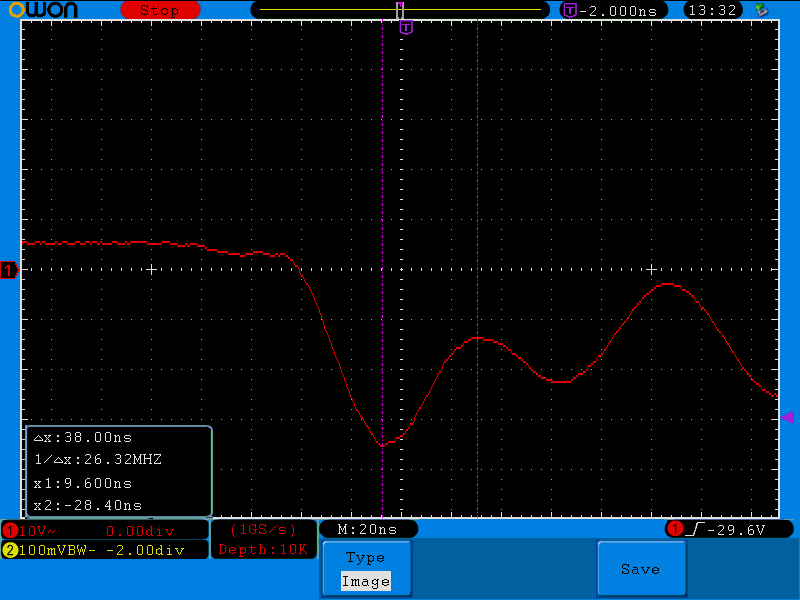

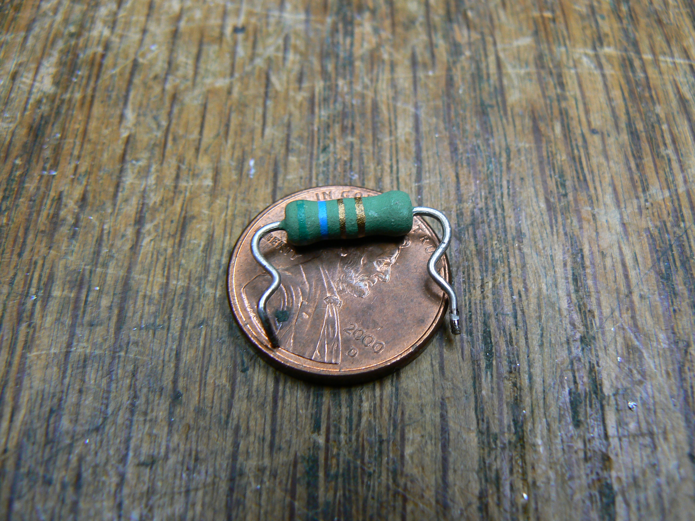

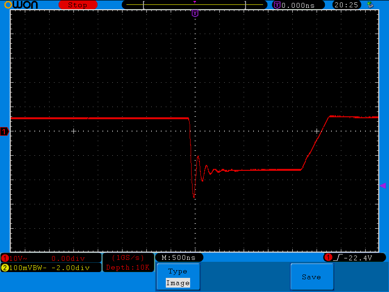

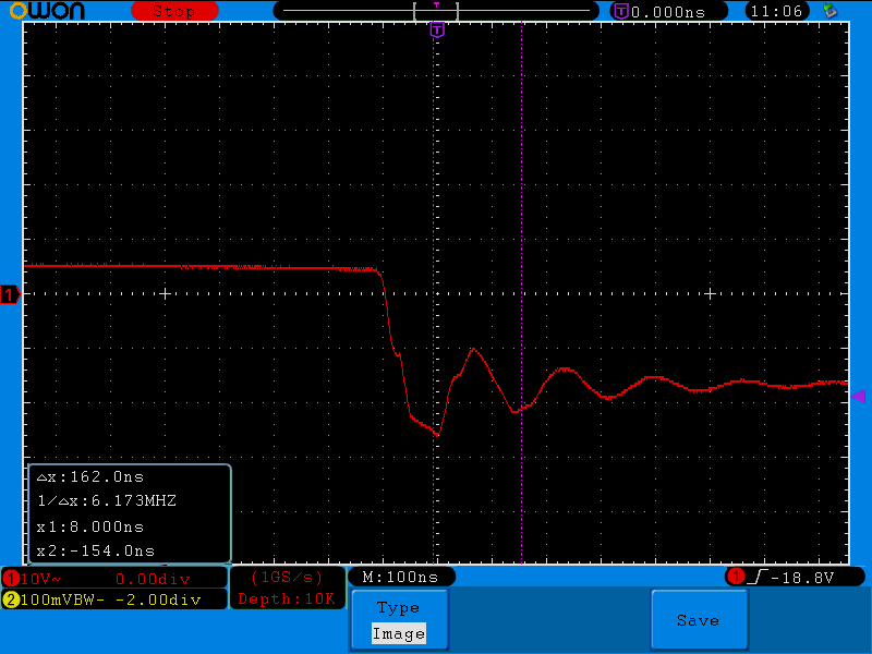

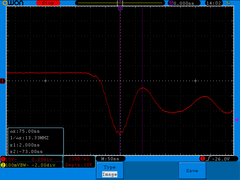

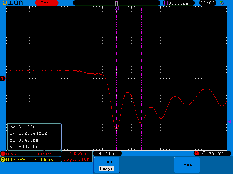

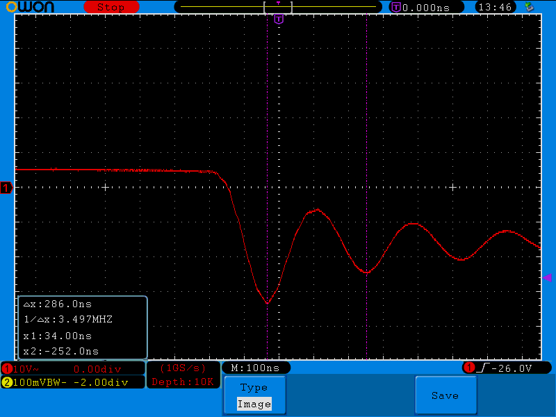

                      I did some testing with four different capacitor values to narrow to the best choice for a snubber. Since with no snubber I was getting a time of 34nS I was looking for something to give me about 68nS.
                      1nF=38nS
                      10nF=286nS
                      3.3nf=75nS
                      2.2nf=64nS
                      The the attached scope shots are in the same order as listed above.
                      I am not sure which of the last two values are the best choice or if it makes much difference.
                      If I did my calculations correctly, I need a resistor of approximately 5 ohms if I use the 3.3nF capacitor or a resistor of approximately 8 ohms if I use the 2.2nF capacitor. So far the closest values I have been able to find in my junk piles or stocks is a 1 ohm and 10 ohm resistor. I am thinking that unless I find something else, the 2.2nF and 10 ohm resistor may be my best option. I am not sure how important the it is for the resistor value too be dead on nor how altering it will affect result.
                      If I can find it, I think I would rather use a 4.7 ohm resistor with the 3.3nF capacitor.
                      Any constructive comments or input would be appreciated.
                        I found a 5.6 ohm resistor so I decided to use it along with the 3.3nF capacitor. All the scope shots are done with the same 3.2 ohm load used in the previous scope shots, except the last one which has a 2.0 ohm load. Increasing the output current did not seem to make much difference in the voltage spike with the snubber in place. Now I should be able to resume my load testing, at least until something else pops.

                          #72
                          I was just looking over the graphs I posted in post #70 and realized that I did not place the second cursor in the wrong spot in the 1st, 3rd and 4th shot. Just eyeballing the first graph it looks like the 1nF capacitor more than doubled the original 34 nS so it looks like I am going to have to back up and start over with my snubber calculations. Oh well the results so far have been interesting, to me at least, so actually using the correct values for the snubber should only improve the results.

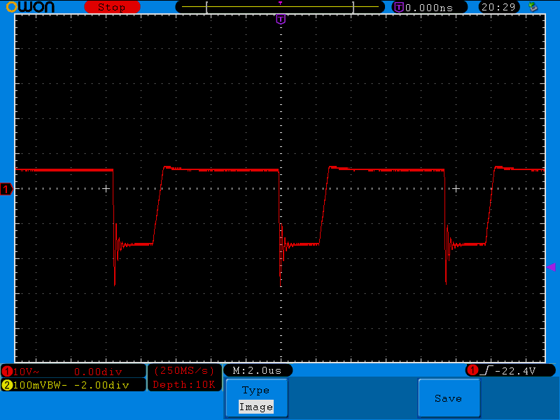

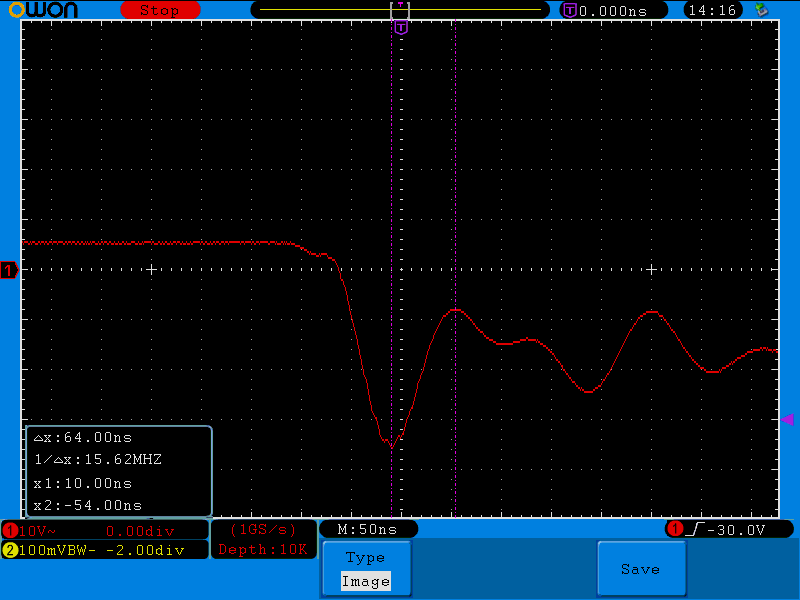

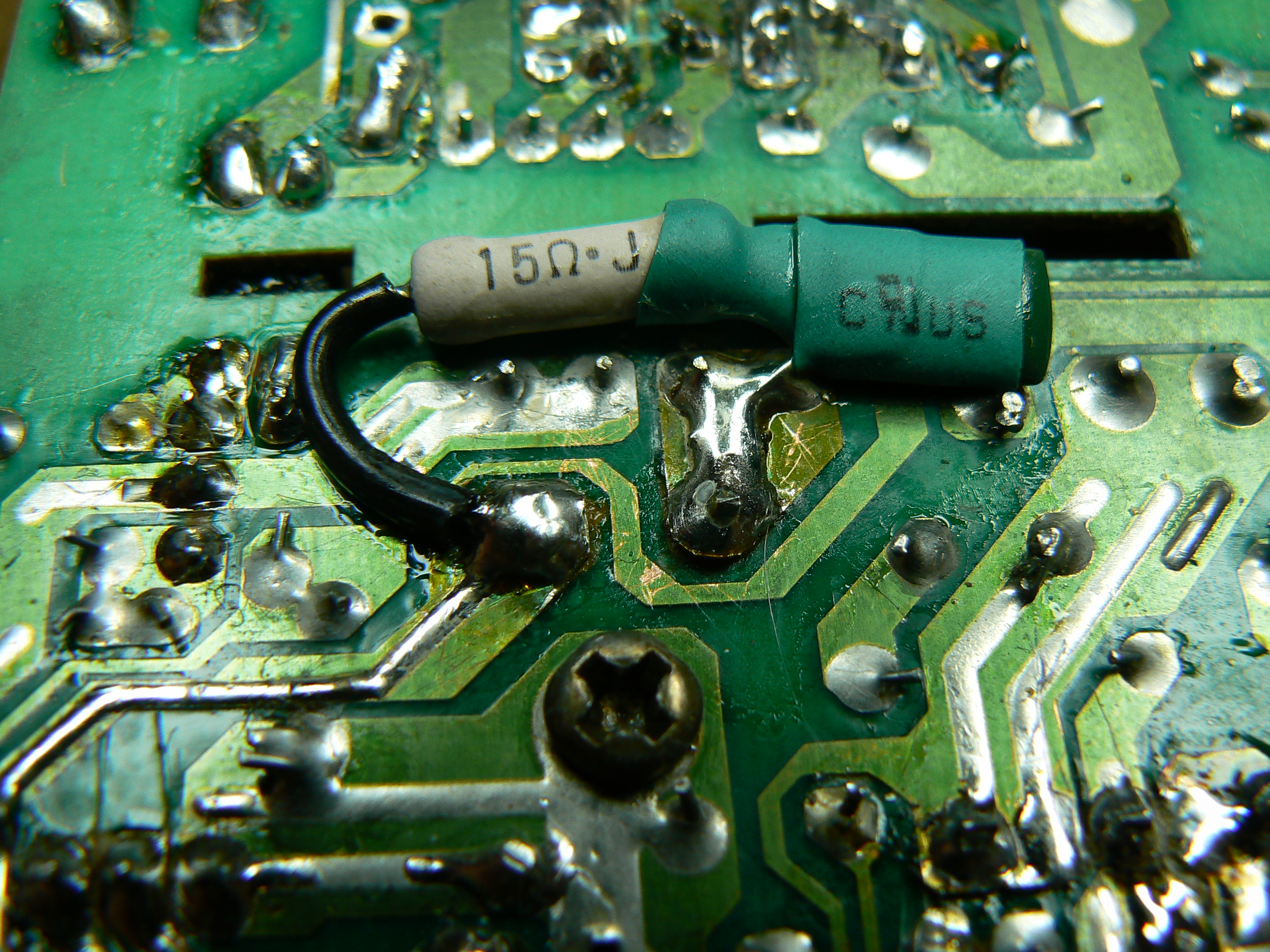

                            #73

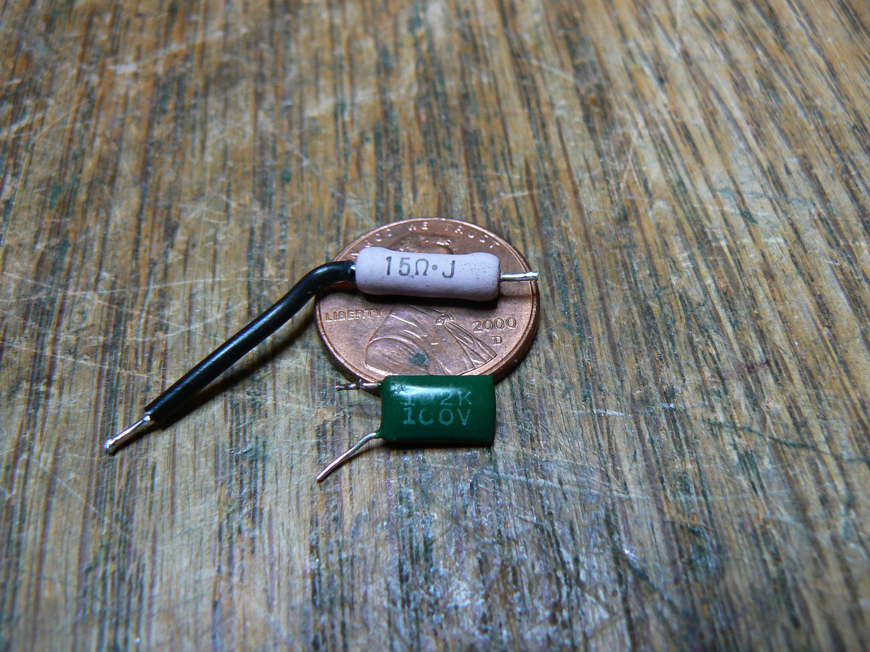

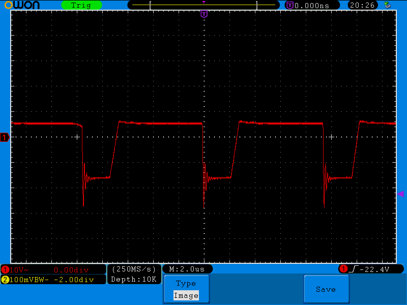

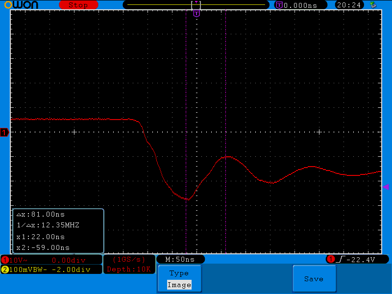

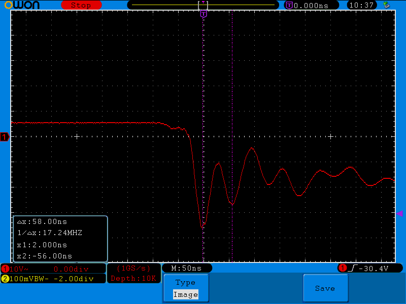

                            Well I did the capacitor test for the snubber circuit again.
                            1 nF = 75nS (First attached picture)
                            560pF = 58 nS (Second attached picture)
                            I could not find any other values in between these two so I just went with the 1nF capacitor. I calculated the associated resistor should be 16 ohms. I had a 15 ohm resistor handy so that is what I used.
                            The rest of the scope shots (attached pictures 3-5) are with the snubber in place.
                            Not too much difference from the previous snubber but it does appear to be a slight improvement.

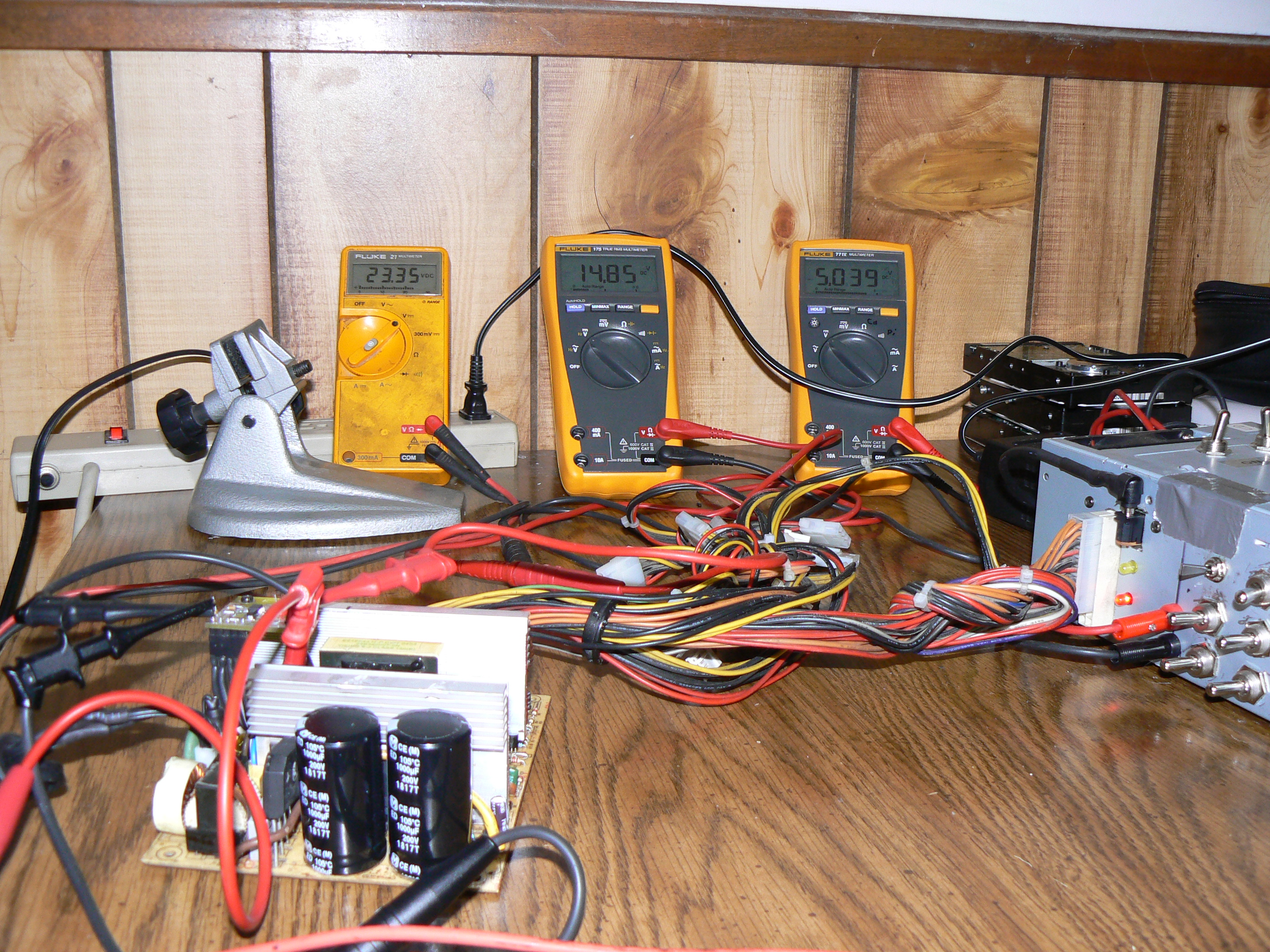

                              While I was working on another supply today I decided it was a good opportunity test this supply off to the side. My goal was to get 5A out of the 5vsb for a minimum of 1 hour.
                              Everything started off good. I had a load setup of 1.0 ohms. I was getting 4.935V out of the supply. Fifteen minutes later I check on it and I am getting 4.945V, everthing is looking good. I had my scope connected to the output diode the same as when I was testing the snubber just as another way to monitor the operation. At thirty minutes into the test I look over and notice the output on the scope was not longer stable. As I go to kill power to the supply I hear some bad noises coming from the supply and then I smell burnt electronics.
                              So far I have only given it a cursory examine and I could not find anything that was bad. I am beginning to have doubts that I am going to be able to achieve my goal, however I have not yet given up all hope. Once I find out what failed, I will try to find a heavier replacement so I can give it another try.

                                #75
                                My guess is the transformer is overloaded. It's simply not designed for 25 watts!... Did you check to see what parts were hot? It's handy to have an infra-red thermometer around...
