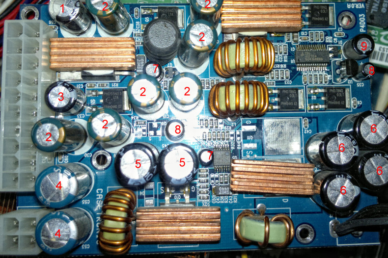

Hello, I have this m ATX PSU, in my old via-epia MIII 10000 PC.
The PSU is dead 3rd time.
So I decided to replace all caps !
Here is how the PCB looks like, The caps are:
1. 1x SACON 1000uF 10v 8x15mm
2. 5x Jamicon 1000uF 10v 8x20mm
3. 1x STONE 470uF 16V 8x11mm
5. 2x SACON 1000uF 16V 10x17mm
6. 4x STONE 470uF 35V 10x15mm
7. STONE 47uF 16v 6.5x8mm
8. STONE 10uF 25v 4x8mm
9. STONE 100uF 16v 6.5x8mm
Looking forward what to use to replace them.
The 1000uf I think I should replace them with Rubycon ZLJ 1000uF 16v
The 4x STONE 470uF 35V 10x15mm with Rubycon ZLH 470uF 35v
