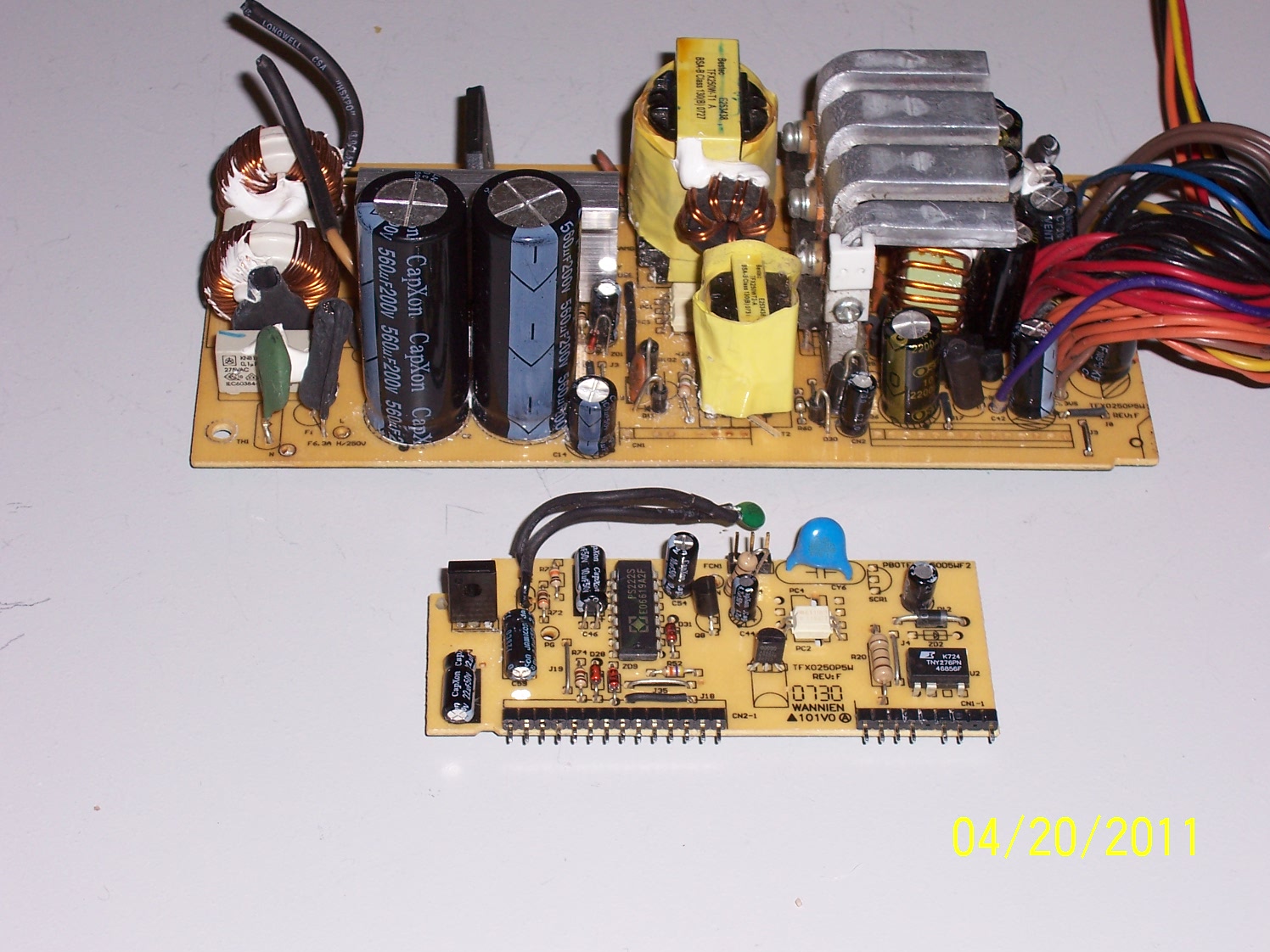

Had a Bestec TFX0250D5W come my way. It had several bloated capacitors. So I thought I would try replacing them and see if that fixed it. It didn't fix it! Here are some pictures I took of another Bestec, same model, not as many bloated capacitors. The earlier Bestec that I fixed was a dead 5vsb with bloated C36 capacitor. This one had a handful of bloated capacitors.
					Repairing Bestec TFX0250D5W
 Re: Repairing Bestec TFX0250D5W
 After replacing the bad caps, the power supply tester LEDs just blinked, the fan just gave a tick. So I measured the output diodes thinking that maybe one was bad. No, they all checked good. So I started tracing the output circuit to see what was in this power supply. To my surprise, there are NO load resistors on the output rails. So I set up a jig with a 12 ohm resistor for the 12 volt rail, a 5 ohm resistor for the 5 volt rail, and a 3.3 ohm resistor for the 3.3 volt rail. The power supply now came up working as expected.
 The reason for writing this post..............make sure the power supply you are working on has load resistance on the output rails - or you may be chasing a ghost.

 I also have a Bestec TFX0250D5W and need some info on replacement MOV. I have two blown MOV and I can see some info on one of them, TRV 07241, but I'm not finding this available in the USA. Shipping from outside the USA takes too long right now so I would like to find an equivalent replacement.
 The MOV are ZR1 & ZR2, they are connected to the wire coming from the voltage selection switch, and to + voltage and ground, after the bridge rectifiers. Pics attached.Comment

 The placement of those MOVs is pretty standard for older PSUs like this: one in parallel to each input 200V mains capacitor. The MOVs protect these caps from over-voltage due to surge or whatever other external factor.
 That being said, since both of your PSU's MOVs blew, you might want to check first if something else didn't go bad. Most likely the fuse on the input has gone bad, and possibly the NTC thermistor as well. Bridge rectifier can sometimes go bad from that as well. If you have replaced those parts already and nothing else appears to be bad, you can actually test the PSU without the MOVs, just to verify if the PSU is working at all after whatever caused these MOVs to blow. The MOVs are there only for surge protection, so they aren't actually necessary for the operation of the PSU. Of course, they are good to have in the even of over-voltage / surge to prevent more damage to the rest of the circuit. On the negative side, they do sometimes happen to fail by themselves from old age. That's because over many years, they probably have seen many "micro" surges. Every time one of these MOVs has had to operate (clamp) a surge voltage, a little part inside it gets destroyed and makes the MOV more likely to conduct next time. So overtime, that can make them fail by themselves, so to speak.
 On the other hand, since both MOVs blew at the same time, you may also want to check your house's wiring. In particular, check the AC voltage at the plug where the PSU was plugged in and monitor it for a while - especially when a high-power device comes On in your house. If living in a house with dual-phase 120V AC supply (most single homes and townhouses in the US), an open/bad Neutral can cause some plugs in your house to go much above 120V AC, while letting others sink way below that. If you turn on a high-power device in your house and some lights flicker or go dim while other seem to go lighter (well, I guess this may not apply so much anymore, now that people have switched to LEDs and CCFL light bulbs), that's definitely a sign of your house's Neutral connection opening or going bad... and if so, you ought to call your electric supply company right away, as this is actually an electrical fire hazard.
 And finally, for replacement MOVs... you really just need ones that are rated for 200V DC. Looking at some other PSUs, these part numbers should work too:

 Thanks momaka, this is good info. The computer, and several household appliances and the air conditioner sufferd from a surge during a thunderstorm. Not my house, my brother-in-law's mothers house. If that wasn't bad enough, the power company was trying to restore power while her power meter box was ripped off the house by a tree limb, and exposed wires were on the ground shooting sparks. I'm trying to get the PC running again so she can play her games. Also, I know I could just replace the power supply, but this is a bit of hands on education for me. The fuse, bridge rectifier and two MOV appear to be the only components blown. I'm currently trying to find one source for the components, so I don't have to pay separate $8.00 shipping for parts that are less than a dollar each. Hopefully your replacement suggestions will help with this. Thanks so much!!!!!!!Comment

 You might want to look at the inrush limiter thermistor, the green disc next to the fuse. It looks like it is chipped, and it might be cracked.
 BTW, that power supply is almost 11 years old, very decent product life.PeteS in CA

 PeteS, the inrush thermistor measured 3.4 ohm. There is no damage on it but some white adhesive is on it.
 BTW, tried to do some testing while waiting for the MOVs to come in and blew the 5v stand-by control chip, U2 (TNY276PN). Ordered some of these too. I had replaced the bridge rectifiers diodes and fuse and the chip blew as soon as I plugged the PS into the outlet. I hope it was already damaged and I don't end up blowing up the new chip.
 The hot side power was normal when I checked it after the chip blew.Comment

 Yes, sounds like it was damaged already from before. Of course, before putting in new TNY276 chip, check its surrounding components for faults. Otherwise, this could repeat.BTW, tried to do some testing while waiting for the MOVs to come in and blew the 5v stand-by control chip, U2 (TNY276PN). Ordered some of these too. I had replaced the bridge rectifiers diodes and fuse and the chip blew as soon as I plugged the PS into the outlet. I hope it was already damaged and I don't end up blowing up the new chip.
 Also, to actually test the PSU in a safer way (or at least the 5VSB circuit and the main PSU without any load), you can put a incandescent (or halogen) light bulb (40-100 Watts typical) in series with the PSU's input, like this:
 https://www.badcaps.net/forum/showpo...4&postcount=70
 The above method should prevent the new stndby IC from blowing up, as well as the fuse and anything else on the primary side.
 First, just hook the PSU with the series bulb and see if the 5VSB comes up correctly. If it does, you can try shorting the PS_ON (typically green wire) to ground to turn on the PSU - but do so without any load (or very light load, such as a PC fan or two or an old useless HDD... or 12V car bulbs.)
 The incandescent (dim) bulb "trick" works with many PSUs (switching and linear)... though there are a few exceptions, like for example, switching PSUs with APFC circuit. In the case of the Bestec in this thread - it's an older design SMPS without APFC circuit, so dim bulb trick will be OK with it.Last edited by momaka; 10-19-2021, 07:15 PM.Comment

 Momaka, Thanks for your help with this PSU. The lamp worked wonderfully, although turns out I didn't have any issues when the PSU came to life. I ended up replacing the two MOV, using parts you suggested, the fuse, bridge rectifier and TNY276PG. Overall I'd say the PSU took the lightning strike pretty well. Momma "O" will be tickled pink to get her computer back . .Comment
