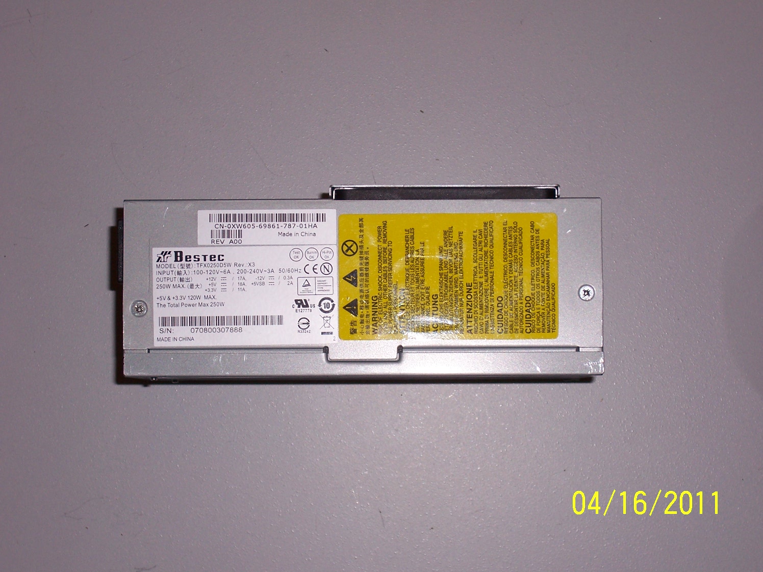

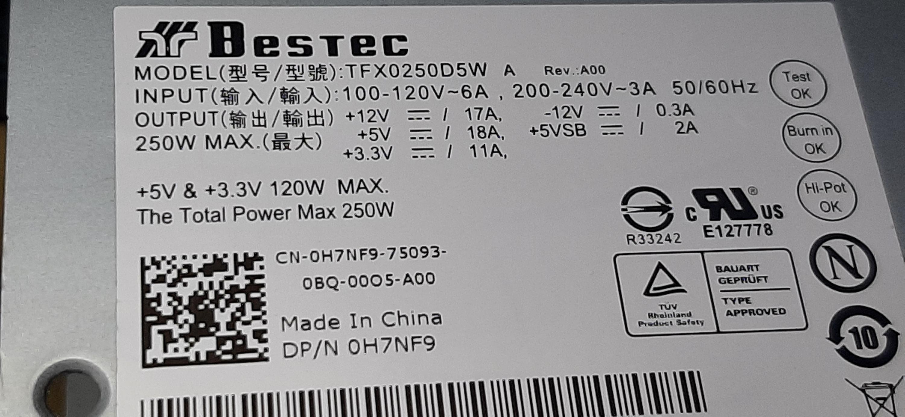

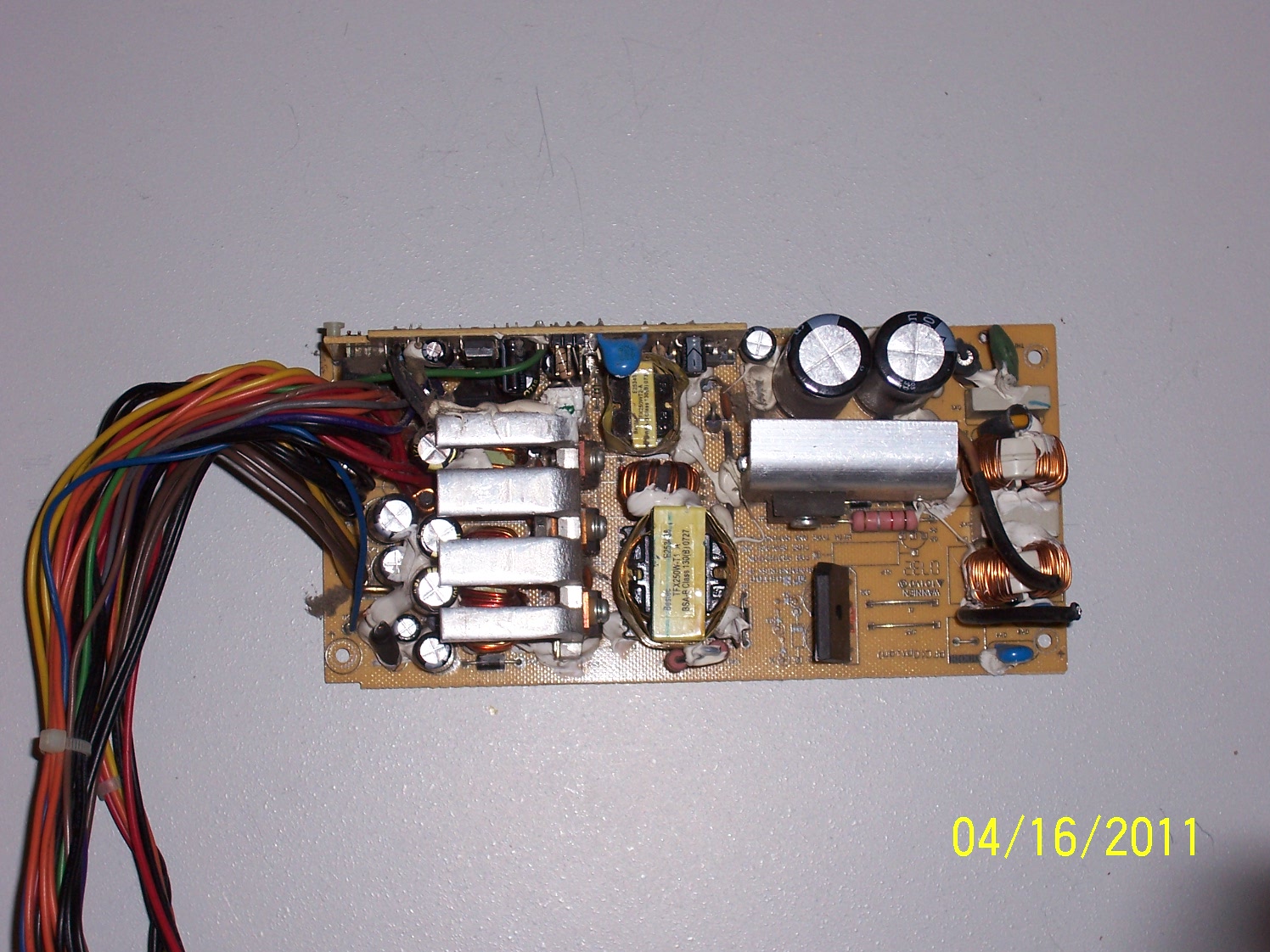

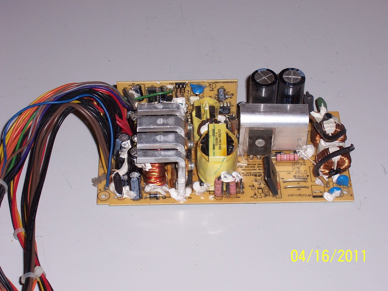

Had a Bestec TFX0250D5W come my way. It had several bloated capacitors. So I thought I would try replacing them and see if that fixed it. It didn't fix it! Here are some pictures I took of another Bestec, same model, not as many bloated capacitors. The earlier Bestec that I fixed was a dead 5vsb with bloated C36 capacitor. This one had a handful of bloated capacitors.
Repairing Bestec TFX0250D5W
Re: Repairing Bestec TFX0250D5W

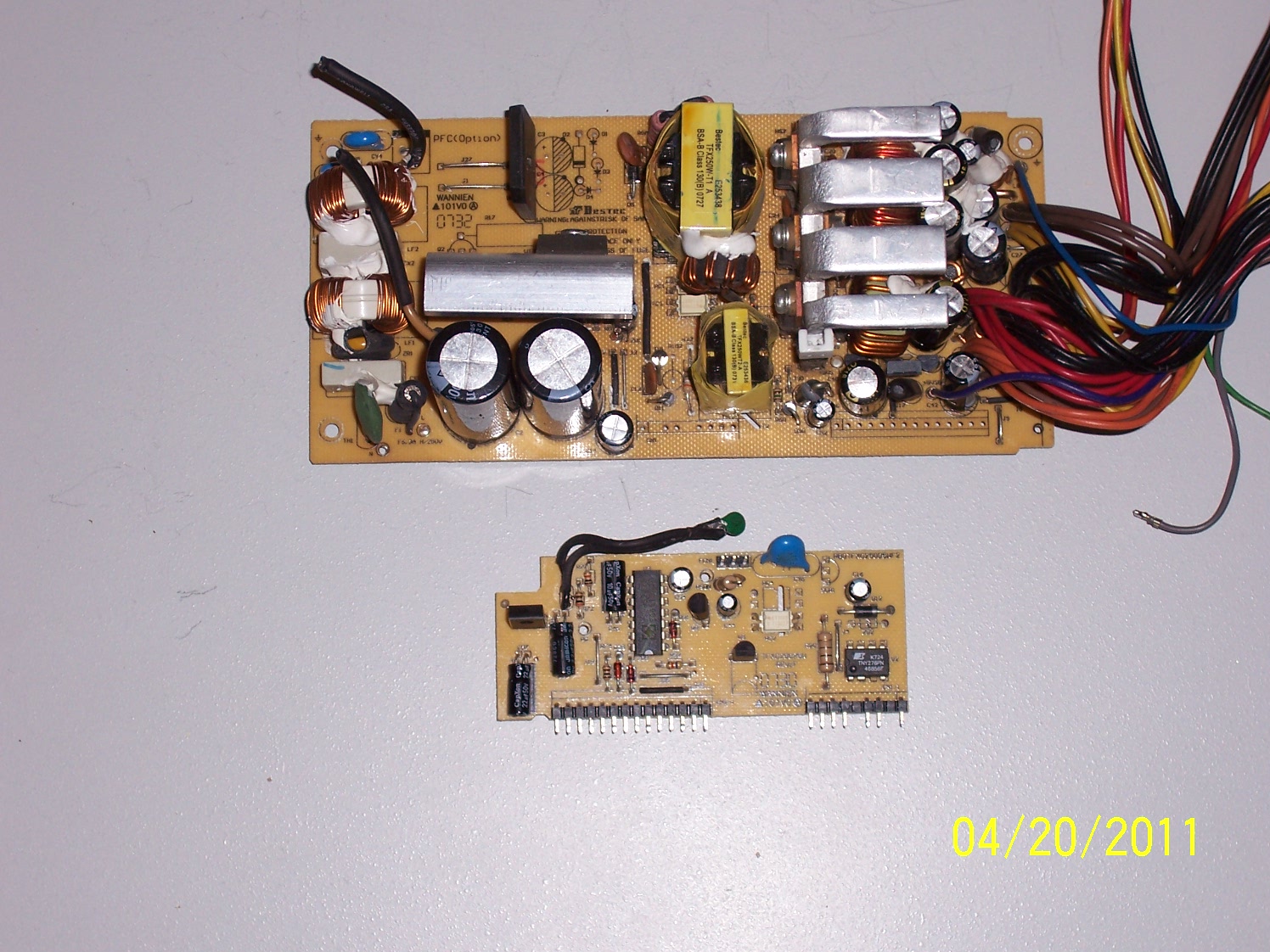

After replacing the bad caps, the power supply tester LEDs just blinked, the fan just gave a tick. So I measured the output diodes thinking that maybe one was bad. No, they all checked good. So I started tracing the output circuit to see what was in this power supply. To my surprise, there are NO load resistors on the output rails. So I set up a jig with a 12 ohm resistor for the 12 volt rail, a 5 ohm resistor for the 5 volt rail, and a 3.3 ohm resistor for the 3.3 volt rail. The power supply now came up working as expected.
The reason for writing this post..............make sure the power supply you are working on has load resistance on the output rails - or you may be chasing a ghost.
For anyone else working on this particular model Bestec, here are some drawings of the 5vsb circuit and the output circuit. Also a roadmap of the output capacitors. Perhaps this will be helpful to someone.Old proverb say.........If you shoot at nothing, you will hit nothing (George Henry 10-14-11)

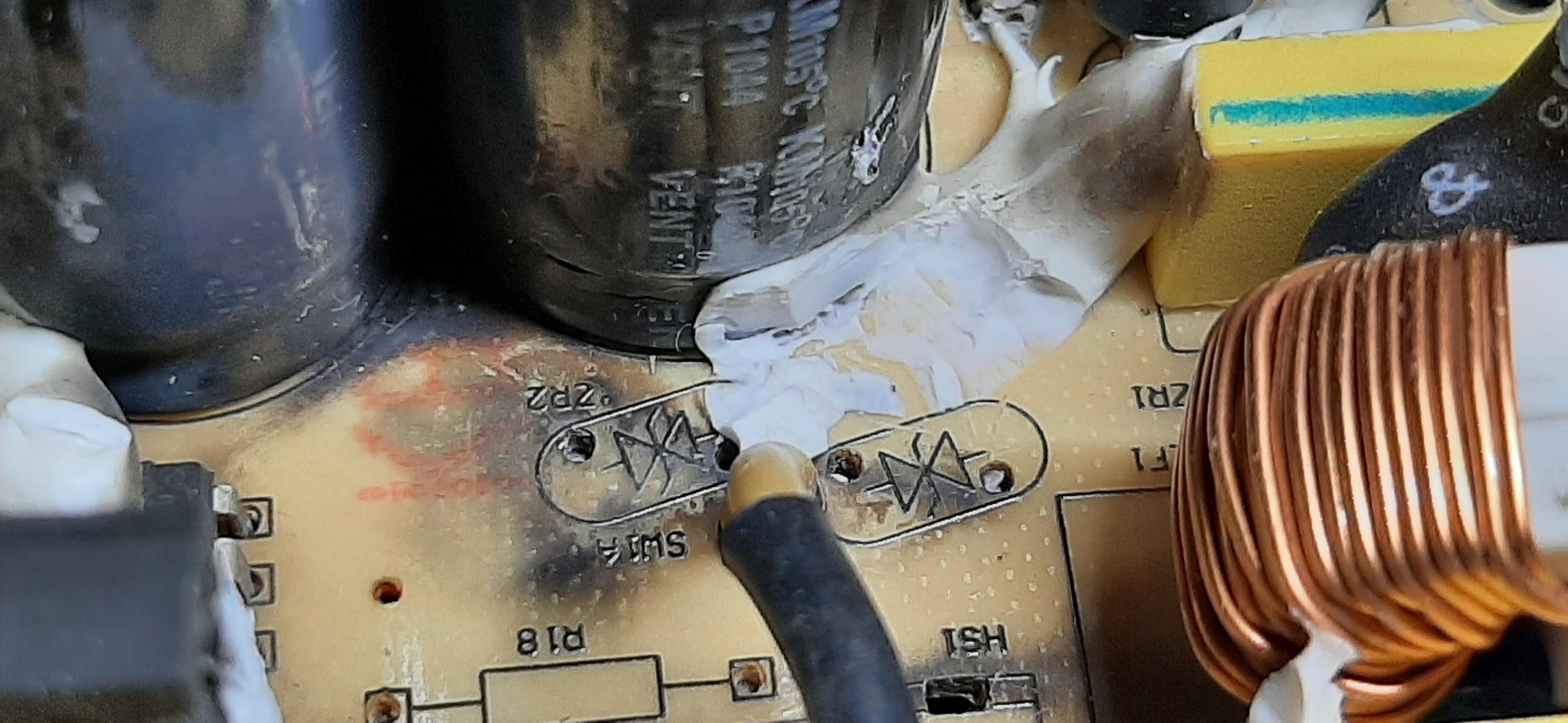

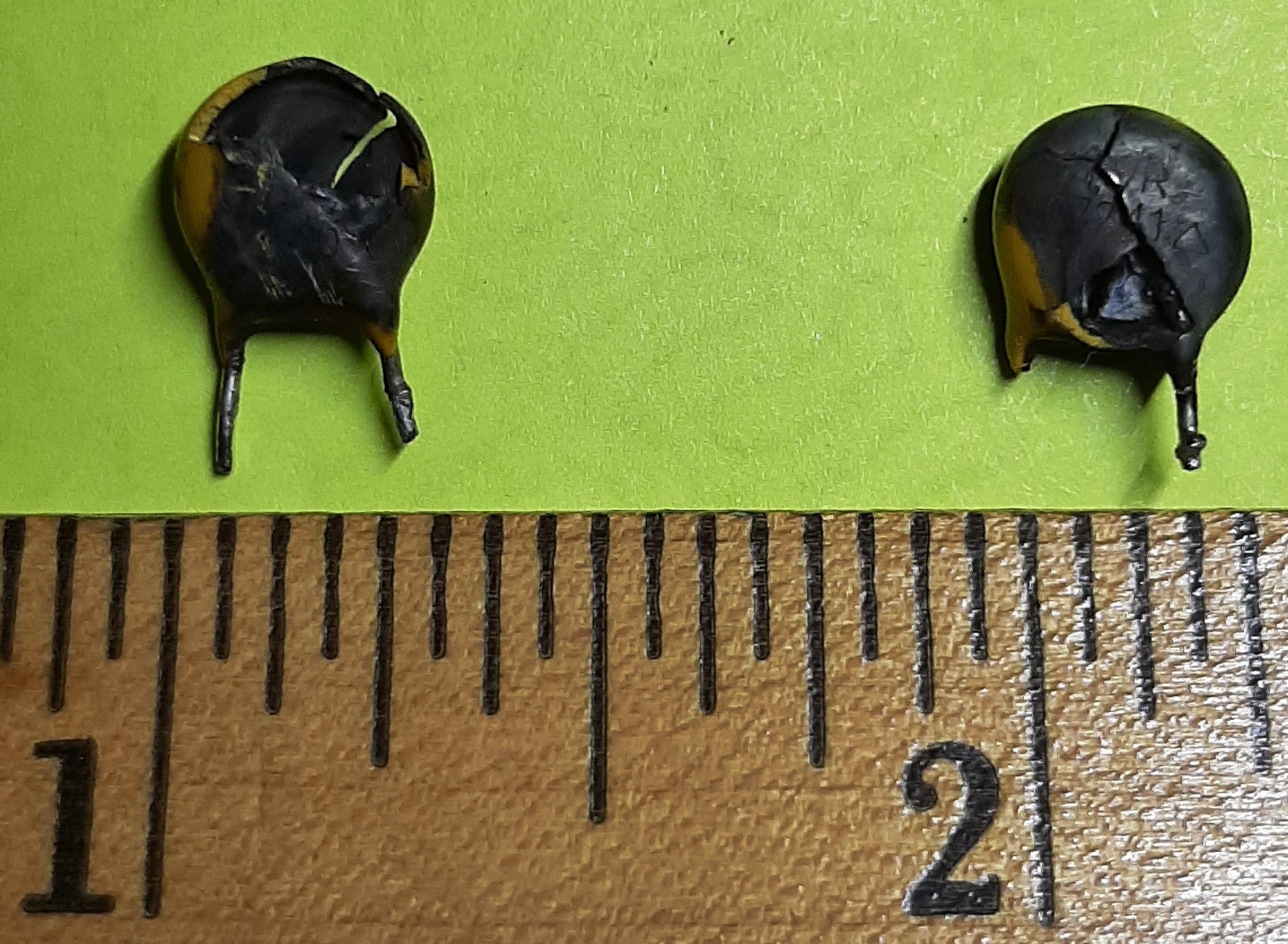

The MOV are ZR1 & ZR2, they are connected to the wire coming from the voltage selection switch, and to + voltage and ground, after the bridge rectifiers. Pics attached.

The placement of those MOVs is pretty standard for older PSUs like this: one in parallel to each input 200V mains capacitor. The MOVs protect these caps from over-voltage due to surge or whatever other external factor.
That being said, since both of your PSU's MOVs blew, you might want to check first if something else didn't go bad. Most likely the fuse on the input has gone bad, and possibly the NTC thermistor as well. Bridge rectifier can sometimes go bad from that as well. If you have replaced those parts already and nothing else appears to be bad, you can actually test the PSU without the MOVs, just to verify if the PSU is working at all after whatever caused these MOVs to blow. The MOVs are there only for surge protection, so they aren't actually necessary for the operation of the PSU. Of course, they are good to have in the even of over-voltage / surge to prevent more damage to the rest of the circuit. On the negative side, they do sometimes happen to fail by themselves from old age. That's because over many years, they probably have seen many "micro" surges. Every time one of these MOVs has had to operate (clamp) a surge voltage, a little part inside it gets destroyed and makes the MOV more likely to conduct next time. So overtime, that can make them fail by themselves, so to speak.
On the other hand, since both MOVs blew at the same time, you may also want to check your house's wiring. In particular, check the AC voltage at the plug where the PSU was plugged in and monitor it for a while - especially when a high-power device comes On in your house. If living in a house with dual-phase 120V AC supply (most single homes and townhouses in the US), an open/bad Neutral can cause some plugs in your house to go much above 120V AC, while letting others sink way below that. If you turn on a high-power device in your house and some lights flicker or go dim while other seem to go lighter (well, I guess this may not apply so much anymore, now that people have switched to LEDs and CCFL light bulbs), that's definitely a sign of your house's Neutral connection opening or going bad... and if so, you ought to call your electric supply company right away, as this is actually an electrical fire hazard.
And finally, for replacement MOVs... you really just need ones that are rated for 200V DC. Looking at some other PSUs, these part numbers should work too:
TVR 10241
Z151
There are many other too, but these are the ones I can recall seeing recently in a PSU.
After replacing the MOVs, make sure to install heatshrink tubing on them for shrapnel control (in case they blow again.) Same if original fuse was blown and you replaced it with a glass type. Glass fuses should be heatshrinked to contain glass fragments if the fuse blows.Last edited by momaka; 10-16-2021, 07:21 PM.

Thanks momaka, this is good info. The computer, and several household appliances and the air conditioner sufferd from a surge during a thunderstorm. Not my house, my brother-in-law's mothers house. If that wasn't bad enough, the power company was trying to restore power while her power meter box was ripped off the house by a tree limb, and exposed wires were on the ground shooting sparks. I'm trying to get the PC running again so she can play her games. Also, I know I could just replace the power supply, but this is a bit of hands on education for me. The fuse, bridge rectifier and two MOV appear to be the only components blown. I'm currently trying to find one source for the components, so I don't have to pay separate $8.00 shipping for parts that are less than a dollar each. Hopefully your replacement suggestions will help with this. Thanks so much!!!!!!!

^ Doesn't look to bad. Just need to clean the board well from all the soot where these two burned. IPA should work OK for that.
Output electrolytic caps could probably also use replacing with (if you'd like the PSU to last as long as possible), even though they don't look bad. Should be just a few more cents per cap to a $1 max. for the larger ones. Note: no need to replace the big 200V caps, unless they are bad... which hopefully are OK and the MOVs protected them. Otherwise, they'd be the most expensive thing to replace @ $3-4 ea. usually.

I think these might actually be drop-in replacements:
https://www.digikey.com/en/products/...7D241K/2407535
In case link above goes bad, these are Bourns Inc. MOV-07D241K (Digikey P/N: MOV-07D241K-ND)
Alternatively, there is also the LittleFuse V150LS2P (Digikey P/N: F5595TR-ND or F5595CT-ND):
https://www.digikey.com/en/products/...50LS2P/1009272
^ More or less the same thing as the first one above for more or less the same price.Last edited by momaka; 10-17-2021, 12:34 PM.

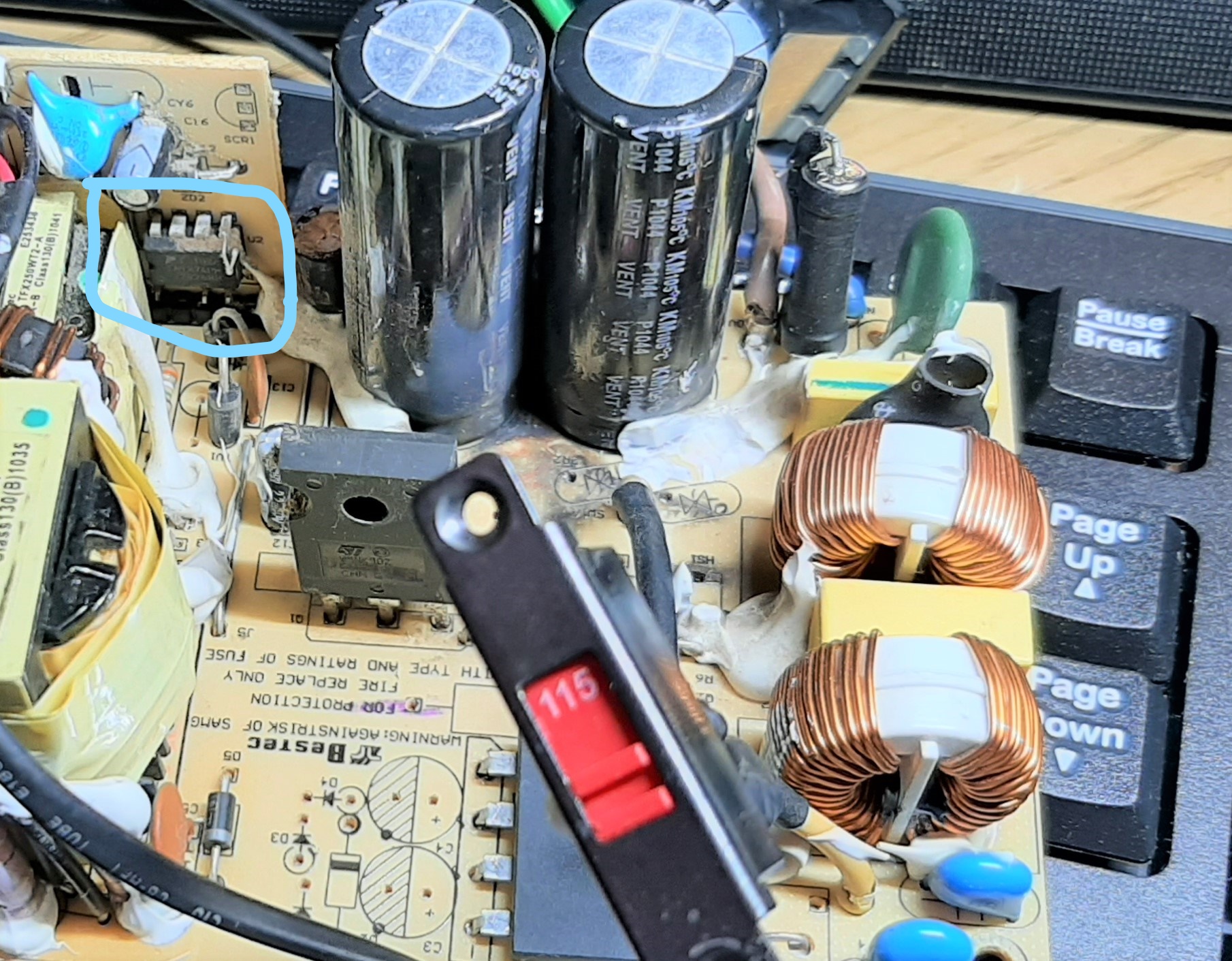

You might want to look at the inrush limiter thermistor, the green disc next to the fuse. It looks like it is chipped, and it might be cracked.
BTW, that power supply is almost 11 years old, very decent product life.PeteS in CA
PeteS, the inrush thermistor measured 3.4 ohm. There is no damage on it but some white adhesive is on it.

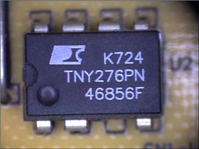

BTW, tried to do some testing while waiting for the MOVs to come in and blew the 5v stand-by control chip, U2 (TNY276PN). Ordered some of these too. I had replaced the bridge rectifiers diodes and fuse and the chip blew as soon as I plugged the PS into the outlet. I hope it was already damaged and I don't end up blowing up the new chip.
The hot side power was normal when I checked it after the chip blew.
Originally posted by lewisp69 View PostBTW, tried to do some testing while waiting for the MOVs to come in and blew the 5v stand-by control chip, U2 (TNY276PN). Ordered some of these too. I had replaced the bridge rectifiers diodes and fuse and the chip blew as soon as I plugged the PS into the outlet. I hope it was already damaged and I don't end up blowing up the new chip.
Also, to actually test the PSU in a safer way (or at least the 5VSB circuit and the main PSU without any load), you can put a incandescent (or halogen) light bulb (40-100 Watts typical) in series with the PSU's input, like this:
https://www.badcaps.net/forum/showpo...4&postcount=70
The above method should prevent the new stndby IC from blowing up, as well as the fuse and anything else on the primary side.
First, just hook the PSU with the series bulb and see if the 5VSB comes up correctly. If it does, you can try shorting the PS_ON (typically green wire) to ground to turn on the PSU - but do so without any load (or very light load, such as a PC fan or two or an old useless HDD... or 12V car bulbs.)
The incandescent (dim) bulb "trick" works with many PSUs (switching and linear)... though there are a few exceptions, like for example, switching PSUs with APFC circuit. In the case of the Bestec in this thread - it's an older design SMPS without APFC circuit, so dim bulb trick will be OK with it.Last edited by momaka; 10-19-2021, 07:15 PM.
Momaka, Thanks for your help with this PSU. The lamp worked wonderfully, although turns out I didn't have any issues when the PSU came to life. I ended up replacing the two MOV, using parts you suggested, the fuse, bridge rectifier and TNY276PG. Overall I'd say the PSU took the lightning strike pretty well. Momma "O" will be tickled pink to get her computer back.
