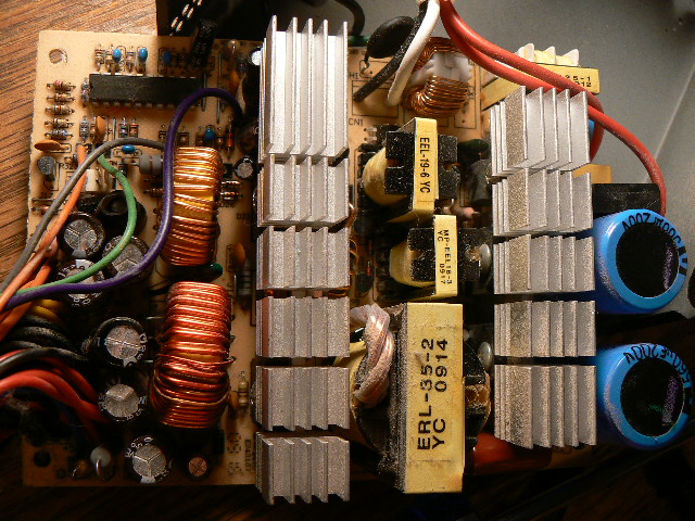

            Coolmax M-500B
            I put this supply in a computer I built for my mother in early 2010. This is the build:
            ASUS M4A78LT-M LE
            MSI N250GTS Twin Frozr 1G
            AMD Phenom II X4 925
            It ran this computer without a problem. However after learning a lot about capacitors from this forum I did a preemptive recap a couple of months ago. I like that it had a 140mm fan instead of the normal 120mm. I dislike the short connector leads. It is definitely not the best supply around but it is far from the worst I have seen. If I had known then, what I know now, I probably would not have bought it, however I felt it was good enough to keep using it after a recap.
            Edit:
            Fan is only a 120mm

              Re: Coolmax PSU's. Brand to avoid?
              ^ That's a 500W PSU? It only has 560uF input capacitors in a half bridge configuration... I think 300W continuous is a more realistic limit for it (maybe 350W at the most?), even with an 140mm fan...
                You may be correct in your assessment of its' real capability, all I know is what it has powered without any problems. Since it worked well for almost three years with crap caps I figured it would run that many or more with good ones. Time will tell.
                    I think I was mistaken about it being a 140mm fan, the Coolmax site says it has a 120mm. I must have confused it with another supply, I have been looking at a lot of them lately.
                      An 120mm fan is still certainly better than an 80mm fan. But...
                      Look at the review...
                      Link...
                      It cannot even get up to 200W with the ripple in spec; 160W seems to be its limit. It originally used JEE and Sapcon capacitors on the secondary and Tongjia capacitors on the primary so the fact that you recapped it with Japanese capacitors helps, though I'm not sure how much...
                        I am not sure just how similar those two supplies are. The V-500 in the review does not even have a bridge rectifier and the caps it uses look anemic. Like I said I most likely would not buy it knowing what I know now but it is not as pathetic as the one in the review nor a lot of other supplies I have seen.
                          True, the one in the review has 470uF input capacitors so with your larger input capacitors, bridge rectifier, and Japanese capacitors, you can probably do more (and it looks like your main switchers are TO-3P rather than TO-220 which also helps), though I still think 300W is a safe limit. If I'm not mistaken, though, your PSU doesn't have any MOVs, though I'm not sure how much that would hurt it in the long term.
