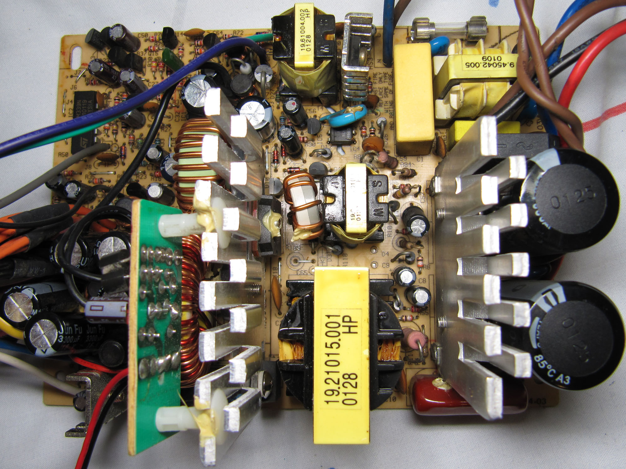

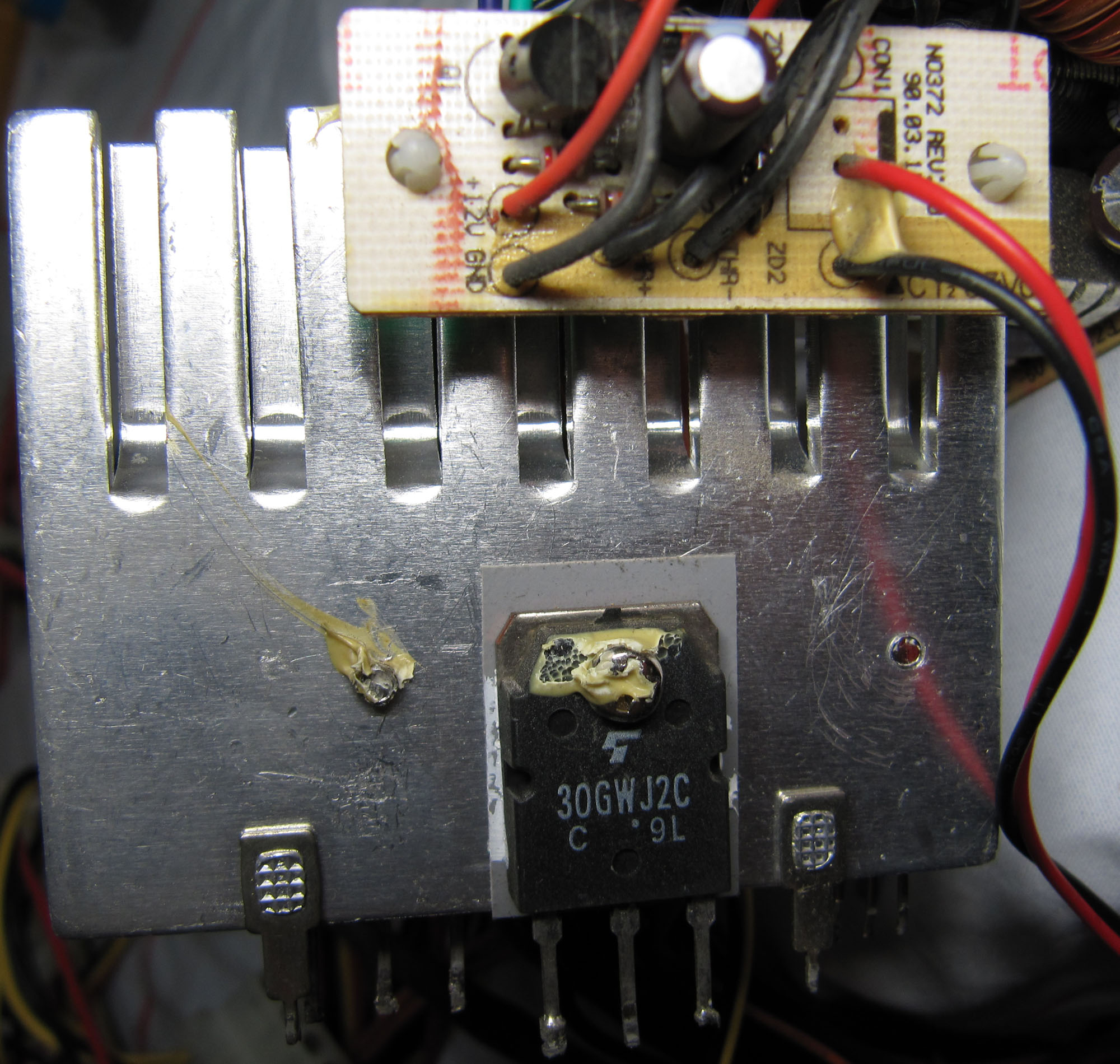

    This is the little brother of the Chieftec HPC-360-202 of the other thread I have created. I thought, since I fixed the other, why not fix that too?
    I have posted again about that power supply here.
    There are some interesting things about it.

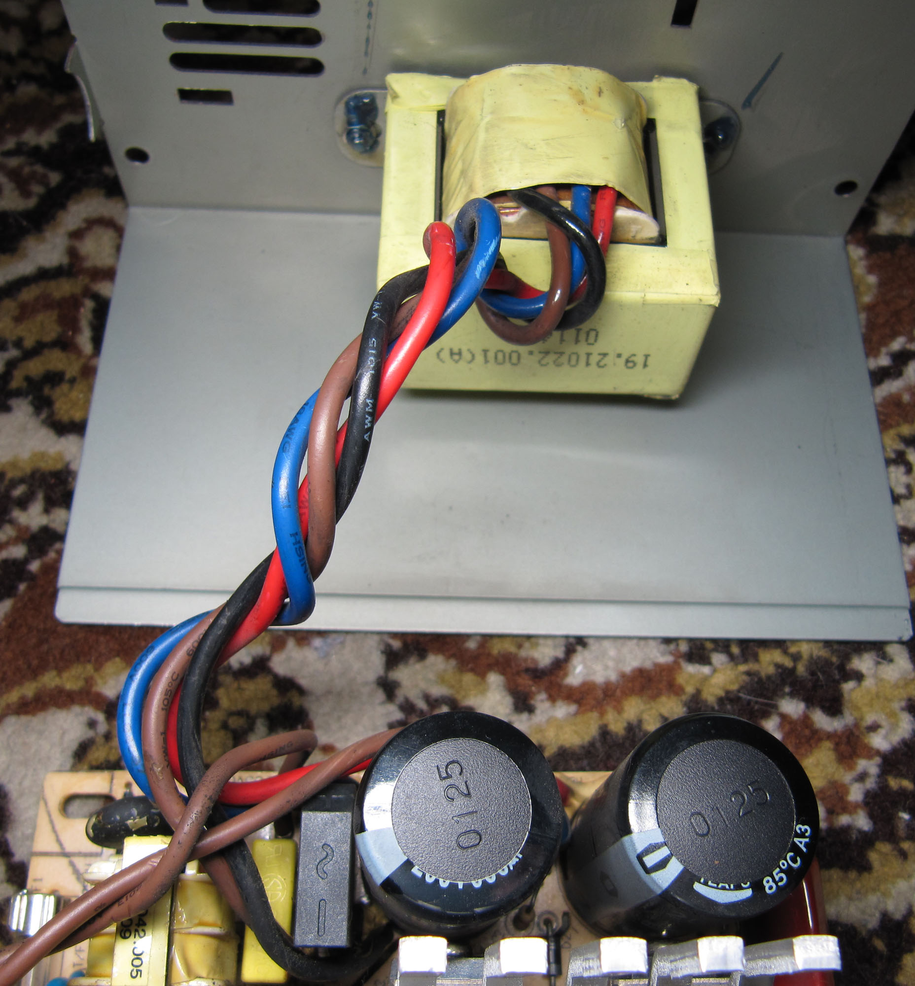

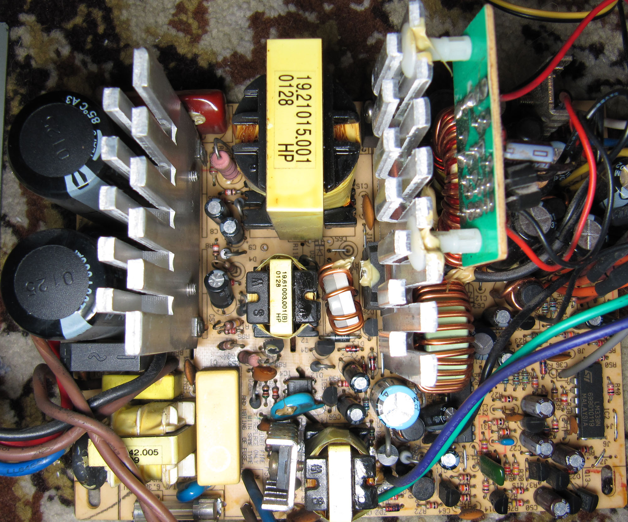

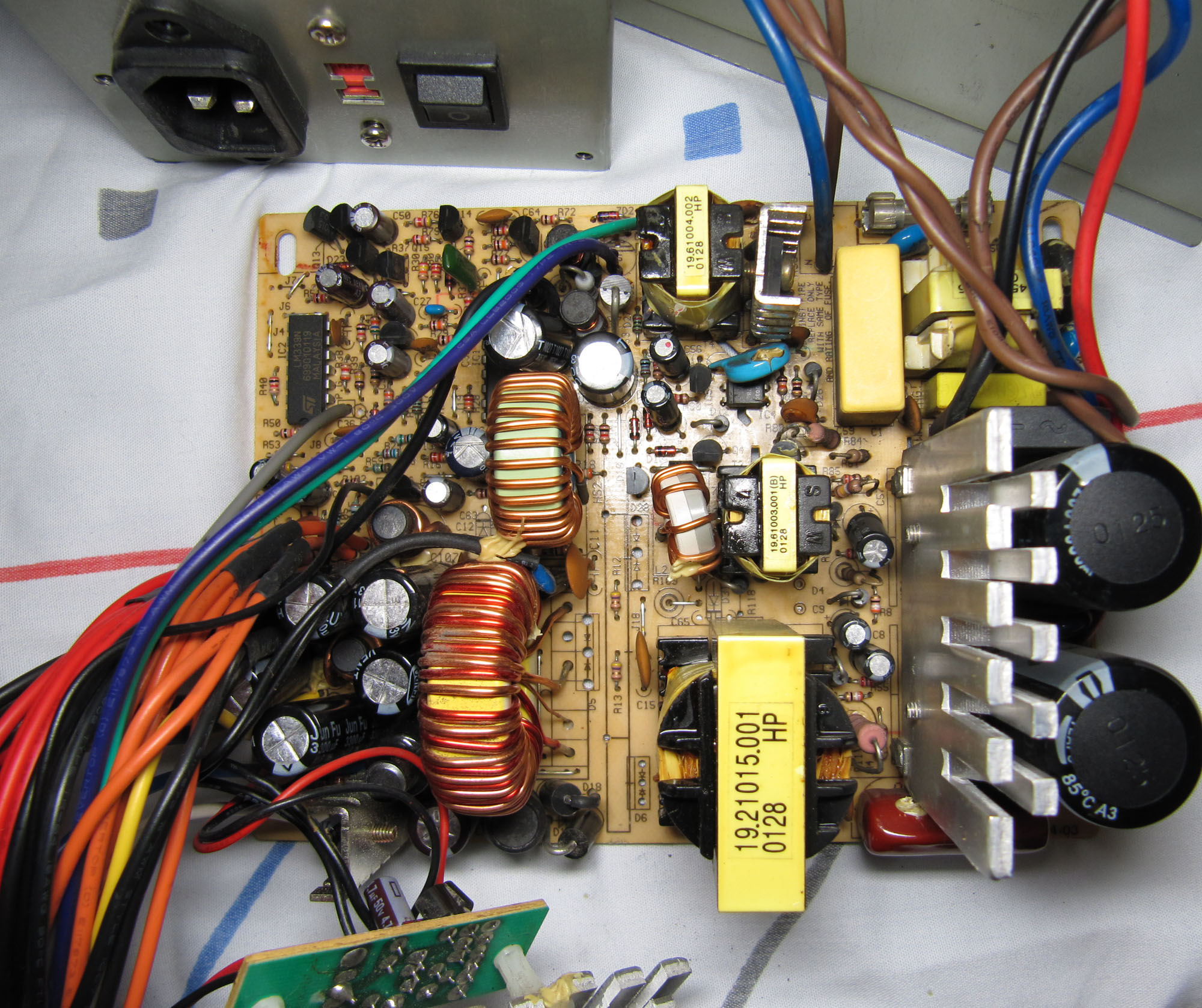

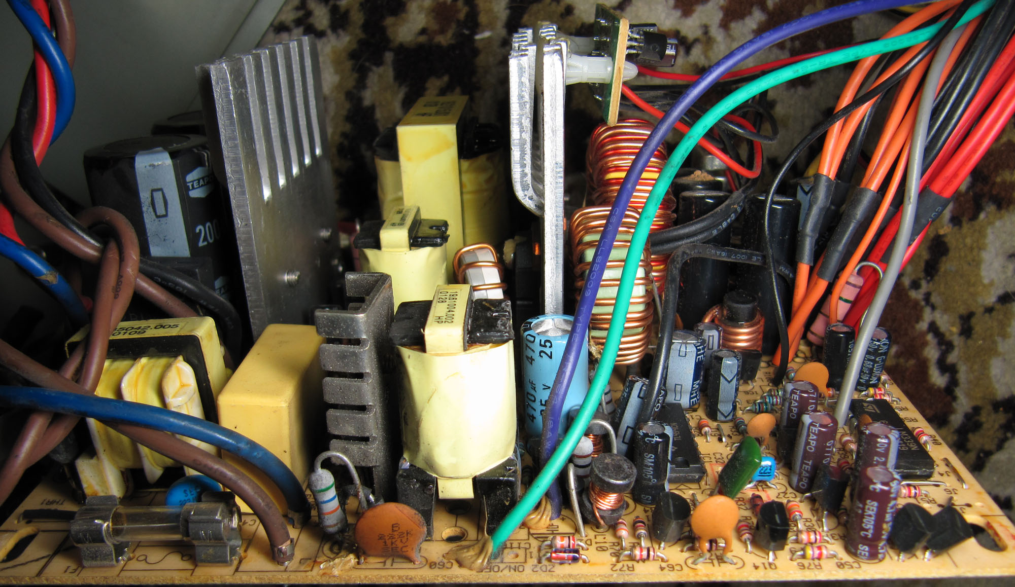

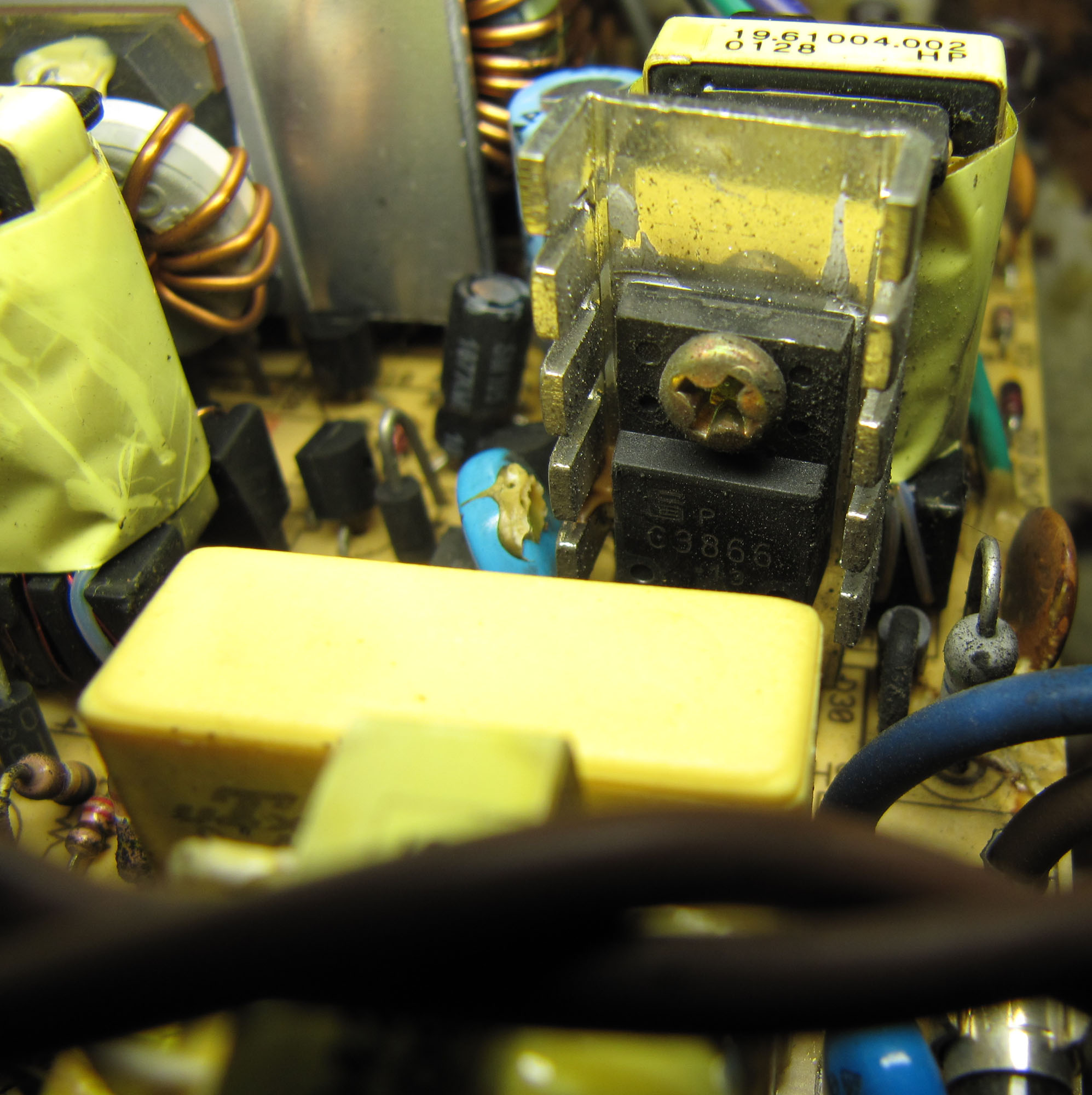

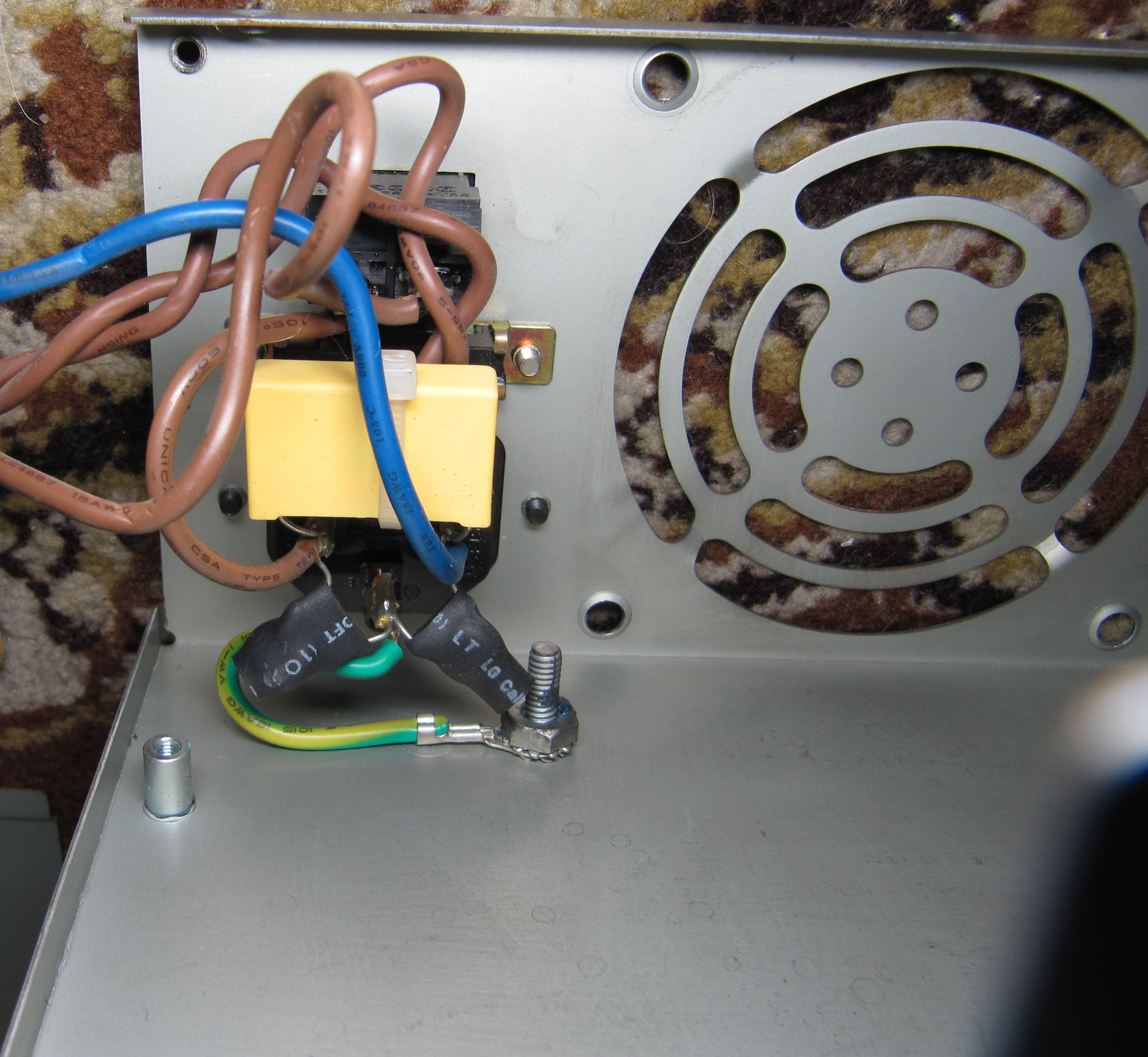

    The passive PFC is connected to psu with 4 wires, not 2! It is connected right after the bridge rectifier and is in series with both the + and the -.

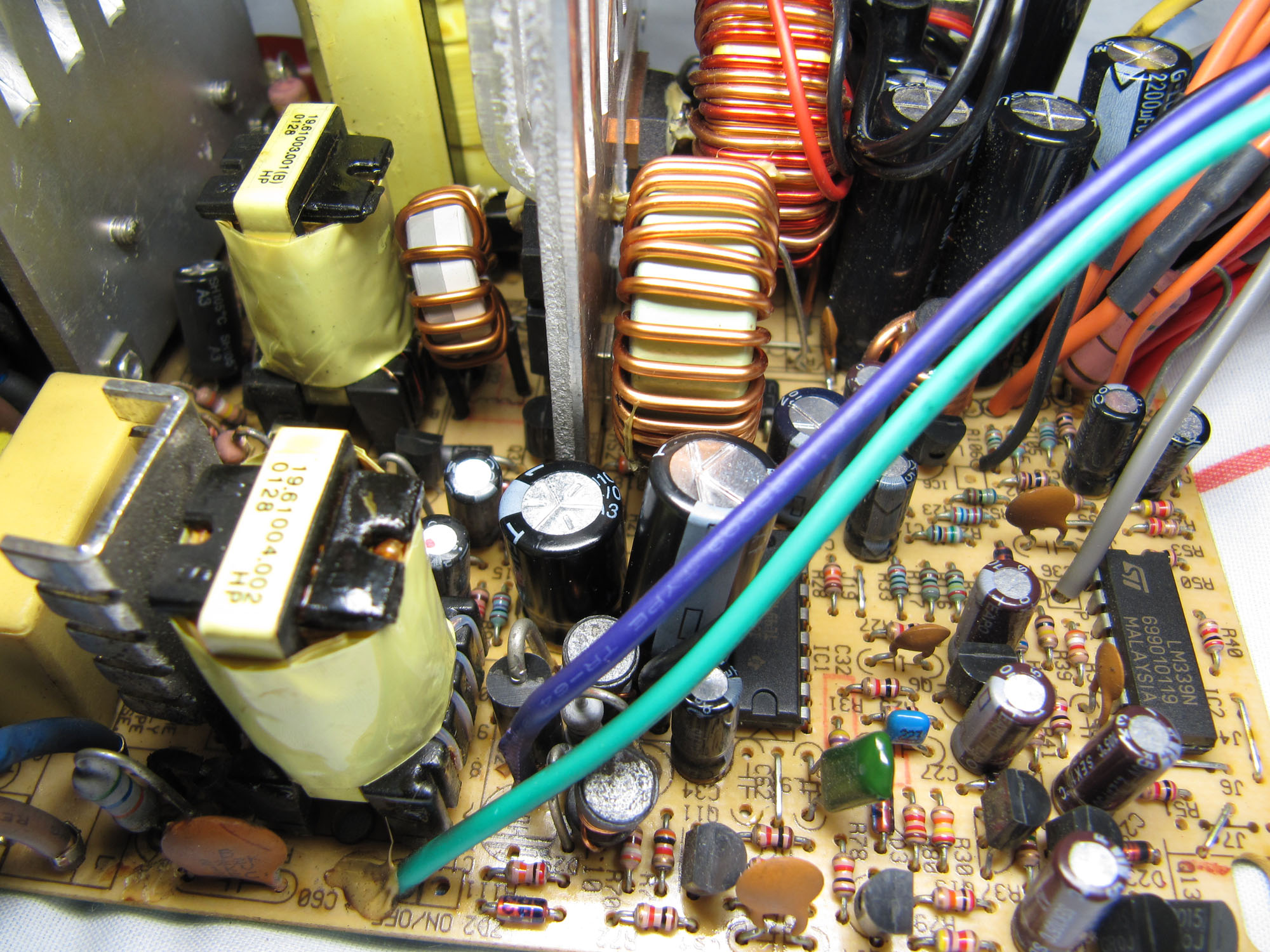

    Another thing I've never seen before is the output filter of the 5vsb. Instead of the usual configuration, capacitor-coil-capacitor, it is capacitor-coil-capacitor-coil, as seen on the link:
    https://www.badcaps.net/forum/attach...9&d=1353028791

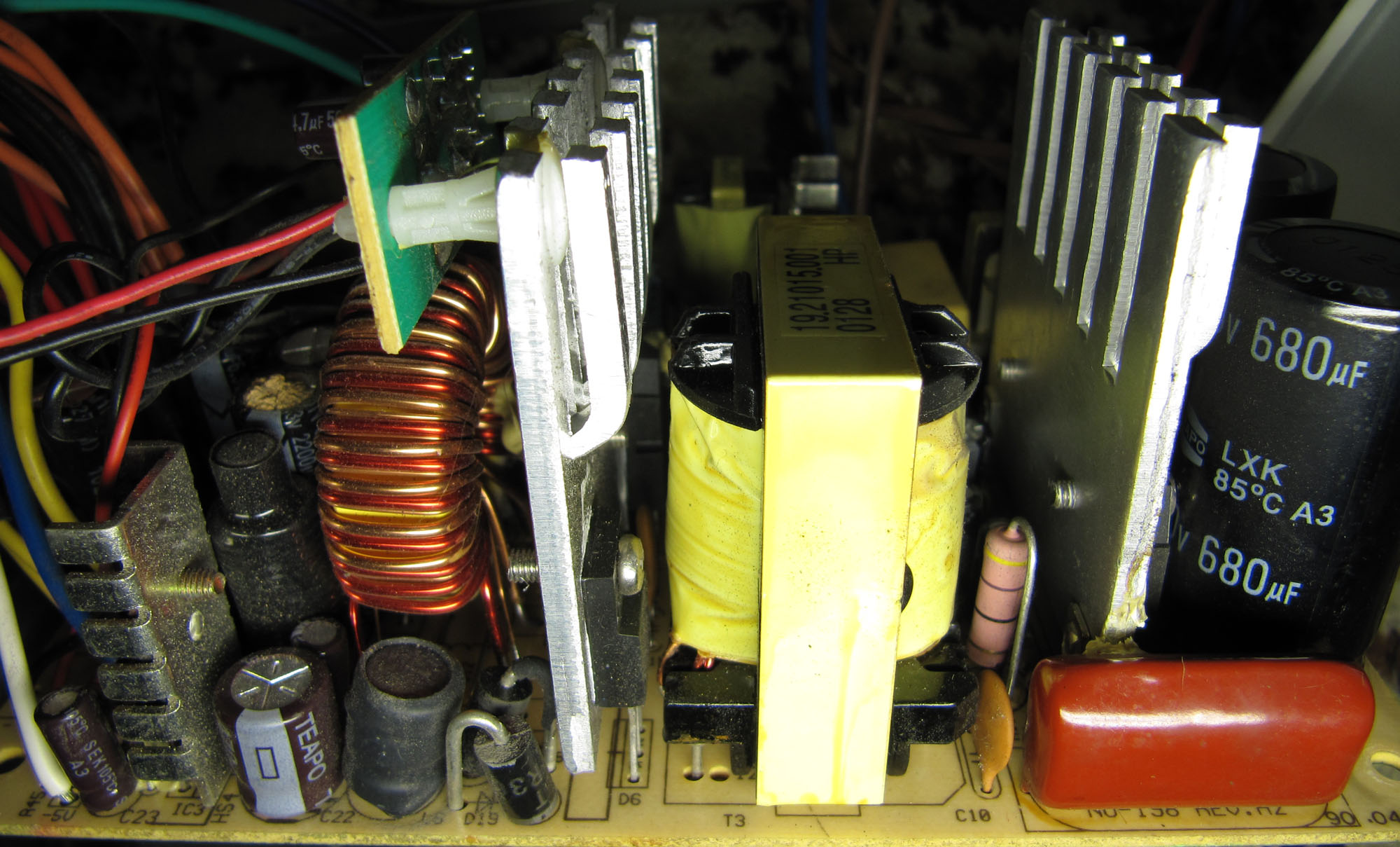

    The 5vsb caps are 470uF 25V Teapo SX and 100uF 25V Teapo SH. I am replacing both with 2x1000uF 16V Rubycon YXF. That's the usual capacity of modern 5vsb circuits.

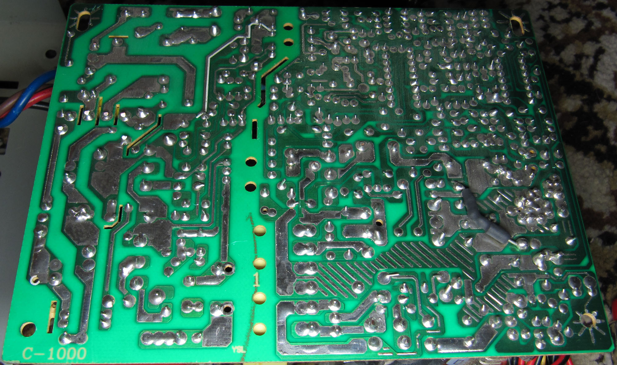

    The soldering is very good.
    There is only 1 bulging cap and it is G-Luxon 2200uF 6.3V on 5V output.
    The filtering of the 12V output is done with 1 coil and 2 caps, 1x1000uF 16V Teapo SH and 1x 10uF 50V Teapo SEK, same odd configuration as Chieftec HPC-360-202.

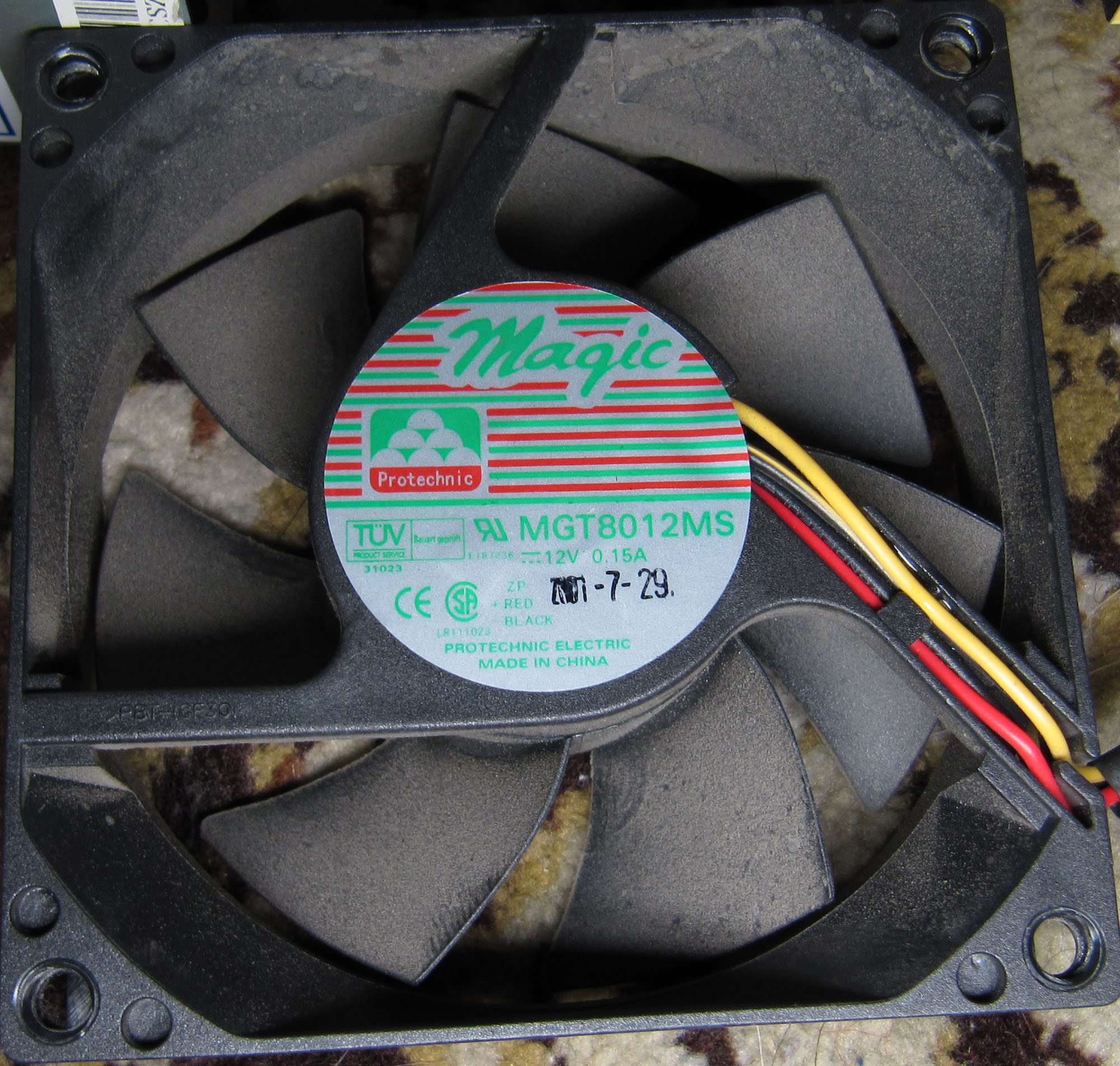

    The fan brand is "Magic". No comment on that.. There is a "sense" wire from the fan that can be connected to the motherboard and be used for fan monitoring.
    All the wires are AWG18, except the ATX12V that uses 20AWG.

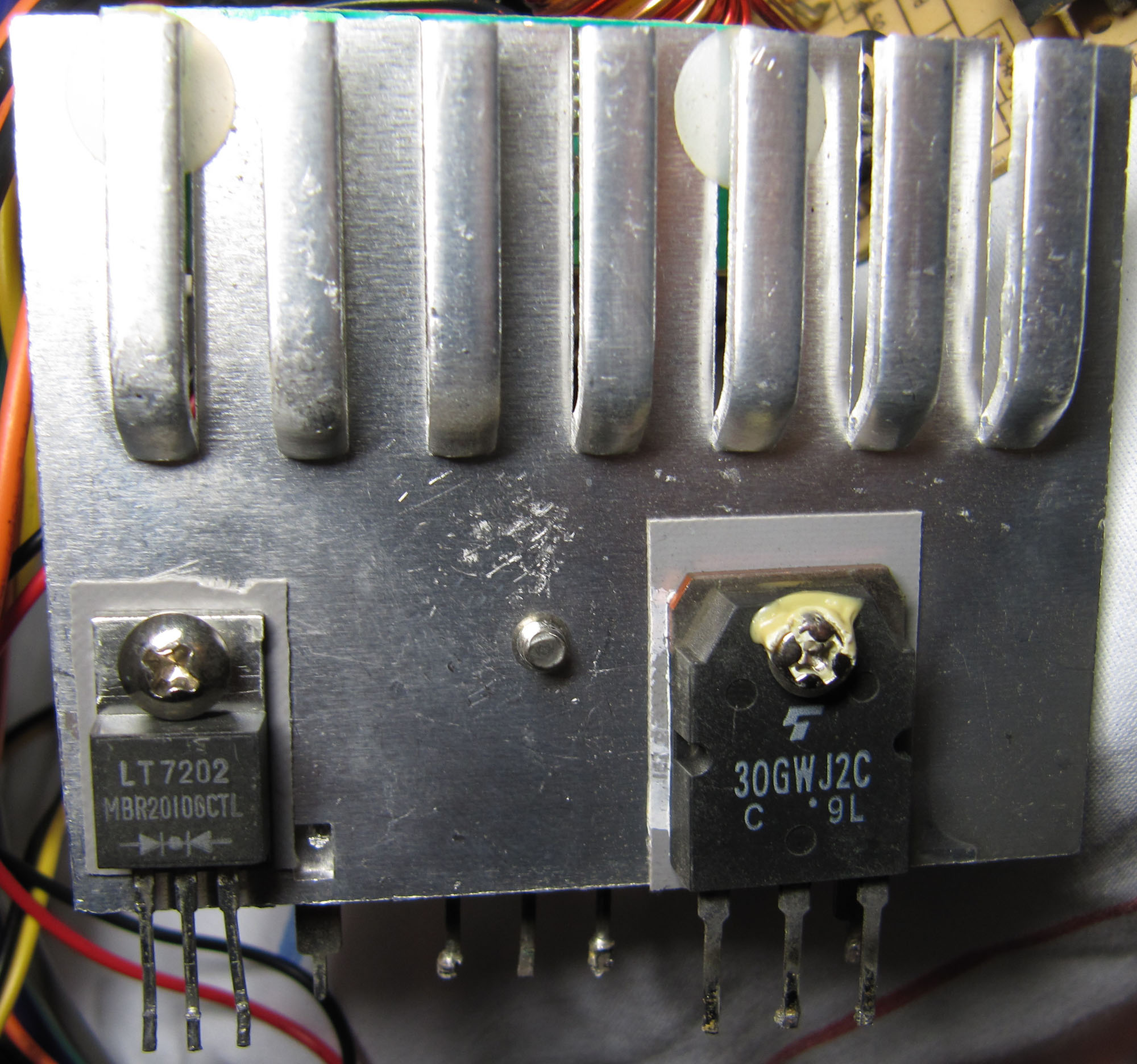

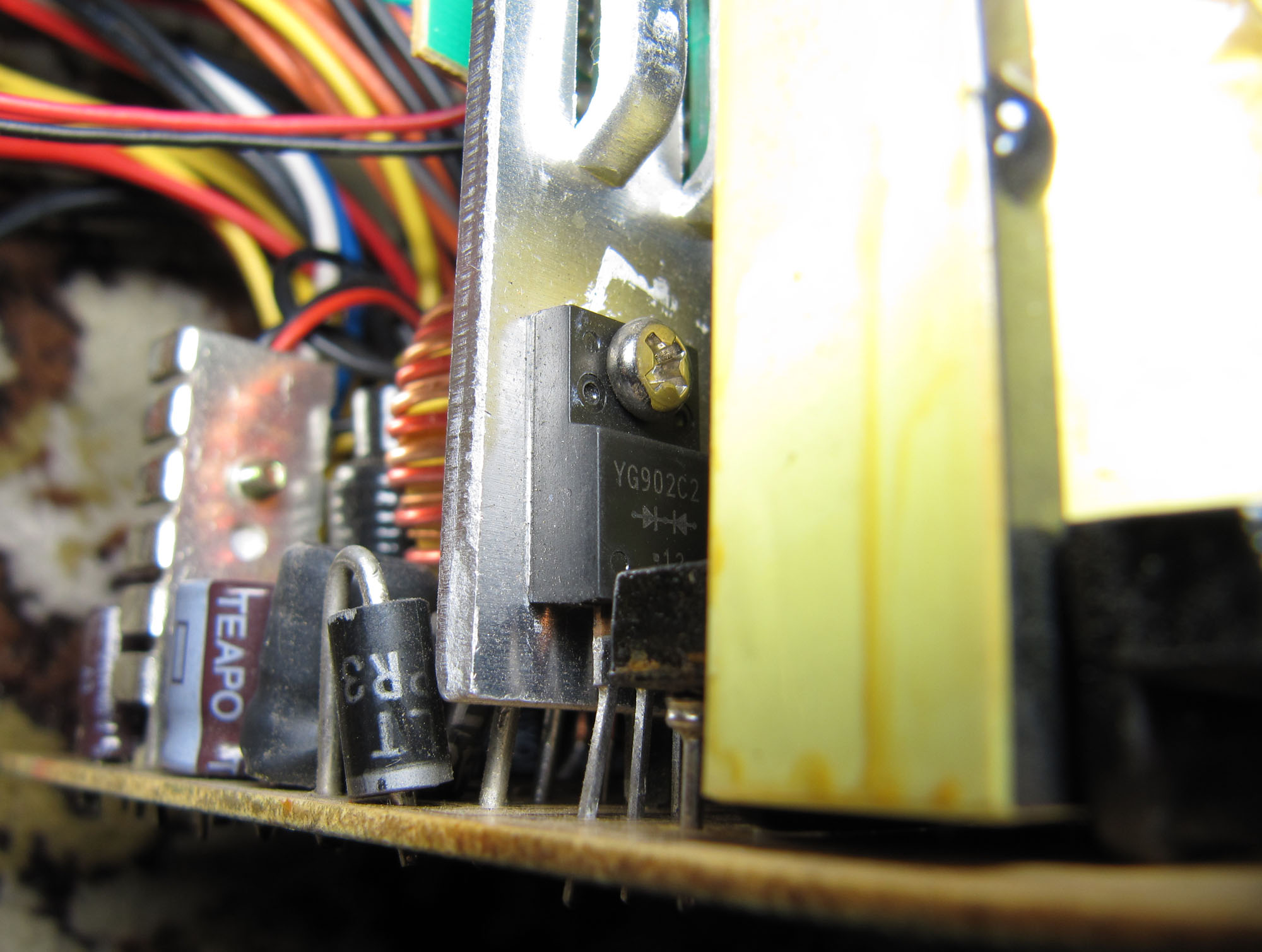

    Unfortunately, the label lies about the 12V rating. It says 13A, but the rectifier is rated for just 10A (YG902C2). I am planning to replace it with MBR20100CT (20A). I am also in the process of replacing the 1000uF 16V general purpose capacitor with 3300uF 16V entry low esr. After that, I hope the power supply could be used with 12V systems.
    What do you think?

    Re: Enlight HPC-300-202
    Magic Protechnic have produced good fans in my experience. I've never had one fail on me, sleeve or dual ball bearing.
    The 10A rectifier being used as futile means to achieve the 13A rating on the label is interesting - I've seen other Enlight/Sirtec 300W PSUs with the same configuration, except on the label it said "peak load: 300W" - perhaps the 13A rating is the +12V rail's peak rating and not so much continuous? Even though for the Chieftec HPC-300-202, it says "Max Load: 300W" on the label... of course, you could also argue that even though the +12V rail only has a 10A rectifier that perhaps with good cooling and bridge topology you could get closer to 12A (maybe 12.5A at maximum, rounding it up) on the +12V rail (since this is a half bridge PSU)? Actually, this label is of the same model but it says peak load too. Go figure - Chieftec twisted High Power's rating.
    That particular PSU may be old enough to be really for +5V/+3.3V based systems and not +12V based systems. I bet the +5V and +3.3V rails have 30A TO-3P rectifiers, which is no surprise. Since it's bridge topology and the label rates the +12V rail at 13A, however, I personally think 20A is an overkill and that a 15A or 16A part would do just fine, but of course there's no harm in putting a 20A part there for the sake of efficiency.

      The power supply actually looks nice.
      Shame about those capacitors dying. Don't forget to replace that Y cap in the 8th picture.
      Don't go too low with the ESR. I'd stay with Panasonic FC, Nichicon HE, HD, Rubycon ZL etc

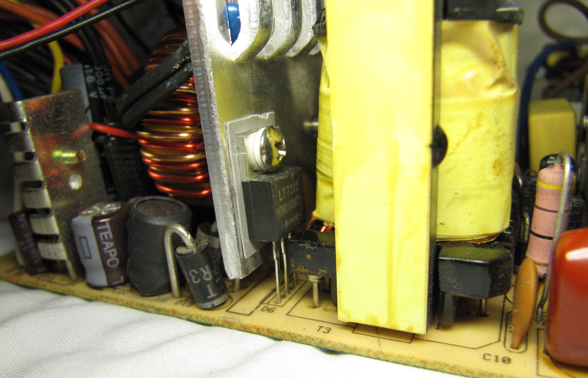

        I did a partial recap, put 3300uF on 12V and 2x1000uF on 5vsb.
        I replaced YG902C2 with an MBR20100CT. Due to very little free space among the heatsink and the transformer I had to remove the heatsink. Unfortunately many traces were lifted, but I managed to restore them when I soldered back the heatsink. I don't know how you do it, maybe I need some tips
        I tested it with a (12V based) computer and its performance was mediocre. 5vsb fluctuates a bit: 5.13-5.14-5.13-5.14-5.13-5.15-5.13 etc..
        3.3V is stable, 5V is almost stable and 12V is stable when PC is in light use, but when running Memtest it's oscillating just like the Chieftec. The maximum range of oscillation is approximately 100mV (11.98-12.07).
        Are these results acceptable?
