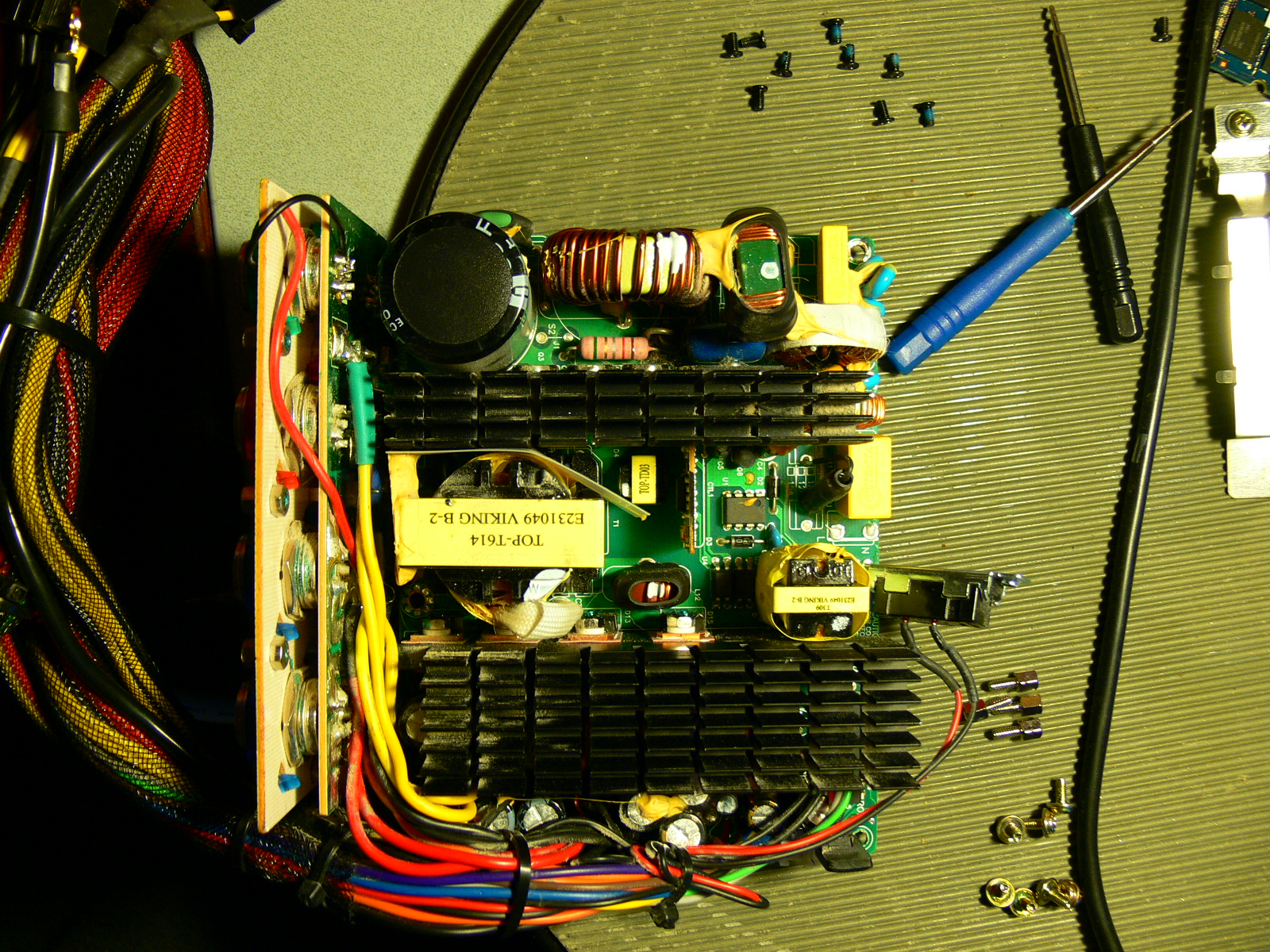

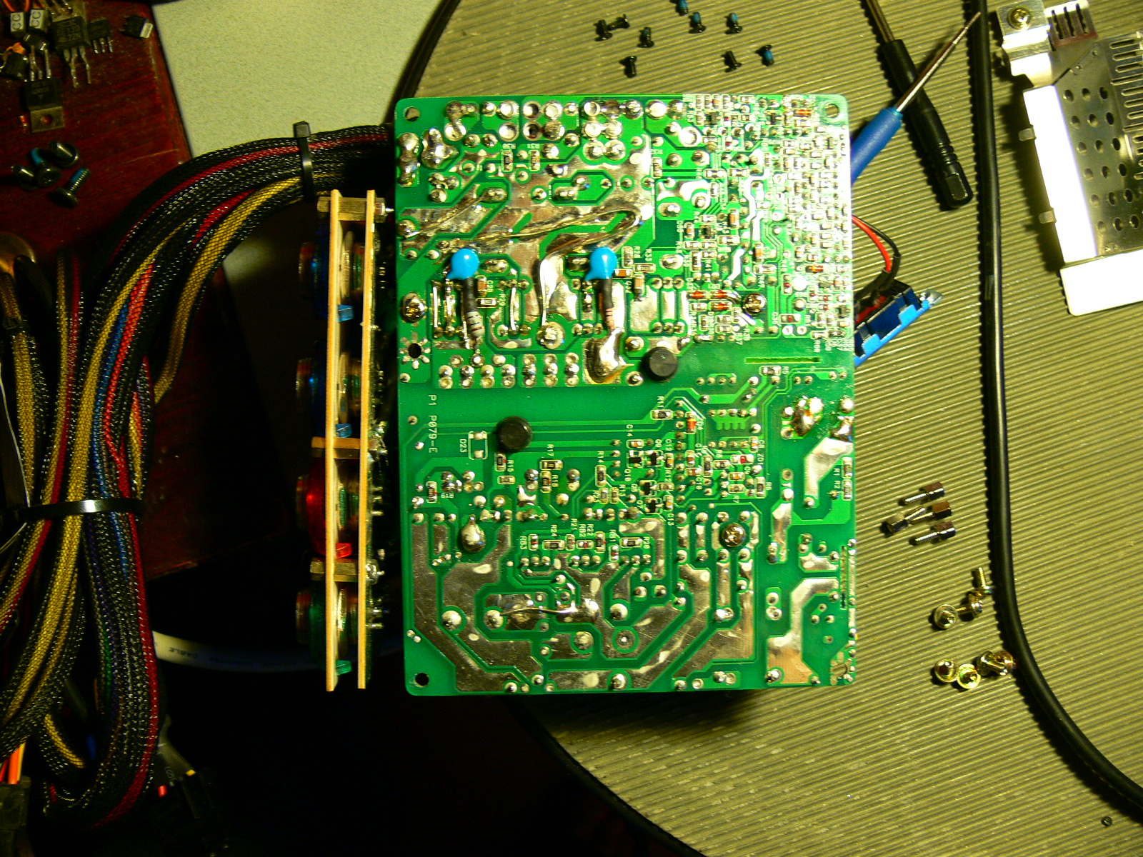

    If a couple weeks ago it was LCD's, this week i scored a grand total of 6.7KW of (dead) PSU's from the same company, plus a 20" HP LCD and a Dell Latitude D620, all for ~85$
    First on the operating table, the Tagan BZ800 (OEM = Topower).
    5Vsb is powered by an ST Microelectronics ViPer22A chip, PFC/PWM's a CM6800. Protections are handled by a PS232 chip.
    5Vsb works just fine, puts out 5.116v. Upon shorting the green wire to ground, nothing happens. PFC works fine, i've got 387v on the main filter cap. 12v's around 0.4v and dropping, 5v and 3.3v even lower.
    Cap-wise, a blend of Hermei and CapXon.
    - 12v = 2x CapXon KF 3300u/16v -> Panasonic FK 2200u/16v
    - 5v = ditto
    - 3.3v = 2x Hermei LE 3300u/10v -> Rubycon MBZ 3300u & 2200u/6.3v
    - 5Vsb = 2x Hermei LE 1000u/16v -> Sanyo ME-AX 1000u/6.3v
    - -12v = ditto -> Sanyo ME-WF 1000u/16v
    Plus a 470u/400v JunFu, a 10u for the CM6800 and a 22u for the ViPer22A.
    Post-recap - same thing
    Attachments = top / bottom view, pre-recap.

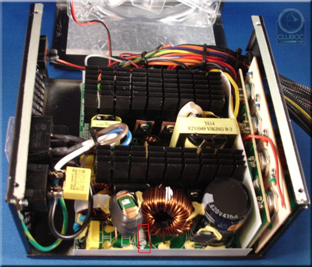

    That's some ugly mess on the backside of the board.
    Can't see behind those sinks, are there any small caps, preferably arround +5V SB circuitry, which may be baked?

        There were two small caps, that 10u and 22u, but those were the first i changed (10u/50v Nichicon PS and 22u/63v Panasonic FC)
        I know the MBZ's might've been a tad too low-ESR, but those were the only two caps i had in close-enough uF ratings AND in 10mm diameter.
        Good call on the short-checks It seems one of the switching FETs might've "let out the magic smoke" - it shows 3,6ohms drain-to-source.
        Next step - primary silicon & heatsink extraction, to confirm...

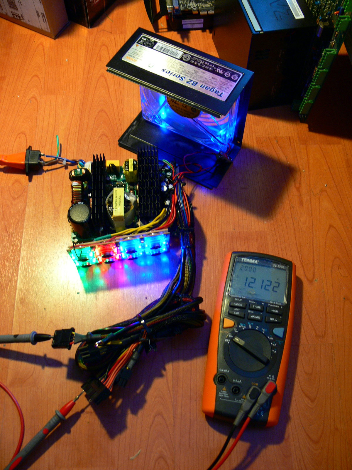

                Great news - UF5408's arrived today. Stuck'em in, soldered the primary heatsink back in, and the results...IT'S ALIIIIVE!!!
                And here's photographic proof (take note of the "bling factor" )
