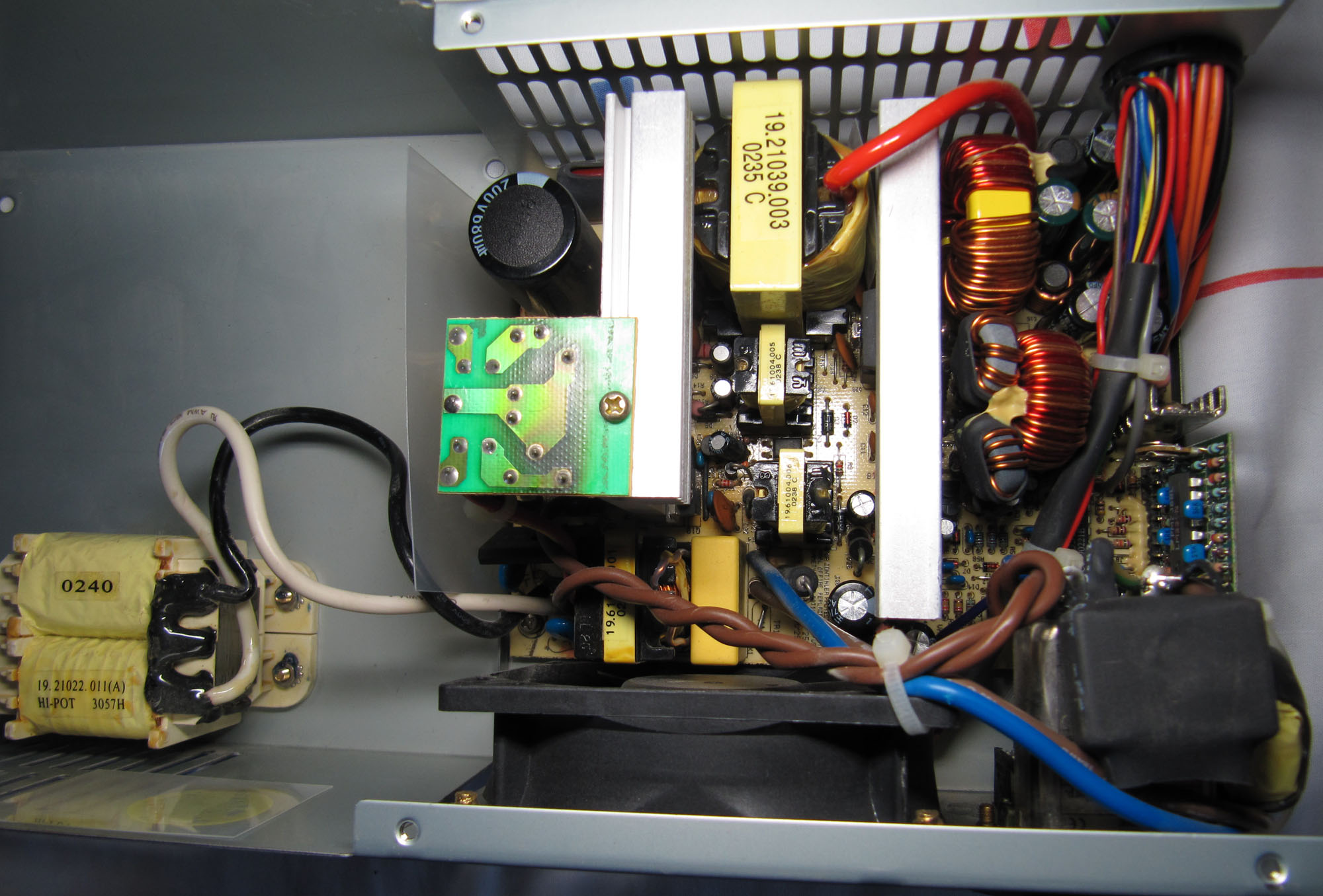

Chieftec HPC-360-202 5vsb jumped to 6V!
  • goodpsusearch
    replied
    Re: Chieftec HPC-360-202 5vsb jumped to 6V!
    Maybe it's trying to say "Wake up and see what you have done"
    Or, "wake up and fix me now"
    Leave a comment:
  • Pentium4
    replied
    Re: Chieftec HPC-360-202 5vsb jumped to 6V!
    What a strange creature
    Leave a comment:
  • goodpsusearch
    replied
    Re: Chieftec HPC-360-202 5vsb jumped to 6V!
    Originally posted by goodpsusearch
    12V: 1x 2200uF 16V Jenpo 10X25 & 1x 10uF 50V Jenpo
    Yes, there is a second cap on that output..... Why did they use such a small capacitor???
    I replaced the 50V 10uF cap with 1000uF 16V. The power supply oscillates like crazy now! 12V stays 12.03 for 1-2 seconds then it drops to 11.68V, then it goes up again etc... And you can hear a sound inside the psu like a wake up alarm
    The cap needs to go out. Not sure of what caused this though.
    Leave a comment:
  • goodpsusearch
    replied
    Re: Chieftec HPC-360-202 5vsb jumped to 6V!
    Originally posted by Behemot
    Thanks for the info. If I would run into it in future, is it enough to remove those components to disable it? No extra connections and such things are neccessary?
    In every psu that I've seen and had that circuit, removing the 2 400V 2.2uF caps was enough to disable it completely.
    I just took advantage from the fact that in this psu it is located on a separate add-on board and removed the whole board. This is going to help the airflow as well.
    This power supply is full of surprises! The 5vsb Teapo GP cap was glued to the minimum load resistor, yet it survived. Same thing happened with minimum load resistor and 12V output Jenpo capacitor.
    About 12V... I have to correct myself....
    Originally posted by goodpsusearch
    3.3V: 2X 3300uF 6.3V Jenpo 10X25
    5V: 2x 3300uF 10V Teapo SC 10x30
    12V: 1x 2200uF 16V Jenpo 10X25
    12V: 1x 2200uF 16V Jenpo 10X25 & 1x 10uF 50V Jenpo
    Yes, there is a second cap on that output..... Why did they use such a small capacitor???
    Leave a comment:
  • Behemot
    replied
    Re: Chieftec HPC-360-202 5vsb jumped to 6V!
    Originally posted by goodpsusearch
    Thanks for the info. If I would run into it in future, is it enough to remove those components to disable it? No extra connections and such things are neccessary?
    Leave a comment:
    replied
    Re: Chieftec HPC-360-202 5vsb jumped to 6V!
    Seems like a lot of effort and components for a slight voltage boost. Maybe it lets them get a bit more power from the transistors but it seems quite dodgy to me...
    Leave a comment:
  • c_hegge
    replied
    Re: Chieftec HPC-360-202 5vsb jumped to 6V!
    Yup. replace all the Jenpoo caps.
    You know sir, high tech power supplies like this often need re-capping
    Leave a comment:
  • goodpsusearch
    replied
    Re: Chieftec HPC-360-202 5vsb jumped to 6V!
    Originally posted by tom66
    What does that circuit with the two resistors and two caps do? I've seen it a lot in power supplies that are usually built a little better (I had a "Jackson" power supply like this with bad 5Vsb output cap.) The resistors are always very burnt from heat...
    Originally posted by Behemot
    Somebody wrote about that in here, IIRC it is to somehow boost efficiency when the PSU is operating, on the other hand it works during stand-by as well and just consumes power and burns itself.
    I tried to draw something like a schematic diagram for that circuit a while ago:
    https://www.badcaps.net/forum/attach...9&d=1268165068
    https://www.badcaps.net/forum/attach...0&d=1268166583
    And these are some results with and without that circuit on a psu connected to AC: https://www.badcaps.net/forum/showpo...&postcount=109
    But I just noticed something confusing:
    https://cdn.badcaps-static.com/pdfs/...a1ac9621a8.pdf
    Go to page 108... Why is that circuit mentioned as "PFC"?
    Jenpo are worse than Capxon, i'd rank them along the likes of Rulycon and JEE. Replace them all. The Teapos can stay.
    I had a Spire 600W where almost all Jenpo caps were bloated or dried, even though the PSU had barely been used at all - there wasn't any dust inside although the PSU is several years old.
    The C38 cap, Jenpo 100uF 25V is also bad. Capacity is ok (110uF), but esr has risen to 1.9. I don't think it is normal for a cap of that uF.
    More bad Jenpo caps...
    470uF 16V Jenpo 5vsb output, esr: 0.55
    470uF 16V Jenpo -12V output, esr: 0.35
    Those are too high values even for GP caps!
    Leave a comment:
    replied
    Re: Chieftec HPC-360-202 5vsb jumped to 6V!
    I have no idea how two resistors and two caps can boost efficiency. I'd guess it's some kind of psuedo-PFC... but I haven't thought much about it.
    Leave a comment:
  • Behemot
    replied
    Re: Chieftec HPC-360-202 5vsb jumped to 6V!
    Somebody wrote about that in here, IIRC it is to somehow boost efficiency when the PSU is operating, on the other hand it works during stand-by as well and just consumes power and burns itself.
    Leave a comment:
    replied
    Re: Chieftec HPC-360-202 5vsb jumped to 6V!
    What does that circuit with the two resistors and two caps do? I've seen it a lot in power supplies that are usually built a little better (I had a "Jackson" power supply like this with bad 5Vsb output cap.) The resistors are always very burnt from heat...
    Leave a comment:
  • Behemot
    replied
    Re: Chieftec HPC-360-202 5vsb jumped to 6V!
    If you would recap it, CHANGE THE CAPS FOR EXACTLY THE SAME RATINGS ESR/current wise. Had a thread here about one which's compensation got oscillating, wasn't able to fix it.
    Leave a comment:
  • Th3_uN1Qu3
    replied
    Re: Chieftec HPC-360-202 5vsb jumped to 6V!
    Jenpo are worse than Capxon, i'd rank them along the likes of Rulycon and JEE. Replace them all. The Teapos can stay.
    I had a Spire 600W where almost all Jenpo caps were bloated or dried, even though the PSU had barely been used at all - there wasn't any dust inside although the PSU is several years old.
    Leave a comment:
  • goodpsusearch
    replied
    Re: Chieftec HPC-360-202 5vsb jumped to 6V!
    The 5vsb critical cap is completely dried. It is a Jenpo 22uF 50V.
    This power supply is designed better than power supplies like Antec SmartPower and Bestec that would go completely unregulated when the critical cap fails and provide even 8-12V on 5vsb and fry the mobo.
    Btw, very good soldering:
    Leave a comment:
  • Behemot
    replied
    Re: Chieftec HPC-360-202 5vsb jumped to 6V!
    The integrated input filter is quite common on better PSU these days. Once again, have a look to Hardware Secrets reviews once per a month or so
    Leave a comment:
  • Khron
    replied
    Re: Chieftec HPC-360-202 5vsb jumped to 6V!
    I vote for dead / dying 5Vsb cap
    Leave a comment:
  • Pentium4
    replied
    Re: Chieftec HPC-360-202 5vsb jumped to 6V!
    Wow, not bad at all! Interesting AC thingy there Although not much filtering on the 12V and I think the transformer is too close to the heatsinks, that thing would get toasty. Any idea why the 5VSB is so high??
    Leave a comment:
  • goodpsusearch
    started a topic Chieftec HPC-360-202 5vsb jumped to 6V!
    Chieftec HPC-360-202 5vsb jumped to 6V!
    This is the power supply that came with the Albatron PX865PE PRO mentioned on the other thread I created.
    It works, but the psu squeals and the 5vsb climbs to 6.11V.
    I opened it and was surprised by the build quality. In the AC reception there is something I've never seen again in a power supply.
    https://www.badcaps.net/forum/attach...1&d=1352833284
    It seems to be an input filter that incorporates X cap, Y caps and input coil.
    But wait, there is more! 2 extra X caps, 2 Y caps and 2 coils, one of them is the biggest AC filtering coil I have seen. There are also 2 M.O.V., but there is no inrush current limiter. The bridge rectifier is GBU8J rated at 8A.
    Oh, no! That voltage doubler circuit again! You can tell where it is from the burnt PCB... It's the PCB board mounted on the primary heatsink. I bet the 2.2uF 400V caps are dead as usual.
    The caps in this power supply are Teapo and Jenpo.
    The primary caps are 2x Teapo 680uF 200V.
    5vsb: 1x 1000uF 16V Teapo SH & 1x 470uF 16V Jenpo
    3.3V: 2X 3300uF 6.3V Jenpo 10X25
    5V: 2x 3300uF 10V Teapo SC 10x30
    12V: 1x 2200uF 16V Jenpo 10X25
    The secondary silicon is very impressive:
    3.3V: 1X SBL4040PT 40A
    5V: 2X SBL3040PT 60A total
    12V: 1x ESAD92-02 20A
    The main NPN switching transistors are 2SC2625 rated for 10A continuous. Correct me if I am wrong but I think they are worse than the D13009...
    There is also SSP2N60B for 5vsb.
    There is SG6105D for PWM and the voltage comparator LM339N, placed in an add-on board.
    I found that test report: https://cdn.badcaps-static.com/pdfs/...a1ac9621a8.pdf
    and schematics: http://www.rom.by/files/HPC-360-302.rar
  • прямо
    Viper22A 5VSB circuit
    by прямо
    So I have a cheap non working ATX PSU that I was learning to repair a decade ago. At the time, it blew the main fuse, bridger rectifier, NTC, and primary 9A 900V MOSFET. Replaced all except the MOSFET. 5VSB came back online. Then I poked around in it so much, measuring components one by one to a point I accidentally made the 5VSB circuit primary side went bang. Blown the AP8022 (Viper22A) PWM chip, along with a low resistance resistor and the PC817 opto isolator. I replaced them all.
    In the process of poking around, I also lost a zener diode that stabilize the voltage coming from...
    01-13-2024, 07:05 PM
  • kotel studios
    FSP300-60GTF - no 5VSB, PS_ON; 5VSB carnage
    by kotel studios
    Finally replaced all of the shorted 4148's and resistors and an blown tl431 on my FSP300-60GTF after 5VSB going crazy and destroying it self. Those components also made the secondary transistors appear shorted (while in reality they weren't).
    Powered it on through my dim bulb tester and they (bulbs) only flash once meaning primary caps are getting charged, but that's it. No 5VSB, PS_ON voltages.
    I am sure I have replaced the components correctly and that there weren't any shorted/blown traces left.
    Any ideas where to go next?
    02-23-2025, 11:47 AM
  • mrcliem
    CM V700 no +5vsb, ICE2QR4765 low VCC in... Need guidance please...
    by mrcliem
    Hello...
    I got my self a dead CM V700 PSU, with nothing on +5vsb
    I have tried to fix it for the past 2 week, and I'm stuck... so i guess i post it here to get some pointer before i scrap it..
    As you can see in photo, the psu still pretty clean, no visible damage or bulging cap.. when i got it, it still has CM seal on it
    The +5vsb system use ICE2QR4765, I have trace and measure the voltage on ICE2QR4765 and the only voltage reading i got is in VCC 4.8v, Drain 310v and FB 3v.
    I have read the datasheet and and still can not...
    06-29-2023, 08:18 AM
  • mikey5791
    Tiny Tech ATX480W output power ticking
    by mikey5791
    Hi to all forum members,
    ​​​​​​This psu (Tiny Tech model ATX 480W) had been installed in a very old Windows XP PC but recently i pulled it out as the pc cannot start. To test it, i jumped the green wire and black wire on the 24 pin connector. The psu fan jerk a bit but not spinning. I used my dmm to check dc voltage on output connector wire, the 5v red wire keeps ticking a bit at around dc1v....then drops and ticking again around 1v. It is the same situation with the 12v yellow wire.
    Fyi, i desoldered the secondary side electrolytic cap those over 1000uf...
    02-20-2025, 01:11 AM
  • socketa
    Zalman ZM500-GV stops after 40s and 5VSB drops to 2.5V
    by socketa
    Rescued this one
    Started it up in the computer case, and noticed that it would shut down after about 10s in the BIOS
    Took it out, connected to hard drive and it loses all power on all rails (except for 5VSB) after about 40s or so. (the same result happens without a hard drive connected)
    The 5VSB drops to 2.5V when it 'shuts down'
    And the voltage across the primary cap falls from 335V to 330V at the same moment
    I think that the 5VSB is regulated by an A6069H PWM chip (which was initially dropping to 2.5V even before the the PS-ON was grounded - but it now stays at...
    12-20-2022, 03:06 AM
