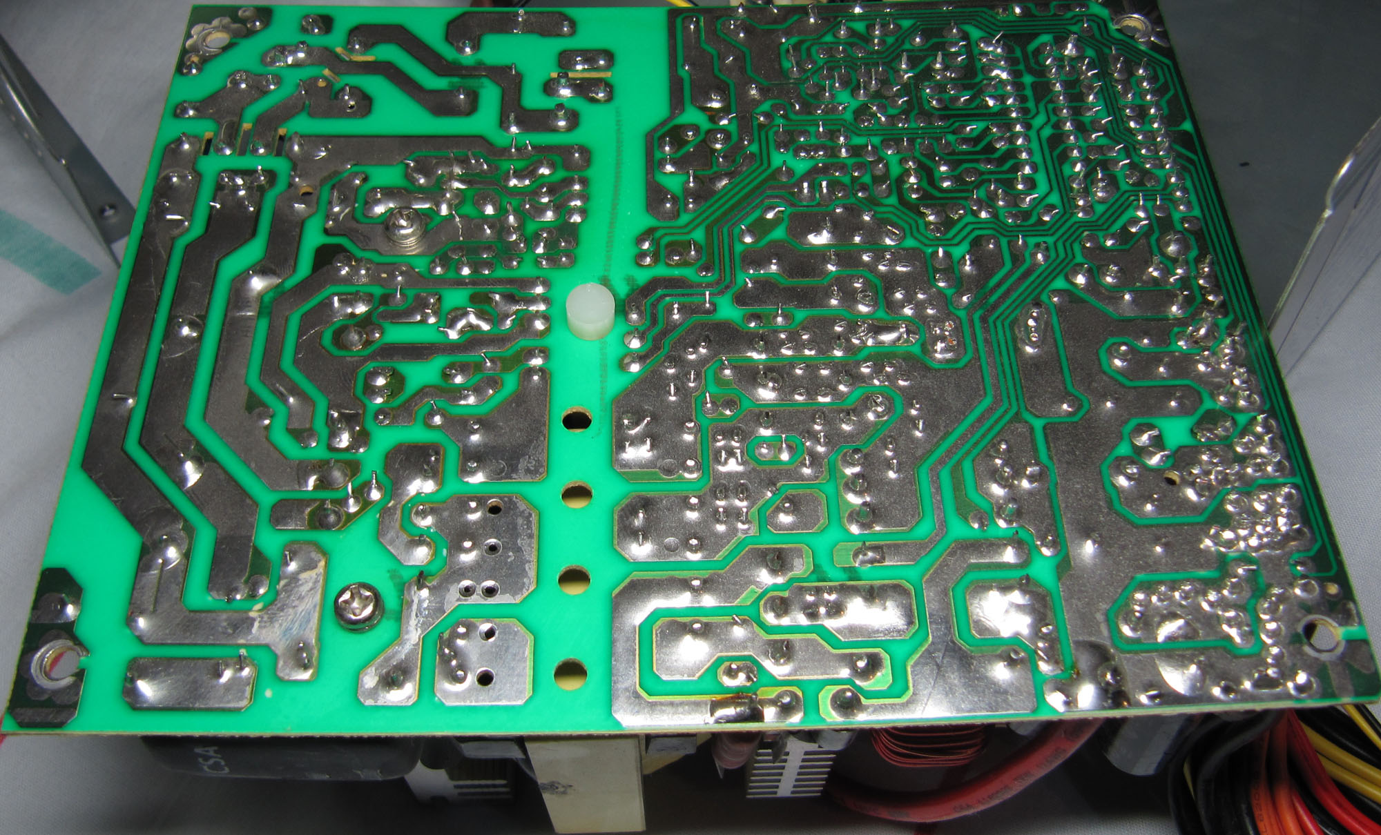

This is the power supply that came with the Albatron PX865PE PRO mentioned on the other thread I created.
It works, but the psu squeals and the 5vsb climbs to 6.11V.
I opened it and was surprised by the build quality. In the AC reception there is something I've never seen again in a power supply.
https://www.badcaps.net/forum/attach...1&d=1352833284
It seems to be an input filter that incorporates X cap, Y caps and input coil.
But wait, there is more! 2 extra X caps, 2 Y caps and 2 coils, one of them is the biggest AC filtering coil I have seen. There are also 2 M.O.V., but there is no inrush current limiter. The bridge rectifier is GBU8J rated at 8A.

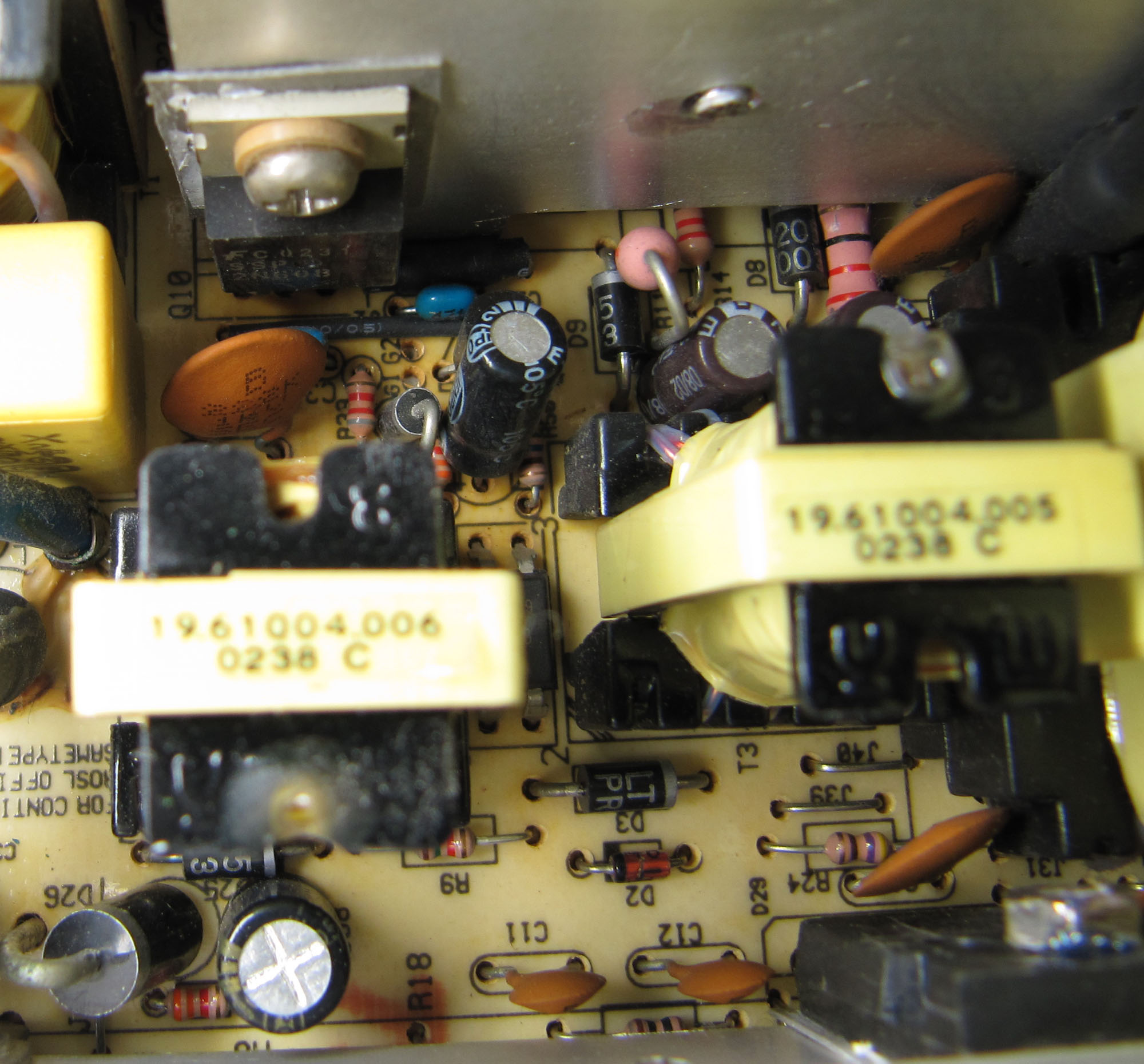

Oh, no! That voltage doubler circuit again! You can tell where it is from the burnt PCB... It's the PCB board mounted on the primary heatsink. I bet the 2.2uF 400V caps are dead as usual.
The caps in this power supply are Teapo and Jenpo.

The main NPN switching transistors are 2SC2625 rated for 10A continuous. Correct me if I am wrong but I think they are worse than the D13009...
There is also SSP2N60B for 5vsb.
There is SG6105D for PWM and the voltage comparator LM339N, placed in an add-on board.

 Although not much filtering on the 12V and I think the transformer is too close to the heatsinks, that thing would get toasty. Any idea why the 5VSB is so high??
  Half of the computer problems is caused by bad contacts
 yet it survived. Same thing happened with minimum load resistor and 12V output Jenpo capacitor.
 Why did they use such a small capacitor???
 12V stays 12.03 for 1-2 seconds then it drops to 11.68V, then it goes up again etc... And you can hear a sound inside the psu like a wake up alarm
