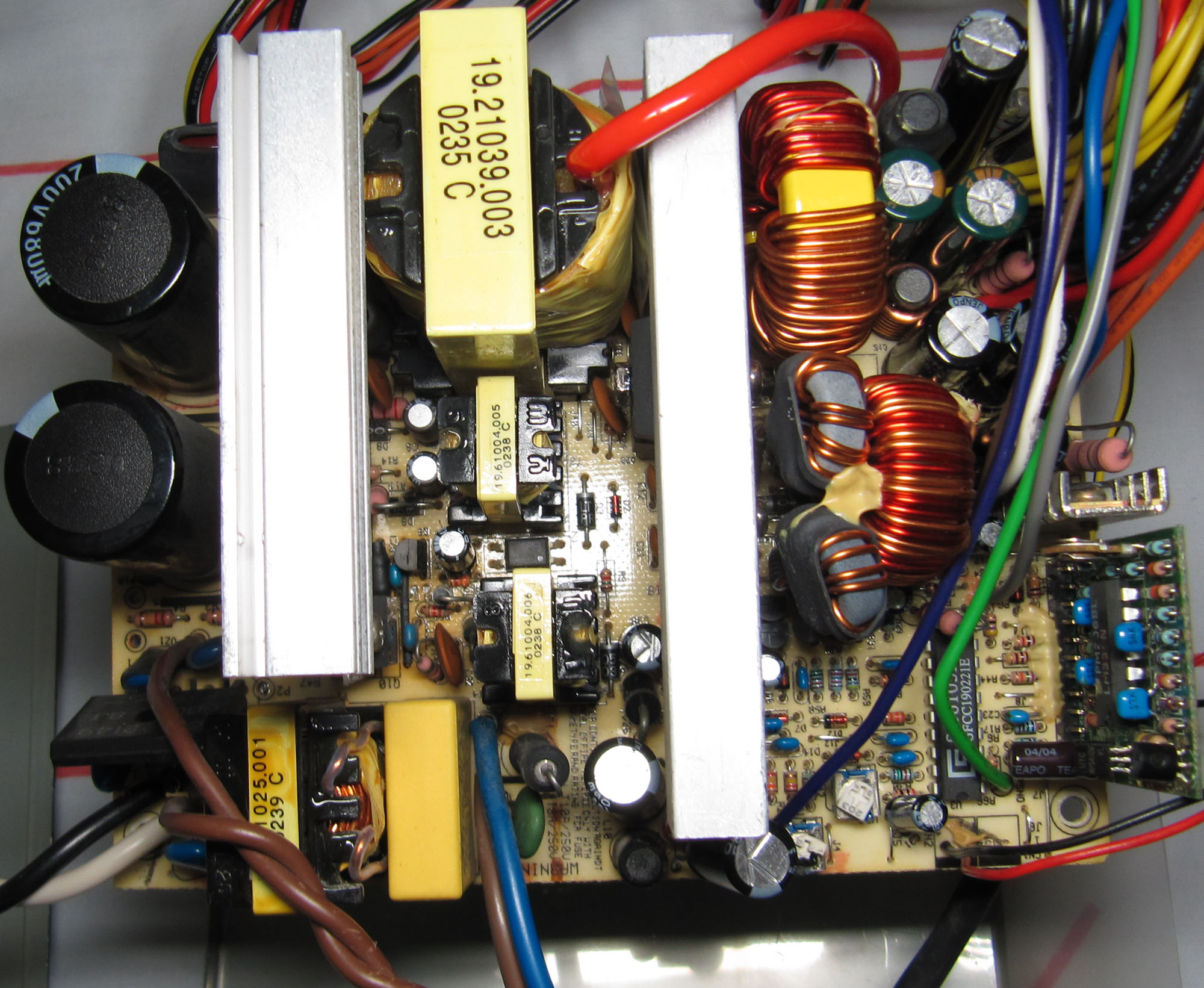

Ok. I put back the original cap and the oscillation stopped.
I added an NTC thermistor 5A rated.
I did a partial recap on that power supply. After all, I have 3 Jou Jye 400Watt psu waiting for recap, those are very well built and heavier on 12V (29A) supplies, therefor I prefer to use my stock of Japanese caps on them.
And finally, I replaced the 2200uF 16V capacitor with 3300uF 16V.
Everything seems to be ok now. Thanks to everyone for your input.
