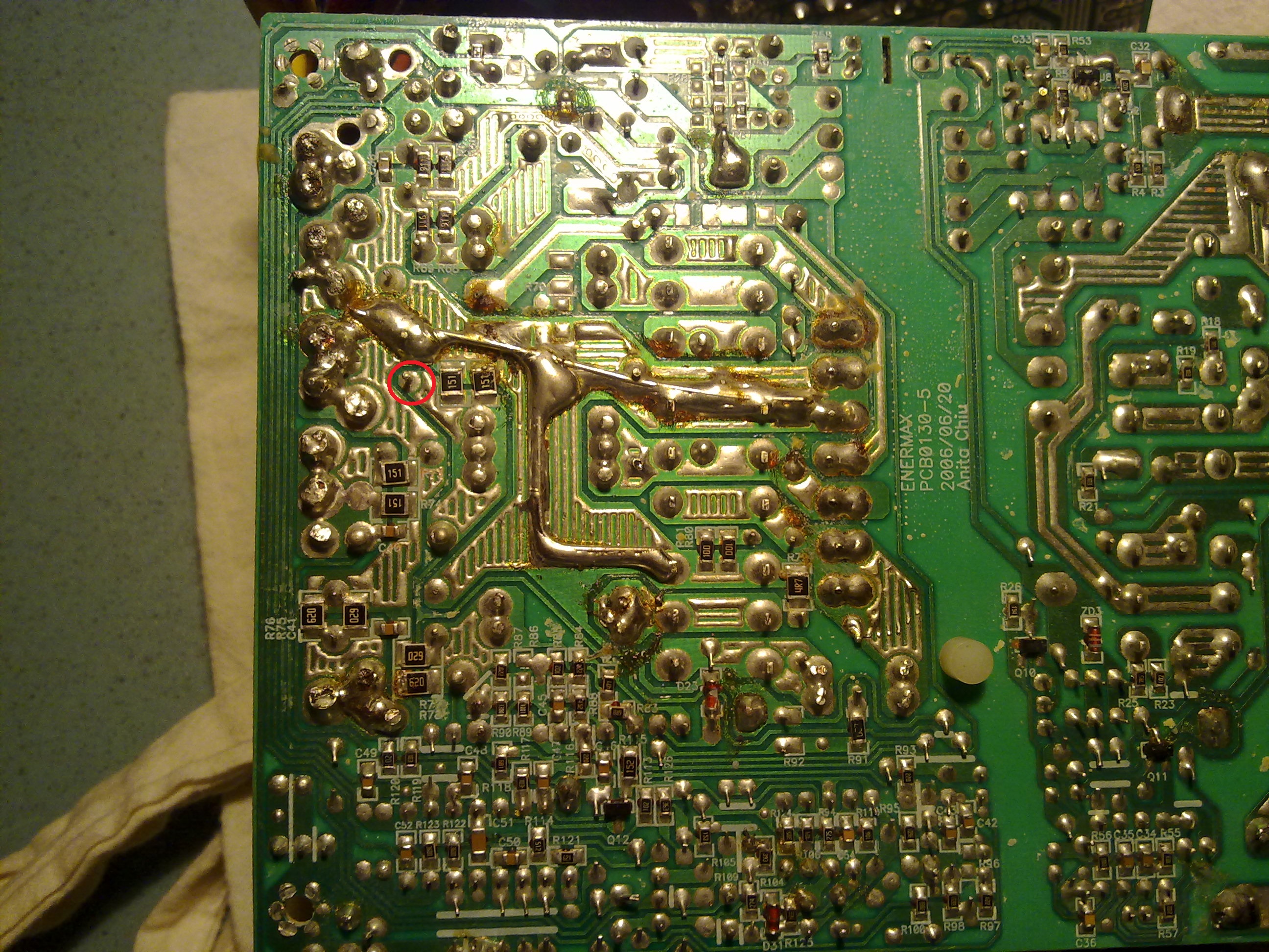

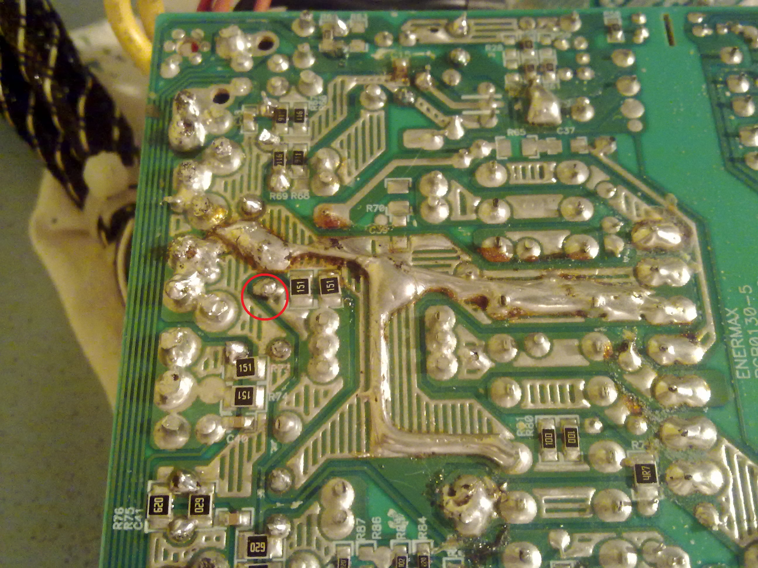

    Today the caps arrived and I soldered them in the circuit. They fit very good. Thx to Behemot.
    Sadly I think something went wrong. I dont know if I short the circuit at one place. All other soldering joints are good imho. Just one went a little bit too big and contacted to another solder area.
    Pls look at the pictures. Does anybody know something about this circuit area?
    Don´t want to reasemble the psu before I make sure I didnt short the circuit.

      Seems like +3,3 V. Use your multimeter set on diode test between +3,3 V and ground while PSU unplugged from power. If it will show 0, you got short there, if 6+, than it should be OK.
      Double or even tripple check your soldering and also polarity. Quite often I swap caps the other way around (mostly on negative rails). Last time it took me half an hour of staring into the PSU to find it…

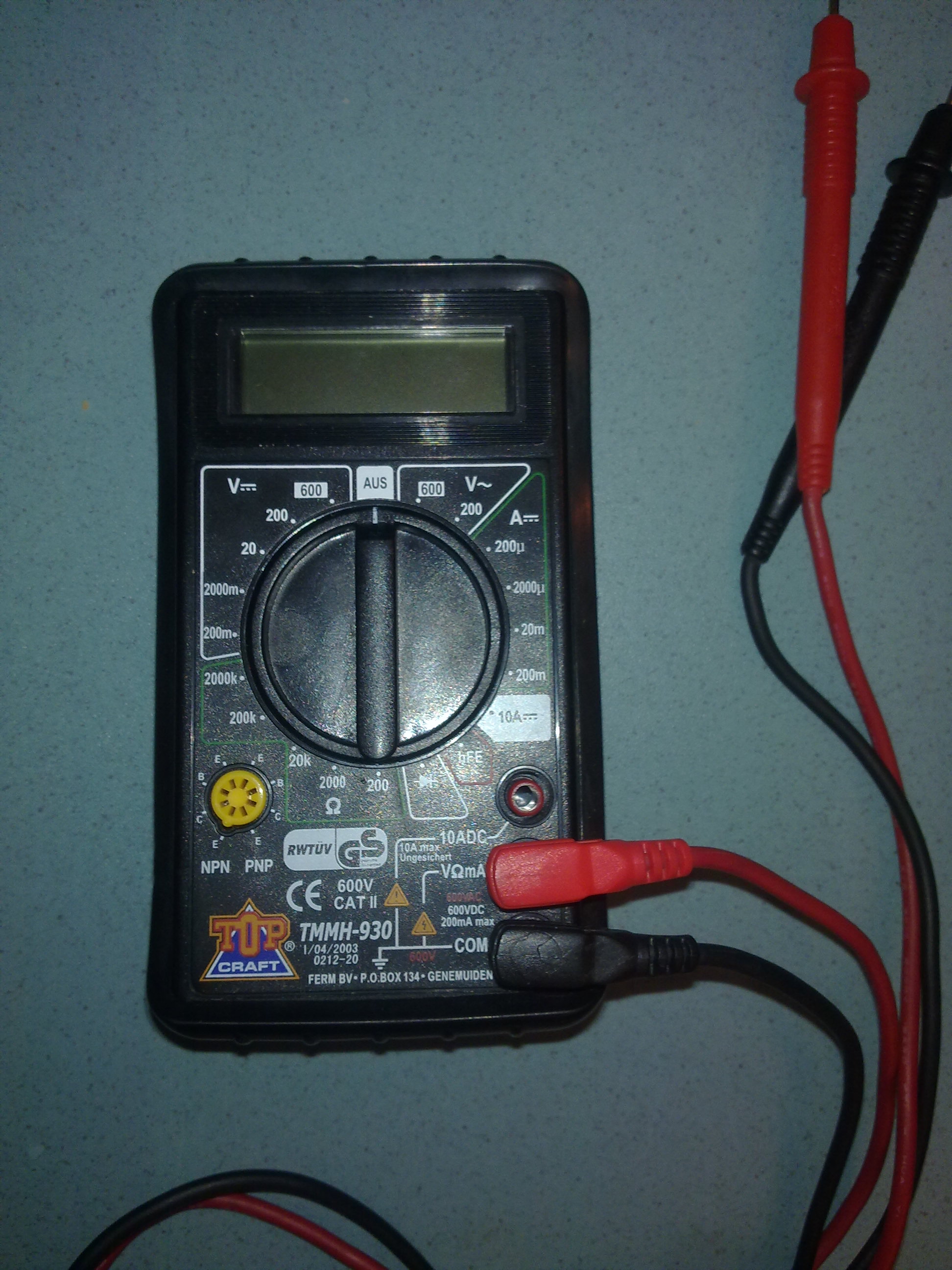

        Hm, my tools are very limited. I only have this mutimeter. (see picture) Can you tell me what setting on my mutimeter is the right one?
        I can messure 3,3V on every psu cable connector? Or should I messure on the circuit?
        I checked polarity of the caps several times. I soldered them correctly. I can compare with previous pictures and the markings of the board.
        Greets

          That white diode icon, right from ohm meter.
          This tool is also useful for tracking paths and so, it makes some kind of buzz noise while in short.

            I messured 3,3 V and ground on ATX power connector with multimeter diode setting. It shows 016 - 015 in both directions (red -black interchanged).
            I shorted the two multimeter pins and the multimeter shows 001. So maybe no short circuit?
            Some things are known from this thread:
            (See picture for comparision): The black area is ground, because all the black wires go from it to the psu connectors.
            My question is: Is the blue area all together (including purple area with pin of my replaced cap)? Because I contacted the cap pin (red) with the blue area. Imho all areas which have a copper layer under it are connected to each other. So I should not made a short circuit, imho....
            Just dont want to blow anything up.
            EDIT:
            Just want to mention. The big coil is connected to the blue area (3 pins).
            EDIT2:
            I checked +12V and +5V Rail with diode setting. No short circuit. (>>001)

              Ok, I dissembled the ELT620AWT and found a similar psu circuit to the ELT500AWT. I measured it and find there is a connection between the one cap pin and blue area. So I should made no short circuit on ELT500AWT.
              I reassembled the ELT500AWT and tested it with 3x 120 mm Fans and a water cooling unit. Everything worked so far, no blow ups.

                Yeah that's the same and seems like +3,3 V. It is primary side of output Pi filter, than there is coil connecting it to secondary side. Typical output filter setup is capacity - inductance - capacity.
