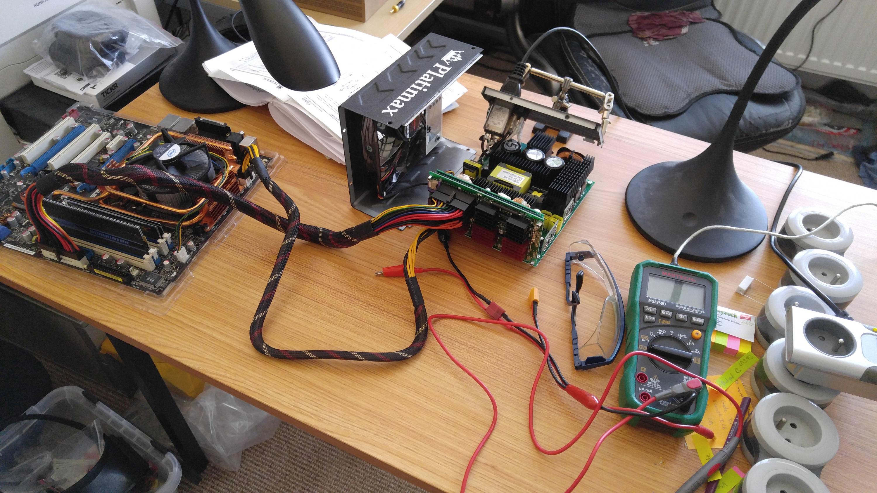

    I'm novice in smps repairs and lurker here also in addition to my preparation I have read Jestine Yong's Troubleshooting & Repairing Switch Mode Power Supplies many times and I cautiously proceeded in small steps a time.
    What's on the table?
    Enermax Platimax 1500W (EPM1500EGT)
    Symptom
    A fault is a little tricky here. When plugged into the wall for a first time (i.e. after proper discharge) PSU starts on power button (PS_ON) as expected, runs smoothly with all the voltages in tolerance also shows quite stable operation in ~600W load in OCCT, no freezing nothing – normal behavior.
    When I turn off the PC and try to power it on again, I can hear almost inaudible (with head close to the PSU) click sound and nothing happens further – no fan spin on PSU, no PWR_GOOD – no post.
    (1min video of the issue https://youtu.be/smy-17Tsxq4)
    To be able to turn it on again I have to unplug it from the line, then wait for discharge of the main capacitors and what's more interesting even after that I got 50:50 success rate of power on sometimes less and it gets worse with trials. When I leave the PSU unplugged from the wall long enough then I can turn it on without hesitation. Same behavior on another motherboard, cpu & ram.
    What is even more confusing is that if I'm able to resend the PS_ON from the second motherboard (power button combo long press-wait-press) then I can “ask” the PSU to turn on as many times as I want (without unplugging the PSU from the wall/discharging), then after 2-3 fail attempts with the “click sound” PSU starts on the 4th. At this point I can say it starts random. When unplugged long enough… Here you go - PSU starts on the first try.

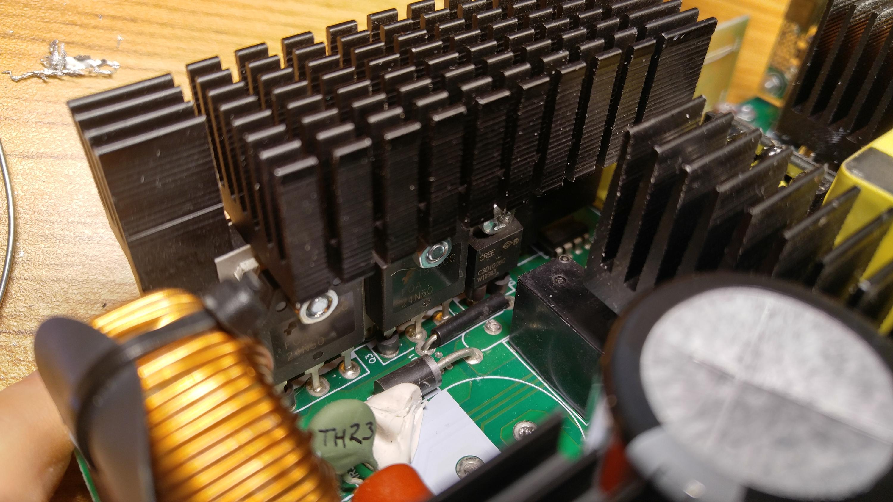

    Capacity & ESR of all key electrolytic & film caps apart from three caps with solid electrolyte on each 5V and 3V secondary PCB output due to bad accessibility (should be ok).
    Measurements here: https://1drv.ms/x/s!Am-Hq0zLeB5Egd4J...fc1NQ?e=MHVCgg
    Found out differential EMI X1 PET on primary out of declared tolerance, so I replaced it for high quality KEMET X1 PP 826nF. But no difference. Issue remains the same.
    Both primary thermistors and varistor measured ok.

    PSU starts up normally when main caps are charged from APFC to <360V, but power FAIL occurs when charged to slightly above >360V (OVP at primary I guess?)

    I thought that the barely audible click sound during FAILURE power on is relay, but when I soldered wire to its control coil I found out, that there is no voltage. And again, when PSU starts OK there is about 10V stable on the relay's control coil as long as it runs and is powered on.
    Ad4.
    When I measure on PGI pin of PS238 monitor on the secondary side during FAILURE power on there is no voltage during the click sound/power FAIL. If my assumption is right the relay does not switch so there is no primary voltage on the diode and resistor to the PGI pin which indicates no voltage to the secondary side – no switching start. And as always when PSU is powered up on PGI pin is about 1.37V stable.
    To be honest I am kind lost. Sorry for such a long story but I want to capture all my findings and provide you a whole picture of the issue.

    Re: Enermax Platimax EPM1500EGT random turn on
    Solved. Replaced smd resistor CLOSED
