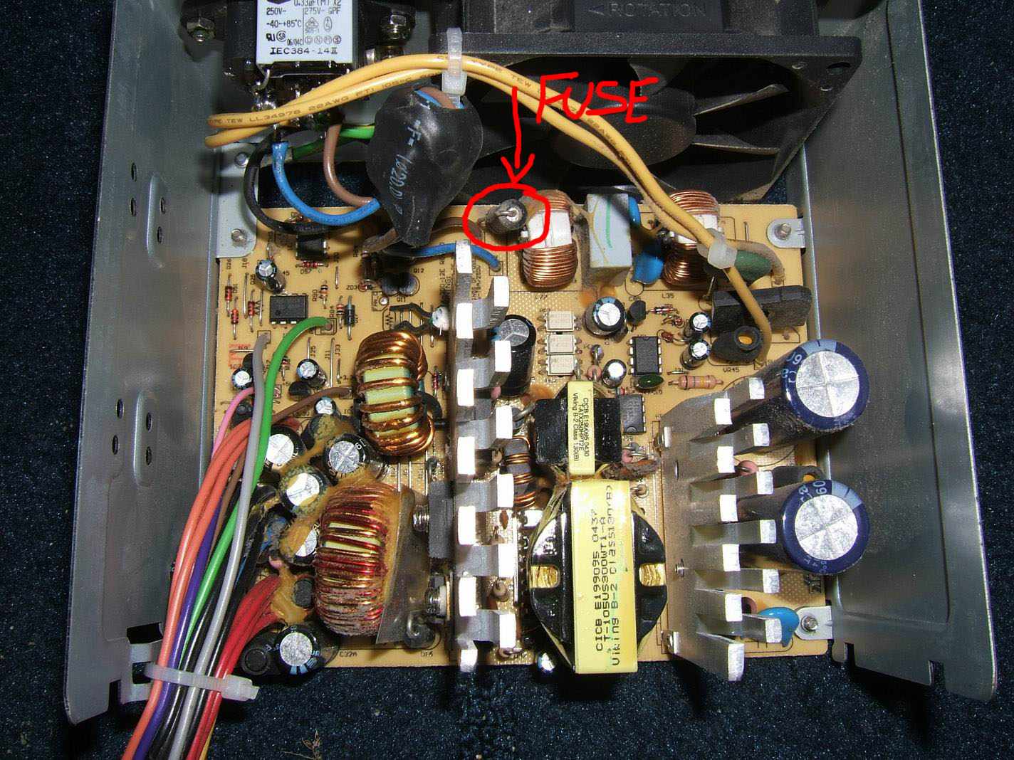

    I am extremely new at this - please forgive my ignorance.
    My question - is there a fuse in the Bestec atx-300-12Z power supply.
    If yes where do I find it.
    many thanks,
    Ian.

      Re: Bestec atx-300 12z power supply
      yes there is. follow the lines in from plug on back! fuse should be right in that area!
          Originally posted by deni2710
          Thank you SO much.
          Much appreciated.
          Have a good day,
          Ian :-)
          If you find it blown, there is probably something else shorted.

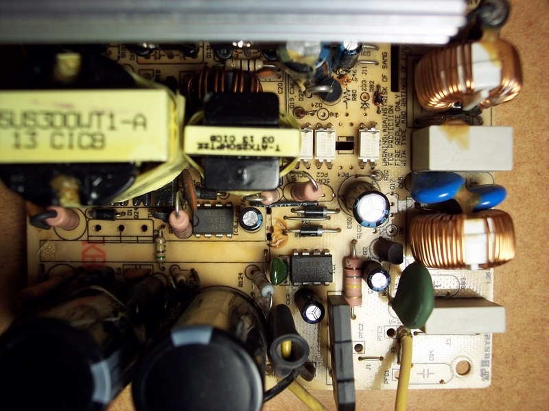

            I know this is a long shot here without you guys being able to see it in person, but I was somewhat defeated by an ATX-300-12Z (Rev:BD) last night and feel like I have unfinished business.
            Someone had a machine which was giving the flashing PSU LED and not booting, and gave it to me. I read about some of the cap issues and sure enough C36 is slightly bulged and reads high ESR. I replace that, along with the two giant main filter caps (just because I had an almost new pair beside me), screw the board back in, and plug it into the wall....BANG!...poof ...stinky smell.
            Damn if I can tell what exactly it was that blew up, but the three caps went in with correct polarity. I also rechecked all my soldered points and they were perfect. I did notice when I pulled the board back out that Bestec had done a rather sloppy job of trimming leads on the through hole parts, and some had almost a quarter inch sticking through the bottom in random directions, so it's possible something got squashed into a short on reassembly. It also had a few spots of the darkened brown glue which may have gone conductive (wasn't aware of that before reading here), but if that were the cause, I suppose it would have blown up or malfunctioned the last time it was working, which was only a week or two back.
            Strange part is, I happened to have a Bestec PSU board I had scavenged for heatsinks or something here which had almost the same layout and about 60 or 70% of the same parts, so I began randomly swapping similar things and must have replaced about twenty components with no change. No light, no power, and it doesn't seem to properly discharge itself after I unplug it. Not sure how or what they normally do there, but it seems to dump current back onto the AC line after I switch the power strip off, and can actually "re-light" the light on the power strip, which I've never seen any healthy supply do.
            I've checked the main fuse of course, swapped several disc caps, the main bridge rectifier, both main yellow transformers, a few diodes, a couple of the main (heatsinked) transistors, one or two of the 8-pin chips and a bunch of other mess. I've checked many of the other diodes and stuff with the basic diode check on my DMM, but I'm not sure how much that can tell me.
            Sorry for all the text, but I figure anybody that knows these units might want to know. If there's any specific part or area I might replace or check for something, I'd be interested.
            Thanks!
              If you have changed out both yellow transformers, the large one is probably the same, but the smaller one is not the same between the 12Z model and the 12E model. This lack of compatability can cause a big bang. Check the pc board you are taking your spare parts from for a model number written on the pc board and let us know what you have.
                Thanks Everell, and sorry it took me a bit to reply.
                No, all the part swapping stuff was actually post-bang. When it blew up, I had only replaced C36 and the two big 200V caps. I'm not sure what that Bestec board is I had laying around, but I don't think it's even from an ATX-300-12 anything. Only number I see is "0314". It has smaller 470uF filter caps and the layout is different in a bunch of places. I don't think any of my scrap supplies had a 24-pin connector either (they're mostly P4 era junk). I was checking the actual numbers on the replaced components as I went along, and I'm pretty sure they were all the same. The smaller transformer is a T-ATX250HPT2E on both boards.
                That explosion still baffles me. It sounded like a mid-sized cap blowing up, and I'd expected to have at least seen some scorch marks or something pointing to where it was, but there was nothing. I still think it was shorted leads on the bottom side.
                If there are any pointers to tracing this fault, or places I can check, I'd be interested. With all that this board has been through at this point, I'm not sure I'll trust it for anything important, but I'd feel I'd accomplished something if I could revive it somehow.

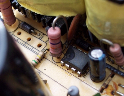

                            I had a bad feeling that's the chip you were talking about. It's one of the ones I didn't swap, and on my board, it's totally buried by components and heatsinks (I've got those 'L' shaped ones that cover that whole area).
                            I'll try to get on it later tonight, but I may have to do some desoldering again. FWIW, the donor board does in fact have an A6351 if I need one.
                              Hey again Everell,
                              Finally got a chance to dig that heatsink off again. It is indeed an A6351A (on both boards actually). I thought I was onto something the other night as I thought I found one of the surface mount resistors in that area to be open, but I may have had my meter on too low a setting or something. I'm hoping whatever component is at the root of the failure isn't popping certain things in its path when it powers up. I'm getting weird readings on R125 now, which was the one I believe was open, and it was replaced the other night (supply stayed dead though).
                              If you get a minute, let me know what you think I should do. I extracted that 6351 chip from the donor board, but like I mentioned, I'm not sure why I have that board or if it contains any failed parts itself.
                                Measure the 1.2 ohm resistor coming off pin 1 of the A6351 chip - should be about 1 ohm (labeled R124 on my drawing). Measure the 180k resistor coming off pin 3 of the A6351 chip (labeled R130 on my drawing). Also coming off pin 3 of the A6351 chip is a 10 uF/50 volt capacitor - measure its esr. If these components all look good, double check that you don't have any solder bridges in the 5vsb area of the pc board. You can power up the board with the main switcher and heat sink still out of the board. Pin 3 of the A6351 should measure about 16 volts.

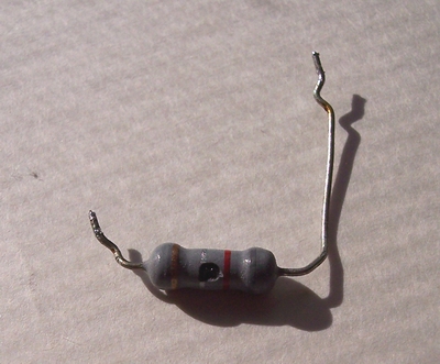

                                  Didn't make it past the first checkpoint Everell. R124 read as wide open and when I pulled it, there was a nice little black hole hiding on the backside. May finally have an answer to my big bang mystery.
                                  I'm off to track down a replacement. I'll let you know what it does (with safety goggles, of course ).
