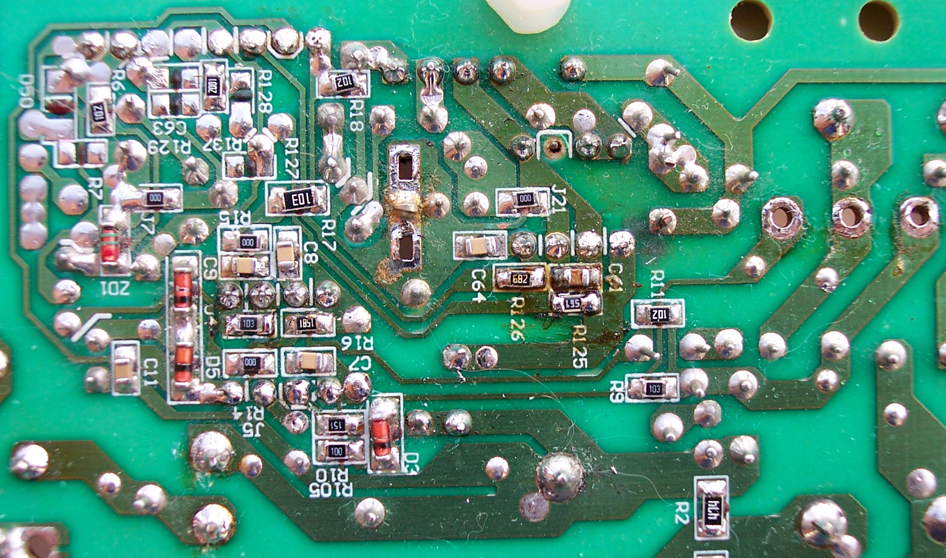

            • Nov 2013
            • 62
            Re: Bestec atx-300 12z power supply
            Everell,
            Brace yourself, this thing's gnarly looking up close. I took one inside the other day, but it wasn't clear enough. Keep in mind, some of this stuff is from all the desoldering/resoldering and my failure to clean the board, but that was all after the big explosion anyhow. IIRC, there were already a few "browned" areas when I started.

            • everell
              • Jan 2009
              • 1514
              Get a bottle of rubbing alcohol and a small brush. Give that board a good scrubbing. If you see anything that appears to be shorting across traces, use an ice pick or similiar tool to scrape it away. Solder bridges are sometimes hard to see with the naked eye. You would be surprised at how many problems go away just by cleaning a board with alcohol.

                • everell
                  • Jan 2009
                  • 1514
                  Originally posted by Jidis
                  I always figured that sort of "robot made" stuff was all or nothing.
                  Its "ether" theory.......ether it works or it doesn't!
                  Remove R130 (180K 5 watt) resistor from the top side of the board. Measure it and make sure it is still 180K. Solder it back in place and then clean that board with alcohol.....completely clean. On bottom of board make sure that the capacitor next to R125 (561) is not shorting on either side. Carefully clean between these two components. On bottom of board measure J21......must measure zero ohms or you have lost a ground.

                  • Jidis
                    • Nov 2013
                    • 62
                    #29
                    Hi Everell,
                    R130 is good (checked). There does appear to be continuity between pins 1&2(GND?) of the A6351 chip, so I'm going to try to look into that cap/R125 combo and make sure nothing is bridged. Without removing them I can't tell exactly what the traces are supposed to be doing, but I'm going to try to avoid it.
