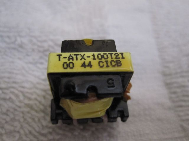

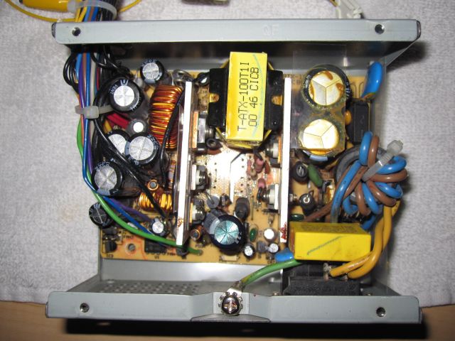

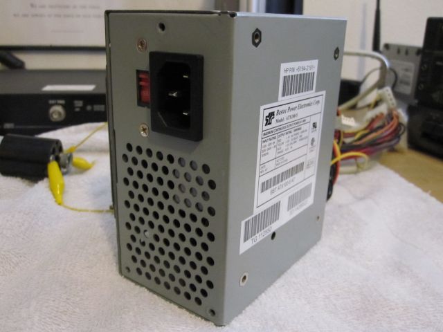

      It's a MicroATX sized PSU, OEM for HP. Has an HP p/n on it 5184-2191. A coworker gave it to me years ago because he knew I liked to tinker. Original problem I think was the fan was too noisy, so I dismantled and lubed the fan. Found a few bloated caps while I had it open and replaced them with stuff from my junk bin.
      Numbers on the transformer looks like T-ATX-100T2I 00 44 CICB, but I've also included pics of it.
      Yes, it looks like a two transistor 5VSB to me. I know Bestec is crap, but I have a hard time trashing anything because I hate waste. That, and I actually do need a small mATX sized PSU!

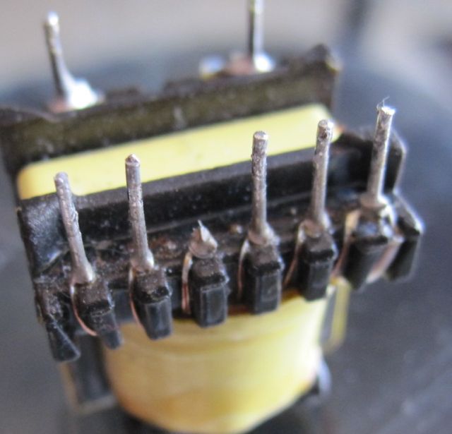

          Looks like the pin came out of the transformer, better solder that back on and re-attach the wires to the pin!
          Check the transistors in the 5vsb primary circuit.
            Do you mean 3rd from left? If so, that's supposed to just be a nub (no hole for it on the PCB). I think it's supposed to be an unused center tap for the 1st and 2nd pins from left. I've attached a closer pic so you can see what I mean.
              Ah yeah nevermind...
              Check the transistors in the 5vsb circuit, especially the one on the heatsink.

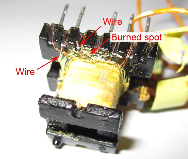

                            It's open-circuit between the two primary input pins. Actually, it's open-circuit between one pin and the center-tap nub, so I think it's that specific winding.
                            I was curious, so I decided to perform a transformer autopsy. I had to unwind the main secondary coil to get to the primary winding, but it happened to be the winding directly below that. There was a darkened burned looking spot and both ends of the coil were severed at that spot. It appears to be where the wires were cris-crossed and touching. Only thing I can think of is the enamel wore through at that spot causing that coil to short and it generated enough heat to burn through both wires, but that's just a guess. I've attached a photo, but I took the pic at night so camera flash washed it out pretty badly.
                              Smoking transformers are no fun, I've burnt out a few myself xD

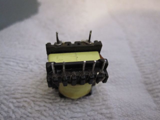

                                I soldered the little wires back together and re-wrapped the transformer. I put it back in, expecting the PSU to either fry or work. It did neither. No magic smoke, no voltage from 5VSB, nothing, just DOA. Checked primary coil resistance again and it looks fine. Looks like the switcher isn't switching, although I'm not sure if you can tell that with just a multimeter.
                                How can I isolate the ground on an AC-powered earth-grounded oscilloscope so I can see what kind of signal is going into the base pin of the transistor?
                                    Are you sure you put the transformer back together the right way?
                                    Check the power transistor and the transistor that drives it, one or both are likely bad. If they measure good, one or both could be open circuit.
                                      I think I did, I took lots of pics during the unraveling, although I did break the ferrite core trying to get that apart. I've read they will still work even when broken though.
                                      I'll pull the transistors to test out of circuit later on when I feel like messing with it again.
