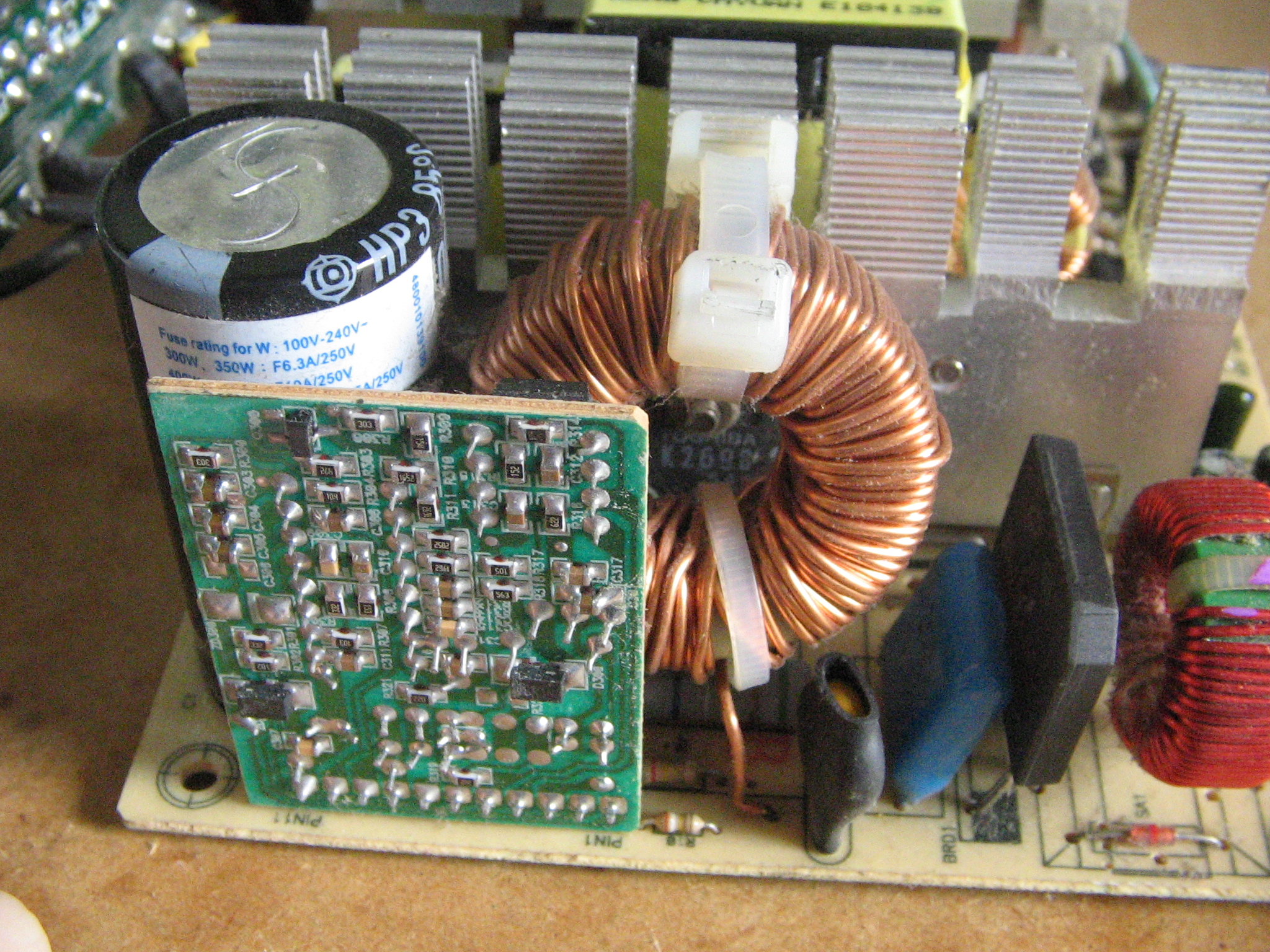

    A couple of days ago I turned my old Athlon 64 machine on and soon after power-on I heard a loud clicking noise.
    It sounded very much like something knocking against fan blades, so I disconnected the case fan, put my finger on the CPU fan and a pencil in the PSU fan.
    No, the noise still happened.
    It seemed to be coming from the PSU itself. The PC was running 'perfectly' but as the PSU seemed to be the problem I immediately turned it off.
    I disconnected the PSU and powered it up with a jumper. It still made the clicking just not as much and maybe quieter.
    I found the higher the load, the faster and louder the clicking.
    Seems very odd that the PSU still runs while making such an 'bad' noise!
    I searched the forum and found a similar problem posted here: https://www.badcaps.net/forum/showthread.php?p=250827
    I also got this response:
    Originally posted by ben7
    Check the diode in the pfc circuit.
    But I want to start a separate thread here to avoid confusion.
    So, where is the PFC circuit and what kind of diode am I looking for?

    PFC is usually on the primary side, either on separate heatsink, or with switching transistors.

      It will be mounted on the primary heatsink, its just a single diode, not a bridge-rectifier. You can track the leads from the PFC choke, and you will find that diode, and a mosfet.
      It will help if you temporarily remove the primary caps to get a better view behind them.

        It looks like a transistor, but has two legs. In this picture, it's the part to the far right (the other two parts are the PFC transistors)
            That link is bad.

              Re: Enermax Liberty ELT400AWT making clicking noise but still running
              OK, Fixed. I attached it (it works here, though)

                          I got the thing open and figured out how to extract the board from the case...
                          I believe I've found the PFC diode, an I.R. HFA08TB60 - hidden behind the main capacitor, the PFC coil, and a little sub-board (The PFC control circuitry??) - see photo
                          Also there should be a high power low ohm resistor for the current sense in the pfc circuit, you might want to check that. If its value has gone up it could fool the control circuit into thinking there is a short circuit.
                          There's a large (~1 watt size) resistor hidden under the primary-side heatsink just behind the HFA08TB60.
                          Coding seems to be Brown-Orange-Silver-Gold-Green which doesn't match up with any chart I know - what value do you suppose it should be?
                          EDIT: Totally missed another, larger resistor just below the PFC coil. Code is Orange-Blue-White-Gold-Green.
                          What should I be testing\checking the diode for?

                            Short or partial-open. Use diode tester, what does it read in both directions? If I am nto mistaken, ordinary diode should read arround 300 ohm minimum.

                              Going by the datasheet this thing is a bit more interesting than an ordinary diode... that said...
                              Diode check on multimeter says nothing in reverse bias and "448" in forward bias.
                              Resistance test says infinite in reverse and 530k Ohm in forward.
                              A standard 1N4004 shows "587" on the diode test and 618k Ohm on resistance. (forward bias)
                              I do believe though that some faulty semiconductors will appear fine on a tester but fail in-circuit because of the higher working voltages. How to test that I am not sure.
                              The resistors both measure very low values:
                              * Brown-Orange-Silver-Gold-Green reads as 0.12 Ohm
                              * Orange-Blue-White-Gold-Green reads as 0.03 Ohm
                              -David VanHorn

                                It is more or less typical ultrafast to me…
                                The first resistor looks like non-standard 0,13 ohm. Silver seems to act like x0,01.
                                The second is 36.9 ohms, ± .5%, according to calculator.
                                  I think the same. It's probably good.
                                  The BR-OR-SI-GD-GR resistor is supposed to be a 0.13 ohm 5%.
                                  The OR-BL-WT-GD-GR resistor is supposed to be a 36.9 ohm 0.5%.!?
                                    That second resistor (actually R14 on the board) is an oddly, very specific value... and shorted too?
                                    Maybe it's supposed to be 0.0369 ohms 0.5%... no, that probably makes even less sense.
                                    Even if that is the case.. where the heck do I get something that specific.. and WHY does it even need something that specific?
                                    Maybe it's time to draw out a schematic and try to figure out what that resistor does...
                                    Probably time to let you all in on a little secret... I actually have another Liberty 400 lying around... it was my friends and it blew a hole in a MOSFET. I didn't go any further than noticing that (and suspected the brown glue of death) but I guess I could have a look at its R14 resistor and see if it's the same.. of course it may well have had a similar problem, so that might be a waste of time.
                                    Aside from the resistor, could there be anything else that's easy to check?
                                      The marking should be right, we used two independent calculators. If you won't find exactly same, you can always buy 33ohm plus 3,9ohm in series, you should easily get these two.
                                      • ben7
                                        Capaholic
                                        • Jan 2011
                                        • 4059
                                        Try measuring the resistance of it the other way around.
                                        Also, what is this resistor connected to?
