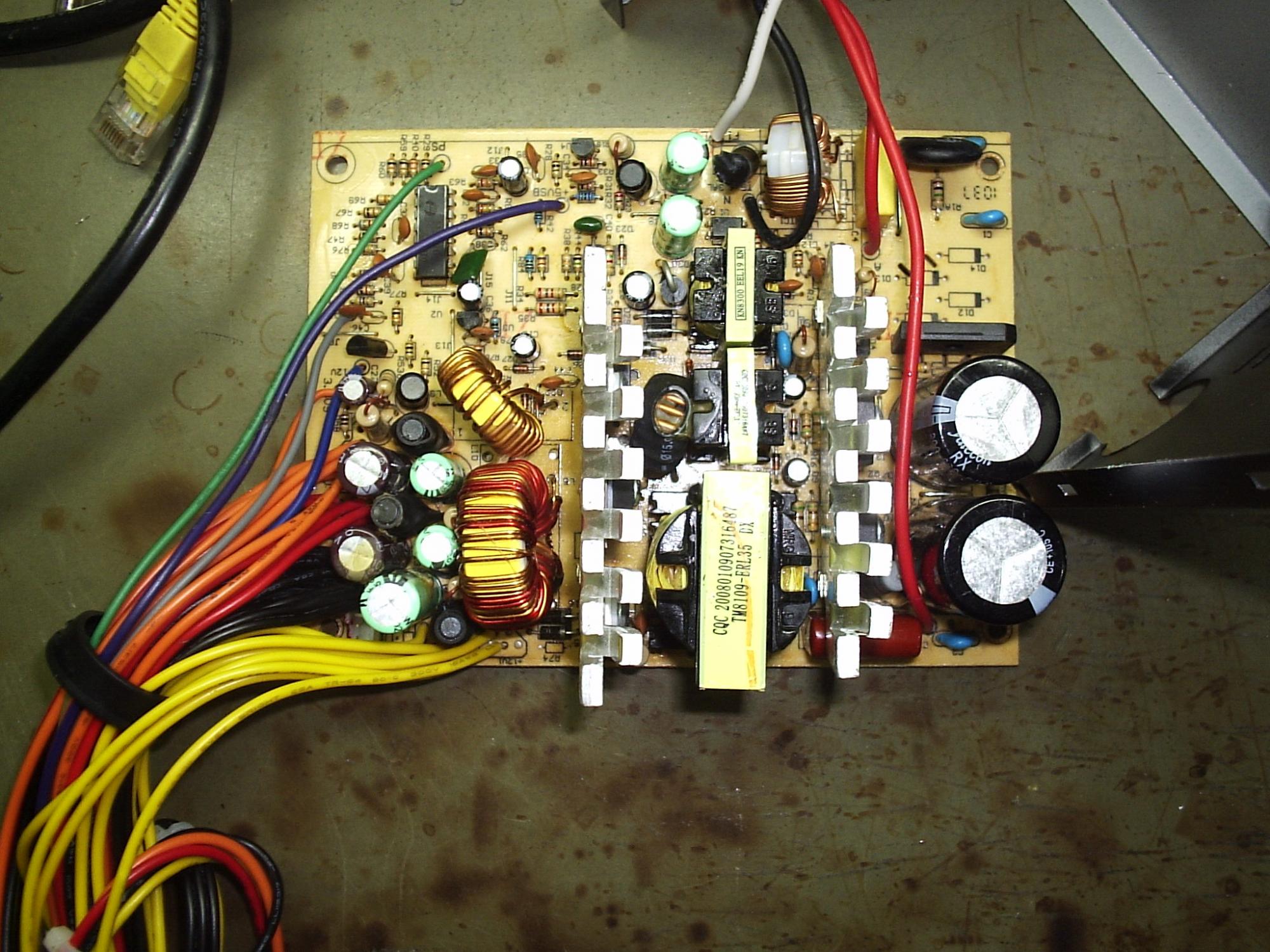

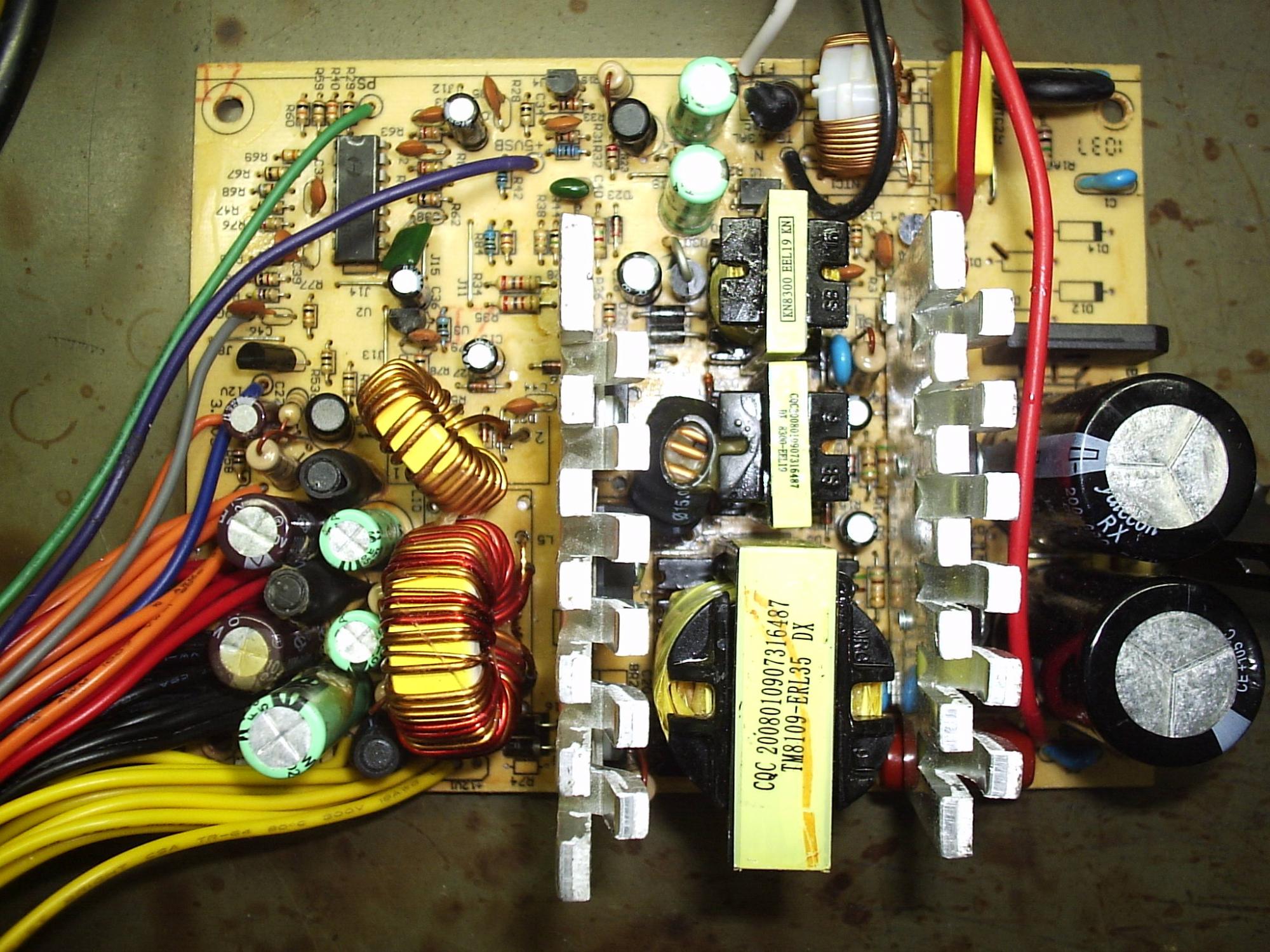

    It hisses a lot, without load. 5VSB is ok, also the other voltages when jumpered on. No caps bulged ( those in the picture are the original ones ) .
    When jumpered on with load ( just one hard disk ) it shuts down and won´t start. Tried changing the rectifiers, same thing.
    Tried changing the caps one at a time, to try in identifying the culprit, also no go. Even after changing all of them, it still hisses and shutdown.
    With the paper tube trick, it seems the sound comes from the big transformer.

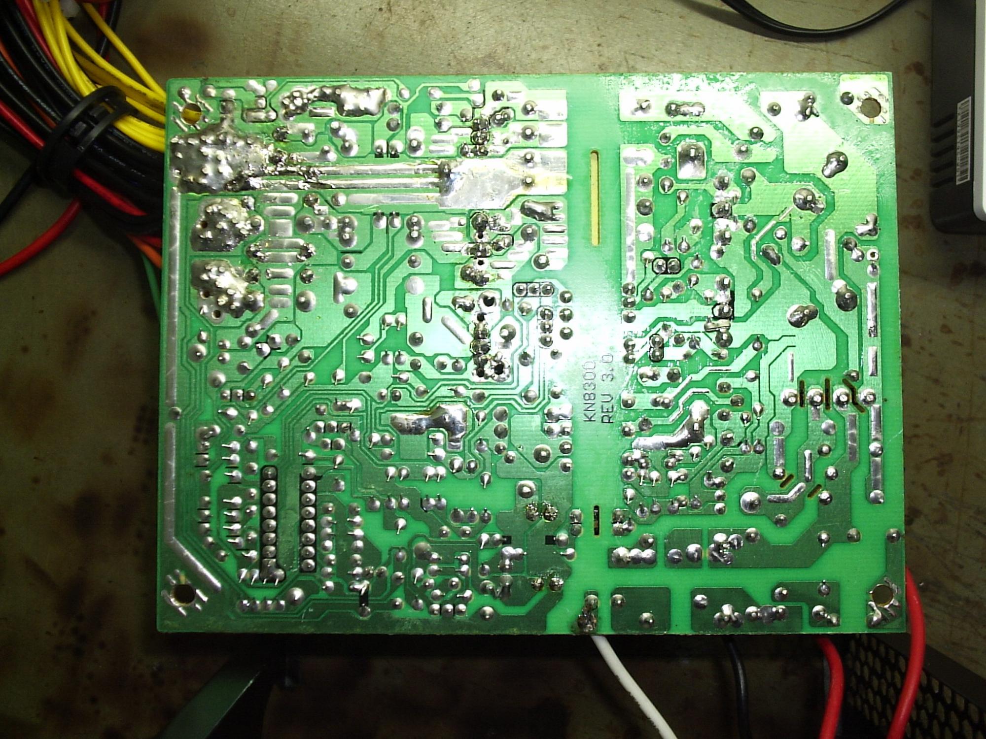

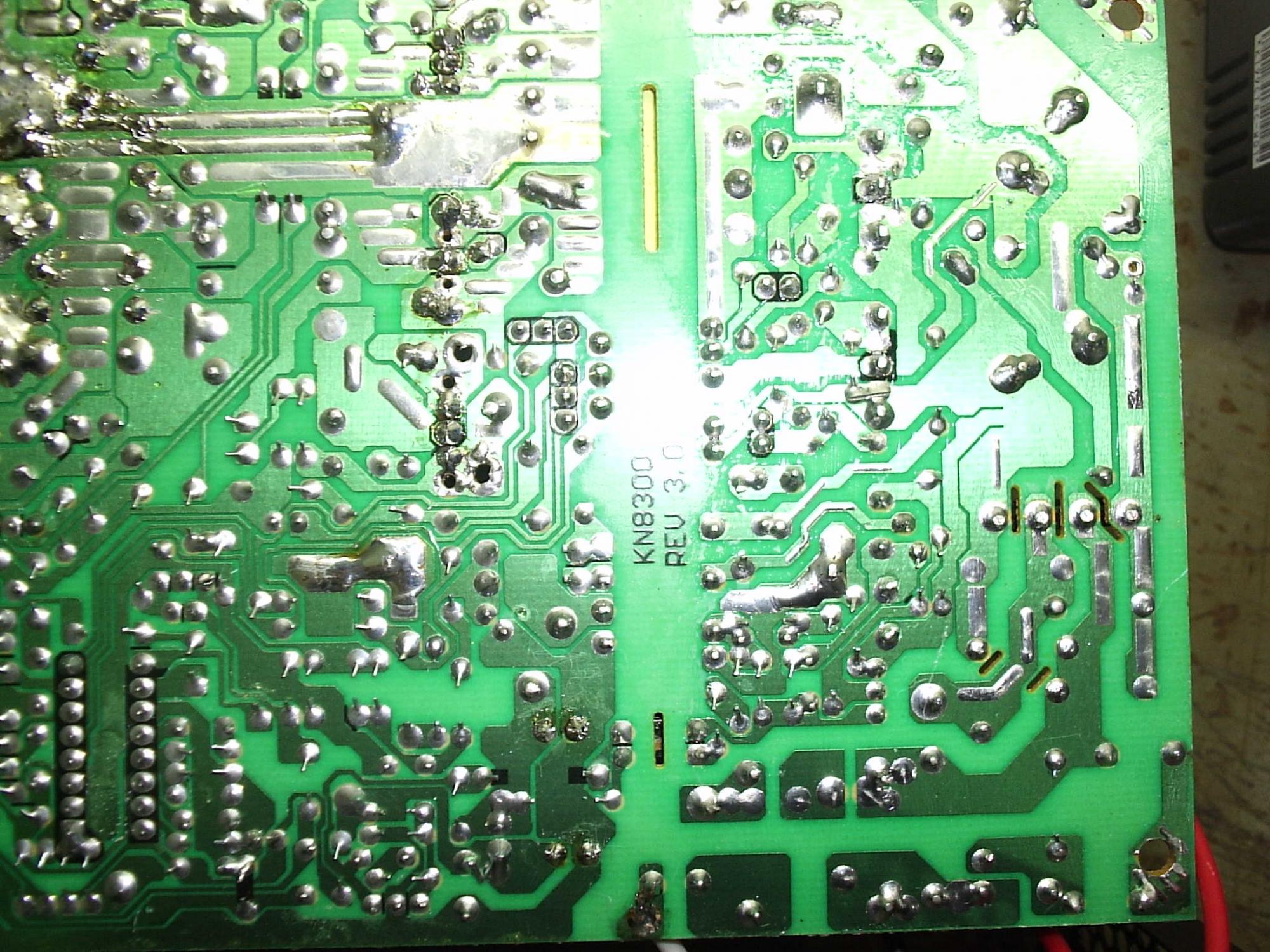

    Picture of the bottom of the board might help - have you tried resoldering the transformer connections

      No, not replaced the yalecon ones. I only have those cheap 330uF ones from gutless wonders.
      I used a bunch of Nichicon PM and HE, also Panasonic FM that I had lying around.
      Here are the pictures of the bottom.
      No cap leaked, the smudges are remains from glue that was between the caps and the toroid.
      Will try resoldering the big transformer.
      Edit : transformer resoldered, same thing. Hiss without load, won´t start ( but stops hissing ) with load.

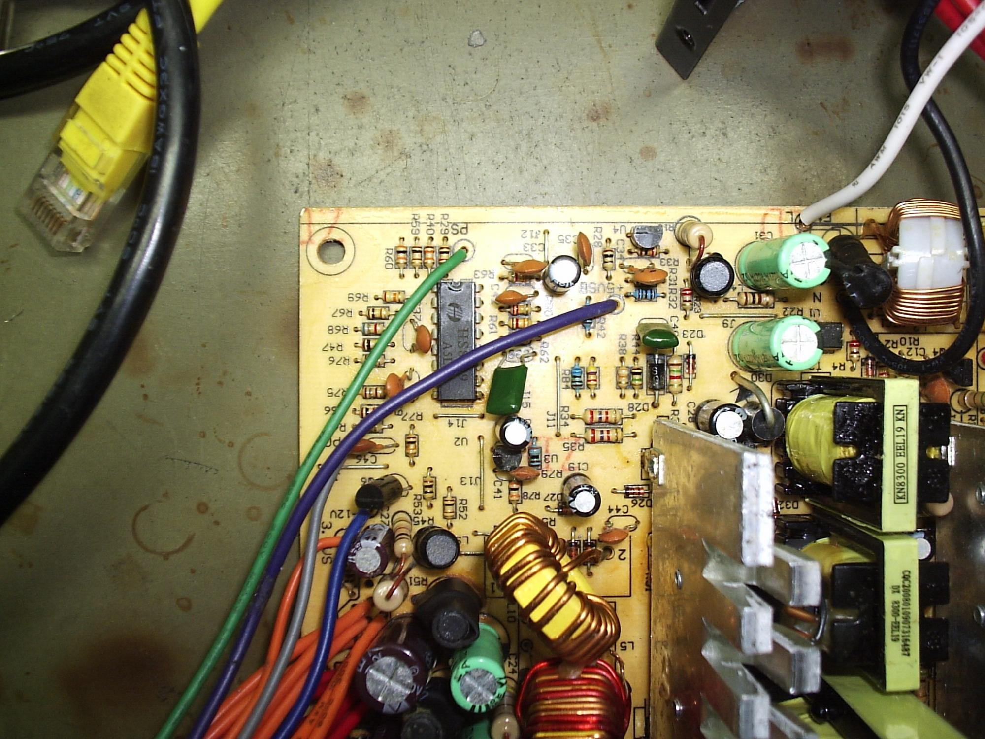

        Hissing means oscillation, irregular operation of the control circuit. Sounds like something is gone in the driver circuit since it stops under load. Check the driver transistors (they will be somewhere near the base drive transformer, in the secondary side, usually C945 in TO-92, but depending on the controller and its supply voltage they might be 1A ones, in a fatter package) and the drive circuit in the primary, on the other side of that transformer. Here you have a schematic, values may not be exact but the basic circuit will be the same.
        https://cdn.badcaps-static.com/pdfs/...ff4ca9d17c.pdf
        By the sound of it, i'm fairly certain that one of the driver transistors is gone, everything else is probably okay. Replace both of them and give it a try.

          They are D1616A. Replaced them with BD139, that was the most similar we could find in the store. Will need to check in the junk pile at home if I found the exact same part.
          But the behaviour remains the same. Voltages ok without load, shutdowns with load.
          I also measured the diodes around the transistors ( Q1 and Q2 in your drawing ) , but all of them measure ok. The cap in a position C8 is a 10uF x 50V, also measures ok (10.5uf ) .
