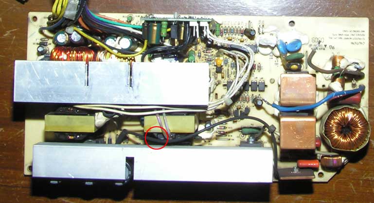

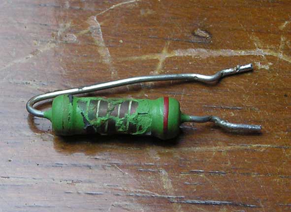

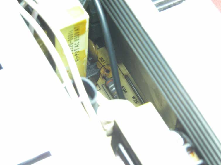

    During desoldering, I found a resistor covered with cracked heat shrink tube.
    When I removed the tube, the coating of the resistor chipped off with the tube.
    So I removed it from the board. It measured 19.88K. The color coding looks like 20K.
    So it's probably a 20K. The size is around 5 mm in diameter and 15 mm long.
    It was located near a transformer, in the red marking.
    Can I continue using it or should I replace it?
    From searching on Digikey, it's probably 2-3 watt.

      That resistor looks quite toasty. You can keep using it but it wouldn't be a wise idea. Either type is fine, but it should definitely be 3W.
      A working TV? How boring!
        Re: Powermac MDD 2002 PSU API1PC36 REV-A 360W Recapping
        I would go with Flame proof MOX.

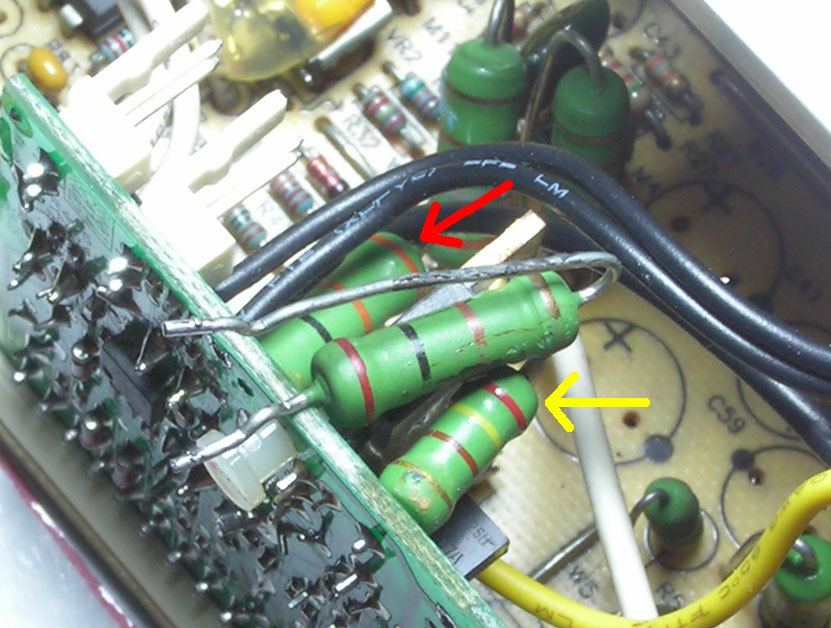

          But now I'm not so sure if it's a 20K. The color code looks like Red, Black, Orange, Gold.
          But the orange isn't so bright, a bit brownish. If it's brown, the resistor is
          then a 200 ohm.
          I've attached two pictures. The first is the location where it used to be. The second is to
          compare its color (the other side surface is still intact) with other resistors. As you see,
          the one with red arrow has got bright orange. But at the same time, another one
          (yellow arrow) has got darker brown than the chipped resistor.
          Can a failing resistor increase its capacitance from 200 to 20000?
          I'm thinking I'd go with 20K. Since that is what it measured.
