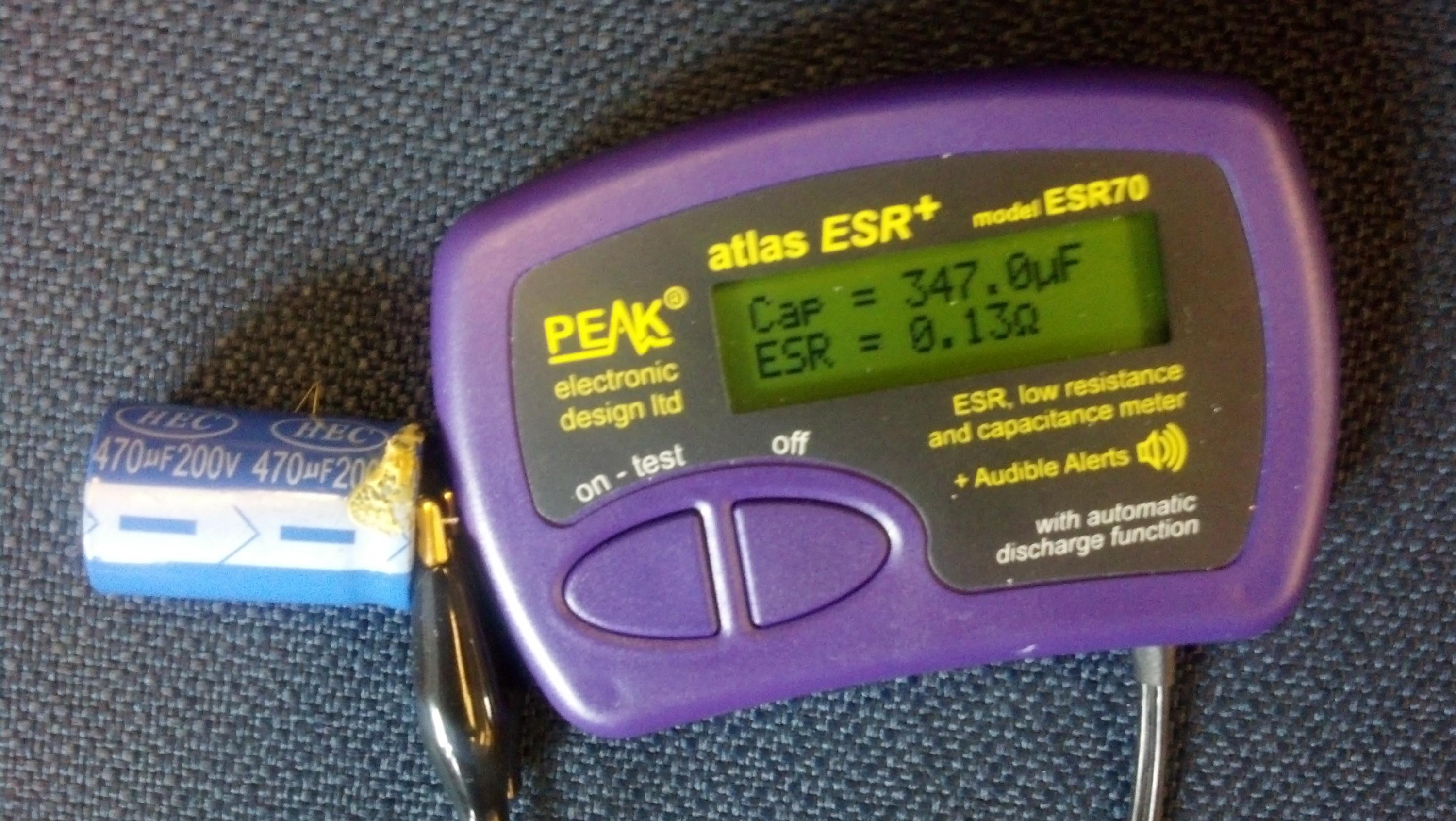

          Re: Fake primary capacitors
          That's a good assumption. Unfortunately it depends...Another 470uF HEC input cap that was black instead of blue was actually 470uF. And a CS cap that I figured would be fake was its actual value. I wish they were more consistent!!!
            Weird!
            Or, WHAT THE HEC!
            Even the fuhjyyu is overrated! :P
              The Fuhjyyu is actually within tolerance (barely...), so it isn't necessarily fraudulently labelled.
                Originally posted by ben7
                Weird!
                Or, WHAT THE HEC!
                Yeah you're right. I measured the other one that ran along side it and it measured 433uF so I assumed they were really 470's I should have posted the picture of that one

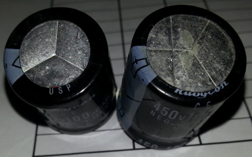

                      I found these fake Rubycon snap-in units in two identical Chinese power supplies.
                      Officially, Rubycon USP only comes in 85C whereas these fakes (both USP series) were labelled 105C.

                        #31
                        Haha well found!
                        Got any esr specs and capacitance specs for the fakes? (I.e., are they actually 100uF?)

                          #32
                          Those are some decent looking fakes. Also curious to know their actual capacitance

                            #33
                            Notice the wacko vent shape on one of them!

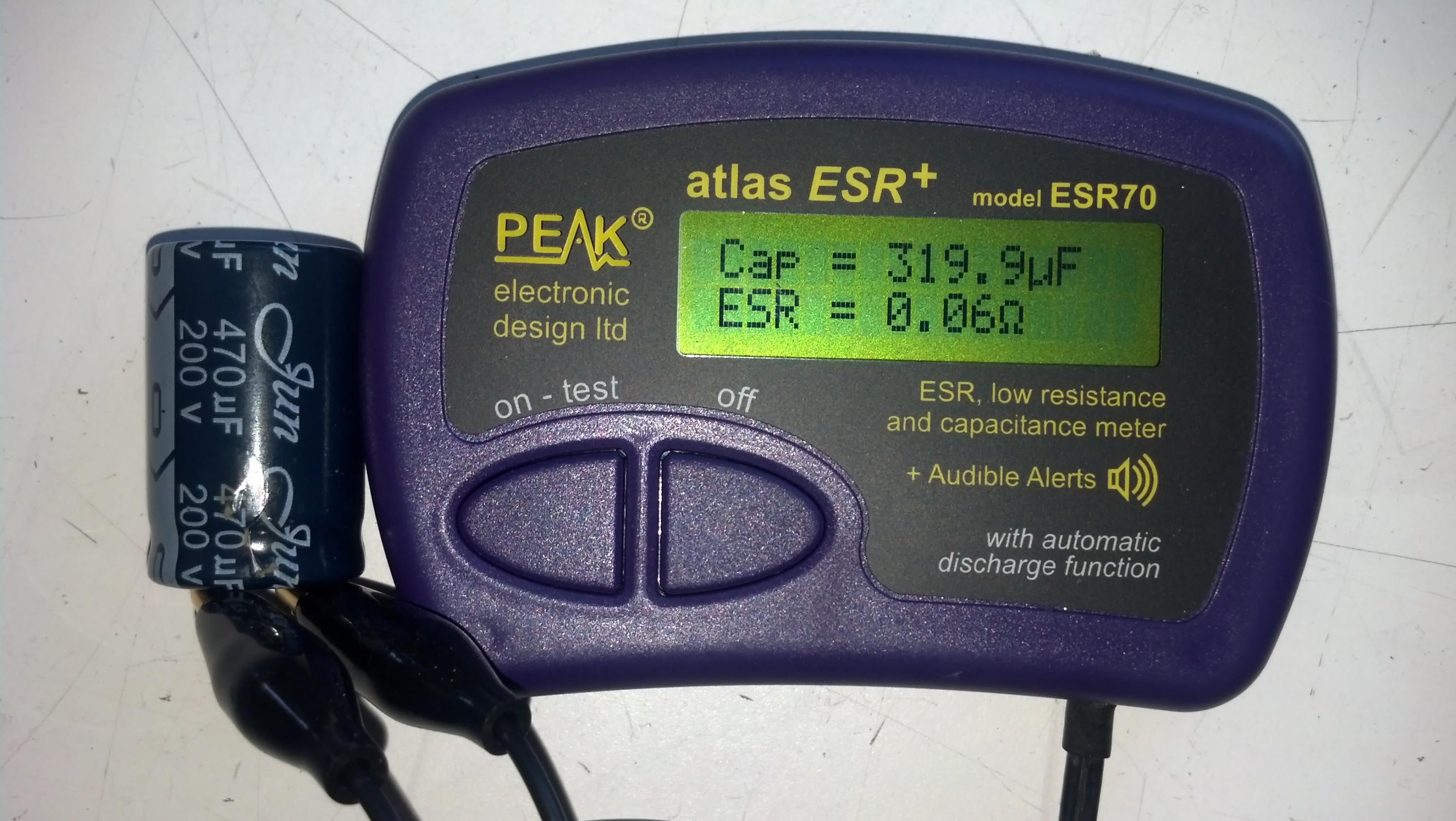

                              #34
                              The JEE 330uF 200V primaries which came out of this trashed King World ATX-250W PSU measured at 202.8uF and 198.8uF respectively, both with an ESR of 0.07 ohms and a date code of 9828. No doubt they are 220s with a 330uF label, as they are still in tolerance of said capacitance.
                              Same again with Su'scon. The two 470uF 200V LXs I ripped from an L&C LC-230ATX were measured at 312.0uF and 319.9uF respectively; both 0.06 ohms ESR. As with the above caps, they are well within tolerance... of a 330uF capacitor. This PSU was also from 1998.

                                #35
                                Yeah true! But they probably had plastic discs over them though?
                                Wow that's crazy, doesn't surprise me though from L&C

                                  #36
                                  That line through the side of the 'Mercedes' vent looks like they tried to turn it into a K shape to match what a Rubycon should have.

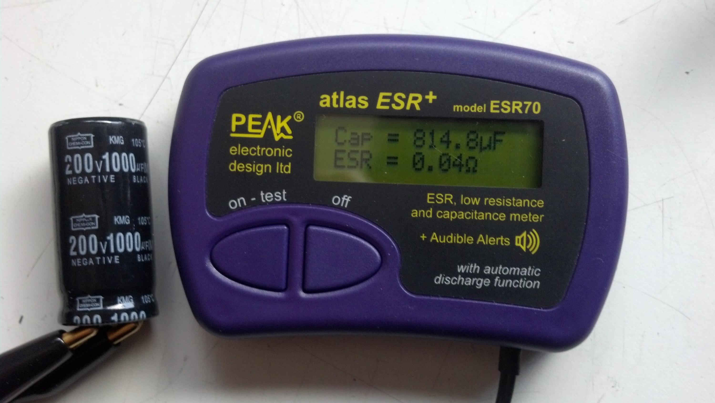

                                        #39
                                        I posted this in the hall of shame but figured might as well add it to this thread as well. Came out of a Leadman

                                          #40
                                          Fake one LOL
                                          KMG sleeves are supposed to be brown not black xD
