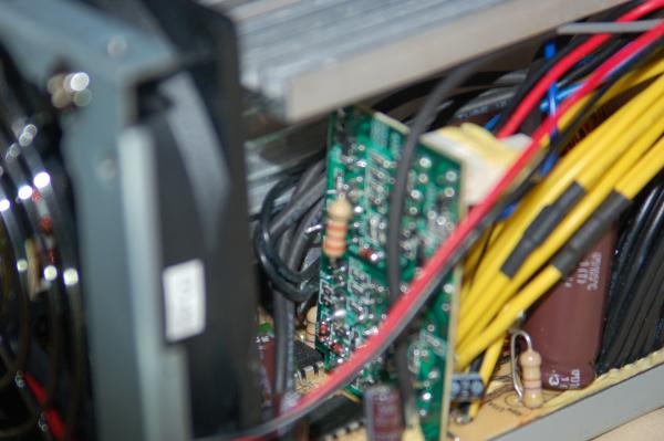

    I know this isn't the first Antec SP series PSU recap posted on this site but there doesn't appear to have been one for a while. I did a full recap (except fan controller) and fan Mod of this SP-350.

    Fan Mod Close Up:

    Other Modifications:
    Added heatsink to bridge rectifier
    Added 2200ohm resistor in parallel to thermal resistor. this keeps both fans spinning at ~1000-1500 rpm when cold, and they speed up as normal once the thermal resistor heats up and its resistance drops. This alleviates the hot running issues with this PSU.

    Re: Antec SP-350 Recap and Fan Mod
    Besides the thermal benefits of having some cooling at all times, that minimum fan speed may actually be better for the fan bearings, by keeping the lubrication spread on the bearings. A temp-controlled fan voltage regulator I worked with had a minimum output voltage chosen to have the fan running at all times. We had to adjust that minimum voltage from 6V to 12V. The sample Rotron 24V fan we had ran reliably at 5V (and we set the minimum at 6V), but Rotron only guaranteed 10V or 11V.
      Good point especially since Antec/CWT used sleeve bearing fans in this PSU where good lubrication is very important. This PSU is in my test/experimental system which is not heavily used so I left the stock fans in, if it was in a more heavily used system I would probably replace them with ball bearing fans.
          Looks like the photos in the original post aren't there anymore. :-(
          I'd like to see if the fan mod was anything fancy...
            They are still there. The fan mod is simply a 2.2K resistor in parallel with the thermistor. I do this with every smartpower I get my hands on.
