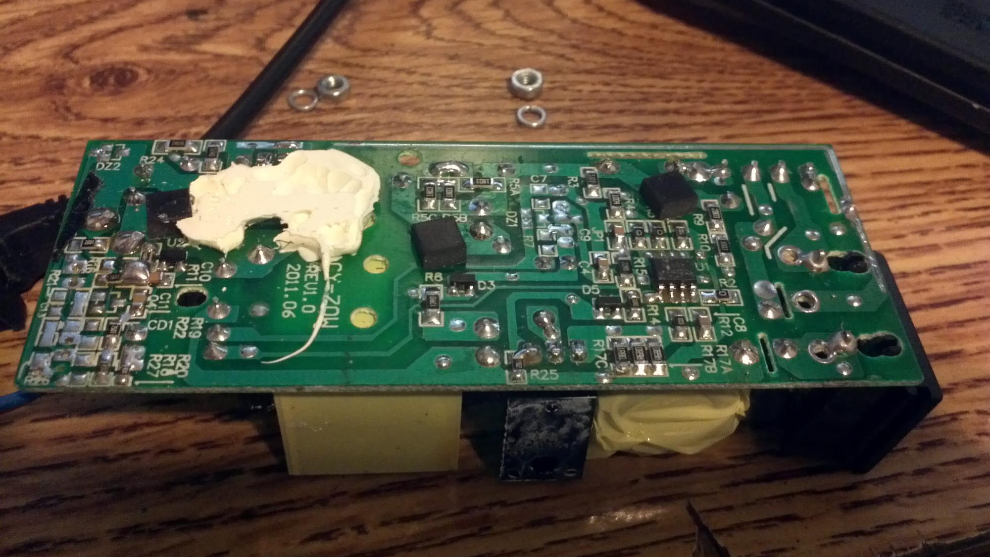

    I bought a used Lenovo T500 about a month ago and it came with a generic ebay adapter. Something that always bugged me about it is the Lenovo power software shows it as a 90W adapter, when the label clearly shows it being rated 3.25A@20V.
    Well, just recently, probably within the last day or so, it has developed a irritating ringing-like noise at low loads (sleep mode) which of course only myself can hear. Its very high pitched. If my hearing was more normal at high frequencies I dont think I would hear it.
    Any ideas what that could be? I cracked the case out of curiosity and I came across interesting. The primary cap appears to be a Chemi-Con. Im just going by color and negative stripe since its buried. But Im pretty certain thats what it is. The output caps, though, were "Lucky" brand. I turned over the supply and the bottom of the PCB has markings that seem to indicate its made by Lucky as well.
    What should I do with this piece? Buy a Lenovo one and toss this one or is it fixable do you think? I was going to get a genuine one but then I ran across complaints that shows a lot of people are having trouble with the cord failing right at the connector. So, I just put it off.

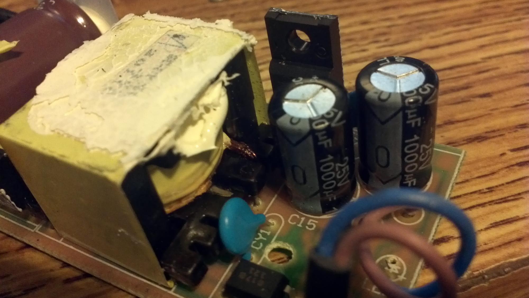

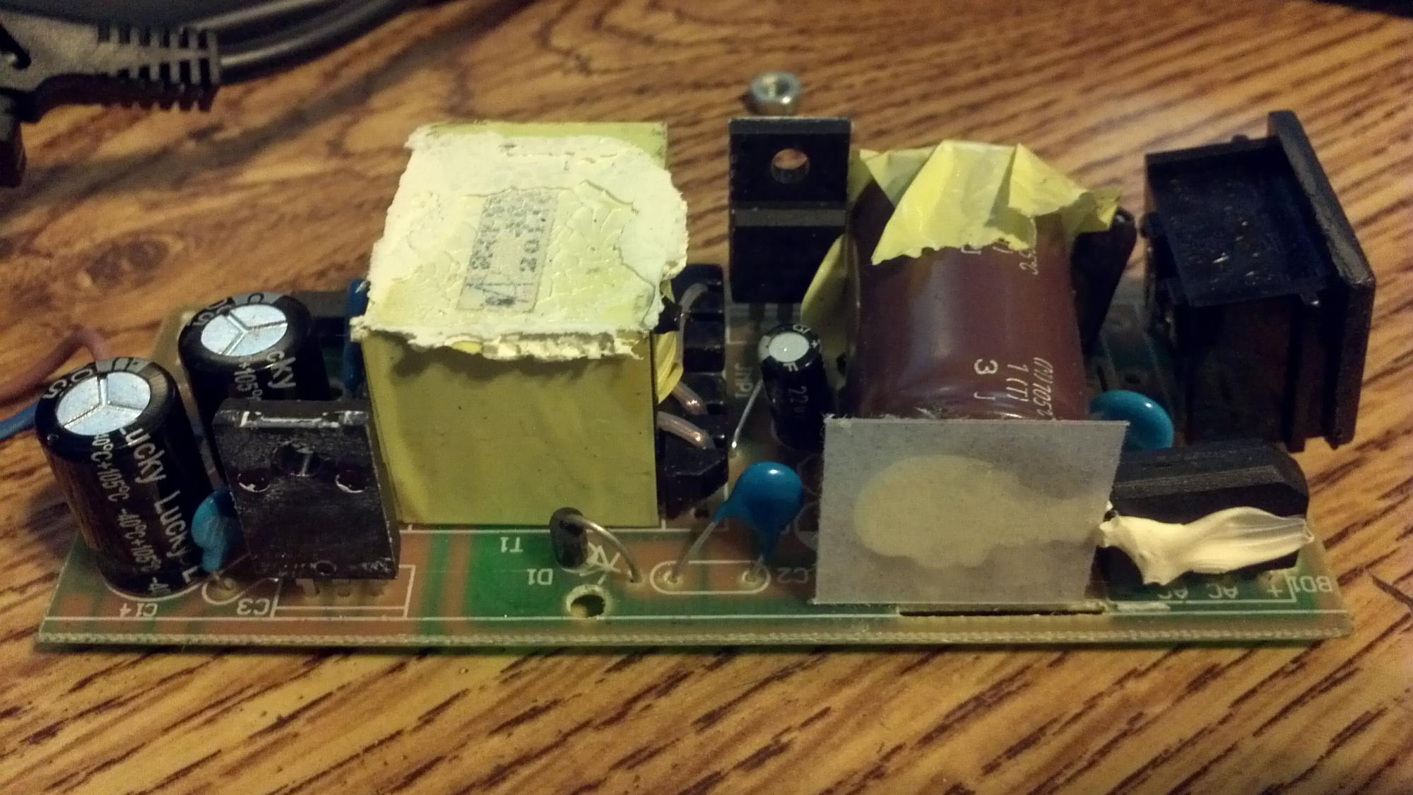

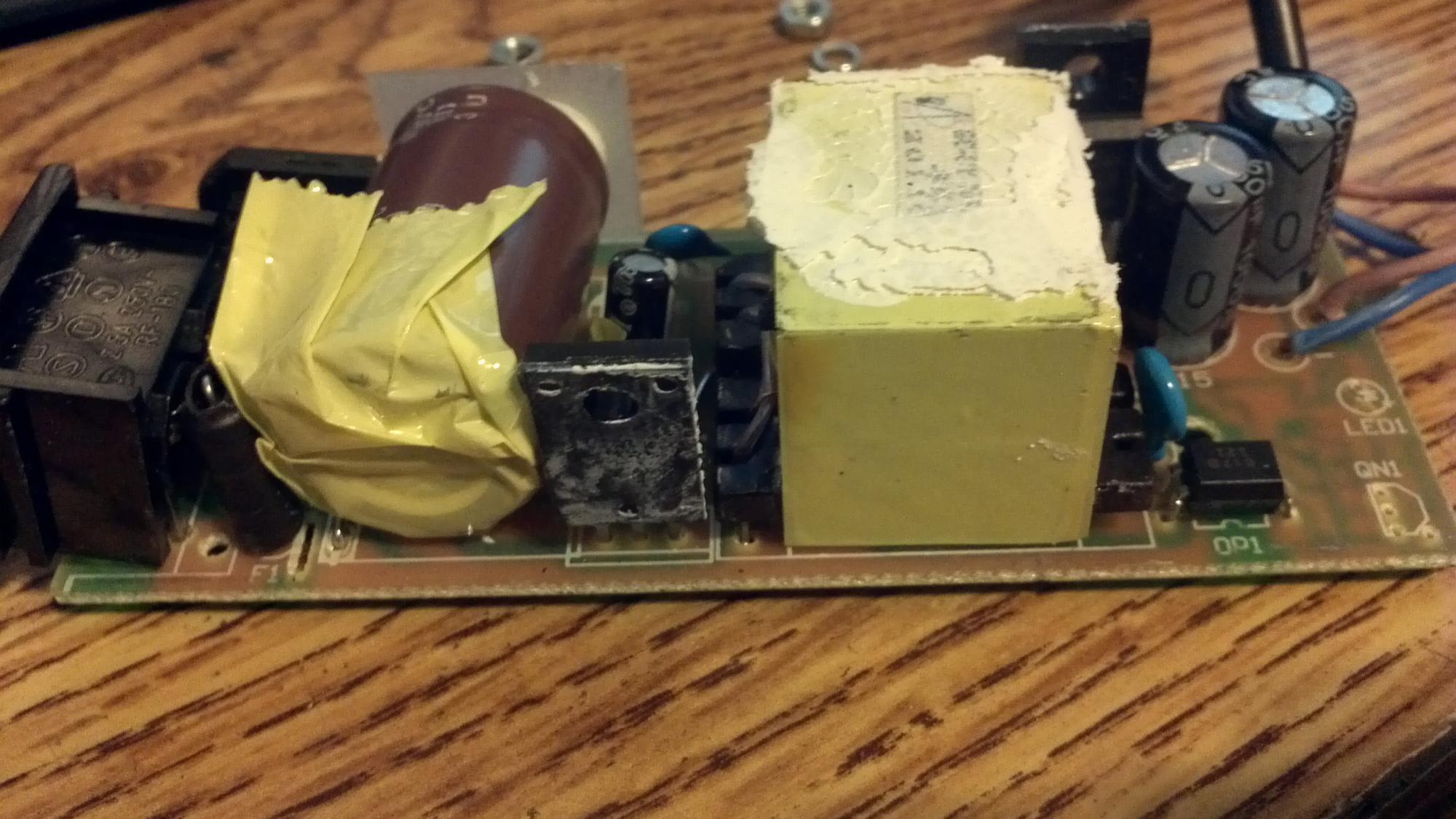

        I pulled the heatsink off to take some pictures. Unfortunately, the transformer appears to have overheated. You can see in my last picture the exposed copper of the output side of the trasformer along with some browning of the yellow tape along the bottom on that side.
        It does not have a communication wire. Just the output. This thing looks very basic to me, but Im no expert.

          Looks like the usual "replacement PSU" ebay junk.
          The fact that the transformer got hot enough to discolor the tape would make me grab an original Lenovo charger ASAP..
          The laptop might have switched to something like a fast-charge mode because it falsely detected a 90W PSU instead of a 65W one, overloading this cheapo. Or it's just so trashy that it couldn't cope with 3.25A load on the long run and overheated.

            I've seen transformers like that, with some sort of brown liquid residue on there, and they work fine. It might not be heat damage.
            Run it under load and measure the case temperature. It will be warm but should not be so hot you can't keep your hand on it.

              If I switch to discreet graphics and play a game, it gets very hot. I cant hold onto it.

                Then it is being overloaded. The CPU draws ~35W at full load, and the GPU another 30W. Add another 10-15W for everything else and you're looking at 75-80W total.
                The laptop originally shipped with a 90W adapter for a reason. I think that's what the software is telling you, that you should use a 90W adapter, because with only +/- there is no way of ID'ing what's plugged in. It will still work with a 65W one most of the time, because the 75-80W is at full load and idling it will draw much less than that.
                Get a 90W adapter if you plan on using the laptop intensively, a 65W one will not last long under those conditions.

                  Okay, I bought a 90W lenovo adapter.
                        "Lucky" brand capacitors?
                        Lucky if they work... heh heh
