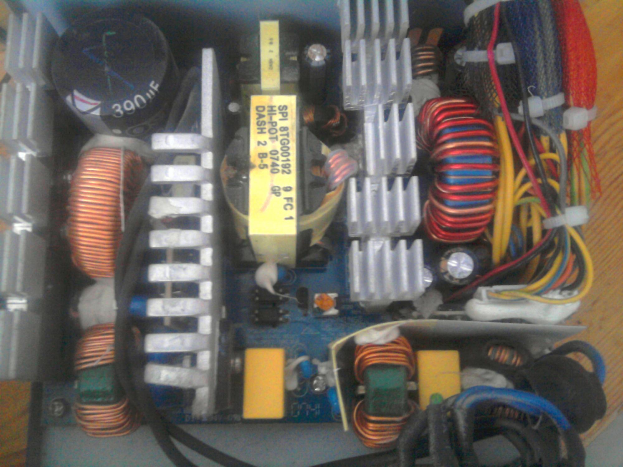

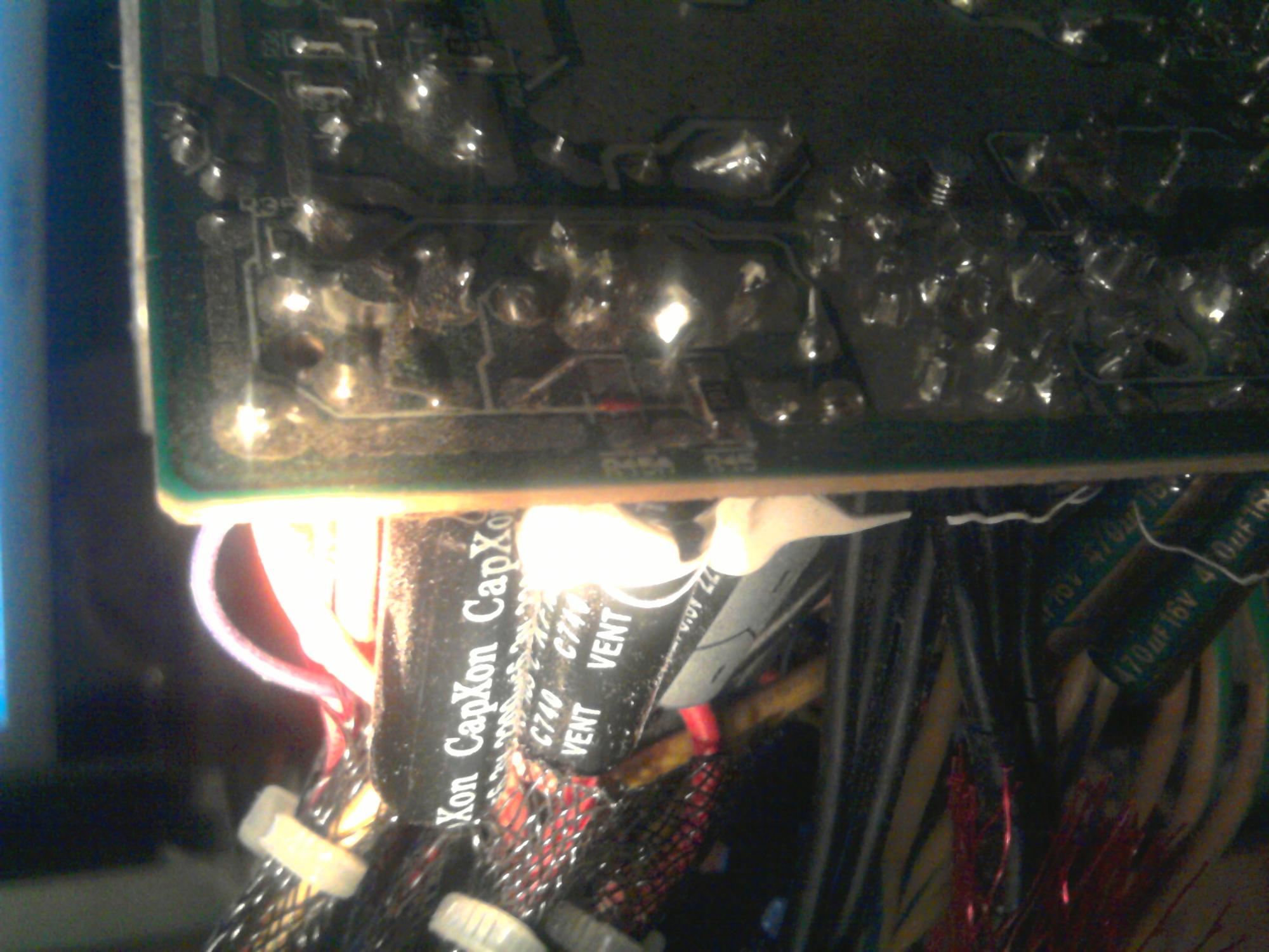

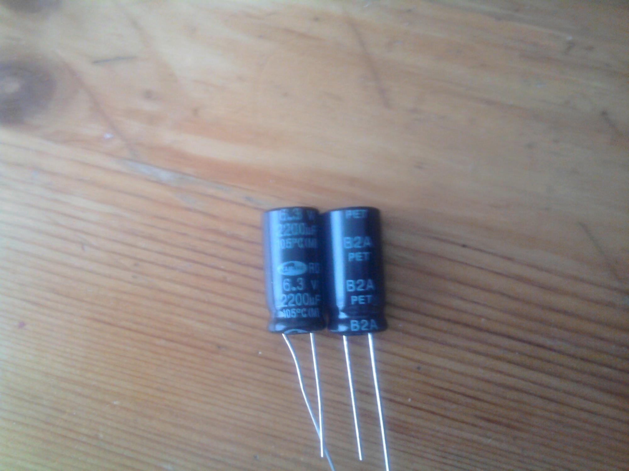

    Alright so i was using my PSU for a while with an lower power card(R5670) and ive switched to gtx 260, which obviously takes more juice. From the start i've had a problem that my PC would only start when it had cooled for like 3-4hours. I consider my current PSU good(Fortron Epsilon 80plus 500W) and it is above GTX 260 limits, ive seen guys running gtx 470,480 off it. So recently i opened my PSU to see where the problem is, i saw quite a few capacitors that were leaking(On pictures). So i ordered a few replacement caps for them. Now i have quite a few questions about it. The capacitors were 6.3V , 2200uF btw.
    Could those small capacitors cause the problem(Like 3 failed ones)? Also recently when i started without my graphics card i saw that sometimes the power fluctuates a bit and then PC shuts off. When its running it runs good and with very healthy voltages. My father is licensed electrician so replacing the caps won't be a problem. It's just that he usually works with way higher voltages and different equipment(Workbenches in factories n stuff like that). Are there any special stuff you should know about replacing caps etc?
    Sorry for all the grammar mistakes, il try to fix them by morning
    Also the leaking capacitors were all the same type, all other stuff seemed fine. And i ordered proper replacement, no need to worry about that, we have something similiar to radioshack in our country.

    The Fortron Epsilon 500w is quite capable and should have no problems powering that video card.
    You just got unlucky with the capacitor selection in the power supply... must replace both the Capxon and those with the GF label (known bad series)
    Wouldn't hurt replacing those capacitors by the heatsinks with higher hours @ 105c rated caps.
    Stores like Radioshack don't do high quality capacitors, only general purpose ones which are not good enough for a power supply.
    Since you're in Estonia, try http://ee.farnell.com/capacitors - I'm using them and their UK version of the website and it works great for me.
    Stick to quality brands like Nichicon (HM/HN/HZ), United Chemi Con, Rubycon (ZL*), Panasonic (FM/FR/ others) - if you say exactly what's written on those capacitors maybe we can give suggestions.

      Replace them with http://ee.farnell.com/nichicon/uhm0j...-3v/dp/1823798 . Spec-wise, they are overkill, but they are they only reliable 2200uF capacitor in 8mm diameter.
      Replace all capxons, bulging or not, unless you want to take your power supply apart again in the near future.

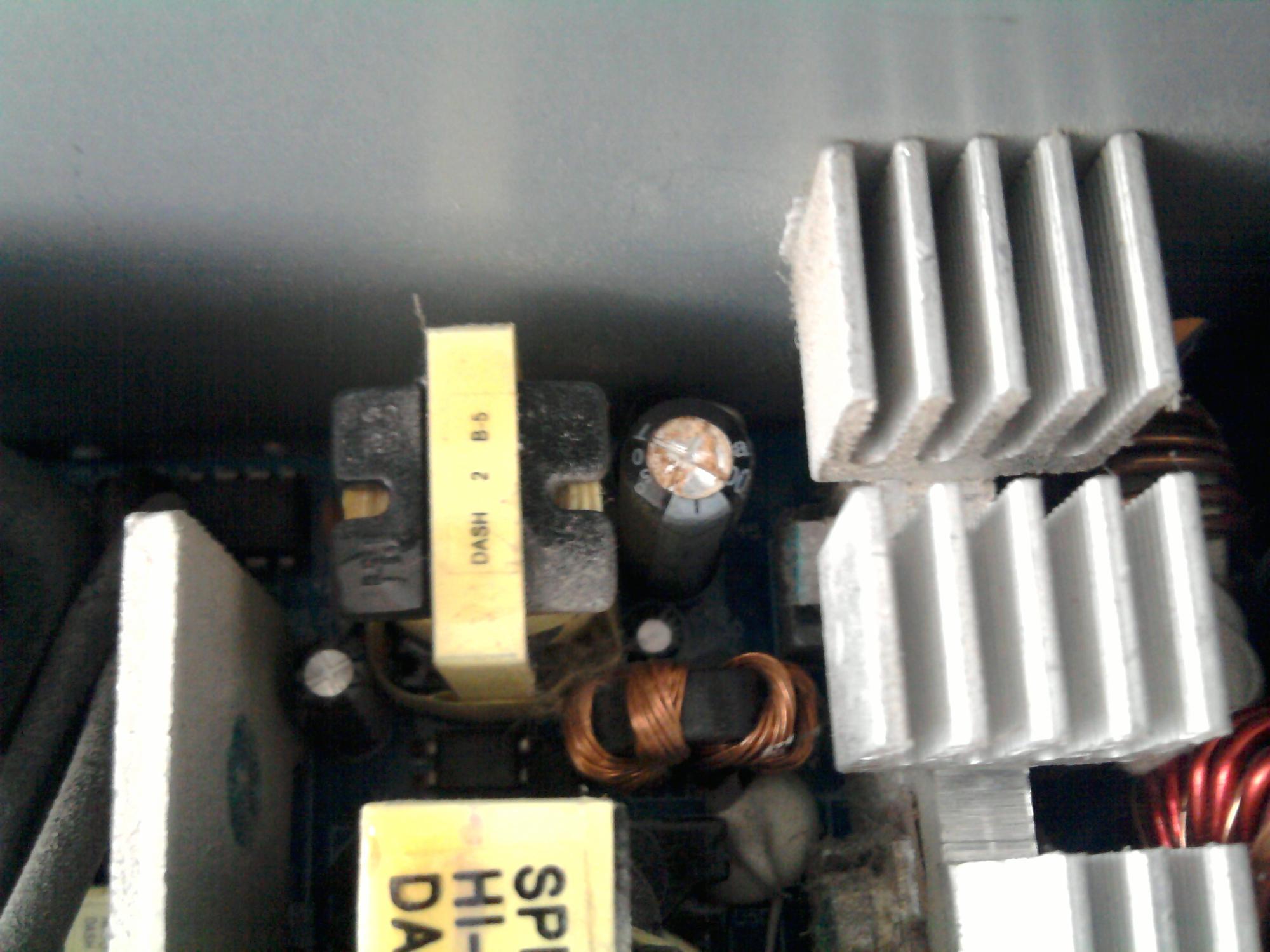

          Also, the tiny cap in the first pic to the left of the transformer ALWAYS goes bad. It's the startup cap from what I can tell. 25V 100uF
          As for the 6.3V 2200uF.. with a bit of ingenuity it is possible to shove a 10mm in there, but only one. You also have to be a bit careful when putting the cover back on then (to not scratch or dent the cap)
          Fortrons are generally good PSUs, but their constant crapcap selection in just about any halfway recent model kills them every single time..

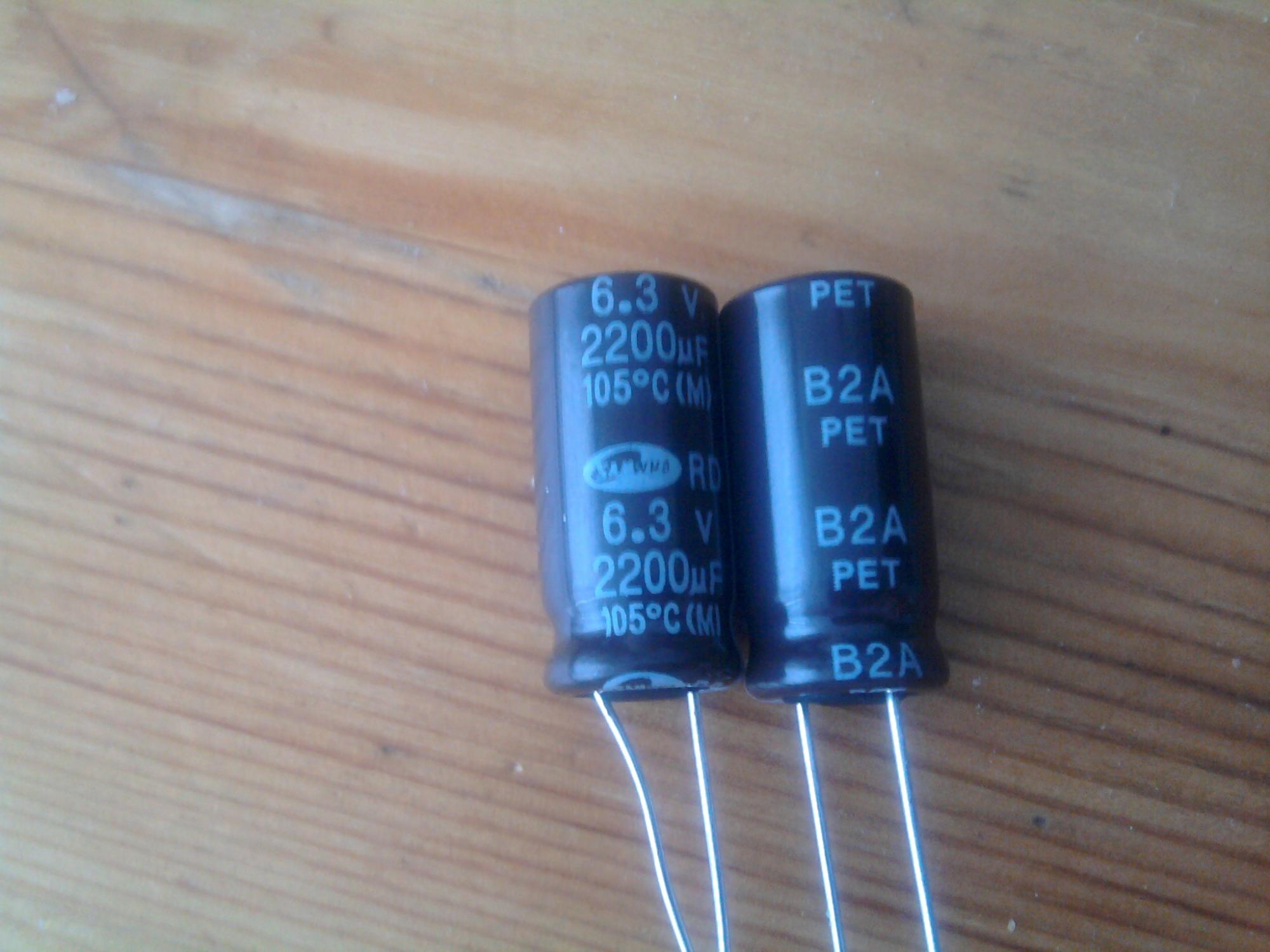

            Wow so much response in so little time, thanks a lot . I was considering replacing with quality caps too, but i didn't know which ones are good and where could i get them. Anyway im going to replace those 6.3s with the ones i got currently. After replacing im going to look for replacement for those and the GF's, also gonna replace the startup one i think.
            Also at the farnell website which caps should i look for? I notice theres bunch of caps made of different material.
            Oh and the new caps are on pics. Thanks again

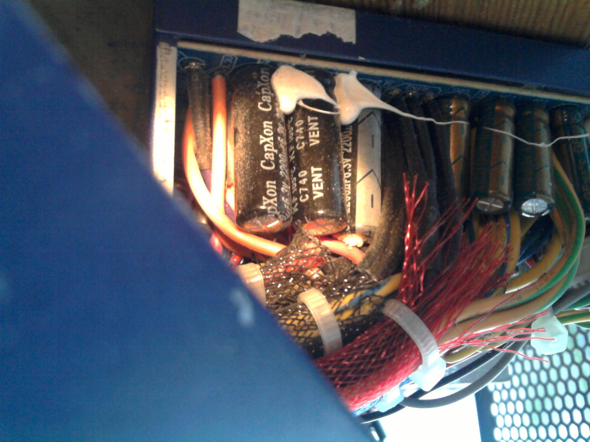

              I don't know which CapXon you show as bloated there, but they look like 10x30. The Samwha caps in the picture are General Purpose caps that are only 10x20 with a ripple rating of only 778.
              If you're going to place an order with Farnell (Here we call them Newark, other times, they're called "Element14"), you should take a good look at the Panasonic "FK" series through hole capacitors (Prefixed with EEU - the U denotes the through hole variant and not the SMDs) which you will most likely need in your repair.
              I've done 2 FSP PSUs now, and I found that the only thing that could match the custom size 10x30 parts were the Panasonic FK (Normally, caps with the same ratings as the original Teapos or OST are 12.5mm - FK are miniaturized in width and FR are miniaturized in height).
              In my opinion, you should do a complete re-cap of the whole PSU.
              Can you post more pics?
              Take those wires out of the way and post all the caps.

                        Yeah oke, the problem is that there's very few 8 mm wide capacitors with that capacity value that are also good. You'll find lots at 10mm or 12.5 mm wide, but few at 8mm.
                        That farnell website has decent shipping fees, for example it costs me about 3$ to ship from UK here, but if they don't have them in the UK warehouse, they charge you a one time 25 euro fee for the whole package. It works ok if you want a lot of stuff but doesn't work in your case.
                        When it comes to picking good capacitors, you need ones that are listed there with high ripple value and as low impedance as possible.
                        What I can suggest is to look on the back of the power supply and see if these three capacitors are interconnected, to work as a single 6600 uF capacitor.
                        If so, you can replace the 3 x 2200 with 2 x 3300uF and keep the same capacity overall, and you will have an easier time fitting 2 10x## or 2 12.5x## capacitors there.

                              So theres noway i can use the ones i bought or the ones on the motherboard for like a month or two?
                              • mariushm
                                • May 2011
                                • 3799
                                Re: PSU problems(More inside)
                                You can.
                                The ones you bought (the Samwha) are OK (good series on paper ) but diameter is large. Samwha I saw a lot in Samsung monitors and they don't seem to be very reliable (lots of swollen tops, out of specs), but it could be because in monitors they're in a very small space with minimal cooling - in a power supply with the fan blowing on them they may last a long time.
                                The ones on the motherboards are good series (good in the sense that they're low esr high ripple) but you have no way of knowing how good they still are.
                                OST capacitors degrade in quality in time but they don't usually inflate their tops or leak, so you have no way of telling visually telling how good they still work. Without an expensive ESR meter, you really don't know.
                                  Yeah. Thats what was in description: Max ripple is 2.36A.
                                  What you have there in the picture - Samwha RD - are NOT any of those things... RD is a general purpose cap, if yo don't believe me, look at the datasheet for yourself.
                                  • mariushm
                                    • May 2011
                                    • 3799
                                    You're right, I apologize oke... I got them mixed up with a RD series from another manufacturer. So those Samwha are not recommended to use them in the power supply.

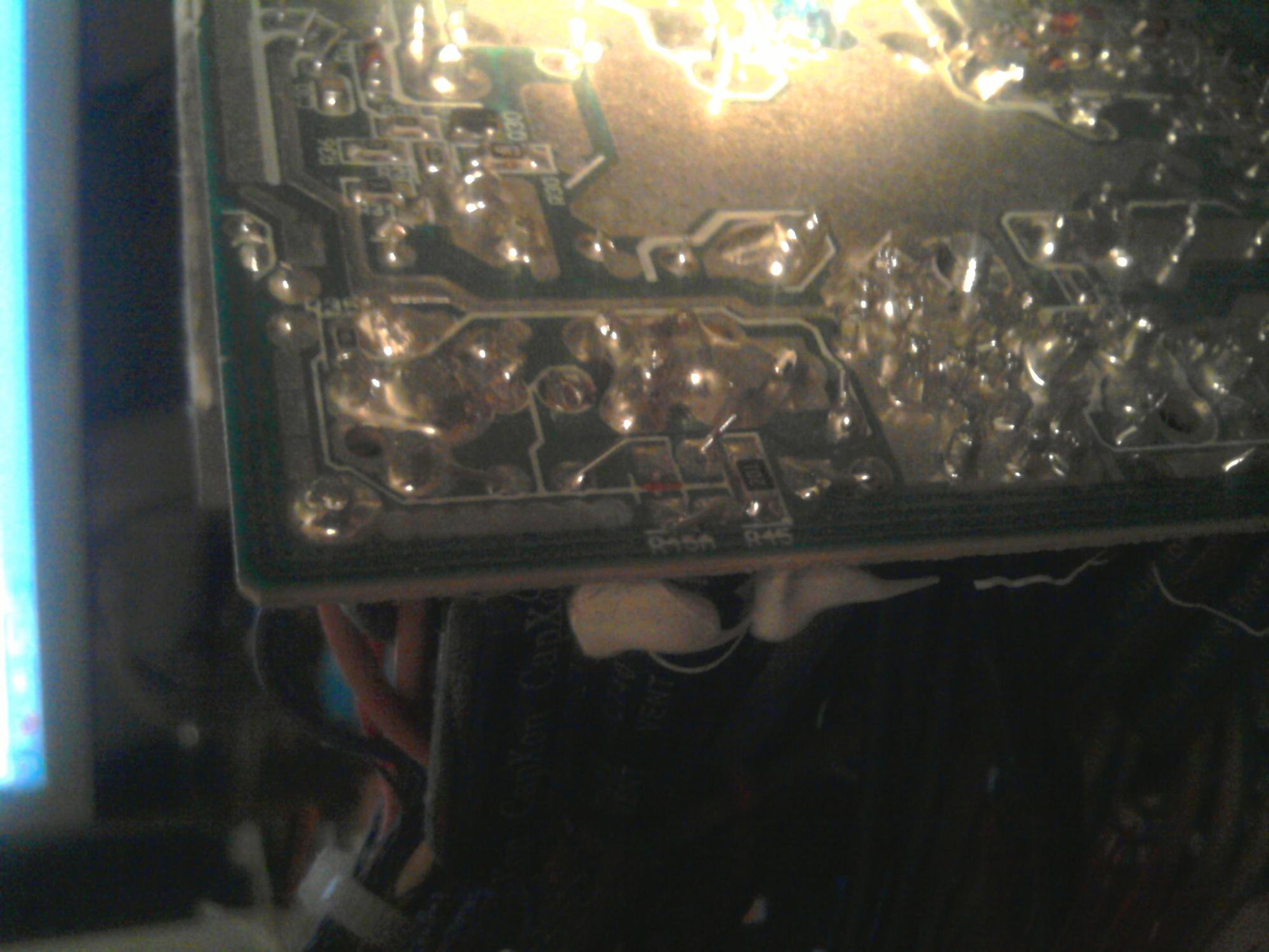

                                      No problem . Anyway i finally got that baby unscrewed and turned around. So according to the pics are the caps connected to each other or do they run seperately(Can i use two bigger caps instead?
                                      • mariushm
                                        • May 2011
                                        • 3799
                                        I can't tell from the pictures... they're too blurry and dark.
                                        If they're in parallel to get the large capacity, the + wires of each capacitor should be in contact, same with the - wires.
                                        So if you have a multimeter, switch it to continuity mode, which makes the multimeter beep when you touch the needles of the meter or you touch the ends of an uninterrupted wire. If you don't have continuity mode, switch it to measure resistance. Place one a needle on the + sign of a capacitor and the other on the other capacitor's + sign and you will get a beep or resistance measurement if they're connected.
                                        If you don't have a multimeter... it's a bit harder. Take an AA battery, a led or a light bulb , two wires... connect a wire to the led and with the other wire put it on the + sign of a capacitor and the led on the + of the other capacitors
                                        [ - ] battery [ + ] --------- [+ C1 ] ----- trace on pcb ---- [+ C2 ] ---- led +
                                        -----------------------------------------------------------------------led -
                                        If the + signs of the capacitors are not connected together, the led won't light up.
                                        In the worst case, take a sheet of paper and a pencil and draw the traces on the board between the points where the capacitors are soldered.
