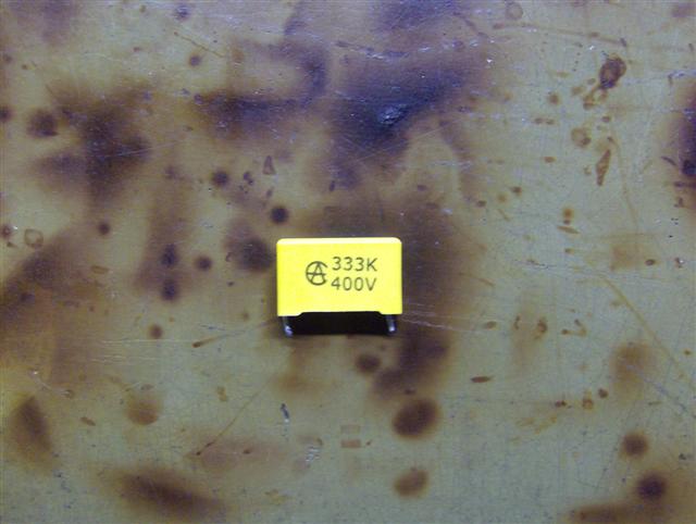

    Long time no post.
    I`ve got a bunch of these. Could not identify the manufacturer. The .33uF seems suitable to PSUs, but I could not find more information. Even if they are not a best choice, do you think they can be used without problem to improve some gutless psus a little ?
    Thanks.

    I believe that is a .033uF, 400VDC film capacitor. Maybe Arcotronics? Any markings on the top or other side? I would NOT use this as an X capacitor, even ignoring its low capacitance value!
    Safety capacitors - X type and Y type - tend to be covered with the logos of the various safety agencies that approved the part. This cap had none, on the side in the pic, anyway.

        No other markings, just that side.
