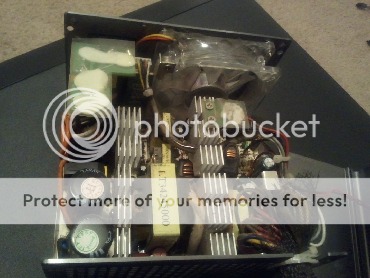

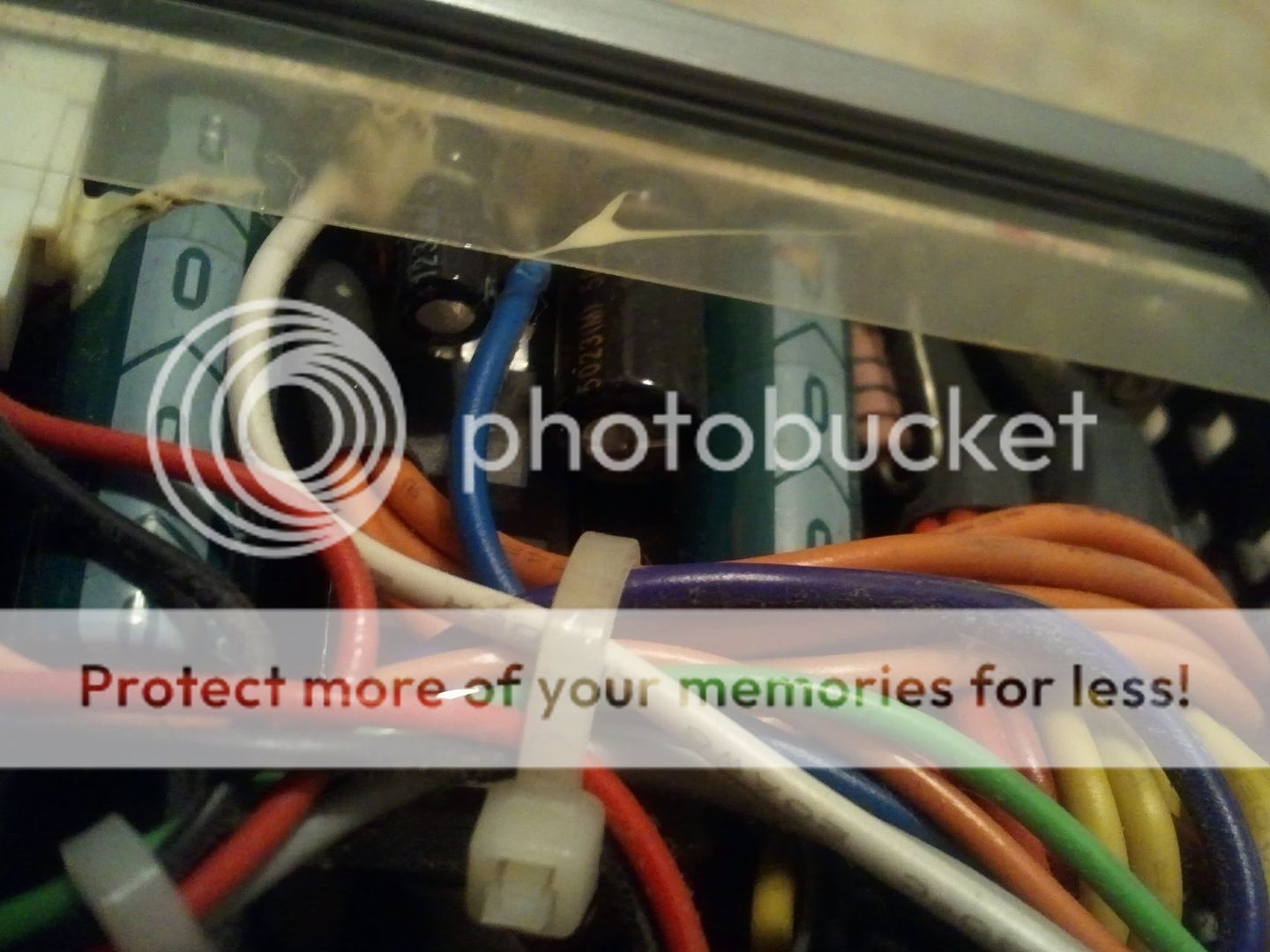

Msi al-b500e 500w psu
  • Sparky
    High voltage
    • Jan 2007
    • 234
    Msi al-b500e 500w psu
    MSI AL-B500E PSU... is it any good? Hmm.
    Did a search of the model number, came up with this newegg link:
    http://www.newegg.com/Product/Produc...82E16817154015
    Apex/Allied, huh? Not reassuring. And to think this unit was in a server? And what is MSI doing rebranding an ALLIED unit of all things? Shame on them.
    Weird thing is this unit that I have actually has PCIe connectors, while the original doesn't. Two, in fact. 20A on the 12V rail seems pretty low to put two PCIe plugs on a PSU however. And 52A on the 5V rail? Sounds like an older design unit that's been "upgraded" with newer plugs. However I should mention that the two PCIe plugs on this are both missing the center 12V wire, so each one only has two instead of three 12V feeds. Nice...
    The guts surprised me. I was expecting much worse and bunches of empty spaces on the PCB like most other Allied units I've opened up. This one it appears they actually decided to put a few more components in.
    Weird vents, I haven't seen those before. No bulges visible on those.
    Those caps with the odd caps are Koshin. Good? Bad? Mediocre? I didn't find much on these when I searched them on here, except that they have the same vent type as Elna caps. But, given that they are in an Allied PSU, I suspect they are mediocre at best.
    Also some smaller caps have the basic + vent design. No name, just a planet looking symbol, like Saturn or something. Those were iffy, this one here is swollen a little bit.
    And the right one in this pic is slightly puffed too, though you can't see it in the pic.
    So I was thinking of maybe recapping this originally as the innards at least appeared to be halfway decent at first glance, but after checking it out more I think this one is destined for the scrap heap (despite being pretty looking with its snazzy case, hmm maybe I should swap some good guts into it!). That is unless someone can give me a good reason to not dump it. Heh, I wonder what would happen if I tried to have it power an 8800 Ultra
    In case you're wondering as to the purpose of this thread... well, there really isn't much of one. It started out as a "is it worth recapping thread" but as I looked at it more I figured nope, it isn't, but I'd post the thread anyway
  • c_hegge
    • Sep 2009
    • 5219
    Re: Msi al-b500e 500w psu
    I'd recap it. Koshin are just as bad as, if not worse than Fuhjyyu. The rest of the guts actually look OK
    • Sparky
      High voltage
      • Jan 2007
      • 234
      Re: Msi al-b500e 500w psu
      If they are that bad I'm surprised none are bulged and/or leaky. Although what may have helped was while it was in a server (running a Pentium D) the fan control knob on it was cranked to maximum, so there was decent airflow through there. Probably the only thing that kept it from popping more caps then.
      • Scenic
        o.O
        • Sep 2007
        • 2642
        Re: Msi al-b500e 500w psu
        Originally posted by Sparky
        Weird thing is this unit that I have actually has PCIe connectors, while the original doesn't.
        Are you sure those are PCIe plugs and not some server-style 12V plugs for multi CPU setups or something?!
        I've seen some really weird configurations on those more-than-4pin 12V plugs. Some looked like PCIe plugs, but didn't actually fit into a dummy PCIe card (fried 7800GT), some did fit, but had the 12V and GND swapped around compared to one of those 5.25" molex to PCIe adapters..
        The latter could possibly end in a rather expensive *oops* situation
        • Sparky
          High voltage
          • Jan 2007
          • 234
          Re: Msi al-b500e 500w psu
          Yep tested it. Wires are in the right spots (except for that missing center 12V wire), keys are correct and fit a video card fine.
          • b700029
            Banned
            • Sep 2010
            • 640
            Re: Msi al-b500e 500w psu
            2000uF of primary reservoir, what looks like a complete input filter, non-flimsy heatsinks, and a good size transformer.
            It's probably good for ~400W at least, I say it's worth recapping.
            • Th3_uN1Qu3
              Believe in
              • Jul 2010
              • 6031
              • Romania
              Re: Msi al-b500e 500w psu
              Agreed, it's worth a recap.
              A working TV? How boring!
              • Sparky
                High voltage
                • Jan 2007
                • 234
                Re: Msi al-b500e 500w psu
                OK I'll recap it. I just won't try to power Bloomfield with a GTX580 with it
                  master hoarder
                  • May 2008
                  • 12170
                  • Bulgaria
                  Re: Msi al-b500e 500w psu
                  If the PSU has a 2-transistor self-oscillating 5vsb circuit, look for the "5vsb critical cap". It's usually a small 10, 22 or 47 uF cap on the primary side, close to the 5vsb transformer. It's very important to replace it (otherwise you can get severe over voltage on the 5vsb rail if that cap fails)!
                  How to check if the 5vsb is 2-transistor design: there will be 2 transistors on the primary side of the 5vsb circuit (main and driver). The main transistor is usually a TO-220 part attached to the primary heatsink while the driver is normally a TO-92 part (i.e. small).
                  • Th3_uN1Qu3
                    Believe in
                    • Jul 2010
                    • 6031
                    • Romania
                    Re: Msi al-b500e 500w psu
                    Agreed, definitely replace that cap too, and throw a 1W 5v1 zener on the 5vsb rail to make sure the voltage never goes past that even if the caps fail.
                    A working TV? How boring!
                      master hoarder
                      • May 2008
                      • 12170
                      • Bulgaria
                      Re: Msi al-b500e 500w psu
                      5.1V zener is a bit too close. Some 5vsb circuits like to run around 5.10 to 5.15V. ATX spec says 5vsb can be +/- 5%, so that means 5vsb is allowed to be anywhere between 4.75V to 5.25V. 5.2V or 5.3V zener would be better.
                      • Th3_uN1Qu3
                        Believe in
                        • Jul 2010
                        • 6031
                        • Romania
                        Re: Msi al-b500e 500w psu
                        It just so happens that 5v1 is more common here. And it won't eat much power anyway, unless the 5vsb rail climbs significantly higher than 5v1, which it shouldn't. Worst thing that could happen is it'll dissipate an extra half watt, and only when there's nothing else on the 5vsb like no front USB ports or such things - not much to talk about.
                        A working TV? How boring!
