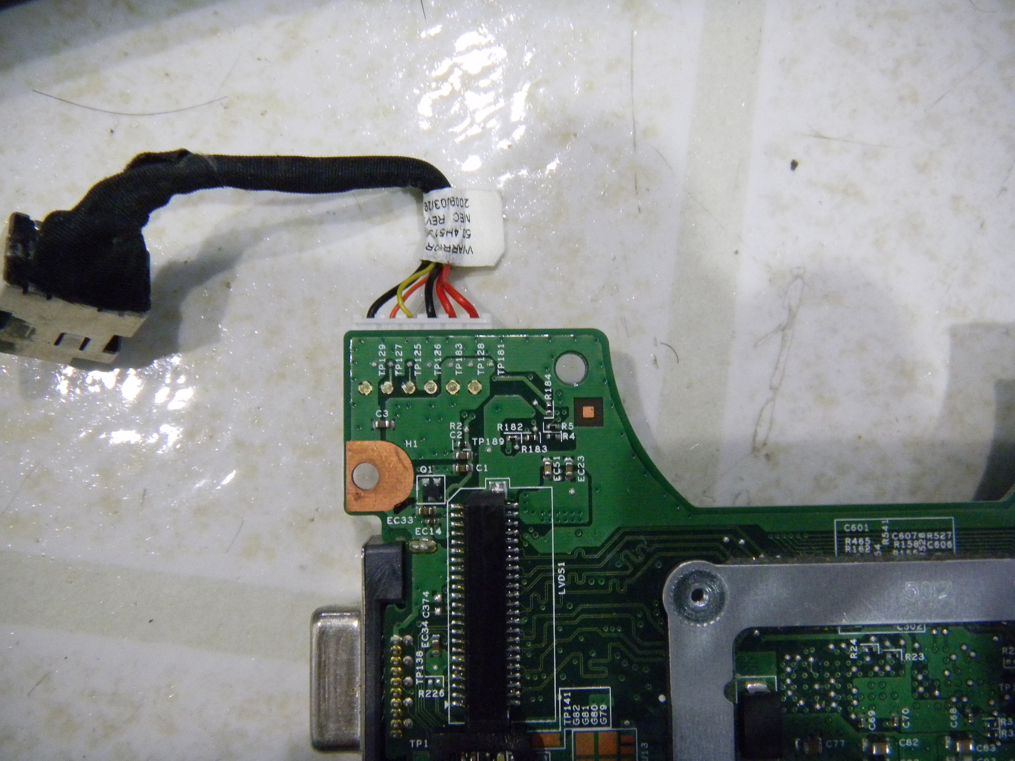

    Hp g60 won't power on or charge
    Hp G60 won't power on or charge, I've tested the psu and it checks out fine.
  • Lobo
    • May 2010
    • 59
    Re: Hp g60 won't power on or charge
    I've seen a few HP's recently with the same problem. It's the DC in jack, and/or an SMD on the mobo. Twice I've found a blown capacitor next to where the battery plugs onto the mobo.
