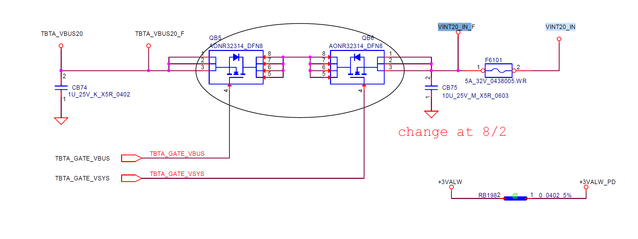

                  Check the DCin mosfets. 20V is very good and this implies the power delivery negotiations have succeeded. However, this is not the voltage that is reaching the charger IC so there is a fault in this power path.
                  Check the voltage to ground on mosfet QB5.
                  Check each pin and post the measurements.

                    QB5:
                    Pin 1 - 20.6
                    Pin 2 - 20.6
                    Pin 3 - 20.6
                    Pin 4 - 19.59
                    Pin 5 - 19.61
                    Pin 6 - 19.63
                    Pin 7 - 19.63
                    Pin 8 - 19.63
                    • mon2

                      I think this mosfet is leaking. Check the resistance across the pins with no power. Or just replace it to test.
                      At this gate voltage, the mosfet should be off. The internal steering diode may be the reason for the pass through voltage but the gate voltage should not be the same value.

                        Meter said to auto-scale:
                        Red probe on Source (PIN 1,2,3) to black probe Drain (Pin 5,6,7,8) = 3.6 Mega Ohms and dropping
                        Red probe on Source (PIN 1,2,3) to black probe Gate (Pin 4) = 3.94 Mega Ohms
                        Red probe on Drain (Pin 5,6,7,8) to black probe Gate (Pin 4) = O.L

                          This mosfet is AONR32314.

                            Hey! Thanks for the help mon2! I went ahead and replaced AON32314 with AON7430 because it's what I had on hand and their specs are so close (but Drain-Source and Gate-Source Voltage are identical with same pinout) and sure enough, it fixed it. Board powers on and charges battery normally now. Awesome!
                            Thank you so much. Marked your comment as answer.
                            Should I purchase a new AON32314 or should I be ok with leaving AON7430 on?
                            Thanks again!
                            • mon2
                              • Dec 2019
                              • 14712
                              Awesome! Very nice to hear some good news once in a while Your replacement mosfet is fine. The difference in the peak currents is miniscule. If you are shopping for new parts, consider to review the mosfets from Texas Instruments from Digikey / Mouser / TI.com website. The TI.com website will often just send you free samples with overnight delivery. Usually the parts are filled by Digikey or Mouser - just a FYI.
