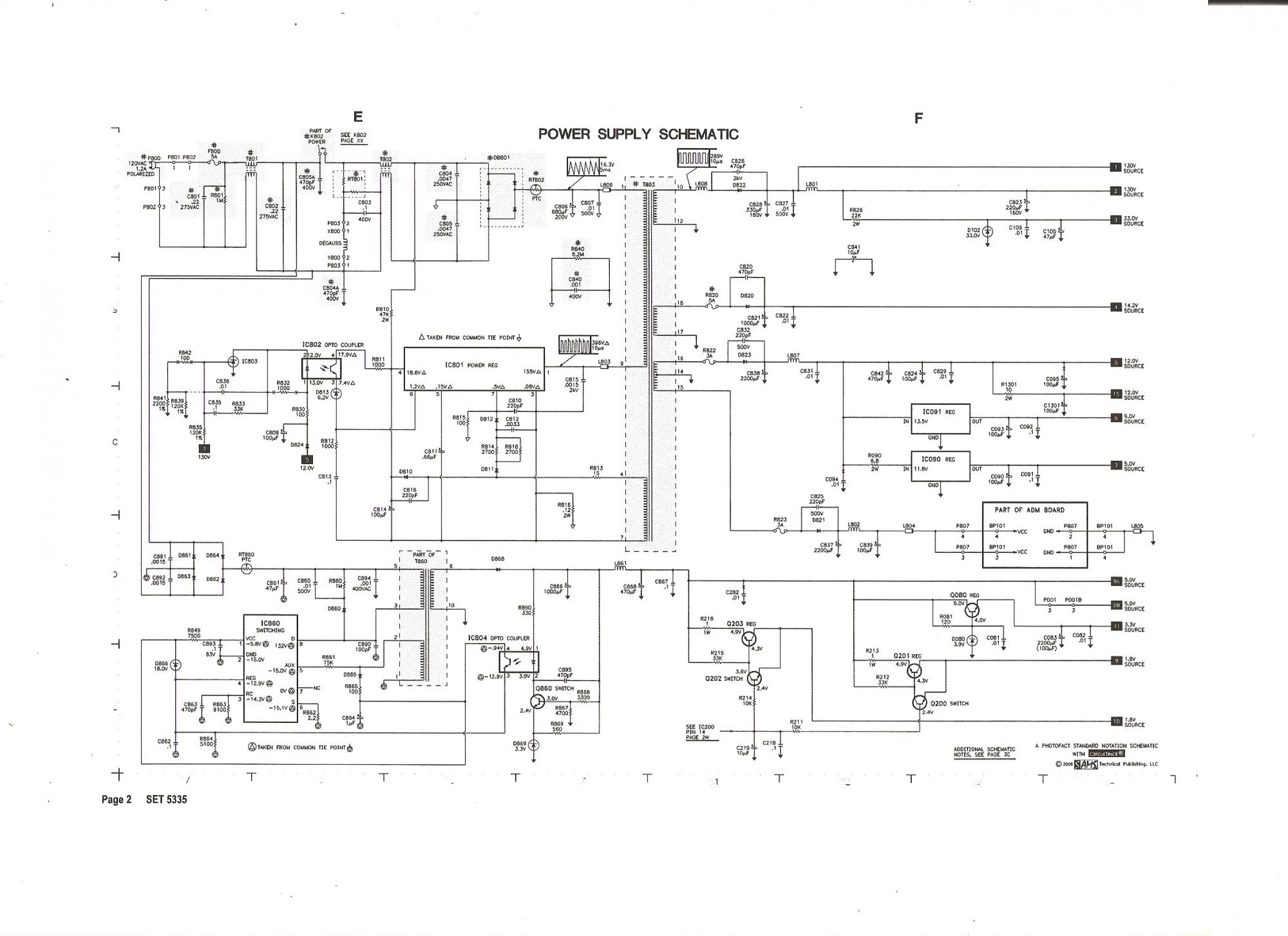

            That thermistor is a PTC type so it *may* be used to limit voltage... Are you sure you're using the right ground for measuring? I've heard of high standby rails but that's out of the norm by too much.
            Are the other rails good that come from the same transformer? If they're also very high there's probably something wrong with the opto IC804 or the transistor driving it.

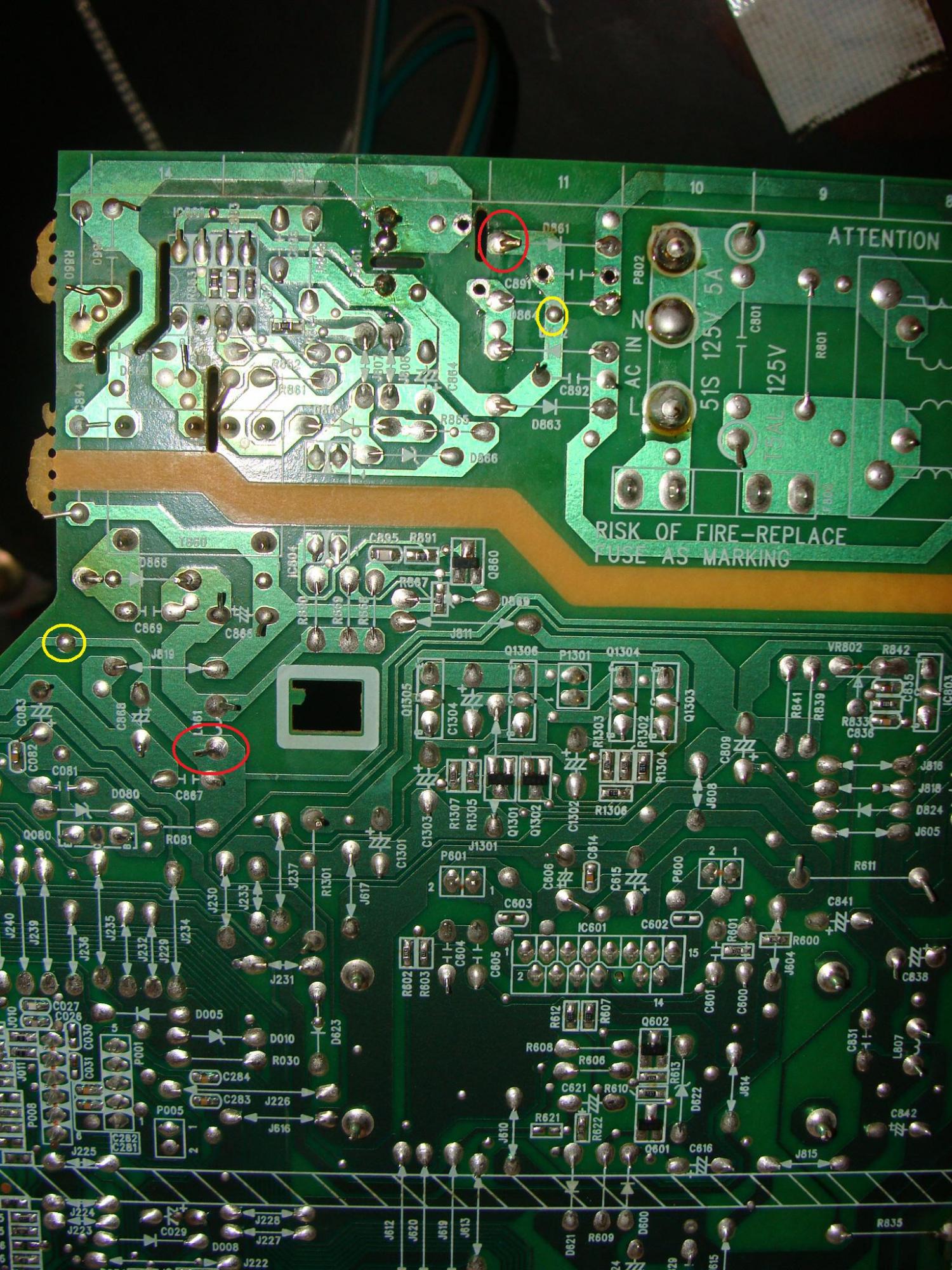

              Photo #1:
              I used the "RED" circled points (photo #1) to measure the 5VDC on the main board. Guess I should have used the "YELLOW" circled points to prevent a probe short.

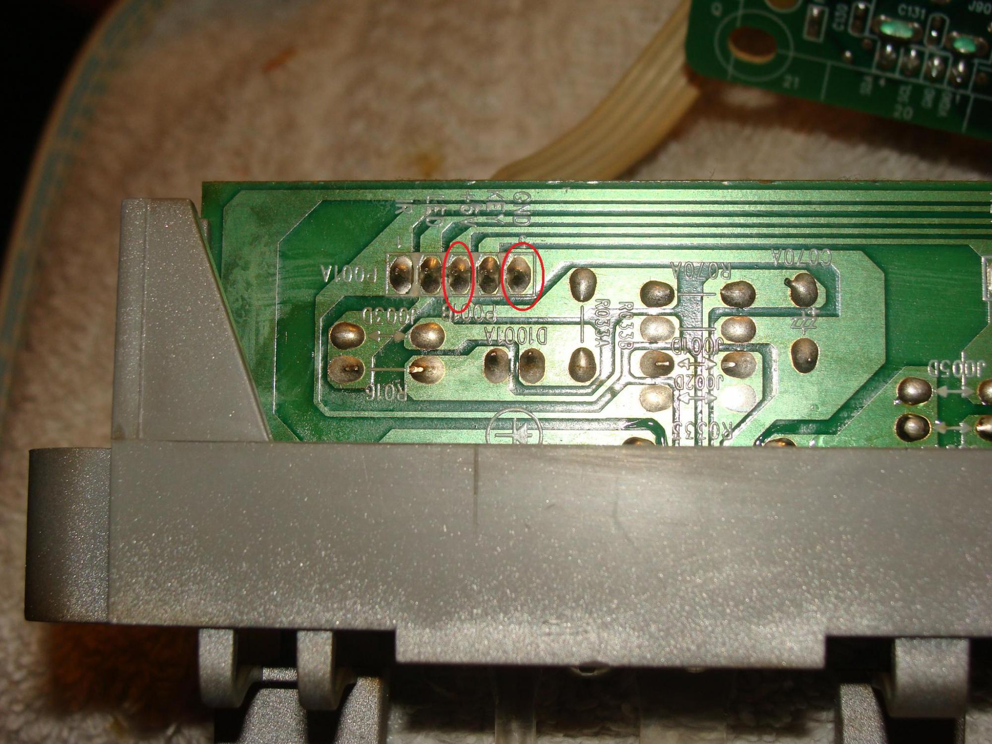

              Photo #2:
              I used the "RED" circled points (photo #2) to measure the 5VDC on the Controlboard.
              I was retest the 5VDC, with anaolog meter, when I caused a probe short. RT860 PTC could have just finally failed on it own, but I don't think so.
              I did remove RT860 and it measures 5.5 Ohms. It also has a chunk if it's encasement blown off.
              I didn't get other voltages. Hopefully when I replace RT860 it won't blow fuse, when power is applied, and I can get the other voltage readings.
