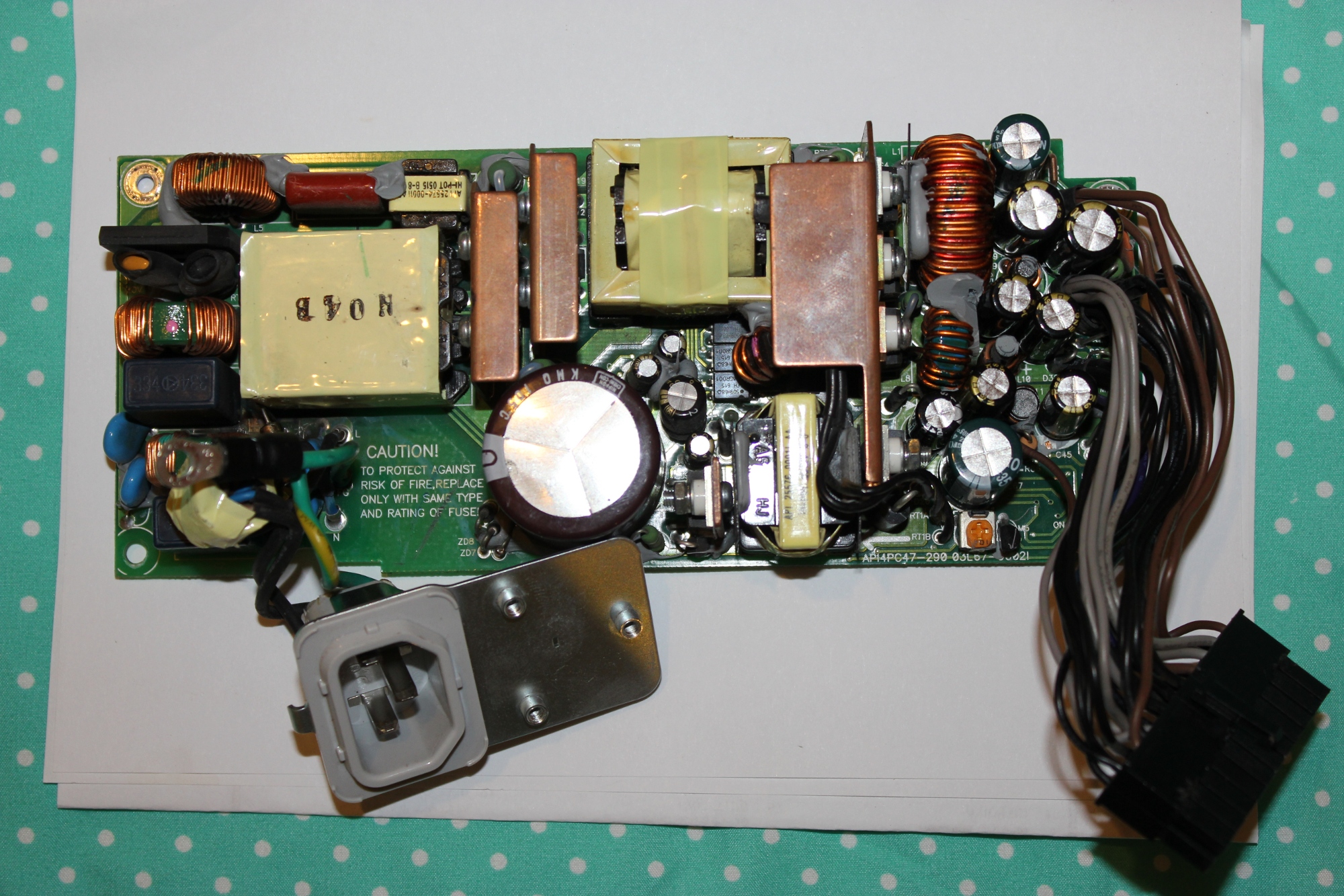

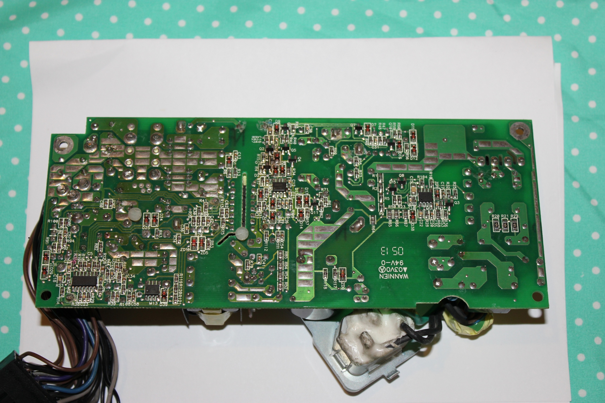

        Apple P/N for my PSU is: 614-0365
        Board: API4PC47
        Ive attached pictures of the board on both sides.

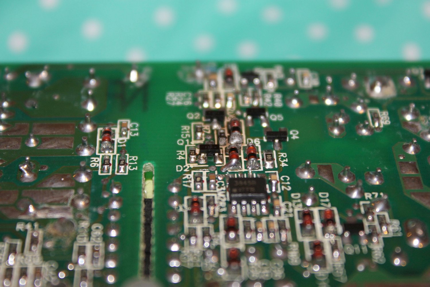

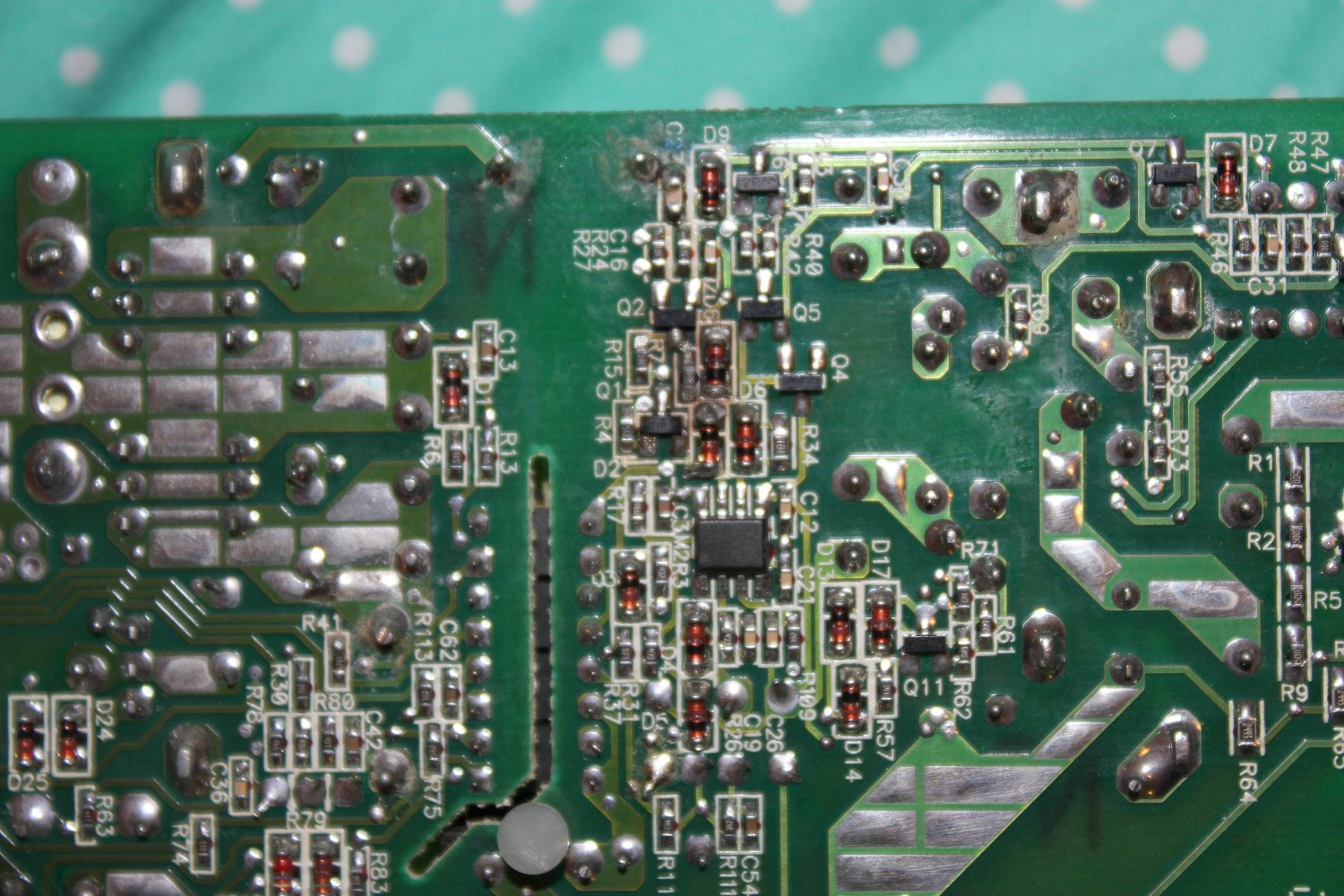

        on one of your previous posts i have read about the problem with the Q1. but after checking all the "little black bars" as i call them. havent found any that were hazed, burned or any such thing.
        although looking at it now Q1 does seem a little off color, but nothing as bad as the picture youv'e attached. I'll add a picture of mine, but it doesnt look so good with the image quality.
        I've tested resistance on q1 between all three legs and im getting 5k,2k and 3k. so no infinite resistance, which im guessing is good.
        If Q1 is infact damaged, will this explain the difficulty in starting up the psu?

          Yes, Q1 is definitely damaged. 2N2222A is the base number. There are variations of that depending on the manufacturer.
          Also, recap that startup section. It's only 4 small caps and will save headaches later on.
          >>Ive attached pictures of the board on both sides.<<
          I'm only seeing one side, and not the full board. You can back off a bit. A a photo like #1 is well done, but get the whole board end-to-end. It's for locating components and giving directions so I have a visual of the board in my head when helping you.
          I uploaded your photos to the forums after I resized them a bit. Attached.
          The problem with using outside image hosting sites is, if the site goes away or you leave them, the pictures disappear also. Uploading to the forums preserves them for future users and troubleshooting.
