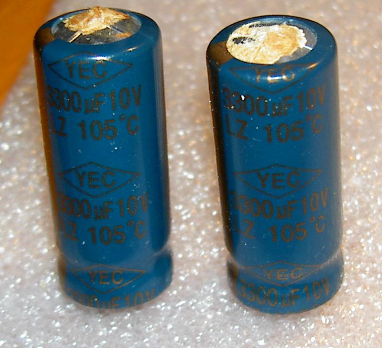

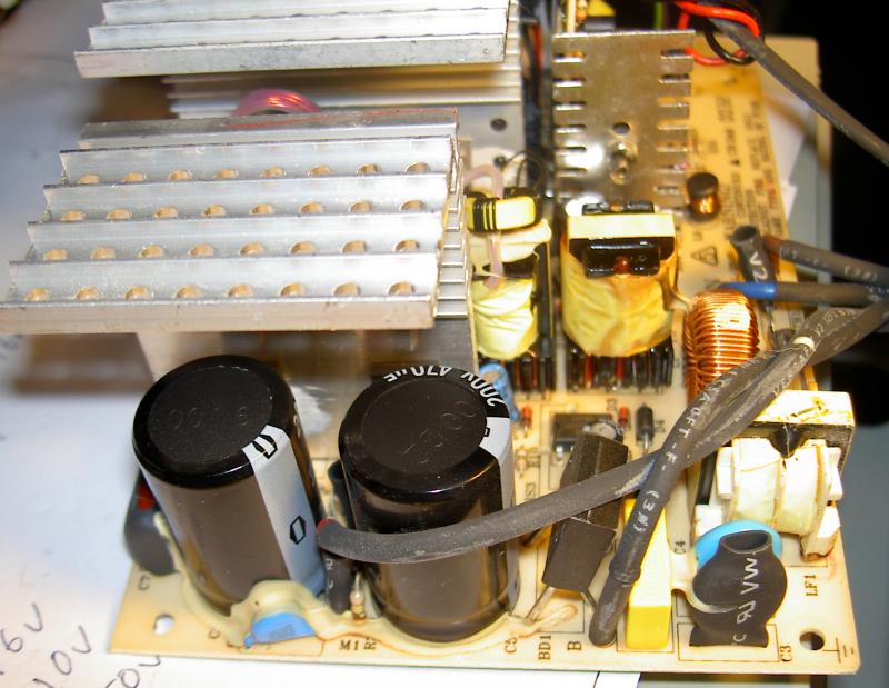

    Got a guy in with a comp, would poweroff after a while, took a look inside the PSU, two leaking YEC caps, one on 3.3v the other on 5v. So I replaced them with a pair of Sanyo MV-WX caps of the same rating, problem still the same...
    Hooked up a multimeter to the 3.3v line, it's fluctuating wildly between 3.7-3.9v if I load the PSU a bit...

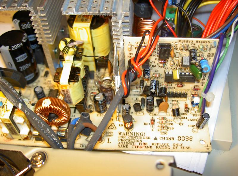

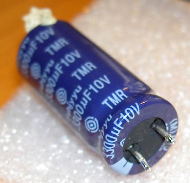

    So I poked around the board a bit with the multimeter and found another cap connected to 3.3v, a Fuhjyyu, though it was not bulging... I desoldered it and took it apart, it was all moisty and gooey and nice with electrolyte, and the positive and negative leads where also connected nicley to it...
    There are now two caps remaining on the secondary side, one 2200uF 16v Fuhjyyu for the 12v line and one 3300uF 10v cap for the 5v line, though both 5v and 12v are rock solid according to my multimeter so I've diagnosed those caps as fine (also seeing as the other Fuhjyyu cap seemed to be ok...)
    So my question now is what could possibly be wrong? I tried powering up the PSU without the Fuhjyyu 3.3v cap and it behaved the same as before, no worse nor any better... It also behaves a bit strange when I flip it's powerswitch, (off) it pulses out current to the computer, making it flash it's standby power led...
    I'd like to fix this PSU because I think the design is pretty good... It's rated for 235w and I'm pretty sure it can deliver that and then some more...

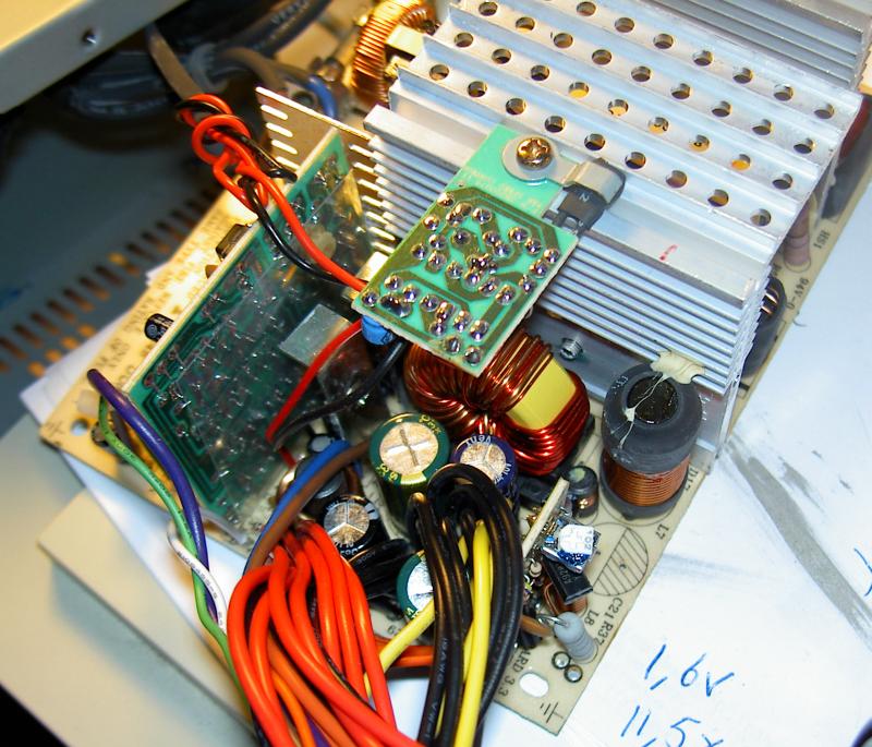

    A little simplistic, but have you verified whether the Vsense wire from the ATX connector is viable and properly attached at both ends?
    I had a Fortron ATX300-GT (I have a few kicking around, they're cheap and can be quite useful) with an out-of-range 3.3vdc line (around 3.75 I believe), the PSU immediately shutting down if it was tipped or shaken. The problem in this case was the 3.3 Vsense wire, which had come loose from its solder point on the PCB and was now barely scraping its surface.
    Apparently increasing resistance at this junction would cause the 3.3v to rise (ultimately going way out of spec), while disconnection would shut down the unit.

      Thank you so much tiresias, I would never have thought of that... In the second pic you can see the small PCB that controls 3.3v... Vsense goes into it, I saw that the soldering joint was not so good so I resoldered it and then tuned the potentiometer so I got 3.33v with my test mobo...
      Voltages where stable...
      So I fired it up on a very high end machine for that 235w PSU, a KT7A mobo with a 1.4ghz Athlon and a 9800Pro, started Rthdribl and the voltages are at 3.43v, just fluctuating +0.02v!
      Again, thank you allot! (And FYI I replaced the Fuhjyyu 3300uF 10v cap with a TEAPO I took of an old Epox 8KHA+ mobo, rated for just 2200uF but that does not seem to be a problem... Of course I will buy good caps for this nice PSU in my next order with Elfa...)

        The PCB soldering joints for those Vsense wires can be a little weak at times - I guess it's a consequence of both of the tiny wire gauge Fortron uses and the, at times, relatively loose cable ties/grommeting - which increases the risk of the wire getting "pulled".
        Now, following the "Vsense incident", I always make sure that I open up any newly-acquired PSU and give its output wires a full treatment with tightly-pulled, large, black, scary cable ties before and after the grommet.

            Good call tiresias! The +3.3V is usually post-regulated with a mag-amp. It's a little circuit that gives a special inductor a little reverse charge during the main switch off time. Then when the main switch turns on, in the +3.3V circuit, the first part of the on time is blocked from the O/P circuit as it overcomes the reverse charge of the inductor. The mag-amp circuit controls how much of the main switch on time is blocked so as to achieve regulation.
