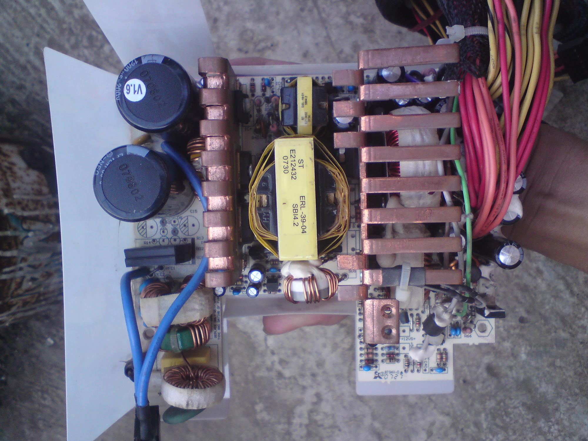

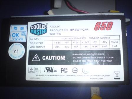

    hi all..greetings
    I have problem in last a week ..
    my recent psu doesnt start normaly in 24pin 8pin motherboard
    when plugged into the 24pin 8ppin motherboard .. .. psu does not turn on, but standby light is on ... if i push the power button theres no reaction ,still in standby condition..
    but if i plugs into the 20pin and 4pin motherboard .. the psu run normal ..all the voltages (+12v, +5v , +5vsb.etc) within the limits of 5% tolerance ..
    btw..this is not apfc psu ..still have switch for changing 100 /220 (passive pfc, of course) ..
    i live in indonesia ..so i use 220v ( i already checked the apfc switch)
    any suggestions and solutions?
    done for inspecting :
    1. the caps full of capxon
    2. the secondary caps seem bulged ( just few of them)
    3. powering psu with jumpering ps-on and ground ( green+black ) and 2 dvd rom for load..psu turn on normally ..voltage still within limit of 5% tolerance (checked with DMM)
    thanks for help ..
    ps:sorry for my bad english ..

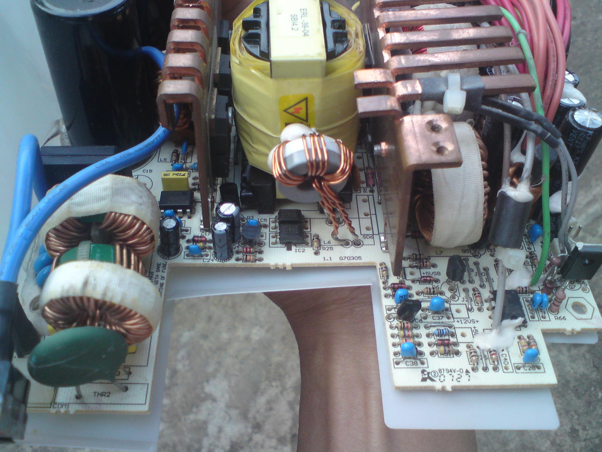

      recent motherboard are asus p5e x38 ..normal board powering with zeus 850w ST85ZF
      lately ..i get this psu (cm rs 650 pcar) from friend. .
      and when powering with cm rs-650-pcar ..it wont start, just standby..
      other mobo is ..abit nf7
      ...will start normally with CM rs-650-pcar plugged in with 20pin 4pin (plus 6pin power for agp gpu)

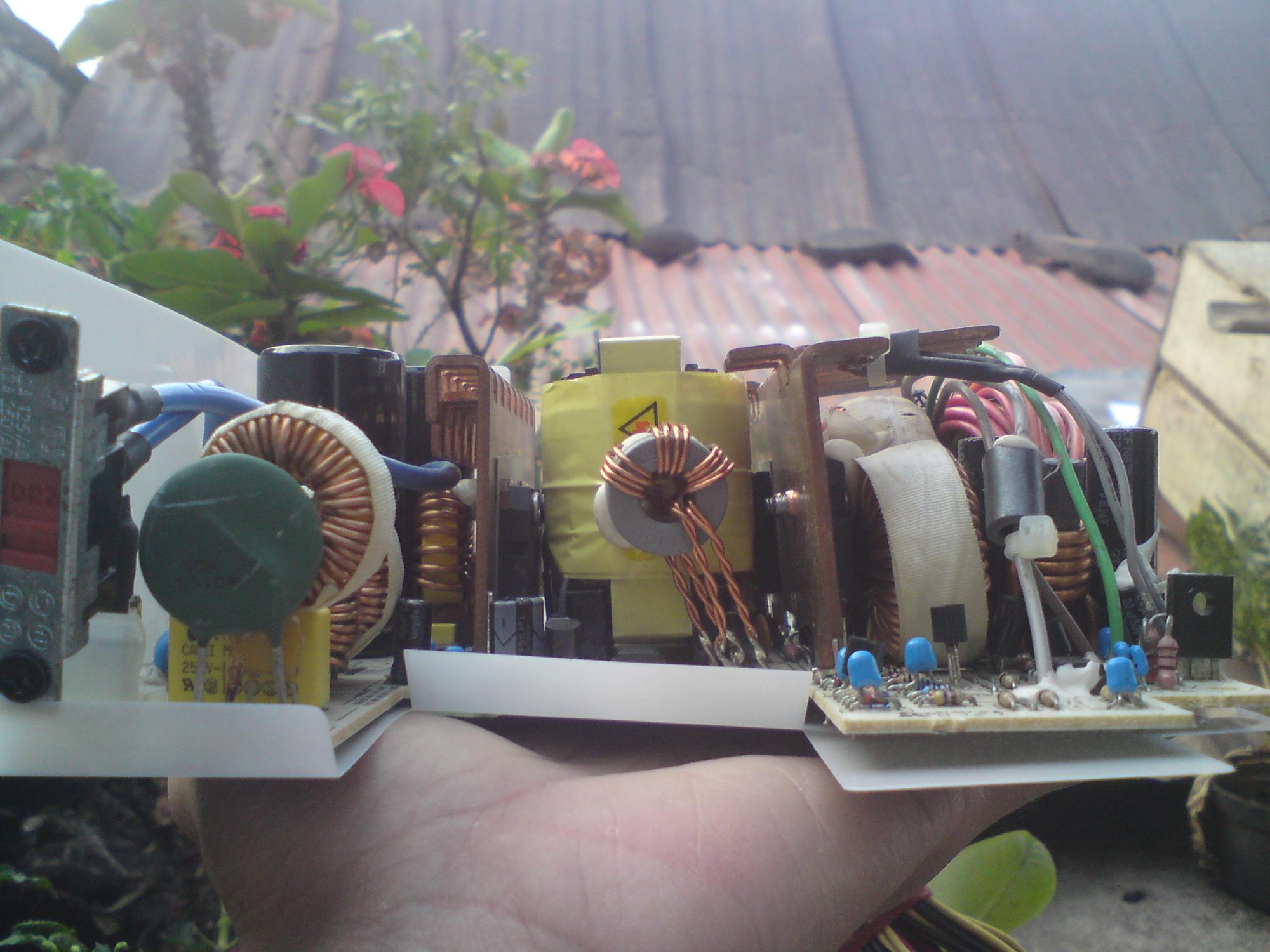

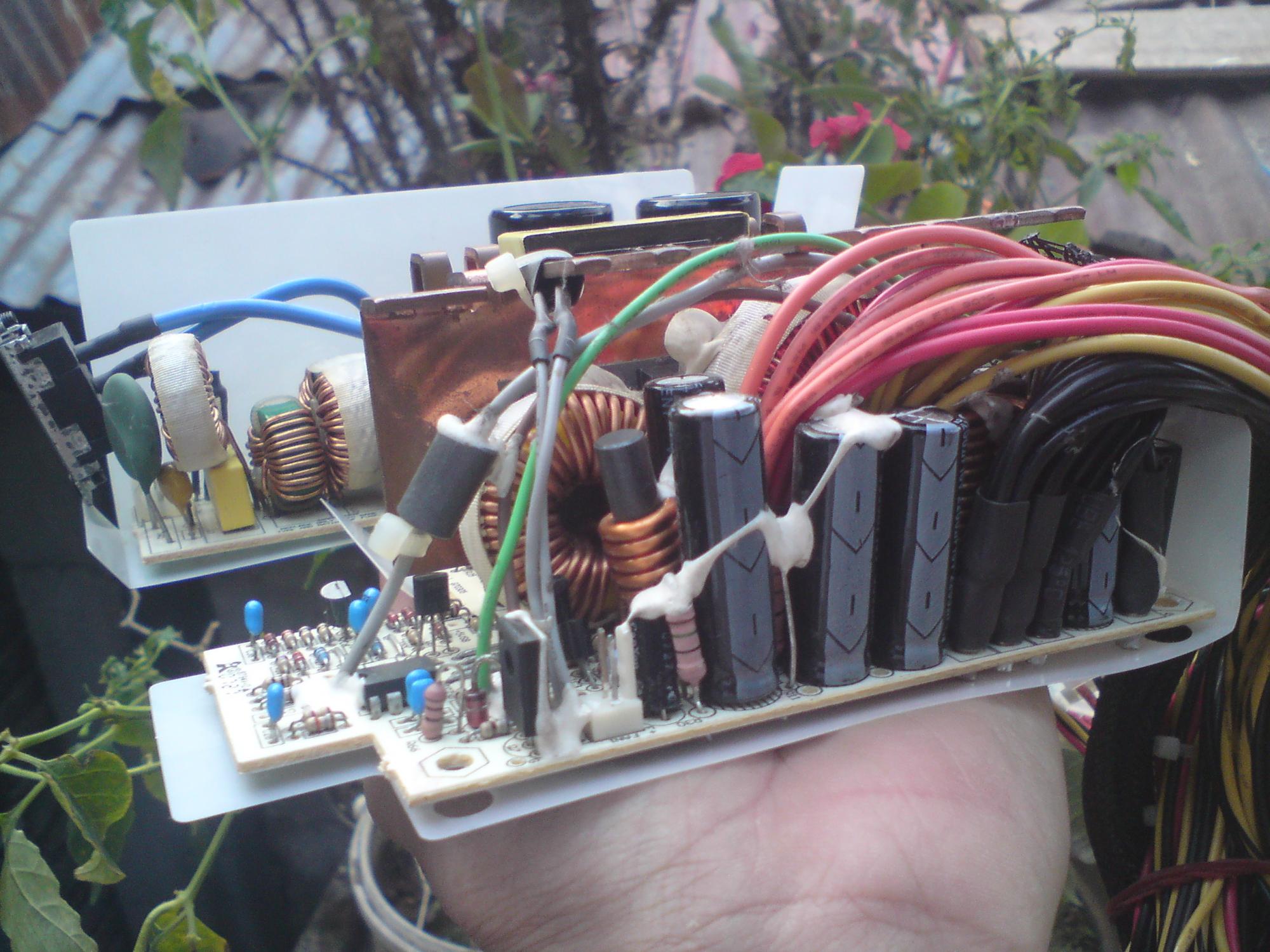

      here's some internal pic ..

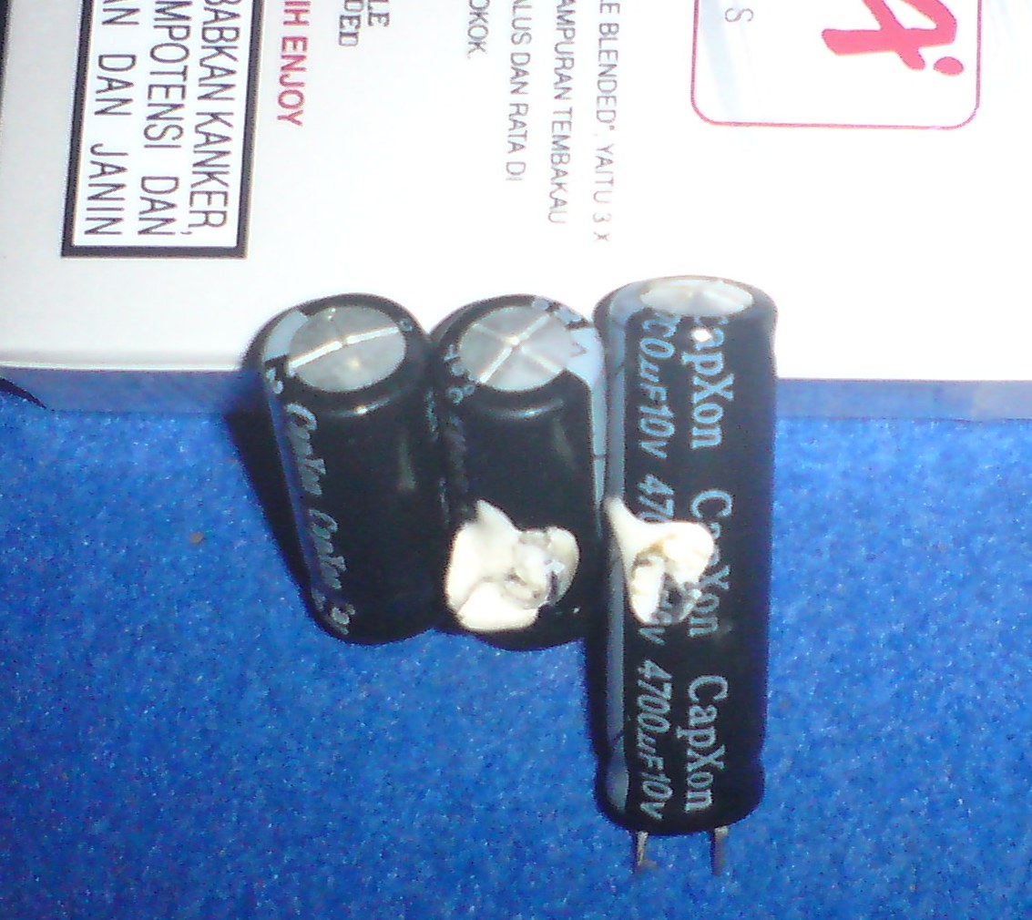

        I see at least three defective Capxcom KM an Kf series output filtering caps plain asw day. That PSU needs a full capacitor replacement.
          @Evil Lurker ...you're correct
          2 capxon KM 2200uf 10v
          1 capxon KF 4700uf 10v
          btw..do i have to full recap all the caps ?? or just partial that looks bulged ??
          what rating for replacement ?? bigger capacitance ?? bigger volt ??
          here's the pic of 3 bulging capxon caps ..

            Replace all the capxons on the secondary side. The others probably aren't far off failing.

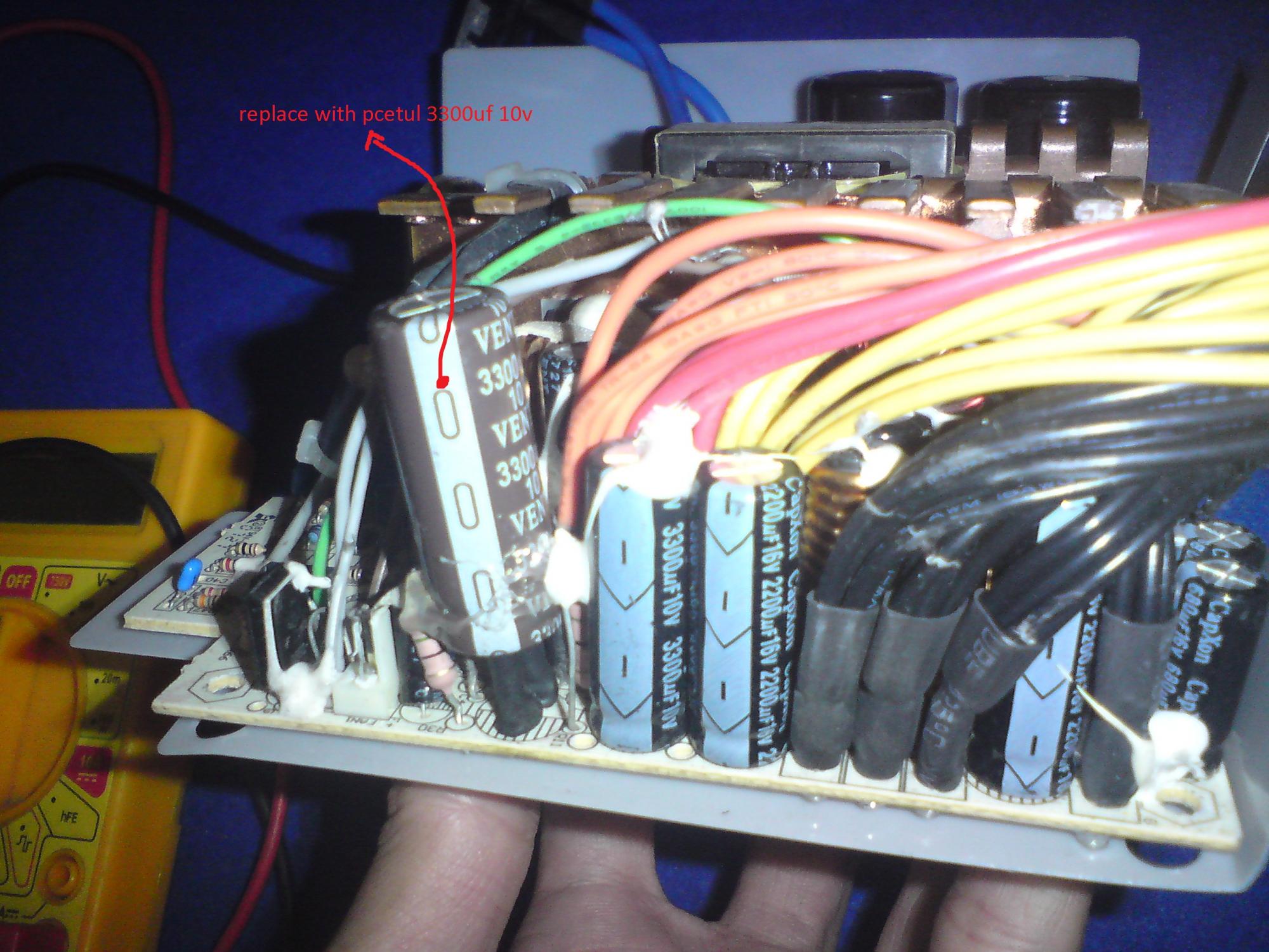

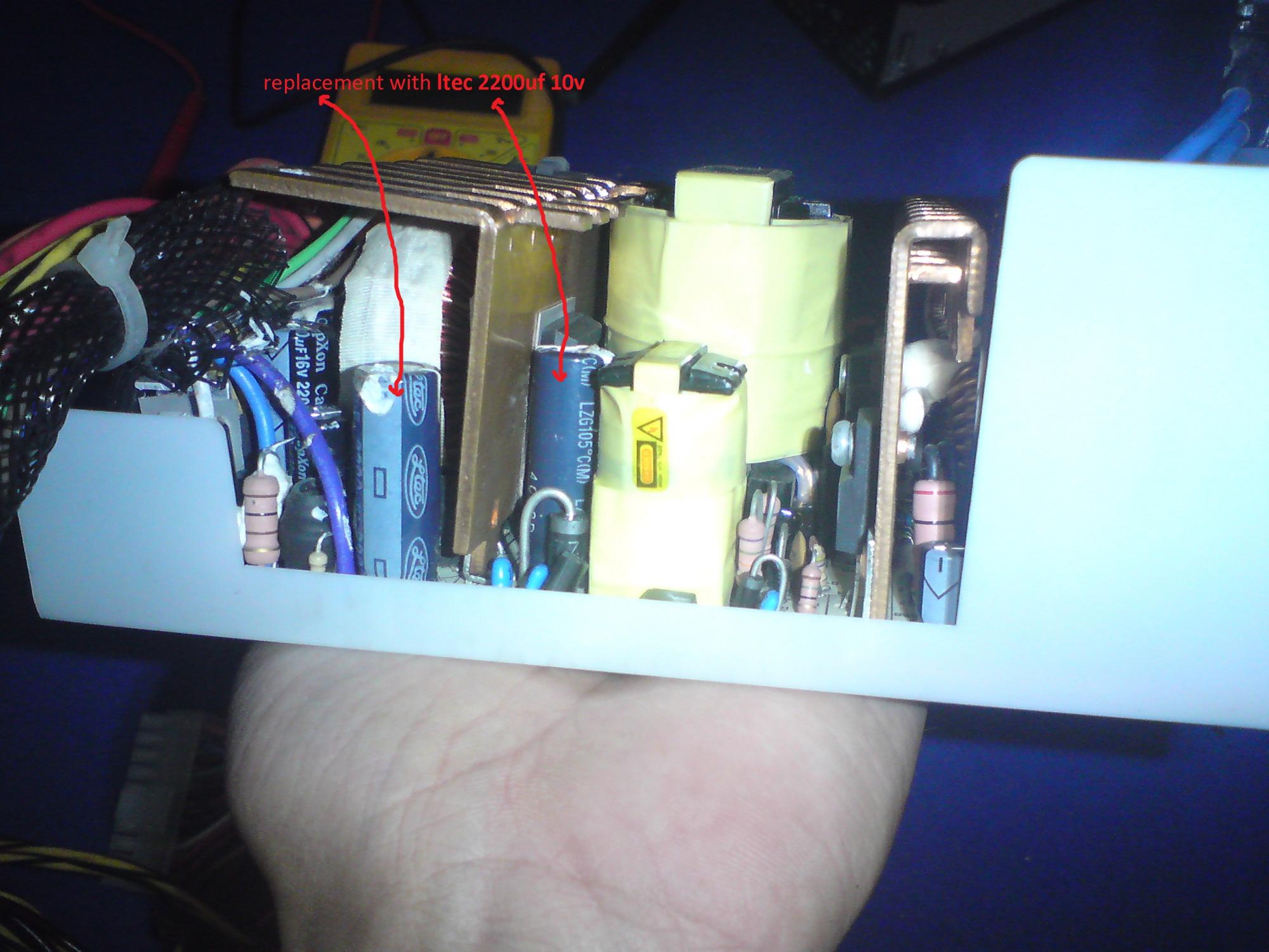

              i first recap the 3 of suspected bulged capxon
              2 capxon KM 2200uf 10v >>>>>> replaced with ltec 2200uf 10v
              1 capxon KF 4700uf 10v >>>>>> replaced with pcetul 3300uf 10v
              (replacement salvaged from other psu lying around)
              finally ..this psu would turn on pluged into P5E X38 mobo ,,with his radeon 4830 (1x6pin pcie)
              do a quick 3dmark test ..passed
              superpi test ...passed
              everest stability running for about 3 hours ...
              voltage rail still within limit of 5% tolerance
              next ...will do full recap all secondary capxon caps ..
              thanks for badcaps ..Toasty ; Evil Lurker ; c hegge ....

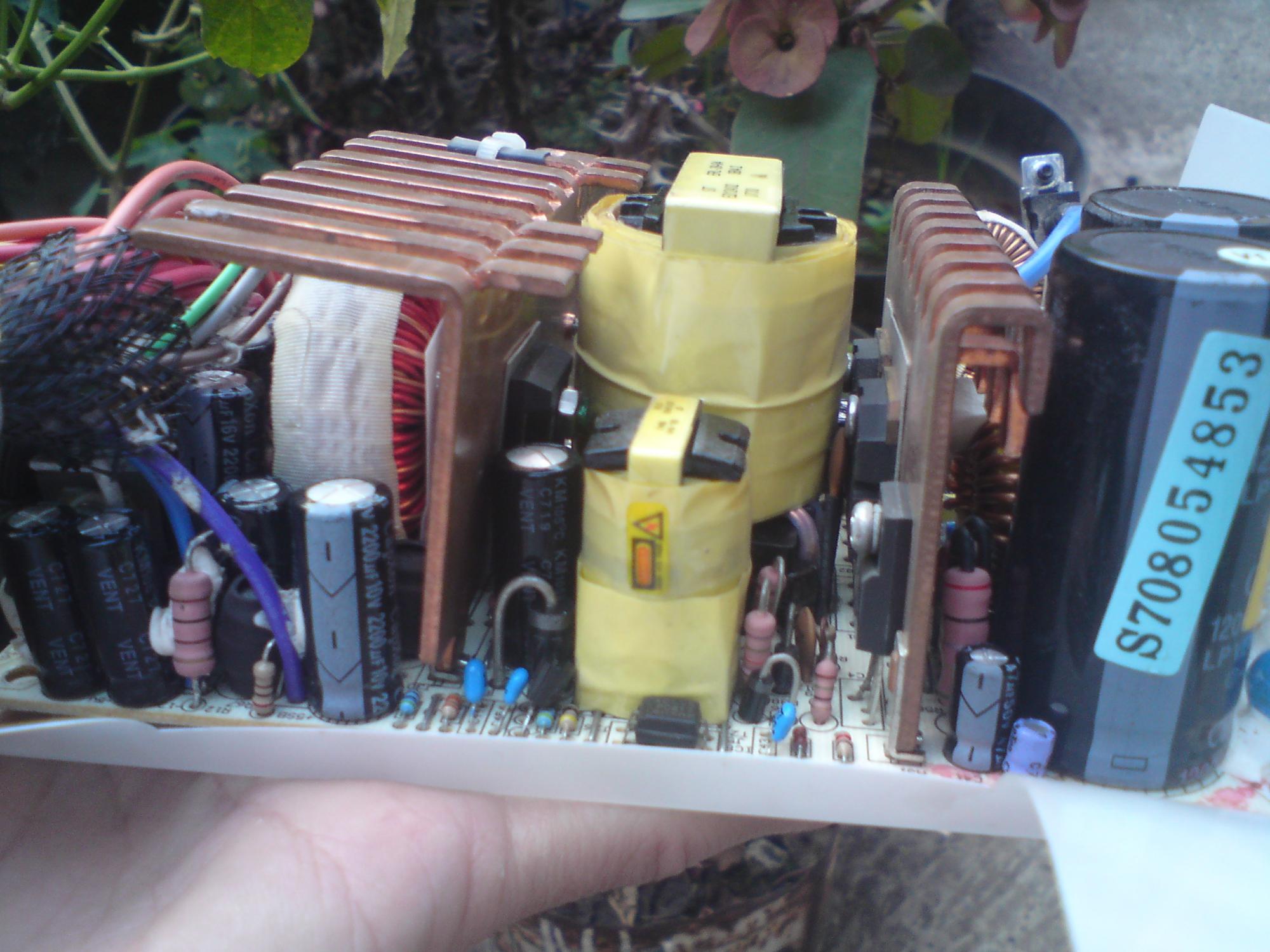

                    here's some pic after recap ..
