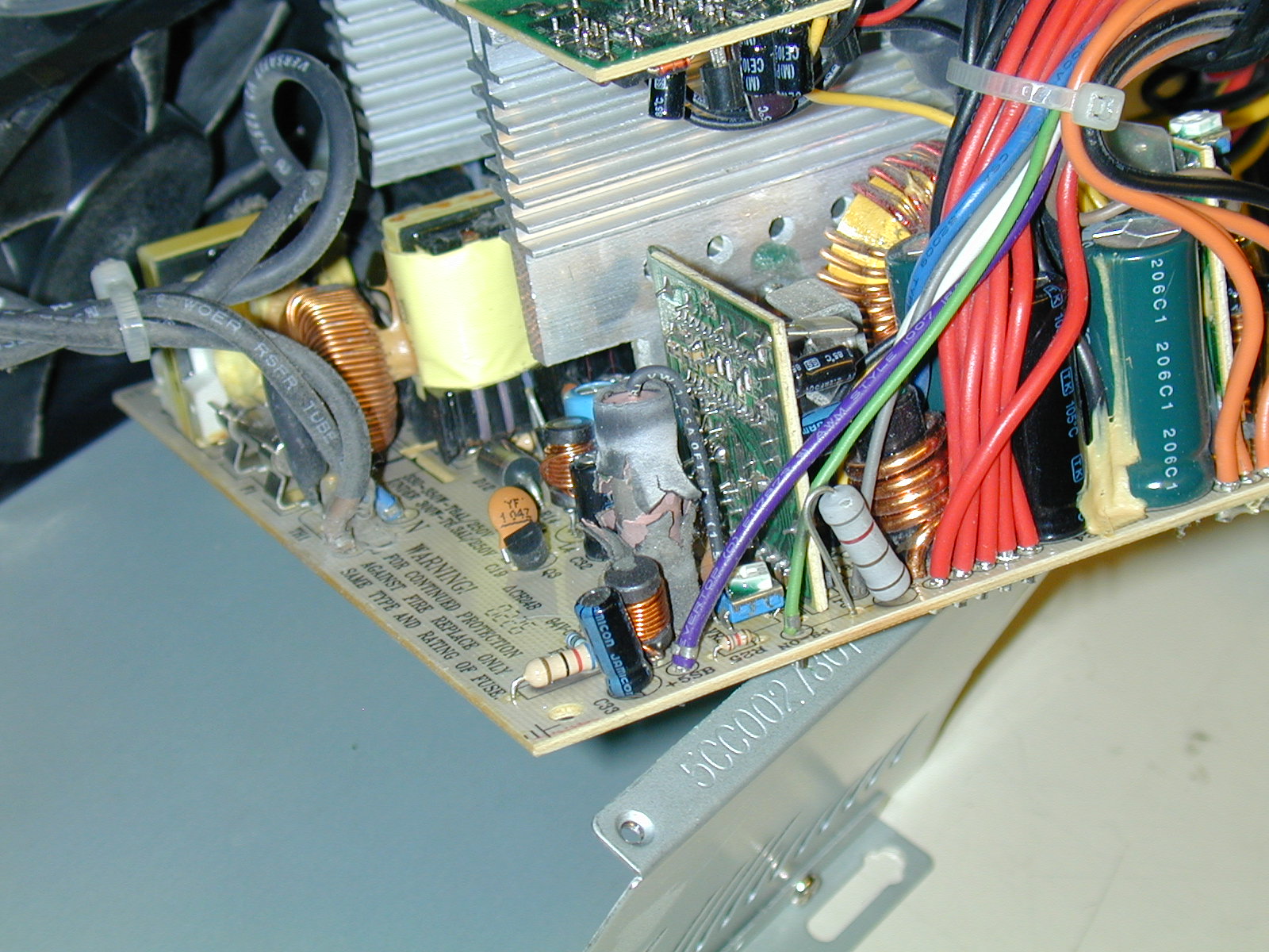

Cannot identify component on FSP300-60BTV
  • BillyJack
    • Jul 2011
    • 3
    I have an FSP300-60BTV power supply out of a nine-year-old VPR Matrix FT-6100 computer. The computer will not power up at all-completely dead. When I opened the power supply I saw this bad component I would like to replace. The photo came from another contributor so the problem may be common. Could someone please tell me what this component is and what value it has so I can replace it? It looks like a capacitor that's burned and mushroomed in the middle. It's soldered into a hole on the PC board lableled: R34.
    Any information would be greatly appreciated. And thank you to the contributor of the photograph.
  • mockingbird
    • Dec 2008
    • 5488
    Re: Cannot identify component on FSP300-60BTV
    That's a resistor.
    I would love to know what the value for it is as well. I also have a rebranded FSP with one of those, and the pink ceramic on the outside seems to have chipped off the metal core.
    The stripes don't correspond to a realistic value, I checked it out.
