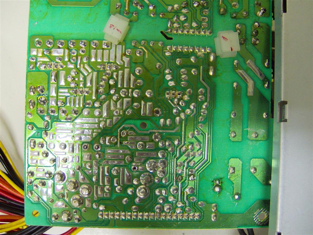

    Got this Dell one, that would not start. The fuse was burnt, power MOSFET shorted, and two caps bulged ( Ltec ones, 470 x 10 and 100 x 35 ) . After replacing them ( the original MOSFET was rated at 900V 9A, I´m testing with a 500V - 14A one, while the compatible is on its way ) , most of the lines work ok , with exception of the -12V one.
    5VSB gives 4.9-5.1V, Power Good ok, 5V, 3.3V and 12V all are at the right voltage or near enough ( like, 4.9 or 11.8 ) .
    The board uses a 7912 regulator for the -12V ( removed it, tested good ) . Measuring at the board, there is 0.5V at its input pin. Following this pin circuit, both caps in it tested good . Will replace them as well, just in case. The circuit goes to one big toroidal inductor, with the other voltages as well, but I could not find the other pin of what I suppose is a -12V coil.
    Trying to understand, this toroid mixes all the voltages to somehow equalize them, or remove intereference ?
    Is it normal/possible for this to fail, or should I search for other failed componentes, even in far places of the board, that could be causing this ?
    Or, maybe, could Dell have made a power supply that will not put out -12V when not connected to a motherboard ?

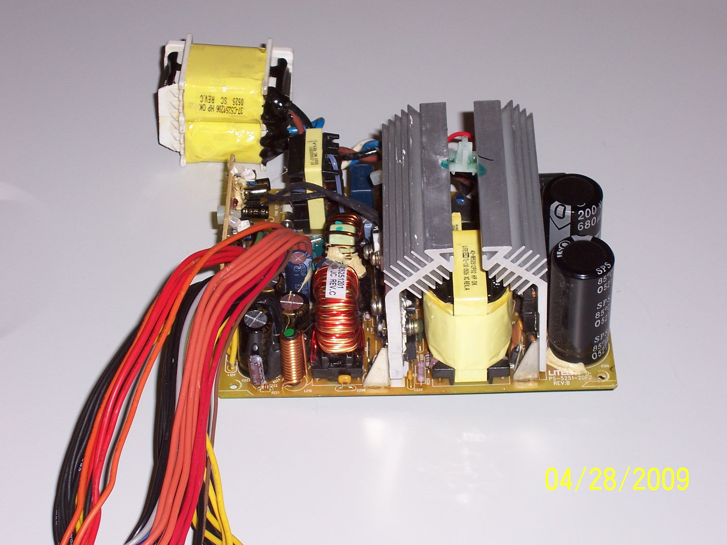

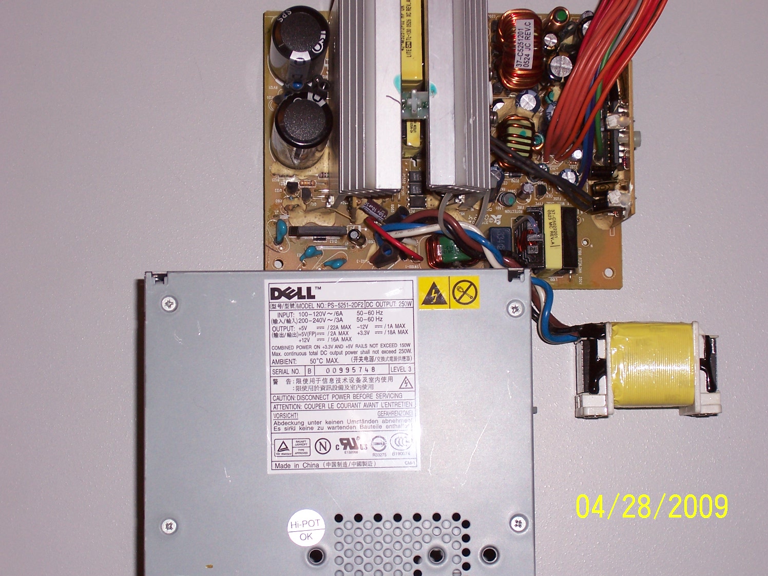

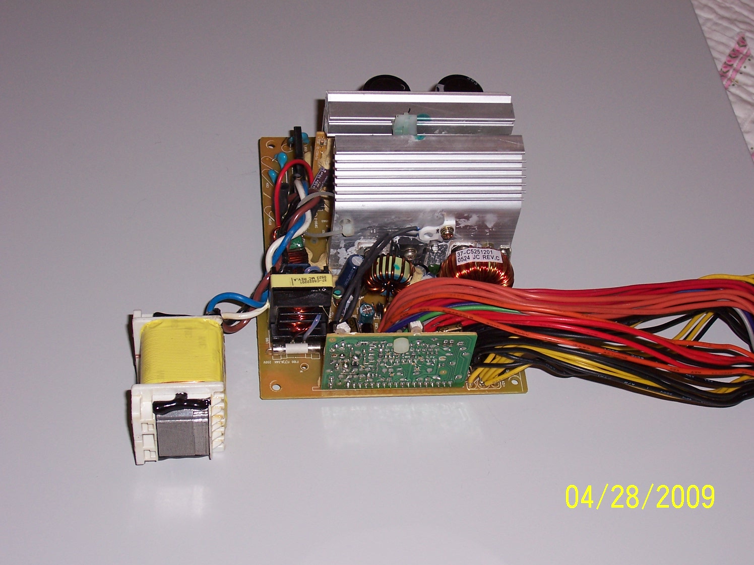

            Re: Dell PS-5251-2DF2 missing -12V line
            Over the past few years, I have fixed at least three of these Dell power supplies. In every case the A916 transistor was either shorted or leaky. I have never been able to figure out just how that circuit works, but it is tied to the -12 volt line, and thru other components also ties to the +12 volt line and the 3.3 volt regulator. So that transistor can cause some strange problems. I would suggest that you remove and test the A916 transistor, or just replace it with a new one. Save a few headaches later.
            That transistor is located on the small pc board soldered to the main pc board.
            Also a couple more pictures.
            Old proverb say.........If you shoot at nothing, you will hit nothing (George Henry 10-14-11)
              Good find on that leaky transistor. I believe what we're looking at is a circuit that makes the +12v track with the -12v. Interesting that they had to do it with discreet parts in a messy circuit. Since all the other voltages are good, you know that the main power supply functions are all fine. If that PNP transistor shorts, then finding it is easy. If leaking, it might show some strange numbers when doing the normal diode tests with the part desoldered.
              Since this circuit is a known trouble maker, please take a voltage reading on the IC terminal from a known working supply and put it in the stickies.

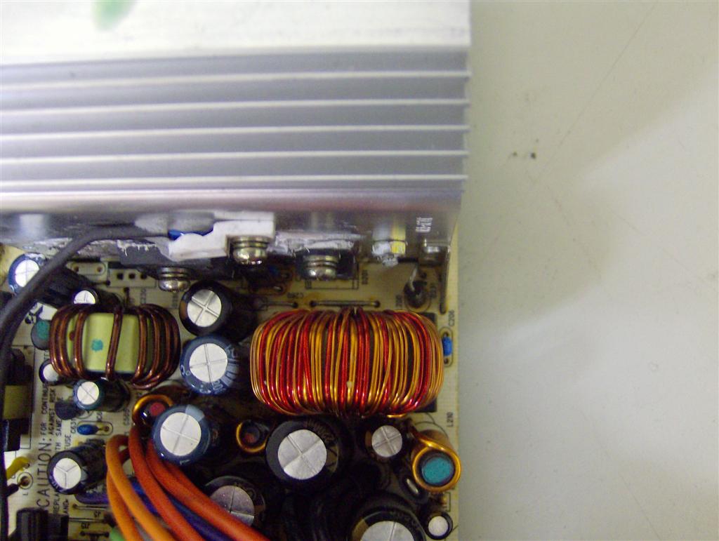

                    Originally posted by rogfanther View Post
                    And I am still curious, the coils from that toroid must present some low resistance, right ? Is it possible, that the same thing that made the mosfet to shortcircuit could somehow have damaged that ?
                    If the wire for the -12v was very thin, it's possible.
                    In any case, check the -12v rectifier. Based on everell's pictures, it looks like the -12v rectifier is right behind the big inductor, close to the small ceramic capacitor C206.
                    Also, all in the name of science and research, provided that I be careful, rewinding that with the same wire gauge and same number of turns of every coil, should probably work ?
                    Yes.
                    Although if the 5v and the 12v rails are working fine, then the wires on the toroid for the 5v and 12v rails are fine too and you don't need to rewind them.
                    If you can't find which other wire connects to the -12v, then just trace out the 5v and 12v rails and see which sets of wires they use. Then see which wires they don't use, and that should be the -12v rail. As for the 3.3v rail, it uses that other smaller toroid.

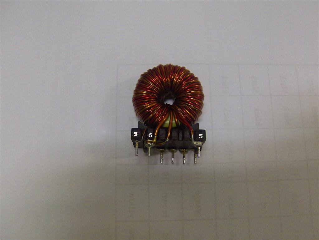

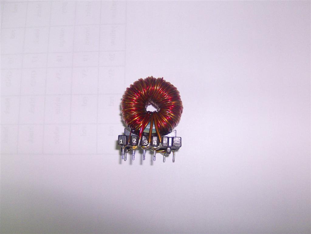

                            Here are some photos.
                            Measuring continuity in the toroid coils, I got 0 ohms between pins 3, 4 and 6 ( thick yellow wire ) . Also 0 ohms between 2 and 5 (thick red wire ) . But between 1 and 7, the pins for the -12V, I measure approximately 12 kohm.
                            Desoldering the thin wire from the toroid pins, one leg of it shows a short to the 2-5 coil, and the other leg seems to not be connected anywhere.
                            I still have to find the a916 transistor or an equivalent, but will solder the toroid back ( with the -12v coil disconnected ) to measure if there is voltage in the input side.
                            The red line in the foto is the path of the -12V, with the 7912 in the upper side. Input comes from the toroid, output goes to the supervisory board.
                                Three main windings, one with thick golden wire, one with thick red wire, one with thin wire. ( the thin wire is connected to the -12V line ) .
                                  Originally posted by Longbow View Post
                                  This is a transformer. It might be your standby power supply transformer, which usually provides standby +5 volts.
                                  No.
                                  This is the main filtering toroid/inductor for the 5v, 12v, and -12v rails. Depeding on the PSU design (and age), some manufacturers will have a winding even for the -5v rail.
                                  Those are normal readings, so those windings are good.
                                  The red wire on the toroid is for the 12v rail, and the two yellow wires are for the 5v rail.
                                  Not good. You should have continuity just like for the 5v and 12v windings.
                                  My guess would be that when the small transistor shorted, it overheated the -12v winding on the toroid and caused it to melt.
                                  Since one leg of it does show a short to pins 2 and 5 (the 12v winding), then you should rewind the toroid's 12v and -12v windings.
                                  Better yet, if you have any other junk PSUs, find a toroid of the same size and rewind it so that it has the same number of turns for each rail as this one.
                                  Also, I may sound like a scratched CD, repeating myself in an annoying way, but again: check the -12v rectifier! Should be 1 or 2 axial diodes.
                                  Based on the underside pictures you posted, the -12v rectifier should be right next to the toroid, close to the edge of the board and that small yellow ceramic cap C206.
