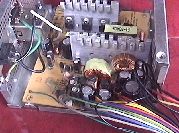

    Well I want to practice first before make any attempt to recap pricier PSU (Tt, Fortron, hec, etc...).

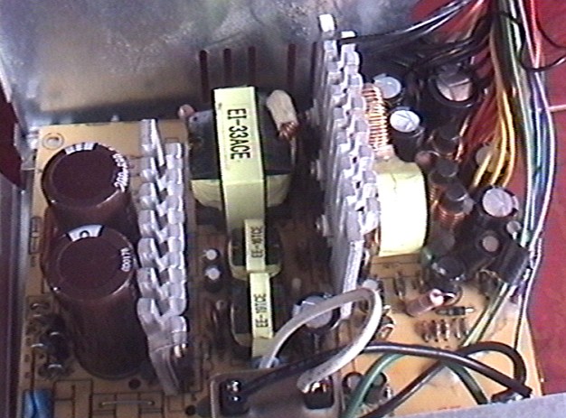

    So I pick the cheap one, ATK (AIBO) 380W ATX PSU. I got it with the $40 case, the psu itself maybe cost $20. It has been powering my duron1300 rigs since a year ago, running folding@home 24/7.
    The original look before modification, this unit is very silent when operate even outside the case:

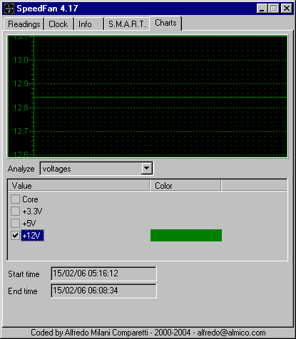

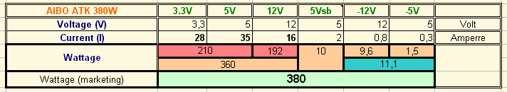

    Spec:

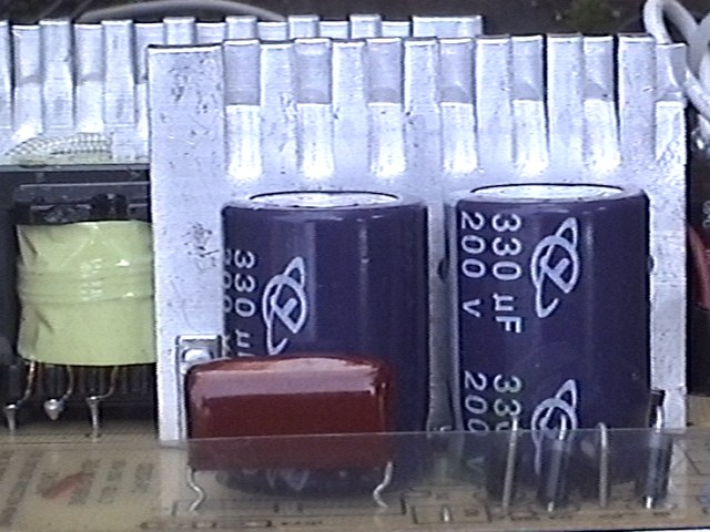

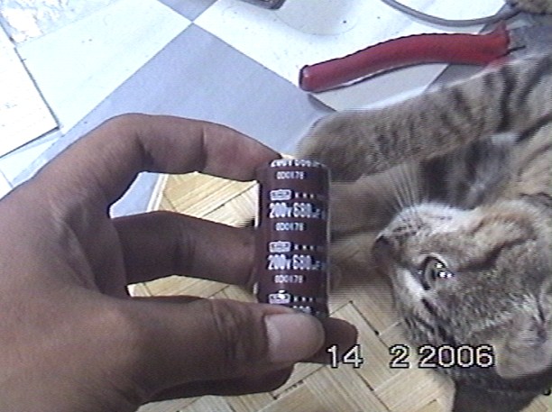

    The original bulk caps (hey can somebody tell me what brand is it? Looks like planet Saturn's.. :P) :

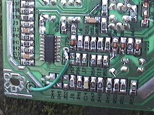

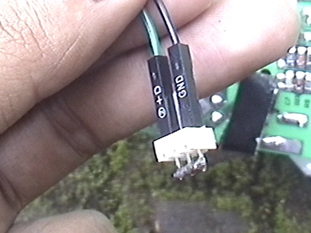

    The PCB trace (back). Notice the green wires, I made a switch (green wires <--> ground) so no mobo required to power on the psu:

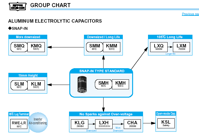

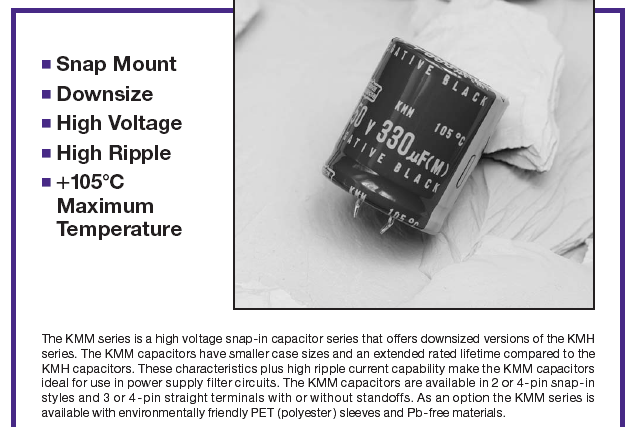

    I was searching for snap in type (bulk) caps from the shop/distributor for value => 470uF 200V. I have no clue what should i get. They give me the KMM chemicon caps. I don't know if it is suitable for my needs (high ripple, low ESR, long life). But the shop tells me that they are good for audio power supply. So, I take it. When in doubt, buy it! That's my motto... The price is almost $2 a piece. Wow!
    Fortunately, after i check the data from chemicon website, these caps are the good ones.
    From the data above I draw conclusion that what I should get are (in order): KMH, KMM, LXQ, LXM
    I make a quick comparison between them:
    KMM is really good compared to the higher spec LXQ. The endurance is 3000hrs though (@105C). That's should be enough.

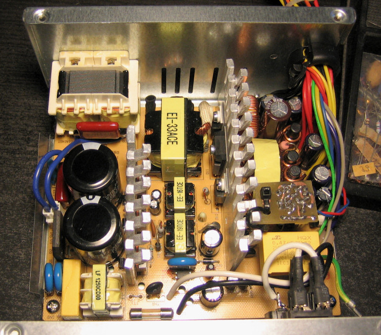

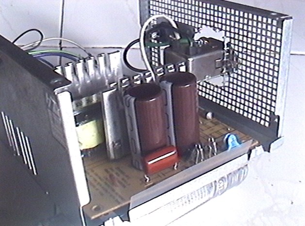

    The recapping isn't really difficult.
    Notice the EMI filter. I don't know if installing an EMI filter will make any good for the non pfc psu. But I did it anyway, because I can... lol I have some PSU w/APFC that already have it.

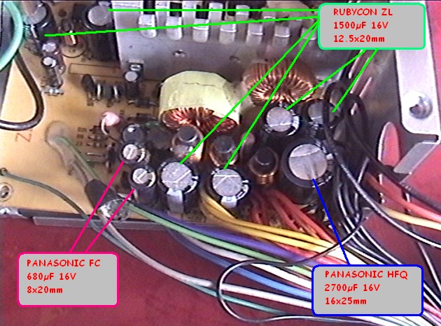

    Btw the original caps in secondary side are some Su'scon and Koshin.
    Caps that I use for this project:
    Code:
    Brand & Series		Capacitance	Volt	Dimension	Pieces	Ripple Impedance/ESR
    Panasonic FC		680uF		16V	8x20mm		2	995 	65
    Rubycon ZL		1500uF		16V	12.5x20mm	6	2360	21
    Panasonic HFQ		2700uF		16V	16x25		1	2070	28
    Chemicon KMM		680uF		200V	25.4x40		1	780		366
    Some original caps under 100uF were replaced with some Panasonic KG, TE, MH.
    The hard part is that I have to desoldered the wires (ground, 12V, 5V) first. That makes recapping a lot easier. In the end, all caps seat nicely, no need to bend the legs or any tricks...

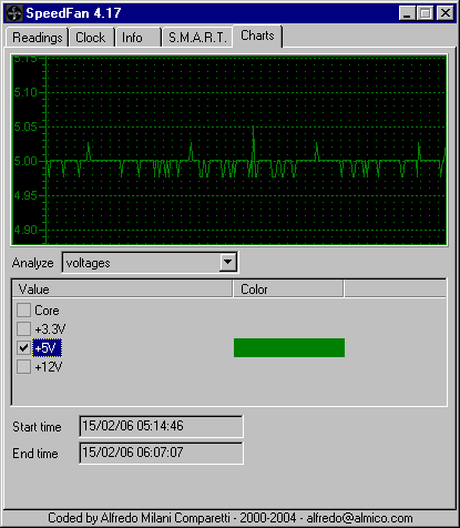

    more pics uploaded...

      You don't really need to change the primary side caps - they rarely fail, except for one small cap, 22 uF or 47 uF near the auxiliary flyback transformer. Also, you've probably used a bunch of 16v caps where 6.3v or 10v would do, on +5vsb, +5v, -5v. You only need 6.3v caps on +3.3v. You can use either 16v or 25v caps on +12v and -12v. 1000uF/25v is sometimes very inexpensive and available easily, and usually has a higher ripple current rating than 1000uF/16v of the same series.
      Other than that, the specs are fine - overkill, actually.
        Re: Recapping my PSU (non PFC) & a little modification
        BTW, the original PSU was probably no more than 200W, notwithstanding the 380W spec.

          looks like an allied.
          they are often packed with ost and swcon/rulycon(rubycon fakes)
            I have seen those same Saturn main caps in an L&C LC-B450 E 450W power supply before.

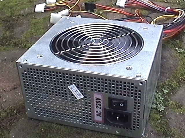

            Is the exterior of the cheap 380W 120MM fan power supply still the same?
            Post an after photo of the exterior of the power supply if you can.

                Cool - it looks like the topology for the auxiliary (+5Vsb) flyback converter includes an optoisolator and does not have the Achilles heel (a small primary-side cap) typically found on these supplies. Does it have a Topswitch TOP221 or similar TO220 device as the primary switch on the auxiliary supply? The TOP22x provides excellent regulation and a simple topology, but less protection against mains spikes. An MOV on the input is highly recommended to protect the FET.
                  BTW, if it's a TOPswitch, you need to stick with the recommended values of the capacitors on the secondary-side pi-filter for +5Vsb. IIRC, it's ~330uF or so - if you go much higher, it will alter the transient response and stability. Anything over 1000uF is probably too high.
                    One curiosity to look for with TOPswitch has to do with the start-up function. If you turn off AC power to a P/S, there may be enough energy in the I/P lytics that the TOPswitch will try to start. It immediately shuts down again, but if you have a 'scope on the +5V Stby, set for 1 second/division, you'll see several pulses from start-up attempts.

                        Actually, at first attemp to recap months ago, I use some rubycom mbz 10v. But then I changed my mind & replace them with pannys hfq & fj 16v. The fj seems to be getting too hot while touching the toroid. So, while thinking that i should bend (desolder) the torroid a little bit to the heatsink direction (done), i said why don't I change all the caps to rubycon zl 16v? It clearly has higher ripple and lower esr than any of the hfq and fj (and elna rjj and rubies yxf) while has the same price. So be it Now the jungle of caps looks more homogen..
                        I have a bunch of those 1500uF 16V ZL. I run out of stock for the 1000uF RJJ, YXF, and 1500uF HFQ. No more supply of them from the distributor. All of them have 12.5mm diameter. he price for the ZL is ~20 cent($) per piece. However i'll try to be wiser for the next mod..
                        Btw sorry for my noob, can you explain where and what is the auxiliary?
                        How to know if that replacement for the caps need not to be over 330uF? is 680uF 16v okay? What is the "TOPswitch"?

                        I dug some pics, and can only find this.. it's really just a simple box..
                              The section of the PSU that supplies both +5Vsb as well as the Vcc for the controller IC. In this case, it is the circuitry around the small yellow transformer furthest away from the main (larger) transformer. It is usually 'on' all the time that the PSU is plugged in.
                              Check the original values and try to stay within about +100% of the original capacitance. 680 should be OK.
                              It's a 3-terminal Power IC that includes a High-voltage Power FET as well as an SMPS controller circuit on the same die. It's usually in a TO-220 3-pin package, or an 8-pin DIP. It allows building a low-power (upto ~20W) flyback SMPS with very few components, and is commonly used as the switching device in the auxiliary power supply of ATX PSUs.
                                With ATX forward, there is a section of the P/S that is always on (if AC is applied). This is called the "standby" or "auxilliary". It supplies power to the MB logic that enables or shuts down the main P/S converter.
                                TOPSwitch is a trademarked name for Power Integrations' IC, described above by linuxguru. STMicro was working on a functionally similar product back in 2000, but I don't know whether they ever marketed it.

                                    DEER makes a power supply that looks to me identical. L&C, a DEER company, uses those blue "saturn" main caps, and also uses the generic "saturn" fans. DEER doesn't have them in 380W, but the closest they make are 350W and 400W. In one of those photos yanz posted, I saw half of the "P4 Support" warranty sticker, and it is commonly on DEER and L&C power supplies. I included yanz's picture with a red oval on the half of the warranty sticker. Have a look for yourself.
                                    http://www.deer-group.com/switch-12cm.htm
