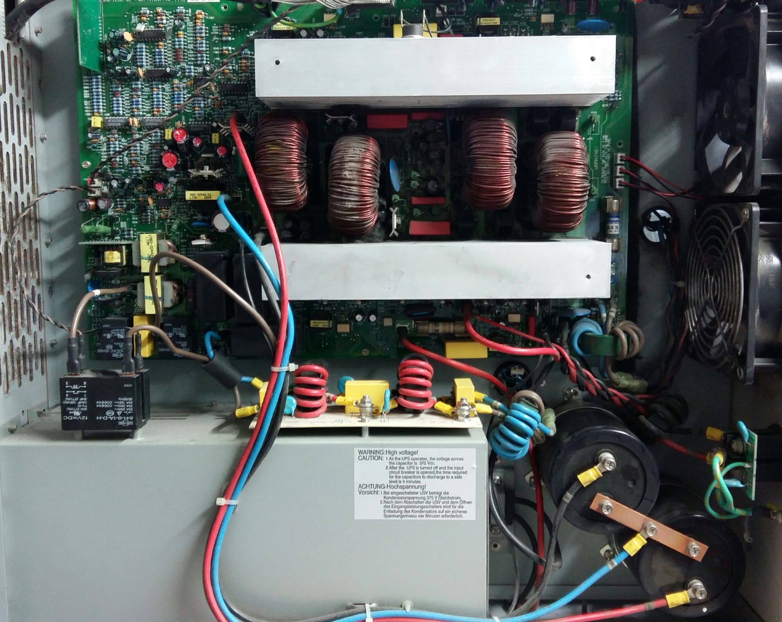

Powerware 9120 Online UPS

    Re: Powerware 9120 Online UPS
    I'm a new member. I have a problem whit my 9120 6kva. on display appears the message "O/V low"; infact when it begins working it's ok, but after 20 second the ups goes in bypass and the message that I said, appea.
    Can somebody help me? thanks

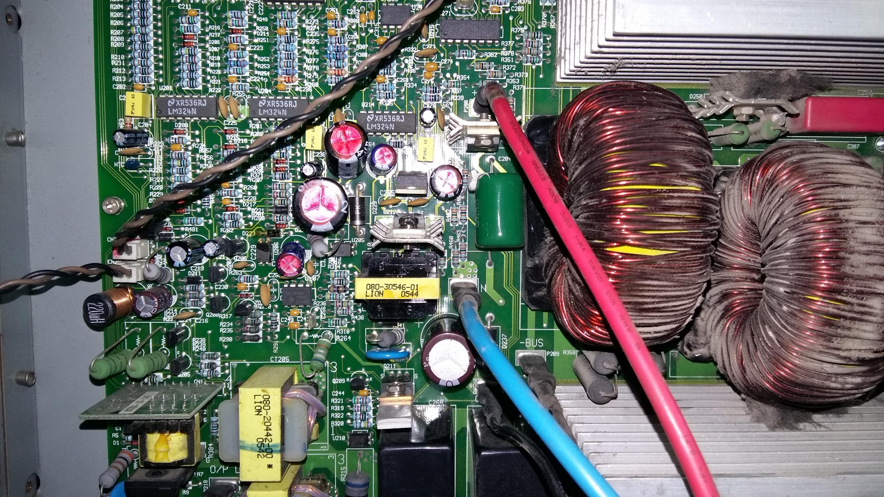

          Hi just repaired a Powerware 9120 700VA that was showing 'DC BUS FAULT'.
          At first I pulled C14 and others ( C10, C40 C42 & C48 as they are in close prox. to heat sources )
          I measured the capacitance of the pulled caps, But the were all within 10-15% of there rating. So I though bummer this is not going to be easy as I don't have an ESR meter.
          But then I found this video "#135: Measure Capacitor ESR with an Oscilloscope and Function Generator" and last year I purchased a Rigol MSO1104Z-S so after a couple of minutes setting up and testing known good and bad caps as a test. Was able to very quickly go thru and test the pulled caps.
          So C14 was like 89uF so thats within 11% of 100uF and on a 20% spec cap it still looked ok to the DMM but its ESR was off the charts.
          The rest of the caps were perfect.
          So if you have a 'DC BUS FAULT' and you have measured C10 and C14 and you still think they are ok, REPLACE THEM.
          Replaced: C10 with Nichicon 100uF 63V 105ºC and remounted the nearby diodes slightly off of the board as its looks like they get nice and toasty.

              Yeah that's exactly what we keep repeating here - you won't tell bad cap with just capacitance meter. If you want entry-level professional ESR meter/capacitometer, I can supply ya. You can use O-scope but that's really for telling way-off caps only.

                i have also an ups like that, with the DC Bus Fault Error
                i have now changed the 2 caps c10 c14 for trying, but still doenst work,
                someone any suggestions what else it could be?

                  I would check every capacitor on it with an esr / capacitance meter.

                                    I have the 5KVA model with same DC Bus Fault. Have thoroughly followed this thread. My main board is more complicated. I have changed the capacitors marked in RED in the DC-DC section.
                                    Anyone was able to find a schematic? Its a pity not being able to fix this old but good UPS.
