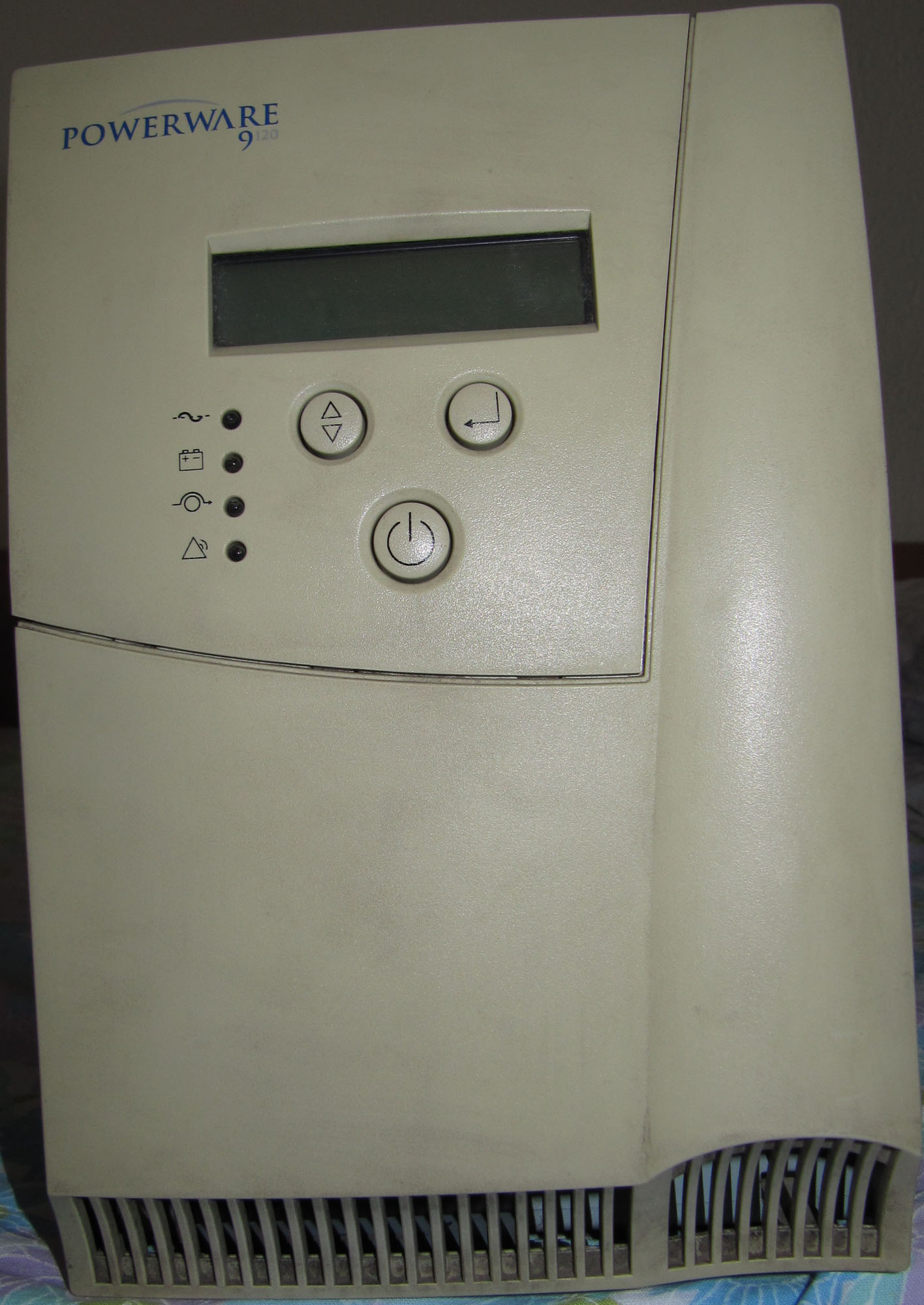

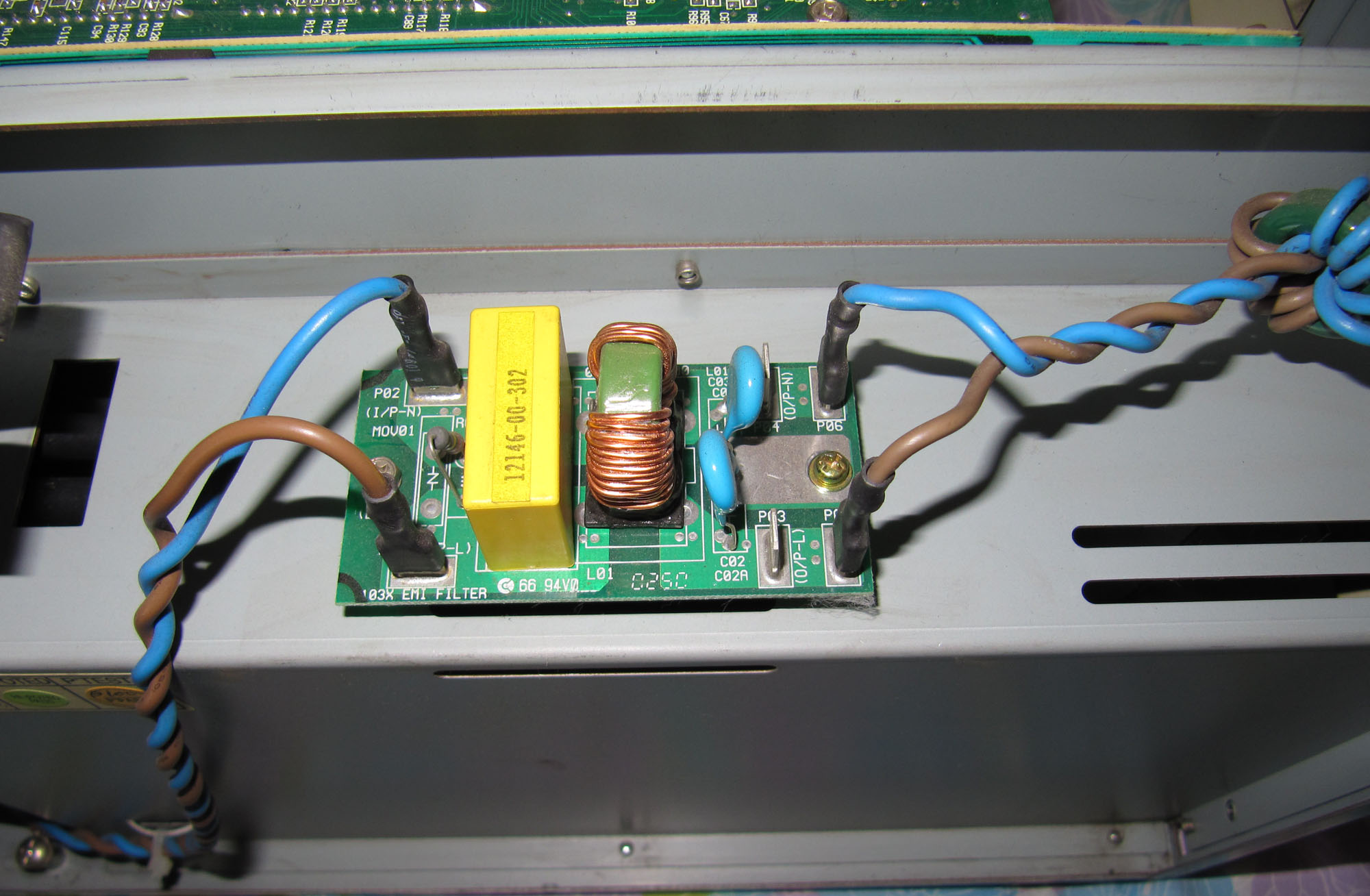

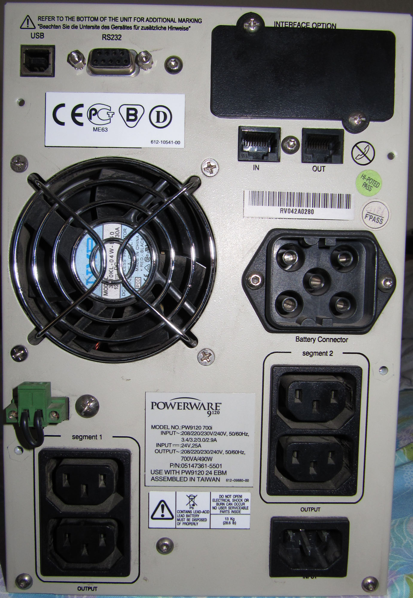

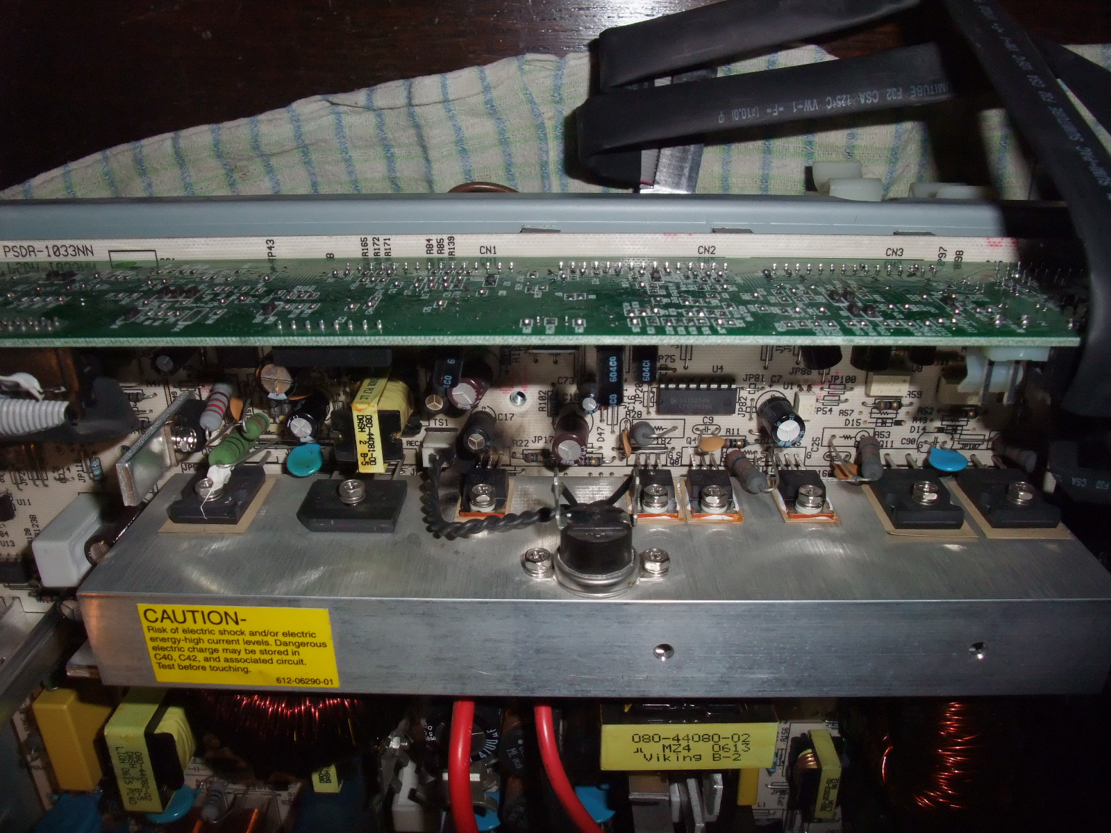

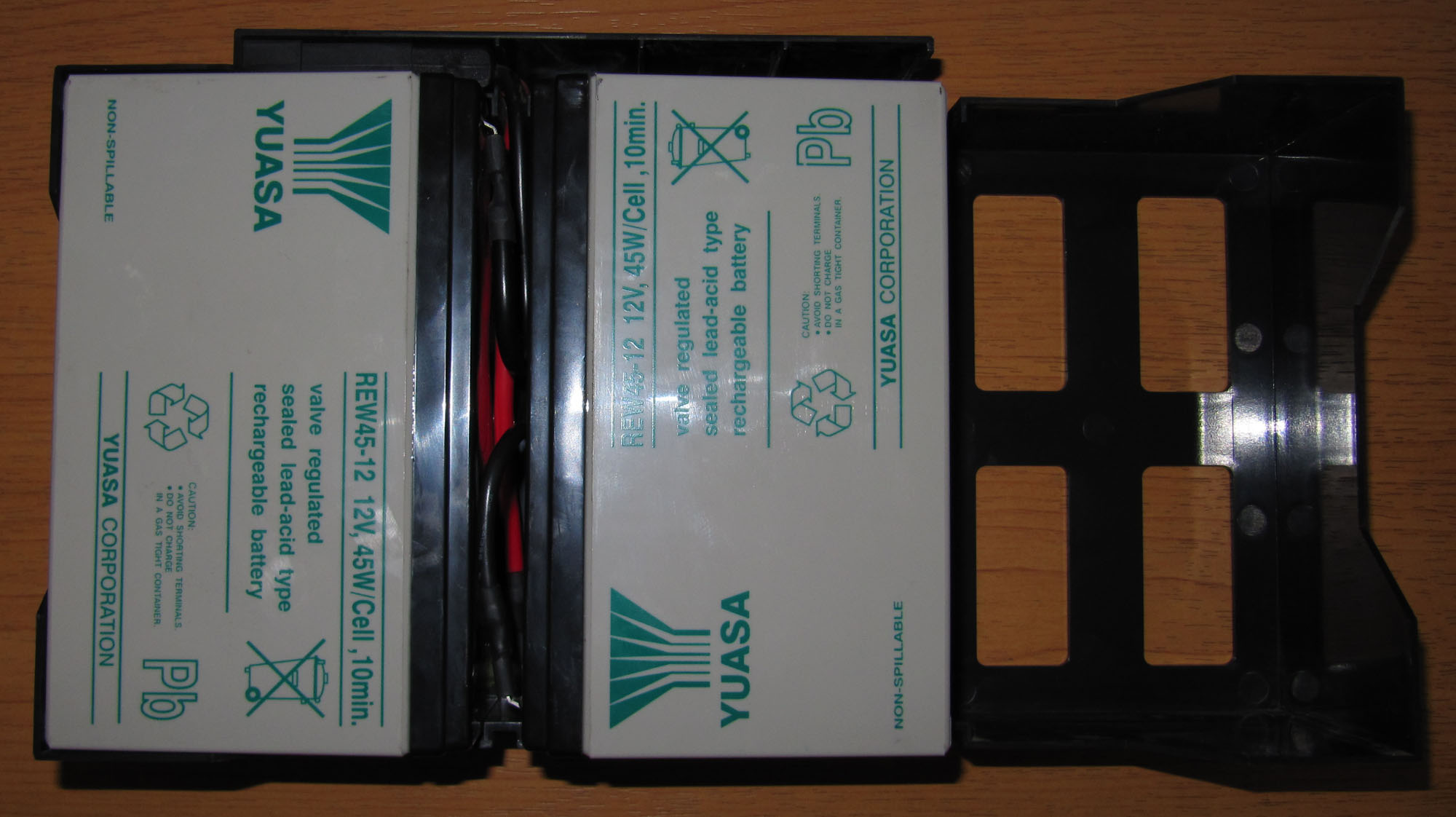

    This is another freebie I found recently. It came with 2 12V 9AH batteries that are not completely dead. It seems they still have ~1/3 of their initial capacity.
    The UPS works, but displays “DC bus fault” the first time it starts. I looked around and it is probably cap related:
    http://oh2mp.ham.fi/misc/powerware9120/english.html
    http://www.fixya.com/support/t133894..._fault_problem

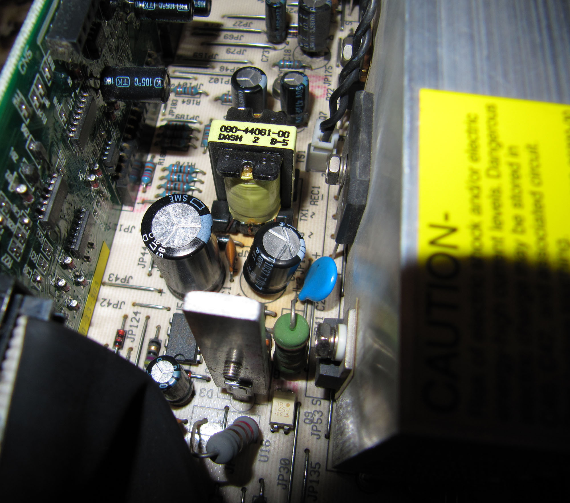

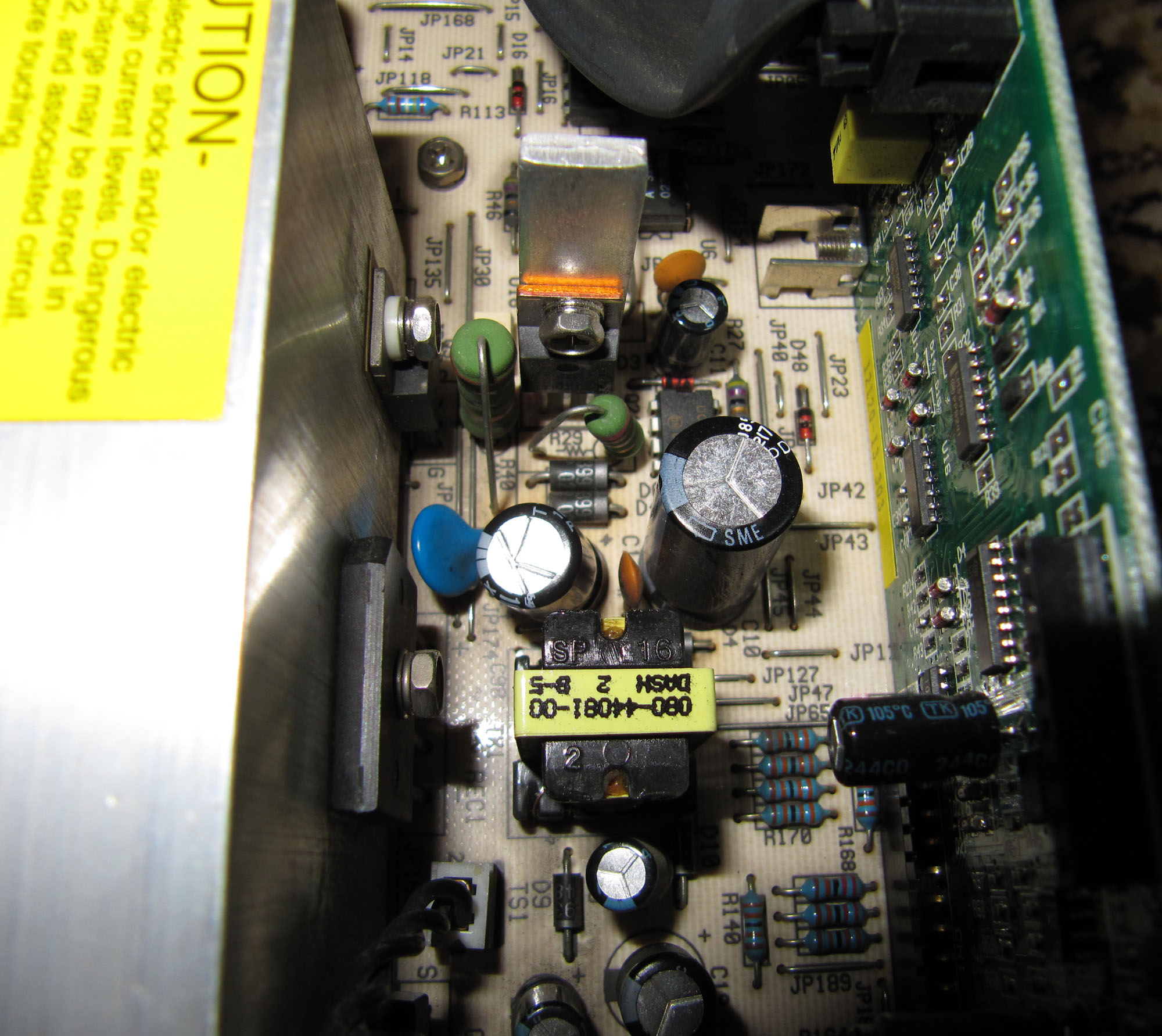

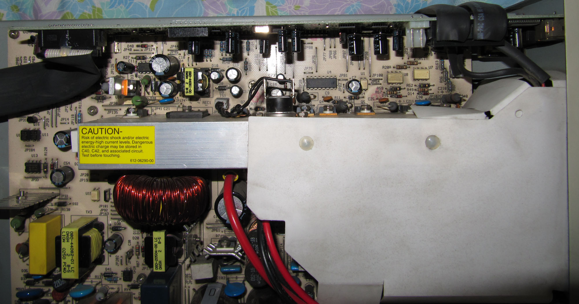

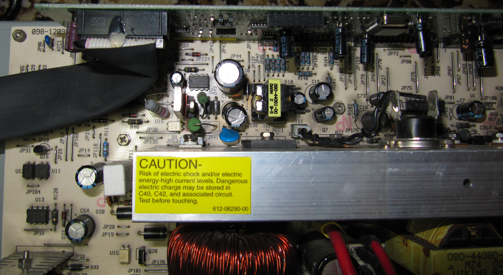

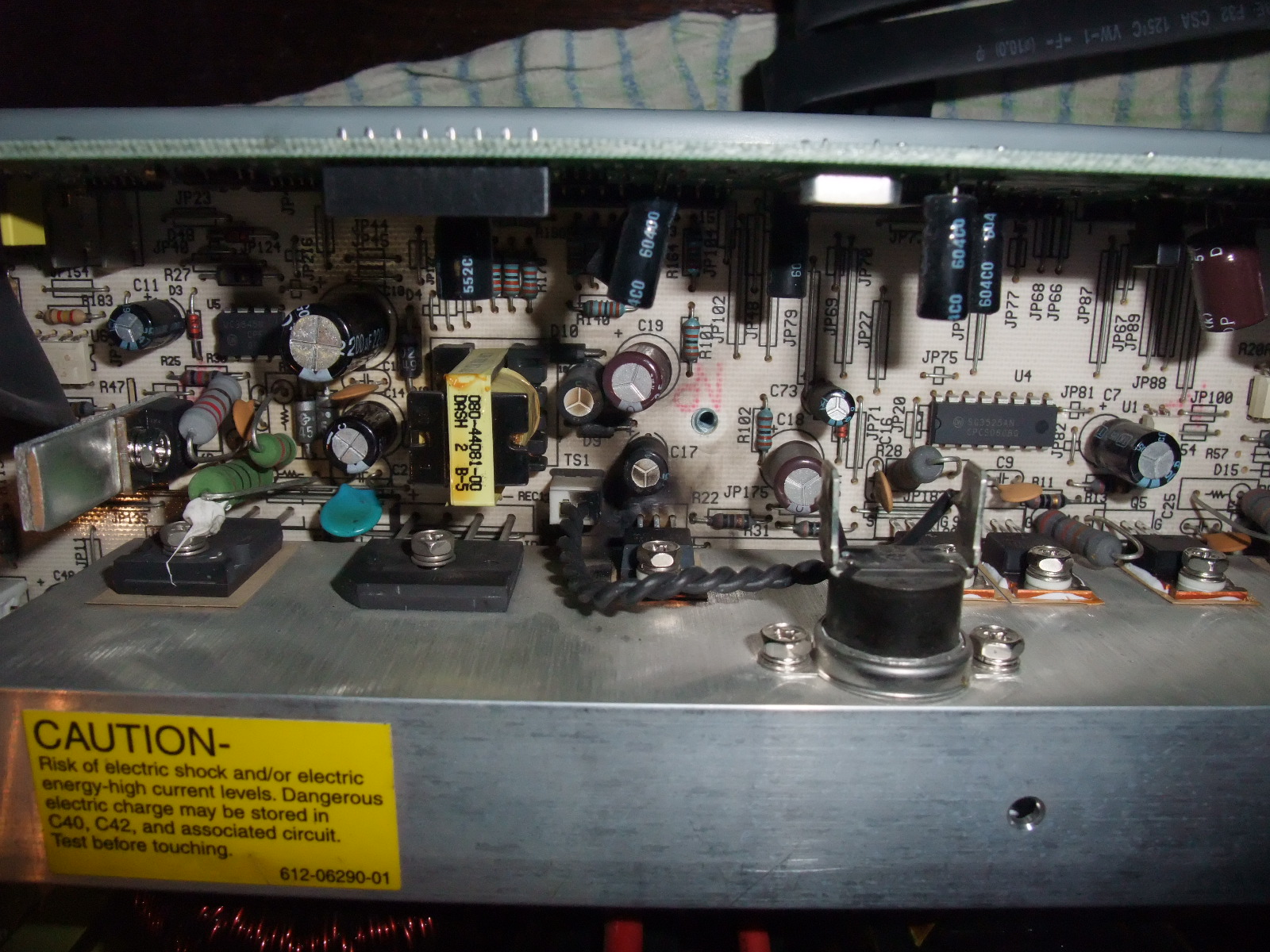

    I tested every capacitor on it and only the C14 = 100 uF 63V Jamicon TK is bad (capacity: 103uF, esr: 28).
    1) Do I need to change the other cap mentioned in the links?
    It is a Chemicon SME 2200 uF 16V with capacity: 2400uF and esr: 0.04-0.06, tested on circuit (datasheet)
    Is Chemicon SME a reliable series?
    2) Can I replace the Jamicon TK 100 uF 63V with Rubycon YXF 100uF 63V?
  • japlytic
    • Oct 2005
    • 2086
    Re: Powerware 9120 Online UPS
    Nippon Chemi-Con SME appears to be a reliable series, and has been superseded by SMG or SMQ.
    You can replace the Jamicon TK with Rubycon YXF.
    Check for shorts on the DC bus as well from C40 and C42 (after discharging them), including checking for shorts on Q11 and Q12 on the power board.
    • goodpsusearch
      • Oct 2009
      • 2848
      • Greece
      I replaced the bad 100uF 63V Jamicon TK with Rubycon YXF 100uF 63V and now the UPS works... I'll test it more thoroughly tomorrow.

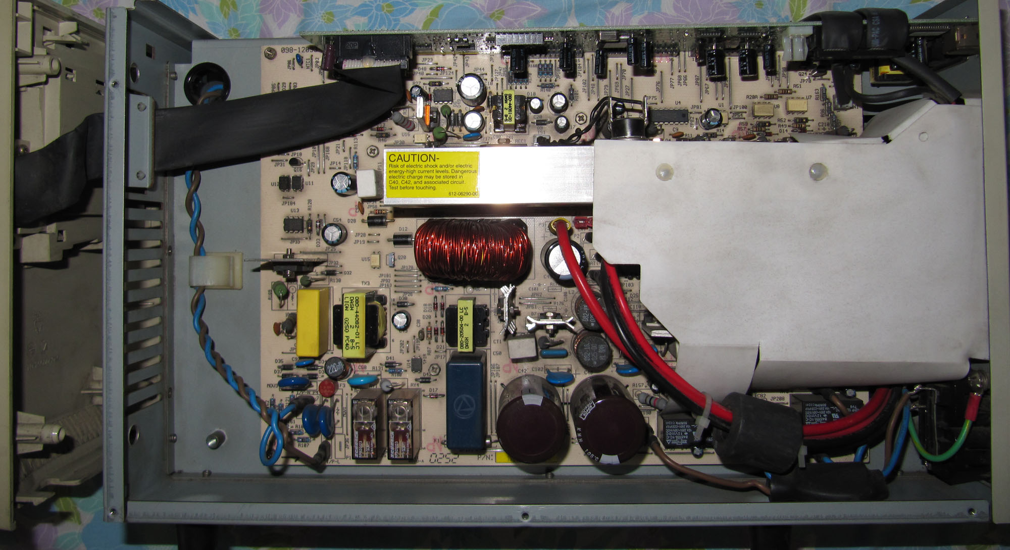

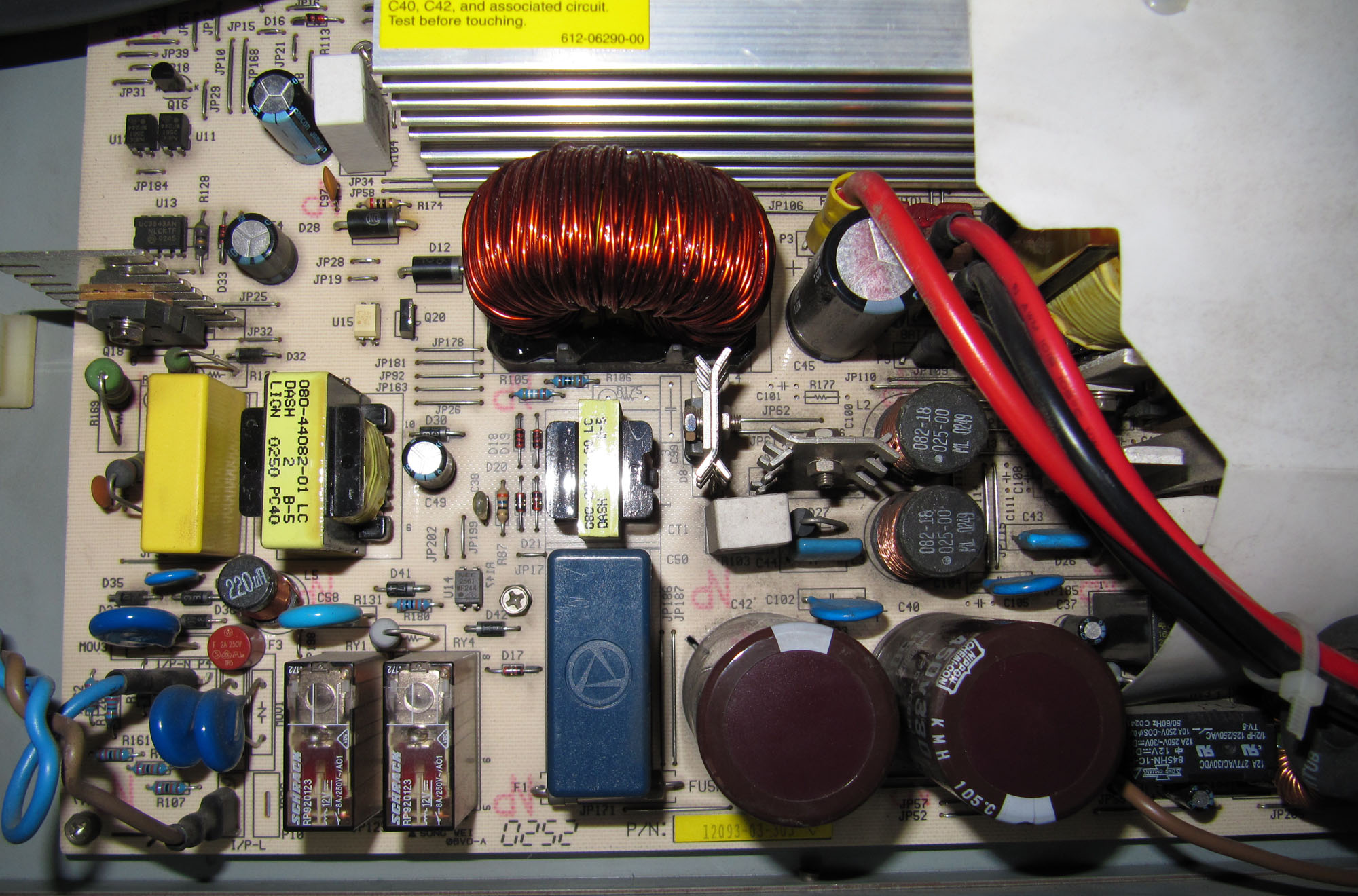

          My board is a model 098-12101-04 PSDR-1112NN P.W
          P / N :12101-09p-638 (e1)
          I appeared on the display DC BUS Fault

            Seems that this usually means shorted transistors and/or dried caps near heatsink. Do you have digital multimeter? Any other equipment?

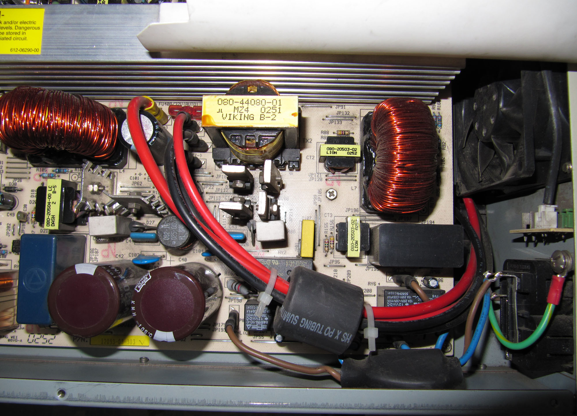

                If you provide good enough pictures If it is more or less the same as in the first post, than that would also be capacitor C14, it's the 63V/100uF cap. Check all those transistors attached to the big heatsink in there, if you have DMM, that's a minute to check them all.

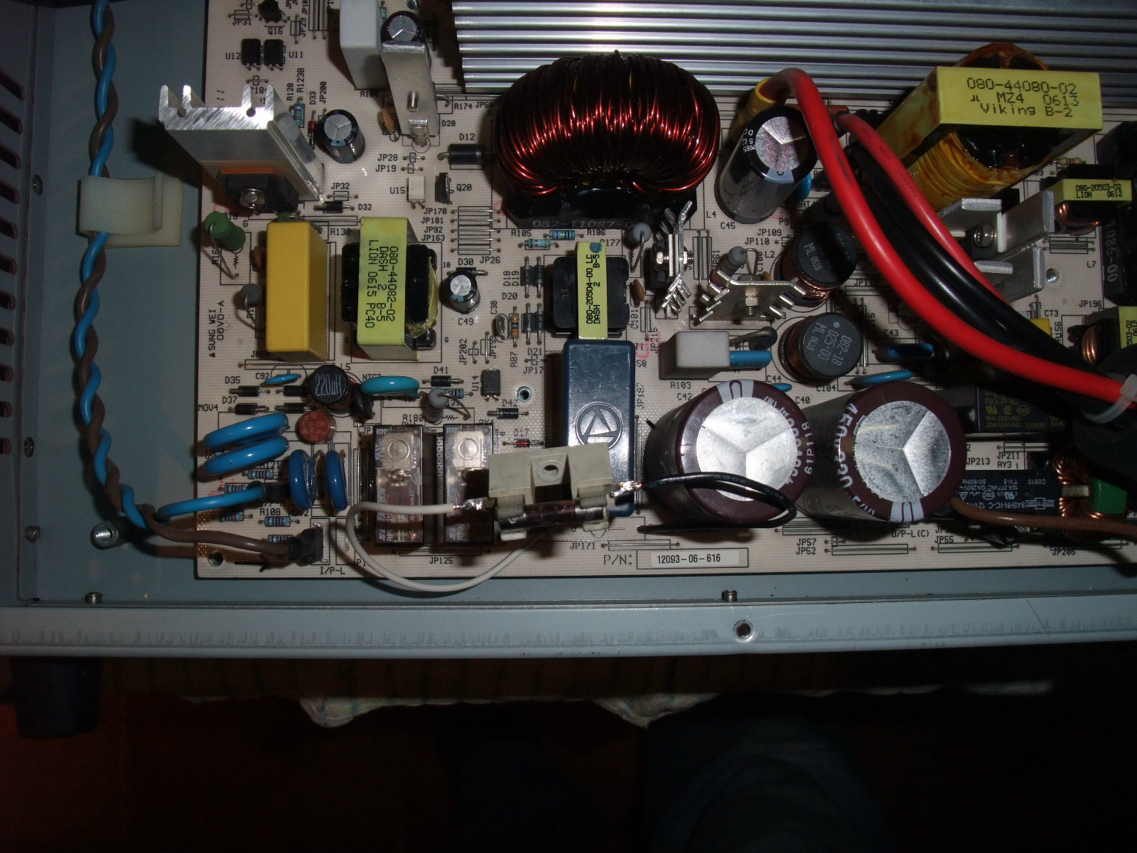

                            Hmm, seems like different design. OK, let's start. You have photos so you know where every cable belongs. So, disconnect everything and remove the main board.
                            I would personally begin with the section between blue and red wire, there is some silicone with only small heatsink and some even without any. Check it. What are the small capacitors in there? They may be baked, I can imagine some heat is being produced arround those components.
                            • biserko
                              • Nov 2012
                              • 6
                              • croatia
                              We replaced the components that you have said, but the problem is what are the other of components very very hot, you can not keep your finger on how many of them are hot ...
                              • Behemot
                                • 4845
                                • CZ
                                Does it work now?
                                Well yeah, you can think about adding some bigger heatsinks or doing some ghetto mods like resistor fly mod and so. If it is worth it…

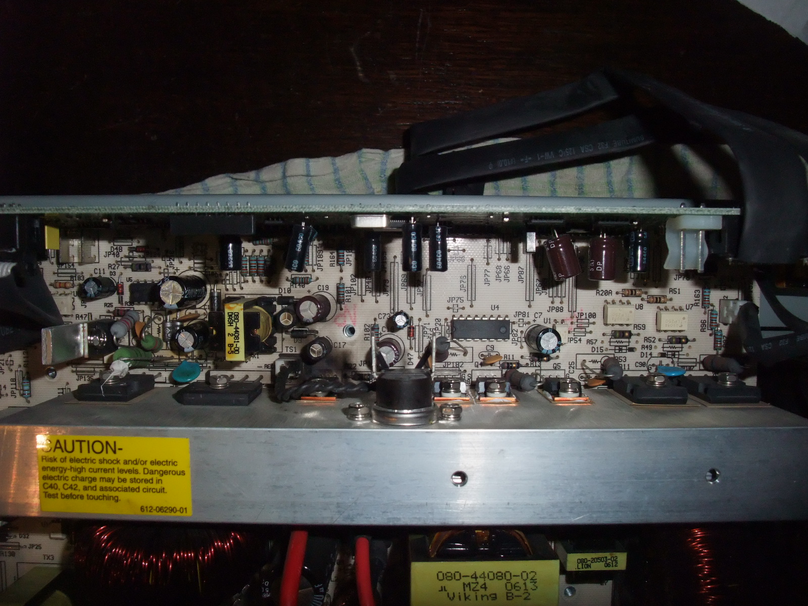

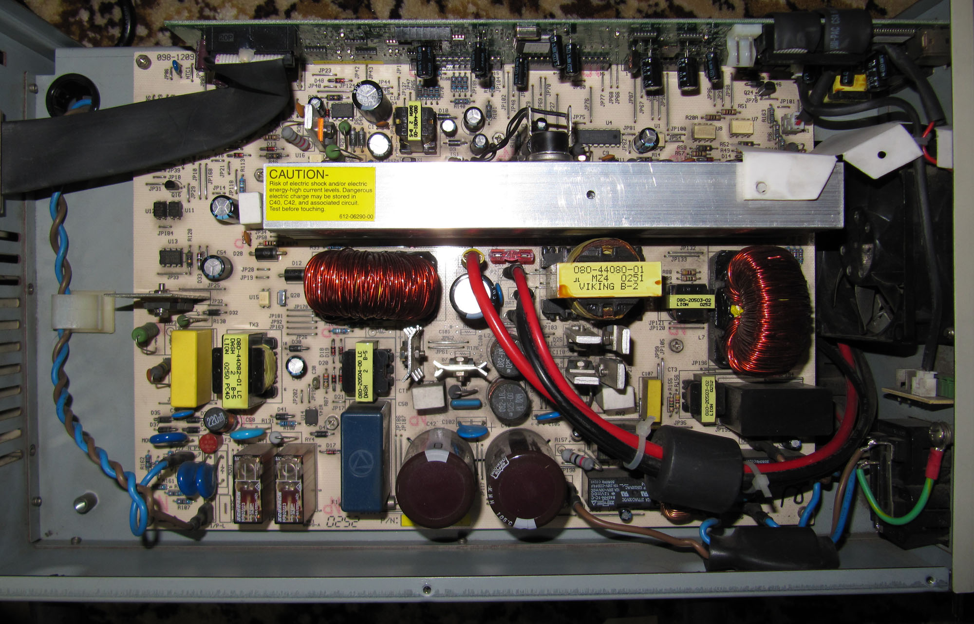

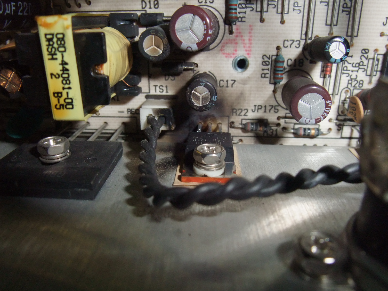

                                  I have blown one IRF3710, near 2 caps mentioned before, and glass fuse on board (5A).
                                  Replaced IRF and fuse but it blows fuse again. On LCD is "DC Bus Fault".
                                  Any idea what next?
                                  • mariushm
                                    • May 2011
                                    • 3799
                                    A blown fuse rarely happens without a cause.
                                    Maybe look at the traces going to the IRF and follow them back checking components in the path?
                                    If something blows the IRF, something is probably shorted or a diode is faulty. I would go from the IRF solder points/holes back and check everything.
                                    Check diodes, check resistors, check for shorted capacitors and if you can their ESR/if they're leaky, check npn transistors (put meter on diode check, test 2 out of 3 pins in both directions as if they're diodes)
                                    If you can, take out the board and get a good camera with macro mode and snap some focused (not blurry) pictures of both sides, maybe someone with good eyes here can spot some components that look burnt out or some broken/burnt copper traces on the pcb.
                                    • davor
                                      • Dec 2012
                                      • 13
                                      • Croatia
                                      Thanx. Its 22:00 and I've just replaced rest 3 IRF's (S/D=short) but spoted on 2 IRF's on the right, traces of some kind of burns/cuts of on source pins!!!
                                      Now Ive left UPS to filll batts to full and will post results tomorrow.
                                      1st IRF was burnt so hard that pin was in the air!!! Temp. was so high that components around have black marks!
                                      Fuse (5A) is soldered to the board as, by design, it's not ready for easy replace.
                                      • davor
                                        • Dec 2012
                                        • 13
                                        • Croatia
                                        No change at all - fuse keeps blowing.
                                        Replaced also 2 condensers, checked diode near IRF (first from the left, traces of burning around it).
                                        With power cable connected fan starts (as before) and I can browse thru options on LCD but when I press power - bang.
                                        Tryed to start device just on batts but some smoke came out - didnt have time to spot from where and didnt want to do it again.
