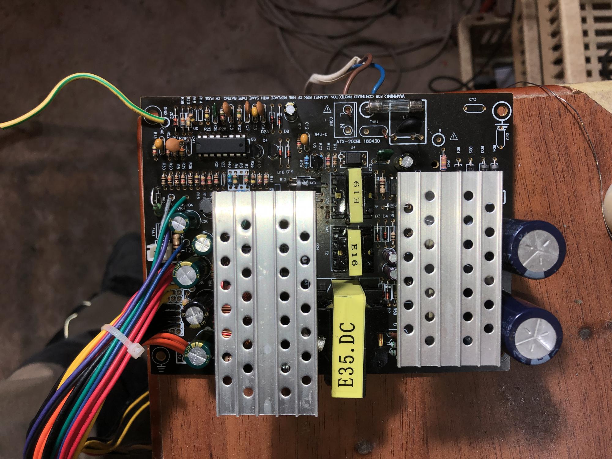

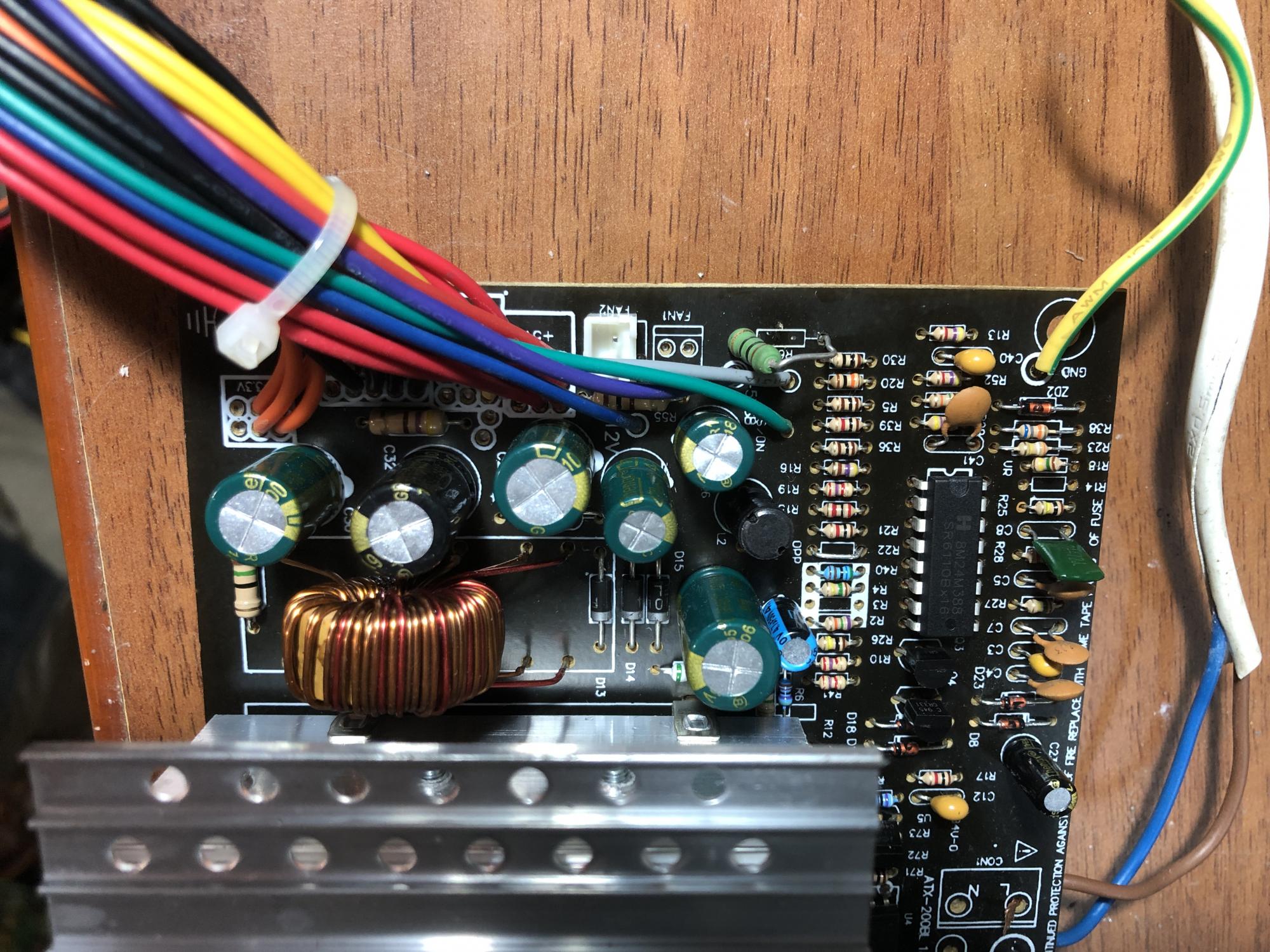

              Sorry I had a couple of busy days and couldn't reply before..

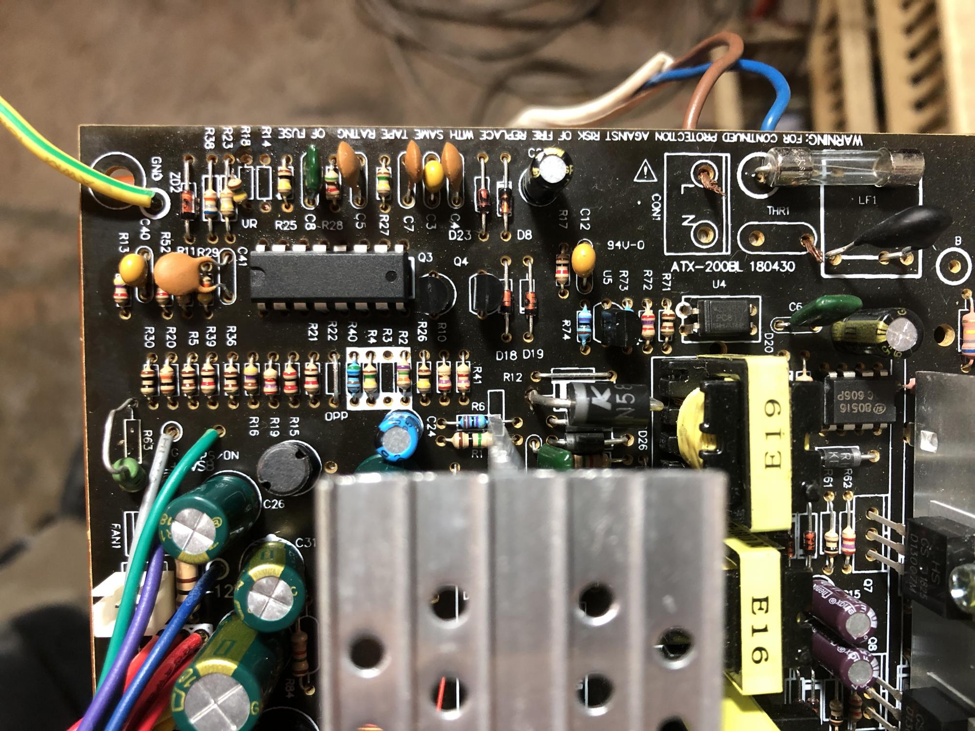

              Anyway here are some pictures of the board, as per your suggestions: all the electrolytic caps look fine (I only checked capacitance since I don't have an esr meter), I couldn't find any bad solder joints anywhere, and I checked all the bjts and the main diodes on the board and everything seems fine, now I will have a look again in case I missed something.
              Btw, I know it's not worth fixing it, but I am just studying and learning how to fix power electronics.
              Thanks for your reply.

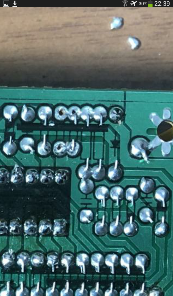

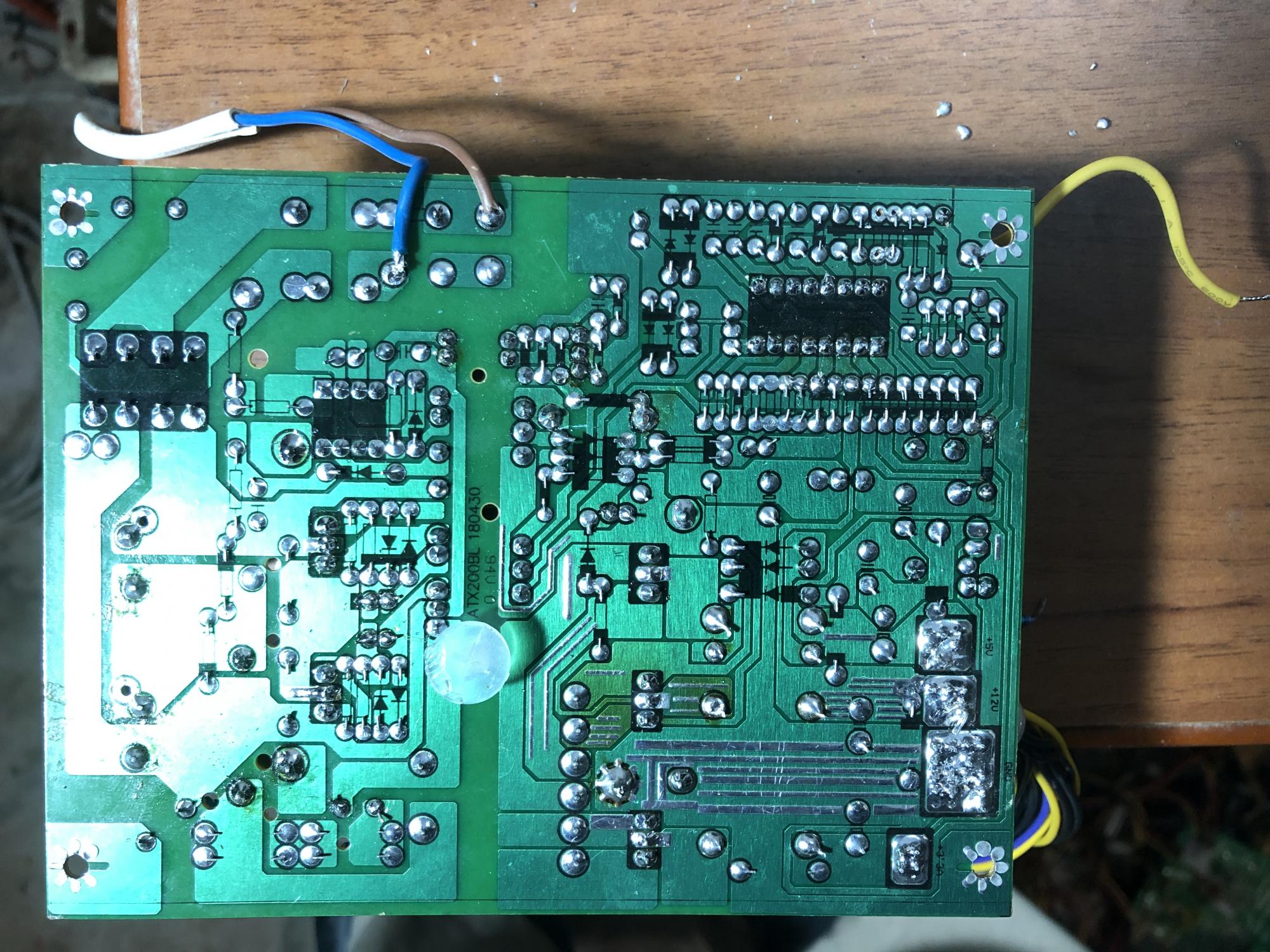

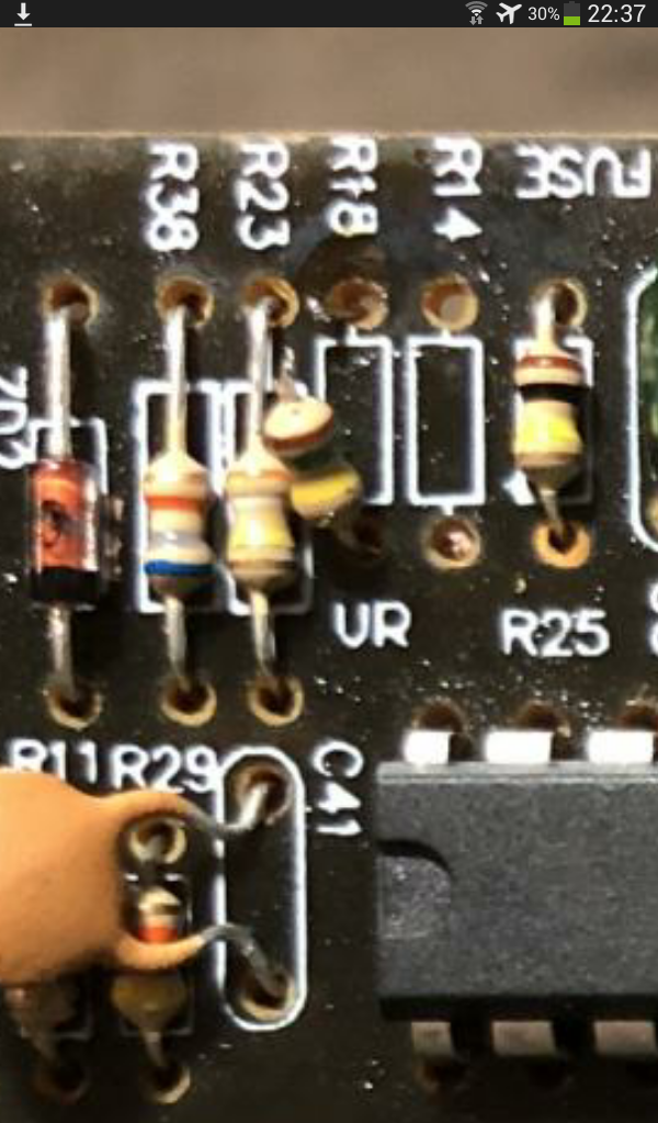

                Re: Atx psu 5Vstb present, no output
                R14, R18 whats going on there?
                R18 150k looks like cutted and lifted but left purely soldered legs
                R14 missing...
                  R14 missing...
                  R18, believe it or not, was like this when I opened it (and the psu was bought new a few months ago), I tried to solder it but nothing changed, so I put back the way I found it, R14 was taken out to measure it when I took the picture, I am checking pretty much every single component just to find if anything is burned or shorted

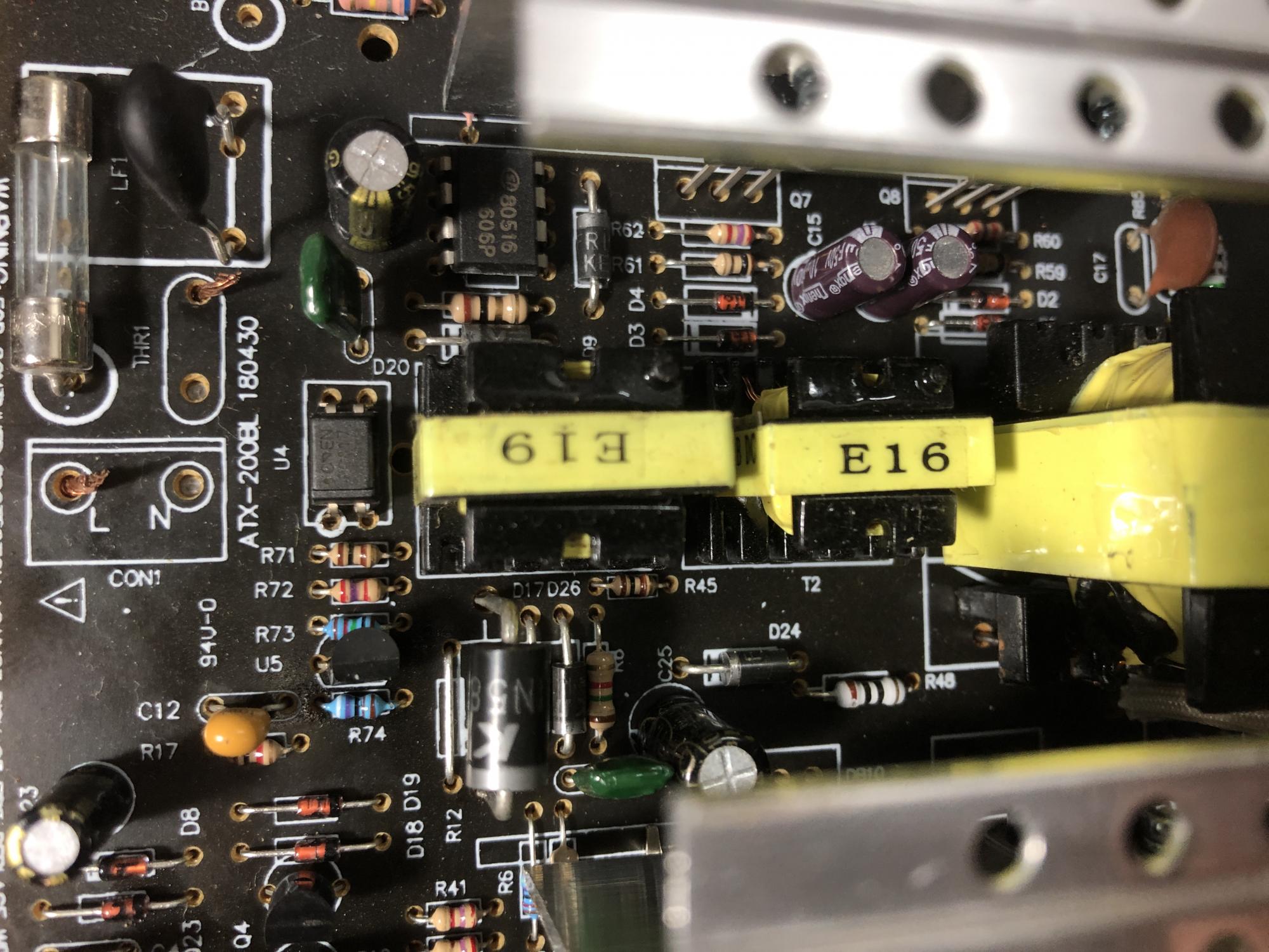

                    Just a quick update, I put back the resistor on r14, and I managed to test the frequency of the pwm output (pin 7 and 8), and I found out that the ic was actually switching, so I checked the main bjts on the hot side and one was actually giving some strange readings, so I replaced them both, and after that the ic stopped switching (same as the beginning) so I had the amazing idea to cut all the tracks (1 to 4) for the ovp protection pins and short them to ground, and turn it on without any isolation transformer nor incandescent bulb in series to limit the current…
                    You can see where this is going, not one but two amazing bangs! The second one was the fuse which literally exploded, while the first might have been one of the two bjts (which is now shorted, note that I tested them before and they seemed ok) ��! Now I am not sure if to proceed, since, even if I somehow manage to fix it, I guess that is gonna be kinda hard to understand which one was the original fault
